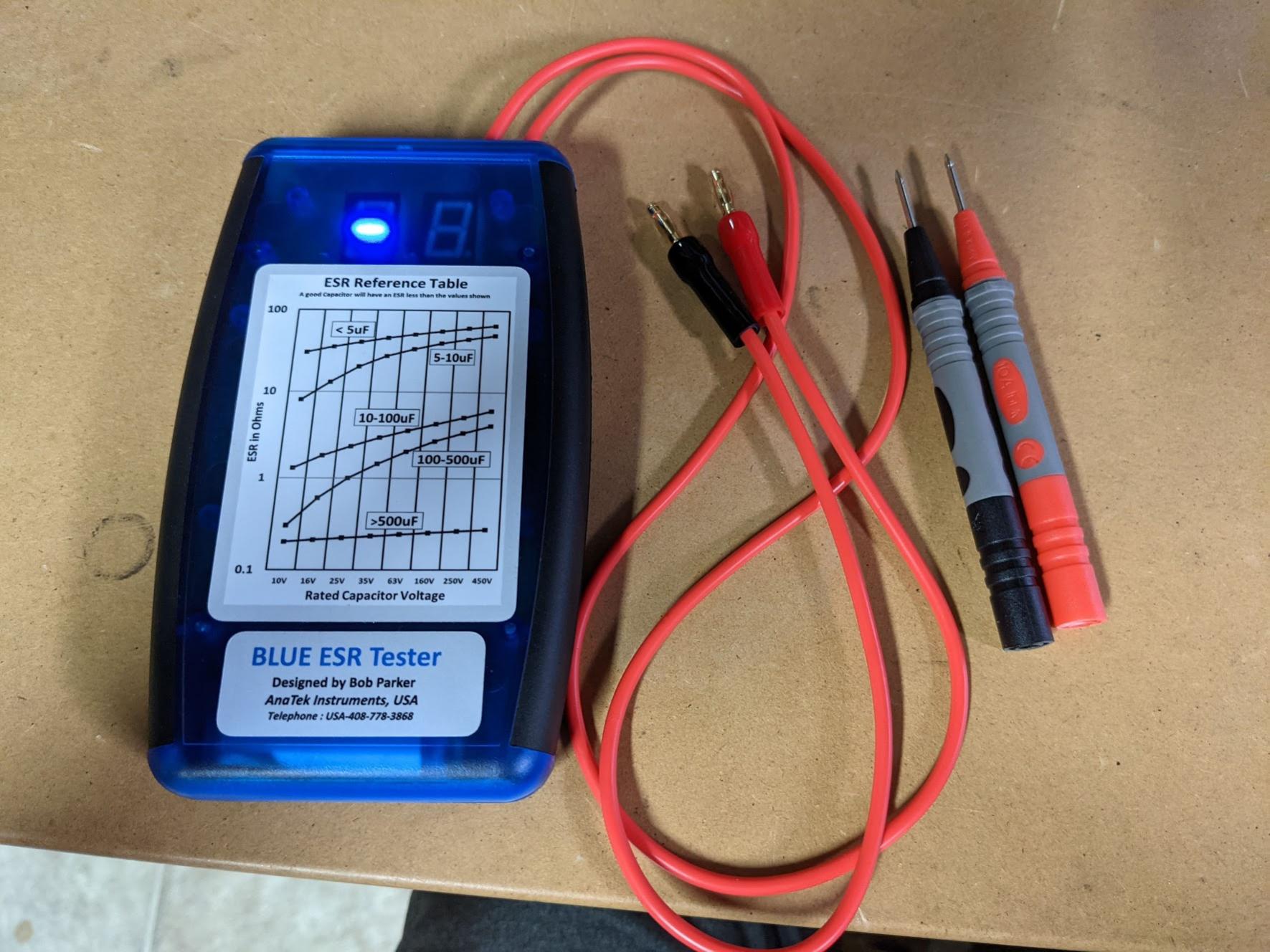

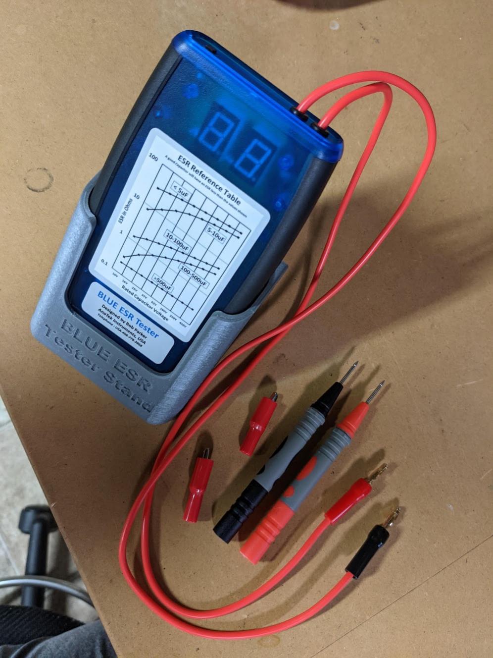

Finally built the Bob Parker "Blue" ESR Meter
  • redwire
    replied
    Re: Finally built the Bob Parker "Blue" ESR Meter
    Some (good) battery blue ESR measurements:
    AAA Panasonic alkaline, 0.11 ohms, 0.13 ohms
    AAA Ikea alkaline, 0.07 ohms
    AAA chinese alkaline [weak almost dead] 0.2 ohms
    AAA Energizer lithium, 0.22ohms, 0.24 ohms
    AAA Ikea Ladda NiMH 900mAh charged, 0.06 ohms. Discharged, 0.06 ohms
    AAA Eneloop NiMH 750mAh charged, 0.17, 0.23
    9V Energizer Industrial alkaline, 1.2 ohms
    9V Duracell alkaline, 5.0 ohms I just want to take a leak?
    12V 7.2Ah gel-cell good 3yrs on standby, 0.03 ohms
    AA Ikea Ladda NiMH 2,450mAh new, 0.03 ohms
    AA Eneloop Pro NiMH 2,450mAh used, 0.06 ohms
    AA Ikea alkaline, 0.05 ohms
    AA Duracell alkaline weak, 0.77 ohms I just want to take a leak
    AA Duracell Procell alkaline weak, 0.70 ohms I just want to take a leak
    AA Duracell Procell alkaline weak, 0.13 ohms
    I think the main advantage to using ESR is it doesn't depend on state-of-charge, so dead or alive it checks the plate's active surface area and cell interconnects etc. which go downhill with corrosion.
    But I really need to build a new blue ESR meter with an extra digit of resolution.
    Leave a comment:
  • volkswagenvan
    replied
    Re: Finally built the Bob Parker "Blue" ESR Meter
    AnaTek worked with Bob Parker to get the Blue ESR Meter assembled for sale.
    I would trust anything he says because he would know!
    As for ESR getting better with charge cycles,... It could happen.
    I have seen old caps that have just sat around in equipment unused get better
    after some time back in service. Reform I guess.
    You got me playing with battery's at my desk now!
    New AA alkaline 1.5 volt reads .00 on the Blue while Old almost dead ones removed from my belt flashlight read 1.0 ohms. Same brand from the same package!
    Interesting!
    Another interesting thing is if you put one sharp tip test lead on the bottom of a cheap
    AA battery you can touch the positive and negative through the plastic at the same time producing a red glow hot enough to make a small blister on your finger!
    Never done that before! Ok,...I`m done testing stuff now. LOL
    Leave a comment:
  • jayjr1105
    replied
    Re: Finally built the Bob Parker "Blue" ESR Meter
    Originally posted by redwire
    What ESR chart did you go with?
    I've heard measuring battery ESR can also be done if you add a series DC blocking capacitor. Good for many testing different batteries, LiIon and car batteries with the Blue ESR meter.
    This guy seems to think the meter can check batteries charged or not.
    https://youtu.be/toq3msUeQ40?t=207
    Leave a comment:
  • volkswagenvan
    replied
    Re: Finally built the Bob Parker "Blue" ESR Meter
    Looks Good Enough to do the job jayjr !
    Everybody can use it if you want. Its not to fancy but it works!
    I remember typing the omega / ohm symbol was a pain for me!
    The colors just looked kinda cool. I saw similar on the net and they got added at the end.
    I have two printers that i use. One HP Laser Jet P1006 for cheap black and white and
    a HP Office Jet Pro 8210 for color printing.
    Leave a comment:
  • eccerr0r
    replied
    Re: Finally built the Bob Parker "Blue" ESR Meter
    Interesting the "old" table seems to include some compensation to limited testing frequency, but the "new" graphs do not...
    Now to attach a table to the AVR transistortester ... heh...
    Leave a comment:
  • jayjr1105
    replied
    Re: Finally built the Bob Parker "Blue" ESR Meter
    Originally posted by volkswagenvan
    Glad to help... looks more professional in color. lol
    I know i love mine now!
    I should have printed it out at work on our $3000 copier instead of my monochrome $80 home laser printer. It looks good enough and I didn't use sticker paper either. I was just really careful with packing tape and used a razor to trim the excess.
    Leave a comment:
  • volkswagenvan
    replied
    Re: Finally built the Bob Parker "Blue" ESR Meter
    Glad to help... looks more professional in color. lol
    I know i love mine now!
    Leave a comment:
  • jayjr1105
    replied
    Re: Finally built the Bob Parker "Blue" ESR Meter
    Originally posted by volkswagenvan
    I kinda made one from the old Bob Parker meter.
    Thanks for the printout. Doesn't look as "professional" as the original but 10 times more useful.
    Last edited by Per Hansson; 02-20-2022, 07:06 AM. Reason: Offsite image uploaded
    Leave a comment:
  • volkswagenvan
    replied
    Re: Finally built the Bob Parker "Blue" ESR Meter
    bcstedt,..
    About your FA error code.
    Lots of reading gives me this from Bob Parker. (Don't try out the self-diagnostic function unless you really need to. And don't use a 9V battery with the diagnostic function because it will report an 'F2' fault which probably doesn't exist. It must be powered by 5.5v to work properly.)
    As far as errors and faults check here. http://www.bobparker.net.au/esr_meter/esrprob.htm
    Lots of good Info on errors and problems with the Blue ESR Meter from Bob himself!
    Leave a comment:
  • volkswagenvan
    replied
    Re: Finally built the Bob Parker "Blue" ESR Meter
    Those minor upgrades add up to ease of use!
    The longer leads would keep me from dragging my Blue around so much!
    Nice job on the holder!
    Leave a comment:
  • volkswagenvan
    replied
    Re: Finally built the Bob Parker "Blue" ESR Meter
    Originally posted by stj
    doesnt esr on batteries vary with charge?
    i know on 18650's i salvage that they look a lot better after a full cycle
    I never tried testing 18650's.
    Just lead acid, nickel metal hydride and nickel cadmium's.
    Can't recall really checking for charged verses dead.
    Lots of charged verses charged to compare their health is all.
    Leave a comment:
  • jayjr1105
    replied
    Re: Finally built the Bob Parker "Blue" ESR Meter
    Did a few more minor upgrades. New thicker and longer cables, better banana plugs, cut off the massive finger guards on the probes, and 3d printed a case that holds the meter upright.
    Last edited by Per Hansson; 02-20-2022, 07:05 AM. Reason: Offsite images uploaded
    Leave a comment:
    replied
    Re: Finally built the Bob Parker "Blue" ESR Meter
    doesnt esr on batteries vary with charge?
    i know on 18650's i salvage that they look a lot better after a full cycle
    Leave a comment:
  • volkswagenvan
    replied
    Re: Finally built the Bob Parker "Blue" ESR Meter
    Cool,... You got a new toy!
    Leave a comment:
  • redwire
    replied
    Re: Finally built the Bob Parker "Blue" ESR Meter
    Hey I looked at the schematic and it's already got a 22uF BP cap to block DC and not damage the ESR meter
    It must be other shitty ESR meters I've built like the 5-transistor special that need a cap.
    Tried a bad 12V 7Ah gel-cell and its ESR 2.3 ohms, a good one is 0.1-0.2 ohms.
    Leave a comment:
  • volkswagenvan
    replied
    Re: Finally built the Bob Parker "Blue" ESR Meter
    Hey redwire
    You can measure battery ESR with the Blue as is. No need to add anything.
    This is only if you did not do any diode mod to your meter!
    (back to back diodes on the input)
    Leave a comment:
  • volkswagenvan
    replied
    Re: Finally built the Bob Parker "Blue" ESR Meter
    I can`t recall but i bet there was some hot air involved.
    Leave a comment:
  • jayjr1105
    replied
    Re: Finally built the Bob Parker "Blue" ESR Meter
    Did the included sticker give you trouble removing it? I agree it's a bit too vague. Need a simple chart. Plus I put mine on a little too high so you can't quite see the decimal positions if it's slanted too much.
    Leave a comment:
  • volkswagenvan
    replied
    Re: Finally built the Bob Parker "Blue" ESR Meter
    Printed it to sticker paper and after applied I put clear laminate over it!
    I made a bunch in case i messed up. lol
    Worked fine on the first one.
    Leave a comment:
  • volkswagenvan
    replied
    Re: Finally built the Bob Parker "Blue" ESR Meter
    I kinda made one from the old Bob Parker meter.
    Leave a comment:
    Modification of a Fluke multi meter that uses three AA batteries to use a 14500 lithium ion battery
    by sam_sam_sam
    I have had with regular AA batteries that leak this meter is expensive new I already replaced the battery battery clips once and the same thing happened again and I am tried of so it is getting modified to accommodate lithium ion batteries that are the same size excluding the positive terminal and removing the battery clips I will have enough room for the BMS protection board
    I going to put 3 lithium ion battery in parallel with the BMS protection board and a way to charge the battery externally and heat shrink the battery pack and use a JST connector so I easily remove the battery...
    12-31-2023, 06:04 AM
    Lenovo IdeaPad IP3 15 I3-1215U 4GB 128GB BLUE Notebook 300 Specification for Upgrade or Repair
    This specification for the Lenovo IdeaPad IP3 15 I3-1215U 4GB 128GB BLUE Notebook can be useful for upgrading or repairing a laptop that is not working. As a community we are working through our specifications to add valuable data like the IP3 15 I3-1215U 4GB 128GB BLUE boardview and IP3 15 I3-1215U 4GB 128GB BLUE schematic. Our users have donated over 1 million documents which are being added to the site. This page will be updated soon with additional information. Alternatively you can request additional help from our users directly on the relevant badcaps forum. Please note that we offer no...
    09-07-2024, 05:00 AM
    Lenovo IdeaPad IP3 15 R7 5825U 8GB 512GB BLUE Notebook 300 Specification for Upgrade or Repair
    This specification for the Lenovo IdeaPad IP3 15 R7 5825U 8GB 512GB BLUE Notebook can be useful for upgrading or repairing a laptop that is not working. As a community we are working through our specifications to add valuable data like the IP3 15 R7 5825U 8GB 512GB BLUE boardview and IP3 15 R7 5825U 8GB 512GB BLUE schematic. Our users have donated over 1 million documents which are being added to the site. This page will be updated soon with additional information. Alternatively you can request additional help from our users directly on the relevant badcaps forum. Please note that we offer no...
    09-07-2024, 05:00 AM
    Lenovo IdeaPad IP3 15 I5-1235U 8GB 256GB BLUE Notebook 300 Specification for Upgrade or Repair
    This specification for the Lenovo IdeaPad IP3 15 I5-1235U 8GB 256GB BLUE Notebook can be useful for upgrading or repairing a laptop that is not working. As a community we are working through our specifications to add valuable data like the IP3 15 I5-1235U 8GB 256GB BLUE boardview and IP3 15 I5-1235U 8GB 256GB BLUE schematic. Our users have donated over 1 million documents which are being added to the site. This page will be updated soon with additional information. Alternatively you can request additional help from our users directly on the relevant badcaps forum. Please note that we offer no...
    09-07-2024, 05:00 AM
    Lenovo IdeaPad IP3 14 I7-1255U 8GB 512GB BLUE Notebook 300 Specification for Upgrade or Repair
    This specification for the Lenovo IdeaPad IP3 14 I7-1255U 8GB 512GB BLUE Notebook can be useful for upgrading or repairing a laptop that is not working. As a community we are working through our specifications to add valuable data like the IP3 14 I7-1255U 8GB 512GB BLUE boardview and IP3 14 I7-1255U 8GB 512GB BLUE schematic. Our users have donated over 1 million documents which are being added to the site. This page will be updated soon with additional information. Alternatively you can request additional help from our users directly on the relevant badcaps forum. Please note that we offer no...
    09-07-2024, 05:00 AM
