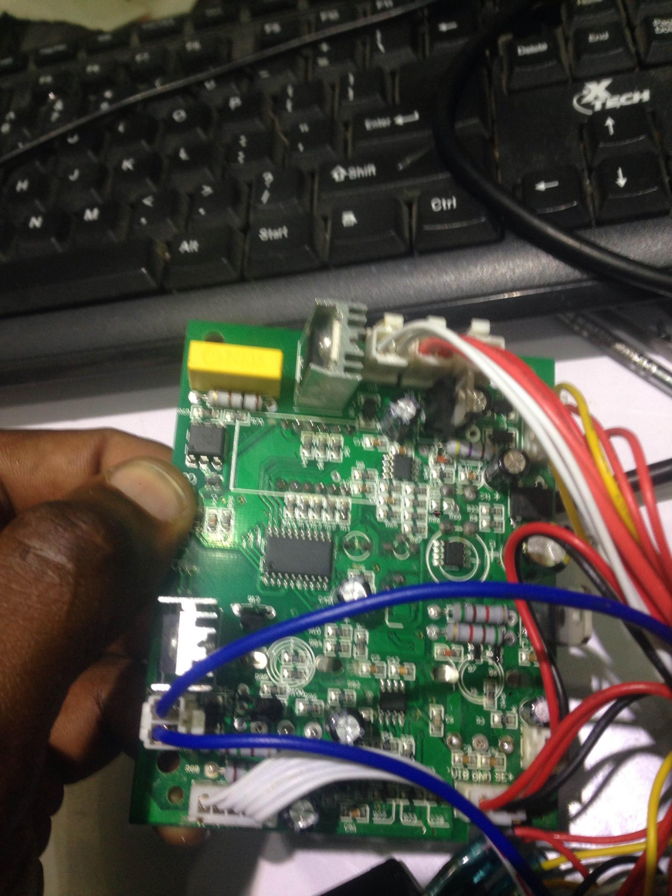

    Post some pictures of this board or boards front and back of the boards
      Re: 878d H-E Error
      here are some photos

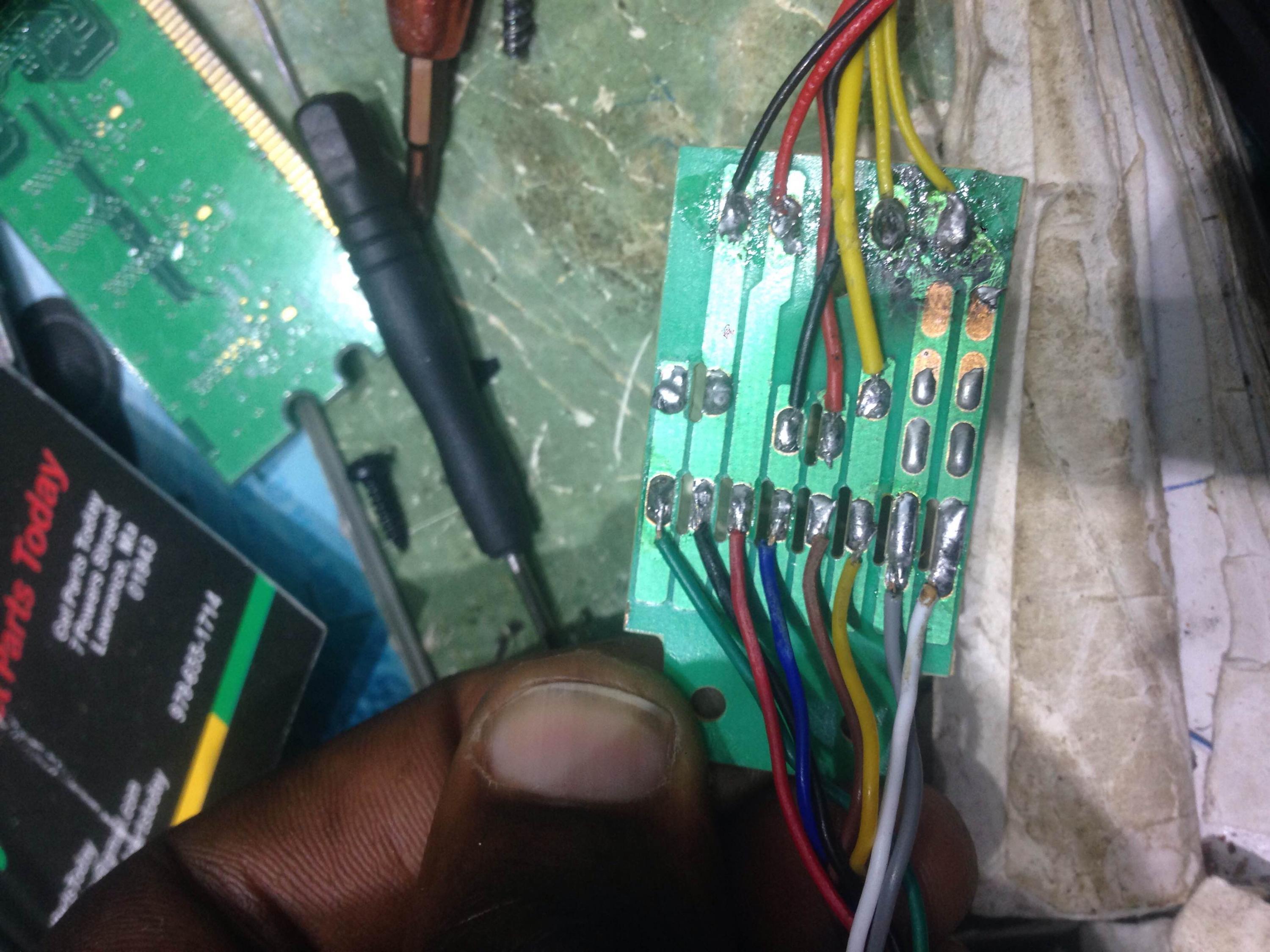

              some of the soldering is total shit - even has splashes on the board!!
                Re: 878d H-E Error
                I would measure ohms at the PCB connector with the two red wires, the one that ends up going to the heater. So plug in the GX connector and see what you measure. The heater should be around 20 ohms.
                Either that, or some problem with the triac turning on. The pics are too blurry to see.
                You can clean up the pcb with rubbing alcohol and Q-tips.
