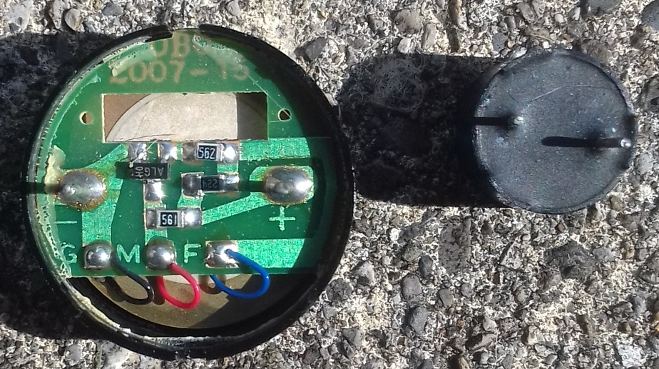

    However, I did find a bigger piezo (about 22mm diamter), that I think was pulled off a UPS board, and when I try with this in place of the original piezo, it makes a nice loud noise. But whereas the other piezos are just a piezo, this one that works has some extra circuitry built in (picture 3).
    So it looks like there is something wrong with the electronics going to the original piezo on the DMM board. Will the multimeter have a similar circuit to the 22mm piezo somewhere?
    Is it possible to get a smaller piezo with a circuit inside it like the bigger 22mm piezo? I couldn't get the bigger piezo to fit the case, but a smaller 12mm piezo with a circuit built in could fit in one of the corners of the multimeter case, if there is such a thing.

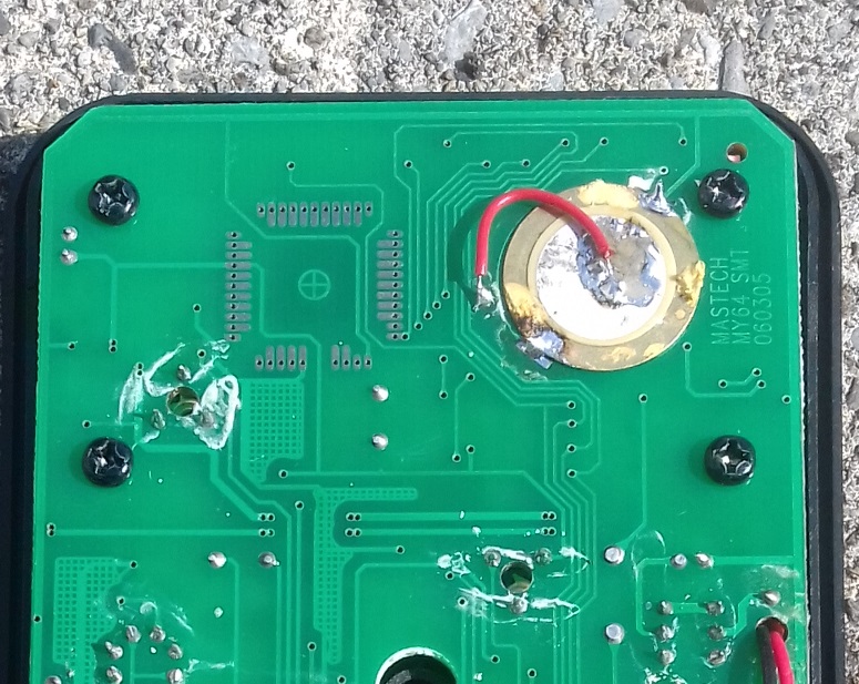

      Yeah, those piezos would probably survive a bombing, and it does test ok in another multimeter.

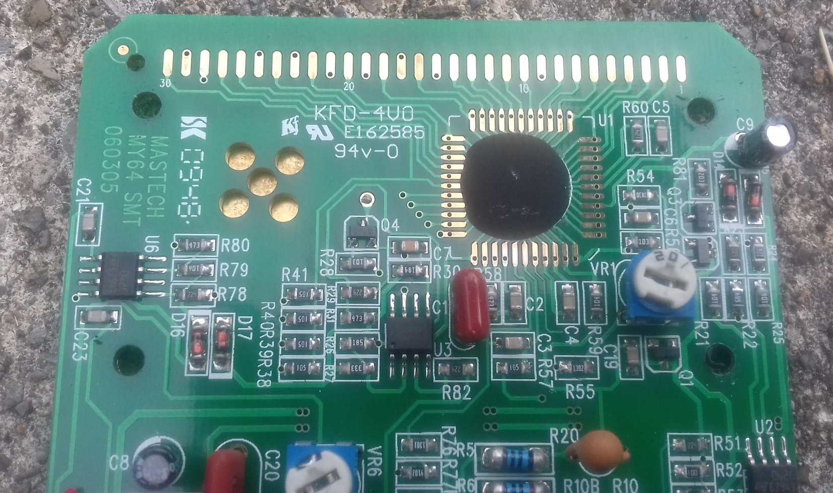

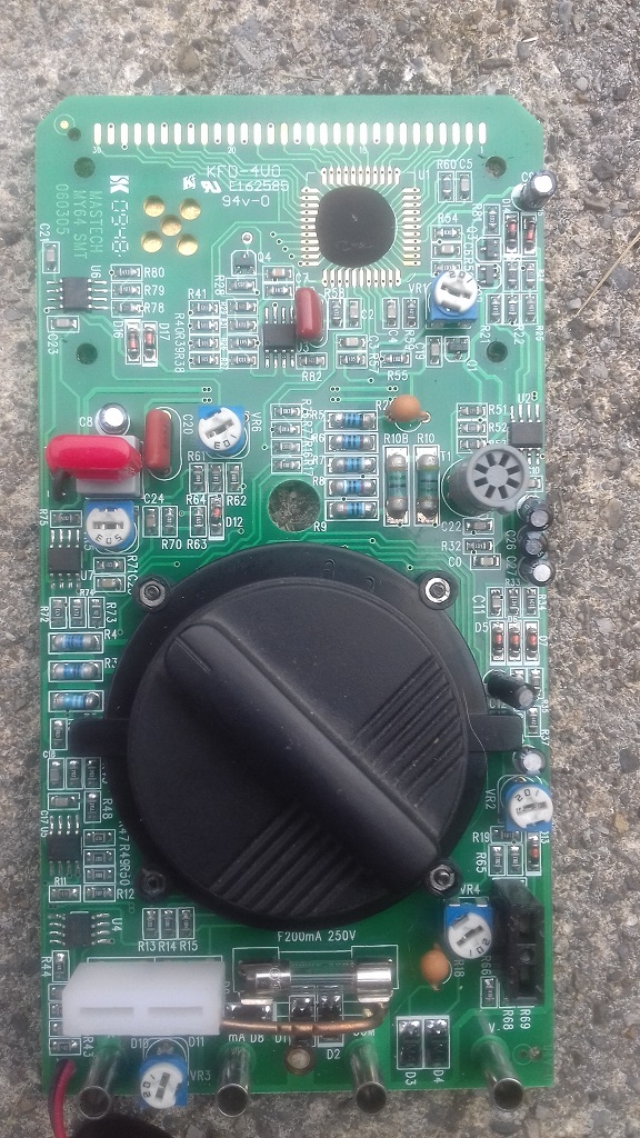

      Attached are a couple of photos of the other side. The center of the piezo (red wire in photos in first post) is connected to the small pad above component Q4.

        Some piezo drive circuits are done wrong.
        A piezo is a capacitive load and needs push-pull (source and sink) current to move. If you drive one with an open-collector transistor Q4 (charge but no discharge path), the piezo will be way quiet.
        The fix is putting a resistor like 330R-1k in parallel (with disk) so the piezo's capacitance gets a way to discharge. I would try that.
        Changing to a piezo buzzer (built-in oscillator) is a last resort.
