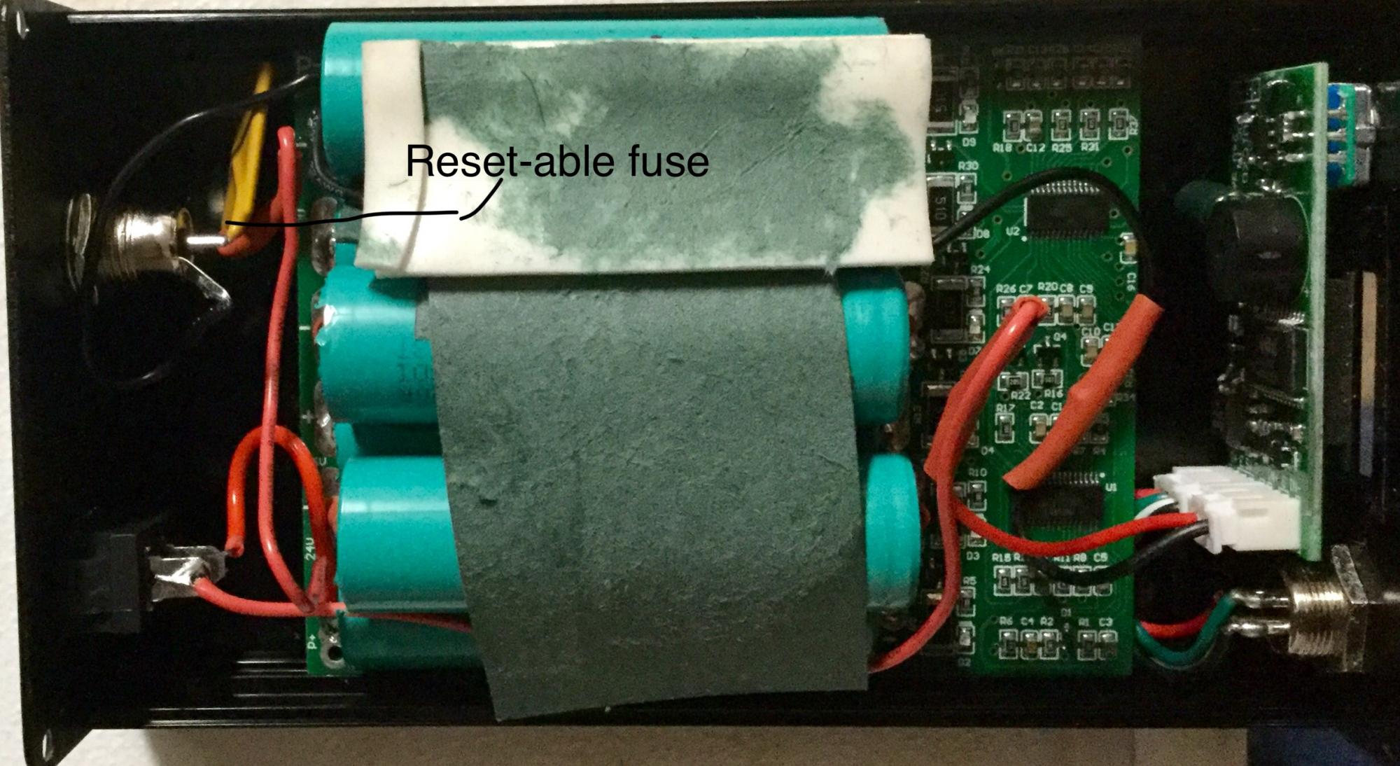

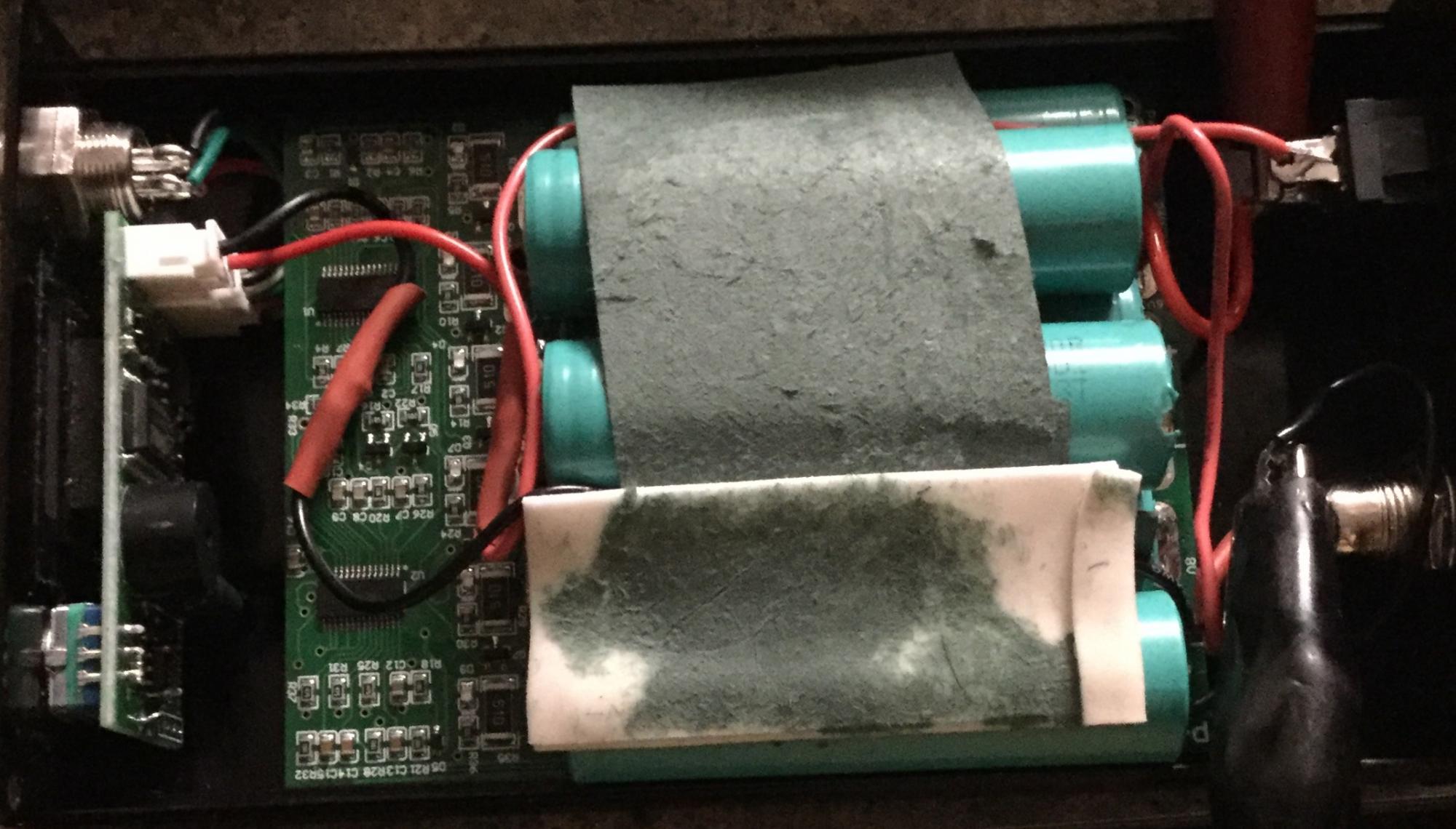

      Here is the soldering iron controller with the batteries in and power supply jack all in one case
      Yes there is a meter hooked up to the power jack I checking the battery charger that I bought for this unit I seeing if it going to work or not with getting to hot
      I bought another Kobalt battery pack from Lowe’s and try out some Samsung 2 amp hour batteries that the battery voltage and amp hour readings were very close to each other
      So we will see if this BMS protection board will work better this time with batteries being very close to each other in milliamperes results

        Here are the test results for this BMS protection board for the Ksger battery powered soldering iron controller
        If you charge and discharge the batteries and use batteries that have the same exact results for each battery
        The results of this board is as follows on a scale of ONE that the board does not work at all and TEN working perfectly
        I give this BMS protection board for batteries a nine.five
        Here is why if you try charging higher than 500 milliamperes it turns on one of the balancing LED light which to me is a down side of this board which I took half of a point from it score
        Yes this board is worth the money if you are willing to do a little work with the batteries first then your results will be very good
        These are my final thoughts on this battery BMS protection board
        I hope this will help someone that is thinking of doing something similar to this setup
        You do need to use the case that is 150mm long otherwise not everything will fit there will not be enough room
        One other thing that I would highly recommend is that you use a reset-able fuse on input power jack just in-case something goes wrong
        As you can see the photo reset-able fuse where I put the fuse at in the photo
        The only thing to work on now is charging controller for this battery BMS protection board and limit the charging current to 500 milliamperes so batteries will be fully charged

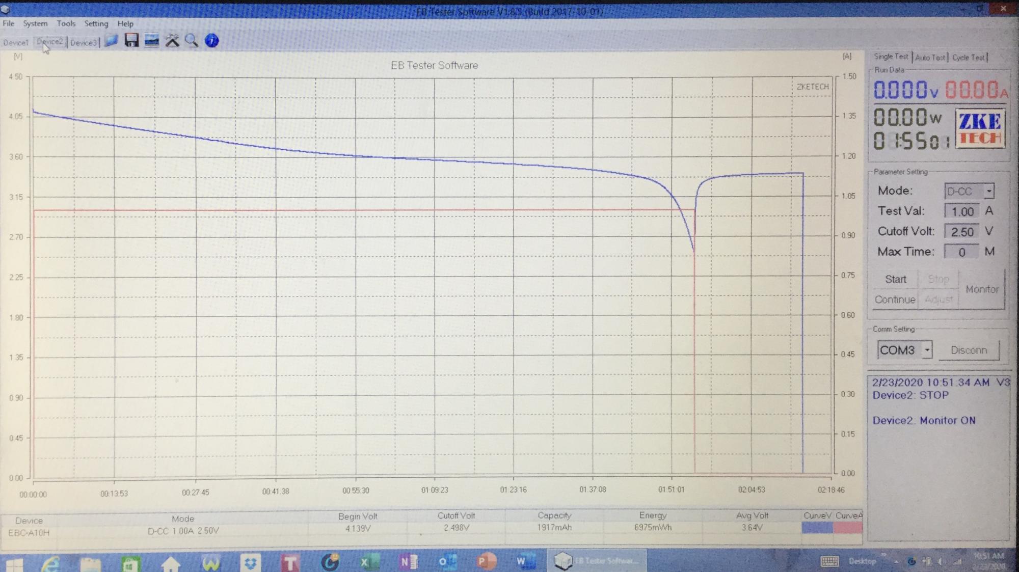

                I checked three of them so far that this BMS protection board says that is charged and the milliamperes are as follows
                1657
                1929
                1985
                Once I have tested all of the batteries and recharge them and retest them and see if it is the batteries or is it BMS protection board having way to many issues if this is the case I will not be using this board on anything at all

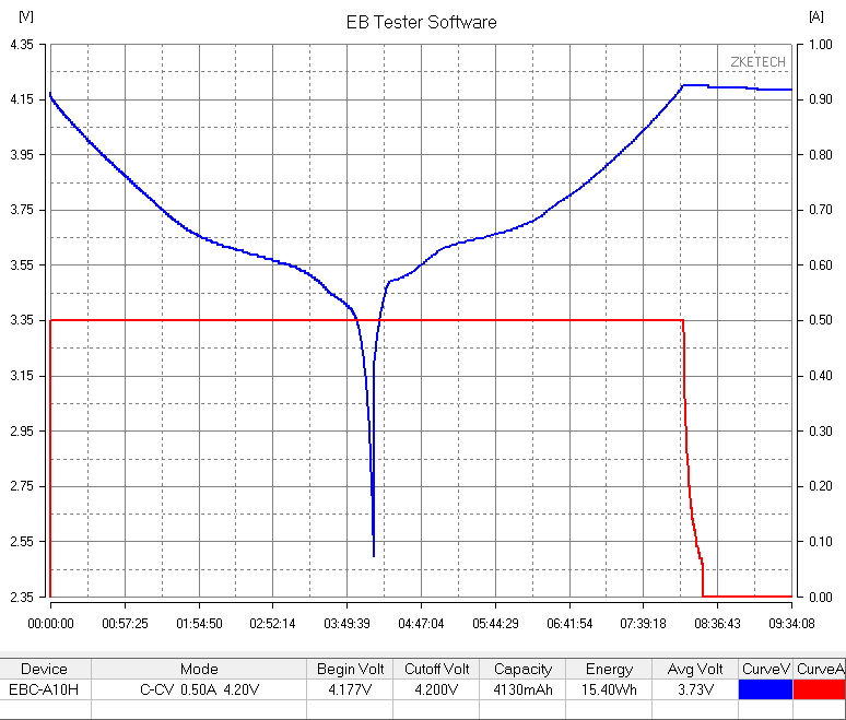

                  Here is an update to this BMS balancing protection board battery test
                  As I said earlier in another post about the EBC -A10H battery tester
                  I have tested 2 of the 6 batteries that was on this BMS balancing protection board
                  I ran this test on two batteries at the same time and milliamperes results were very close
                  With in about 300 milliamperes hour difference
                  The charge curve were almost the same let see if the other two sets give the same results
                  Because if they do then what is wrong with BMS balancing protection board setup
                  Now because this EBC -A10H tester has a monitor function on it once I have checked all the batteries that I had used on this BMS board
                  I am going to make a testing jig for testing this BMS board while charging and discharging the batteries on this board
                  To see just what the problem is with this board

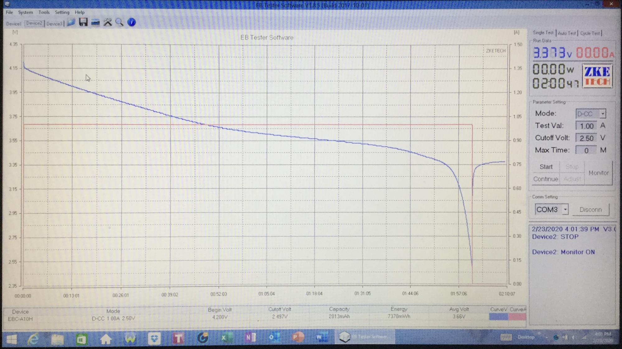

                    1657
                    1929
                    1985
                    You see the results that says 1657 well I ran the test on this battery first and here is the results
                    As you can see there is nothing wrong with this battery

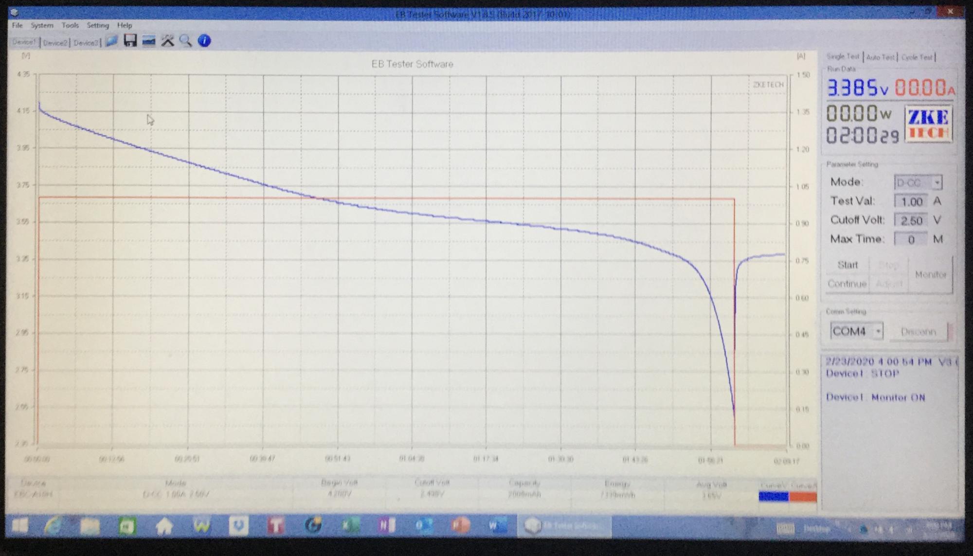

                      Here is the results from the the other battery

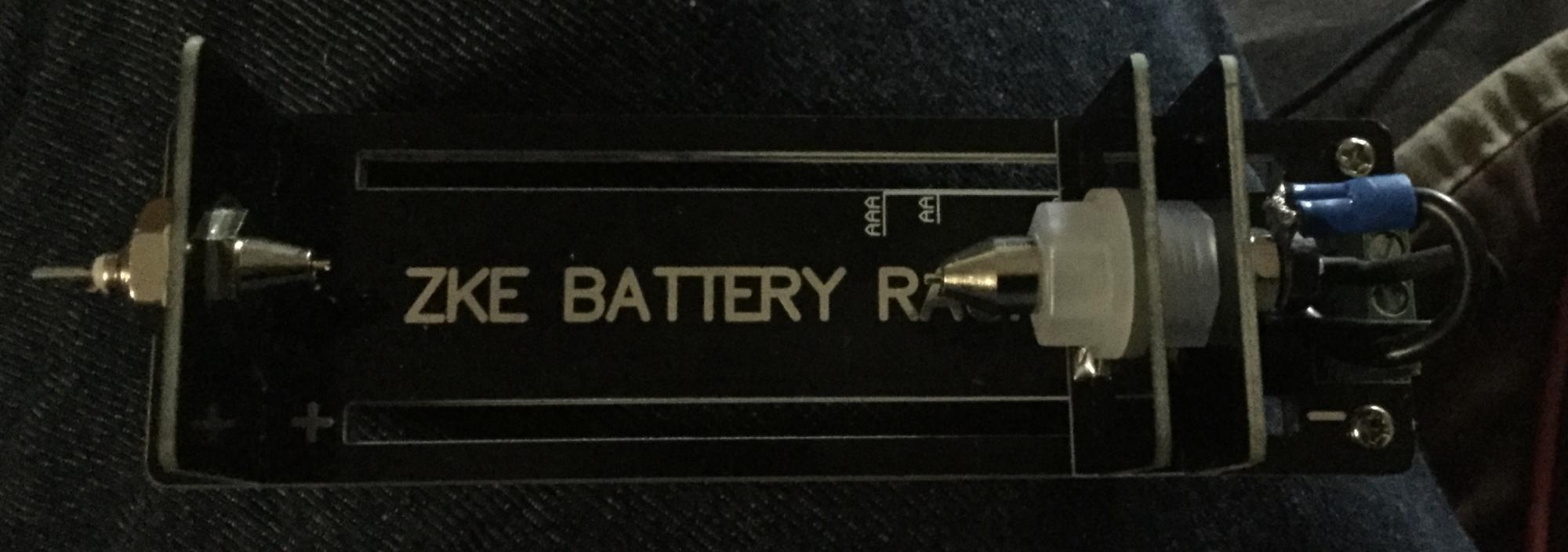

                        Here is an interesting battery test holder
                        The same company that makes the battery tester
                        But I did not get it from the same eBay seller though

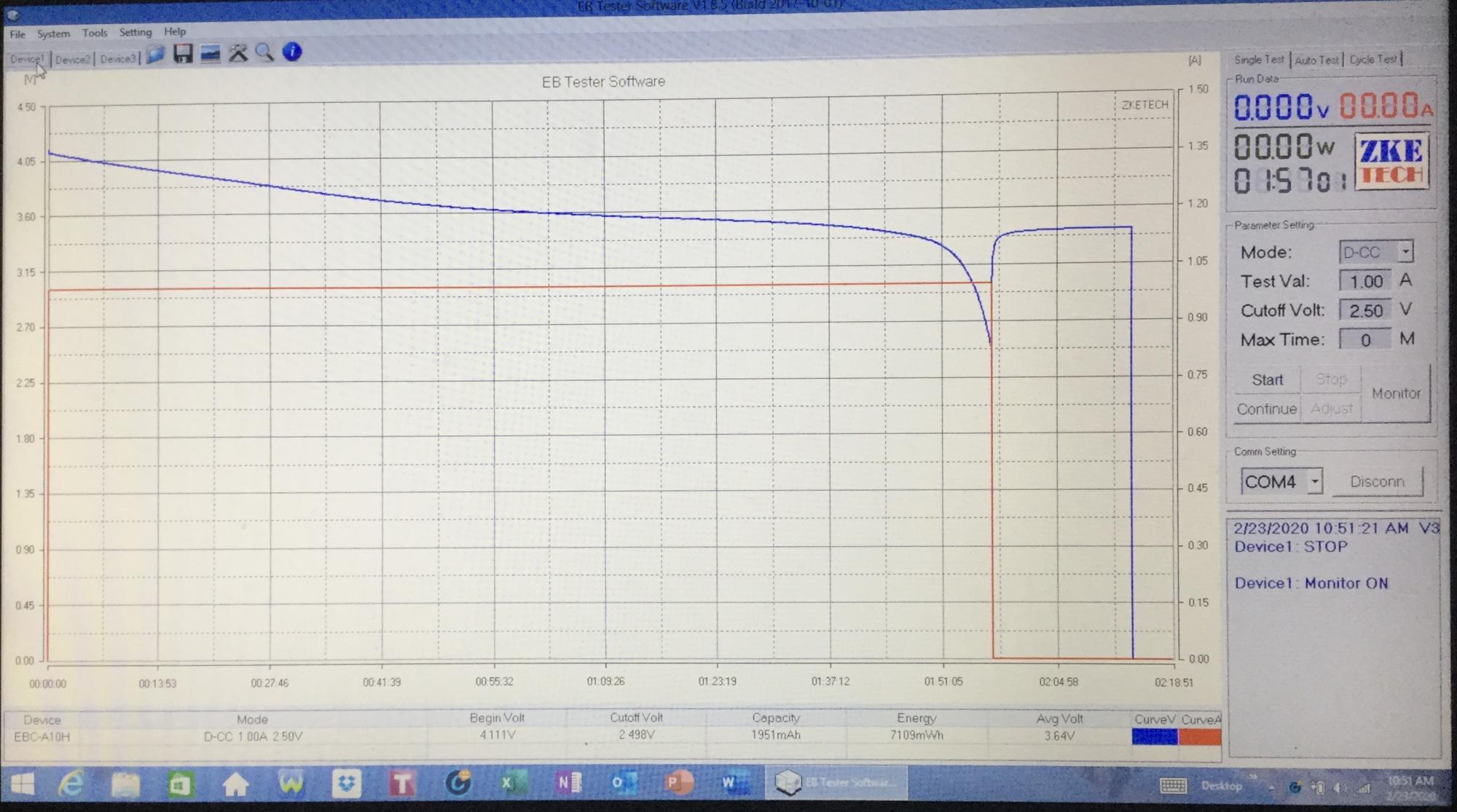

                          Update
                          I have almost finished the second set of batteries and see now why this BMS balancing board is having problem with these batteries it has to with what the discharge curve voltage is when an when it drops rapidly
                          The first set drop at about 3.500 volts and the other set drop at about 3.15 volts but that is not only difference between them the milliamperes hours is also one is at 2008 and other one is at 2013
                          Other ones were 1917 and 1950 milliamperes hours ( this set dose not quite make it )
                          One note about these batteries they are suppose be 2000 milliamperes hours
                          Here is how I see why these batteries are having problems with this BMS balancing protection board
                          You have all the charged and you use to the device until where the battery voltage drops off a 3.50 volts or maybe a little lower than that but you have not reached the BMS board cutoff voltage yet so you see the voltage on the soldering station showing 21.0something volts so you put on charge and because not all batteries have gotten to voltage drop off curve they at different states of discharge so when the first battery reaches about 4.0something volts then the balancing LEDs starts to turn on and that because it has almost has reached the voltage cutoff voltage point now the other batteries have not become fully charged
                          So next time you use it the run time is not quite as long but it still works fairly well now you do the same thing again and same thing happens again ( as noted above ) but this time the batteries that did not get fully charged the first time are lower in charge than the battery that got fully charged the first time
                          Now when you go to use it the third time now it has not charged very much at all
                          Now none of batteries have any run time at all to speak of
                          From the looks of it there not even close
                          I have one more set of batteries to do so we will see what results those have
                          Now the question I have is can you find 6 batteries that have very close charging and discharging voltage drop and voltage rise curves that are very close so the BMS balancing protection board does not get the batteries out of wacky to the point where it will not charge correctly
                          This is the real question to answer
