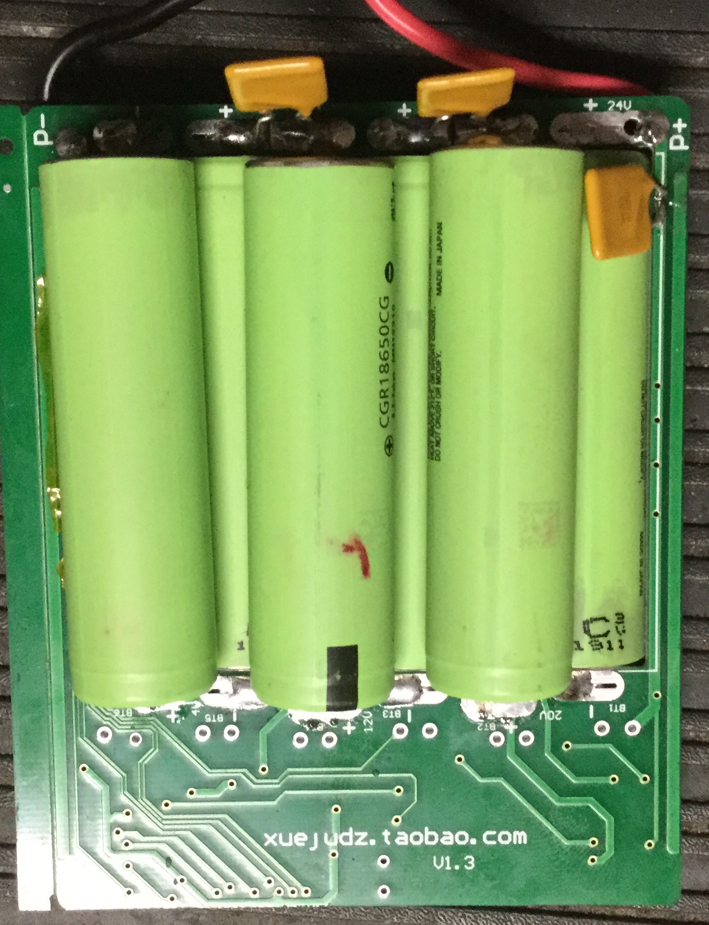

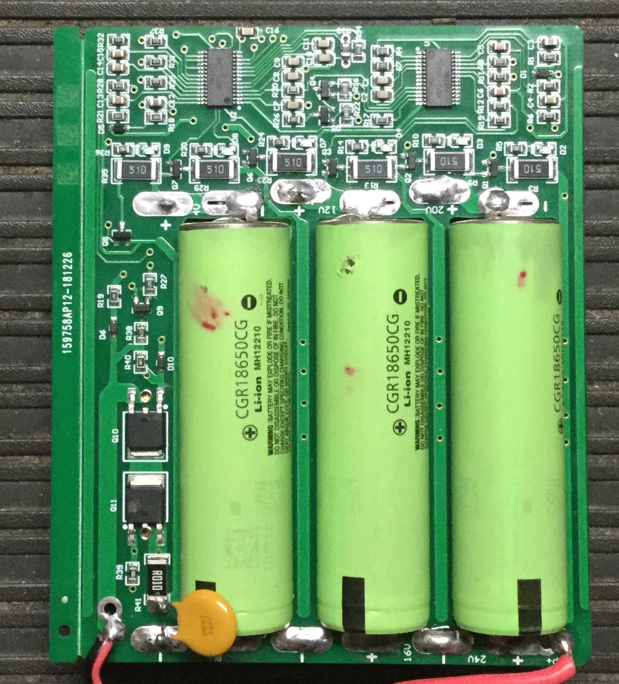

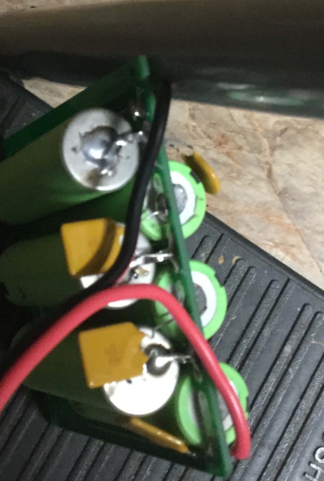

    Here is how I test this board as follows
    One I installed new 18650 Panasonic battery I have had a couple years
    All batteries had a battery voltage of 3.6-something
    Put it on a bench power supply set at one amp worked for about an hour then the balancing board LED started flashing on one battery then on another battery then back off the amperage down to .75 amps then about half hour the same two balancing LED light started flashing again back off the amperage again down to .5 amps 15 minuets later had to back it off again to .3 amps then a couple more came on then one side changed faster than the other side
    Because one side of the charges faster than the other side does the charger turned off and charging on both sides stopped
    When I put a MR16 light bulb and brought the battery voltage below 4.0 volts the charger started charging again until the battery voltage came back up to 4.0 volts again I had to do this several times before the other side was basically at the same voltage
    Then I put the charger rate at .030 amps until all balancing LED lights were all ON and the charger had changed all batteries to 4.0
    The next test I going to do is to put a load on this BMS board until the board shuts down the power output then check each battery voltage to see how well it works

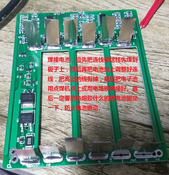

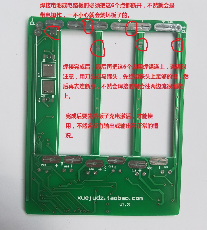

    To set this board up to work took some work there NO data sheet for this board that I could find
    There are three jumper pad under the battery stack that you have to jump together
    There is a positive power rail that has to be jumped
    There is a two jumpers for two sets of three batteries for each side
    There is a jumper to turn on the charging /discharging circuit to turn it ON
    • Jul 2011
    • 6065
    Re: KSGER Battery BMS charge battery board review
    One note about when all battery voltages gets 4 volts to completely change each battery to the same exact value I set bench power supply to .003 amps and leave for a long time before all the balancing LEDs turn off and the charger finally finished charging
    I realize that I should have have changed each battery first and load test each one for milliamperes hour rate results
    But the reason I did not I want to see if BMS Balanced Board could handle this type condition results are the following
    On a scale one being ( does not work at all ) and ( ten could handle any condition you could give it ) I give it less than a <— 5
    I would have given it a higher rating If I did not have to balance it my self to keep it charging that took few points from it
    But in all fairness I will do several changes / discharging cycles and see if the results are better

      I could only find more info in chinese and run webpage through google translate for some of it. https://item.taobao.com/item.htm?id=559209639154
      It's supposed to be a high performance battery management chip BM3451. R41 sets current limit at 10A.
      "The principle is that the first fully charged battery will discharge through a circuit (the indicator light will be on during equalization discharge), so that the circuit will not be over-voltage protected, and other unfilled batteries can continue. Charge until all is fully charged."
      "Note: The 6 indicators on the equalization board are equalization discharge indicators. Only when the battery reaches 4.18V, the equalization discharge may be started. When the battery is discharged to 4.15V, the discharge lamp will be stopped. The lamp will also turn off when the voltage is greater than 4.2V or 4.25V, and the charging switch will be automatically turned off. In the critical state, there will be flashing lights. This is normal. Generally, 6 lights in the full charge will be completely extinguished. However, sometimes due to the imbalance of the battery, it takes a long time to fully charge. Generally, the battery is only required. The group voltage is above 24.6V, which can be considered to be full and the battery is basically balanced. It is normal to have a voltage difference between zero and a few V between the batteries. In short, the specific working mode of the chipset is a bit complicated. If you want to know, you can look at the chip manual of the chip BM3451."

          I have had the load about 1.0 amp load it has on for about 4 hours and still going
          CGR18650CG Panasonic Batteries
          So will have to wait until the BMS Balanced Board shutdowns the battery voltage
            • Jul 2011
            • 6065
            UpDate
            It charged a lot better this time I did not have to help with a MR16 light bulb this time and the voltages are lot closer together
            The cut off voltage is 3.something volts but the battery voltages were all over the place not even close to each other———>
            But I had to do something that should ONLY done with caution
            ( this is a disclaimer warning )
            I used the MR16 light bulb on each cell unit each cell voltage with a load was about 1 volt and with no load about 2.something volts then very slowly charging at 100 milliamperes until the voltage on the hole battery pack was at 20 volts then went to 750 milliamperes until it was full charged
            This is because some BMS Balanced Board are a pain in the ass to get all the batteries to become fully charged and sometimes it does not matter if the voltage values are not that close it just works when you remove power and reconnect the power and you should not see any current flow then you know that the battery is fully charged
            I have done this few times before with very good results but should only be done a few times and then leave it a lone
            Now my problem is finding a 150mm case to hold the battery pack and the soldering controller and the power supply jack in one case I found one but now I have to wait until the seller has a sale tomorrow

              The BMS IC datasheet says it needs many charge/discharge cycles to fully equalize a pack that is poorly balanced. High value balancing resistors like 510R on the KSGER battery board are 7.3mA delta per cell, around 3%.

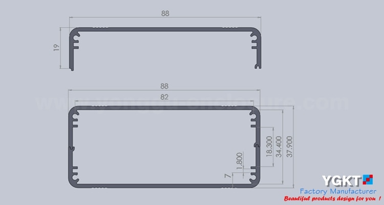

              Which enclosure are you looking for. The usual 88mm wide aluminum extrusion houses these T12 stations. It's not expensive if you don't mind cutting the holes. But the T12 version with holes punched is triple the price.
                • Jul 2011
                • 6065
                It the length of the case is the problem the 130mm is not long enough
                • redwire
                  • Dec 2010
                  • 3912
                  A T12 soldering station large enclosure is 130mm L x88 W x38 H for the 24V mains PSU and controller.
                  The 88mm aluminum extrusion is common in china and you can get longer clamshell pieces or custom cut to any length you like, and you keep your end plates.
                  But china seems to have stopped dumping aluminum products and the trade tariffs have driven up prices, shipping expensive- so no longer a deal.
                  I would ask vendors to price two long pieces.

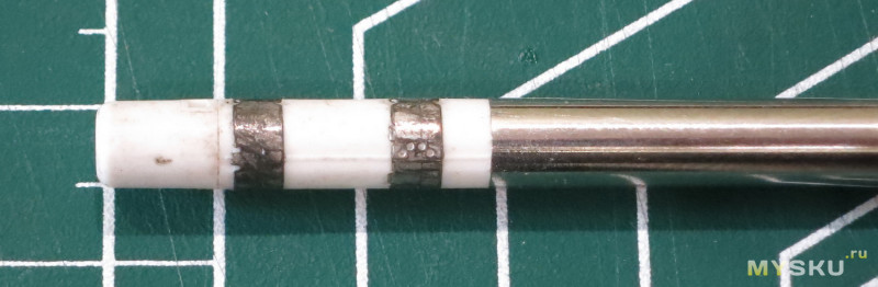

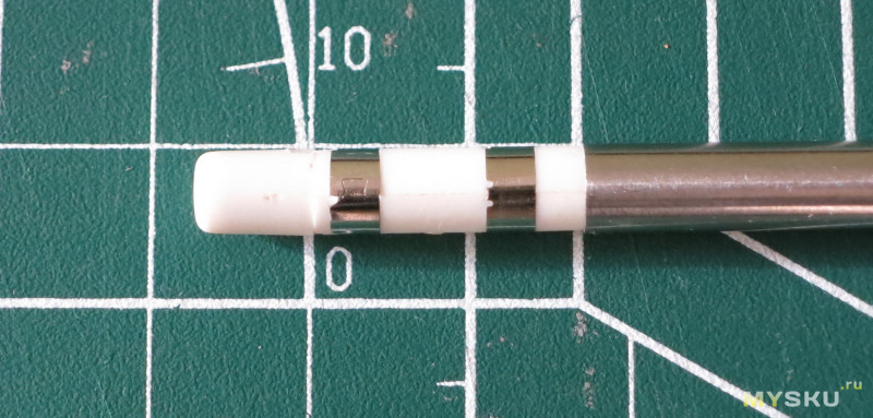

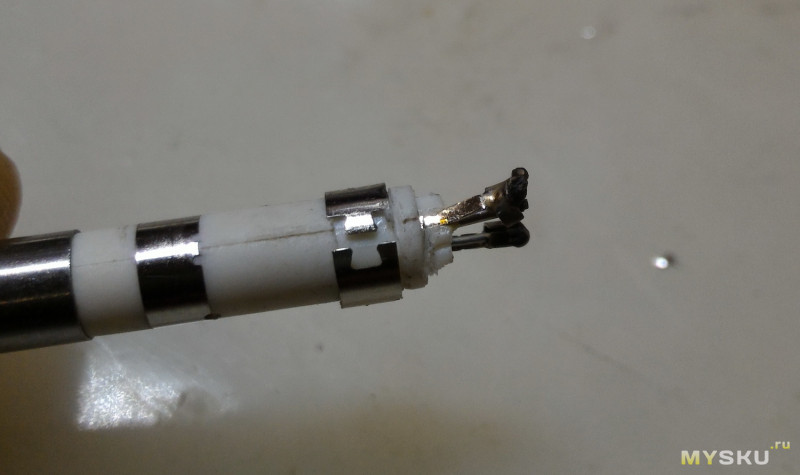

                    I got some T12 tips in that I bought from AliExpress and there behavior is a little odd
                    When you first power up the new soldering iron tip it shows the temperature / error then once it gets to 300c the error message stops flashing
                    Then if you power it down and let it cool down and then turn it back ON it does not flash the error message anymore but the temperature is all over the place at least 50c up and down but after a few minutes it comes to a more consented temperature
                    Then if power it down again and wait until it cools down again and power it ON and then the temperature is very consistent after that
                    What up with this

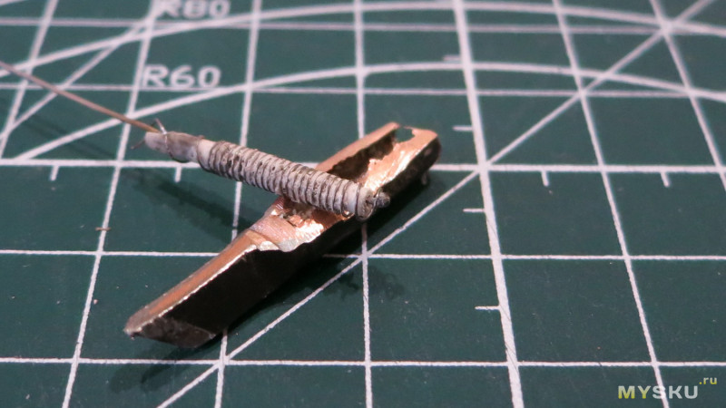

                          It sounds like a bad connection inside the tip/heater that goes away once it is hot. Like a dud (contaminated) spotweld/crimp inside.
                          T12 "ERROR" is when the thermocouple amp sees a fake silly high temperature. The stupid controller design is missing a 1MEG pullup, so noise can make the readings go all over the place with ERROR flashing at random if the tip/heater goes open circuit.
                          A dirty connection can give an intermittent extra thermocouple junction - say +4mV there could peg the temperature over 450C.

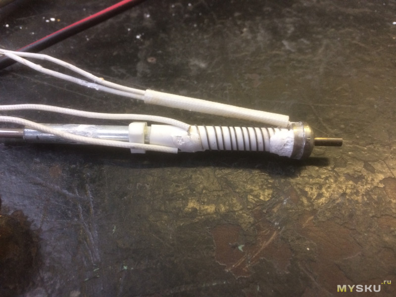

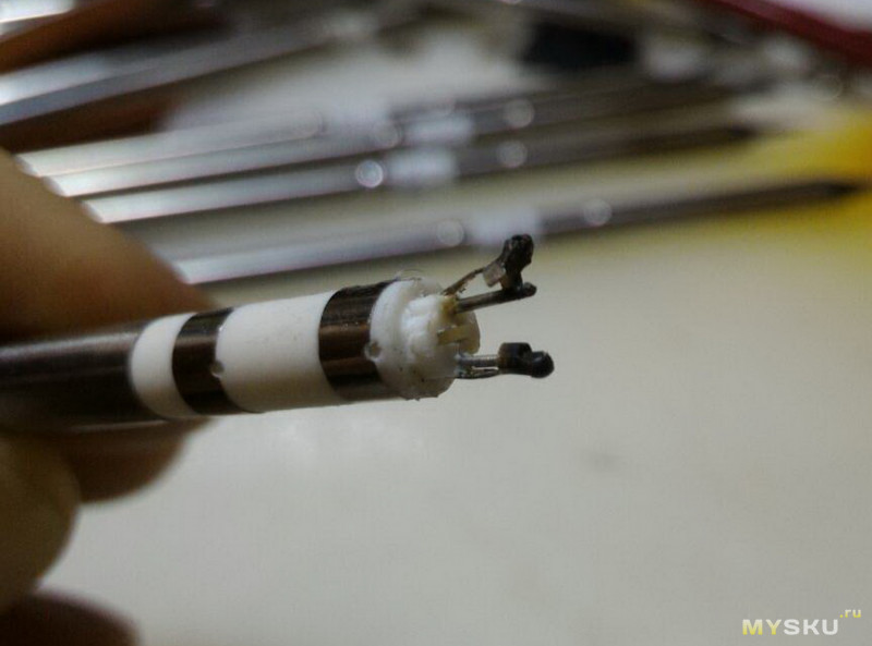

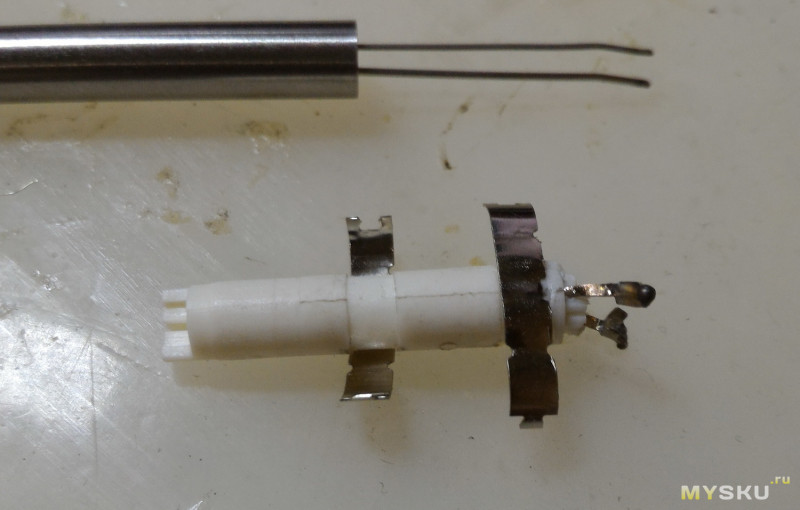

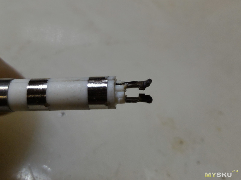

                                  OP gets bad thermocouple readings yet can drive power through the T12 heater, and the two are in series.
                                  What kind of connection is an open but not an open? This is what makes it confusing.
                                  A thin layer of oxide and crud can rectify (i.e. audio connections that sound distorted) at low currents but higher currents seem to punch through. I see connections that are bad at low currents and voltages, but work fine at high current.
                                  I think this is what he is seeing. Or he has the tip with extra thermocouple inside (four wires pic, might be JBC) instead of the one spot weld forming the thermocouple junction at the tip.
                                  The T12 tip collars seem to be different quality, the crimps seem to be another place for bad connections.
