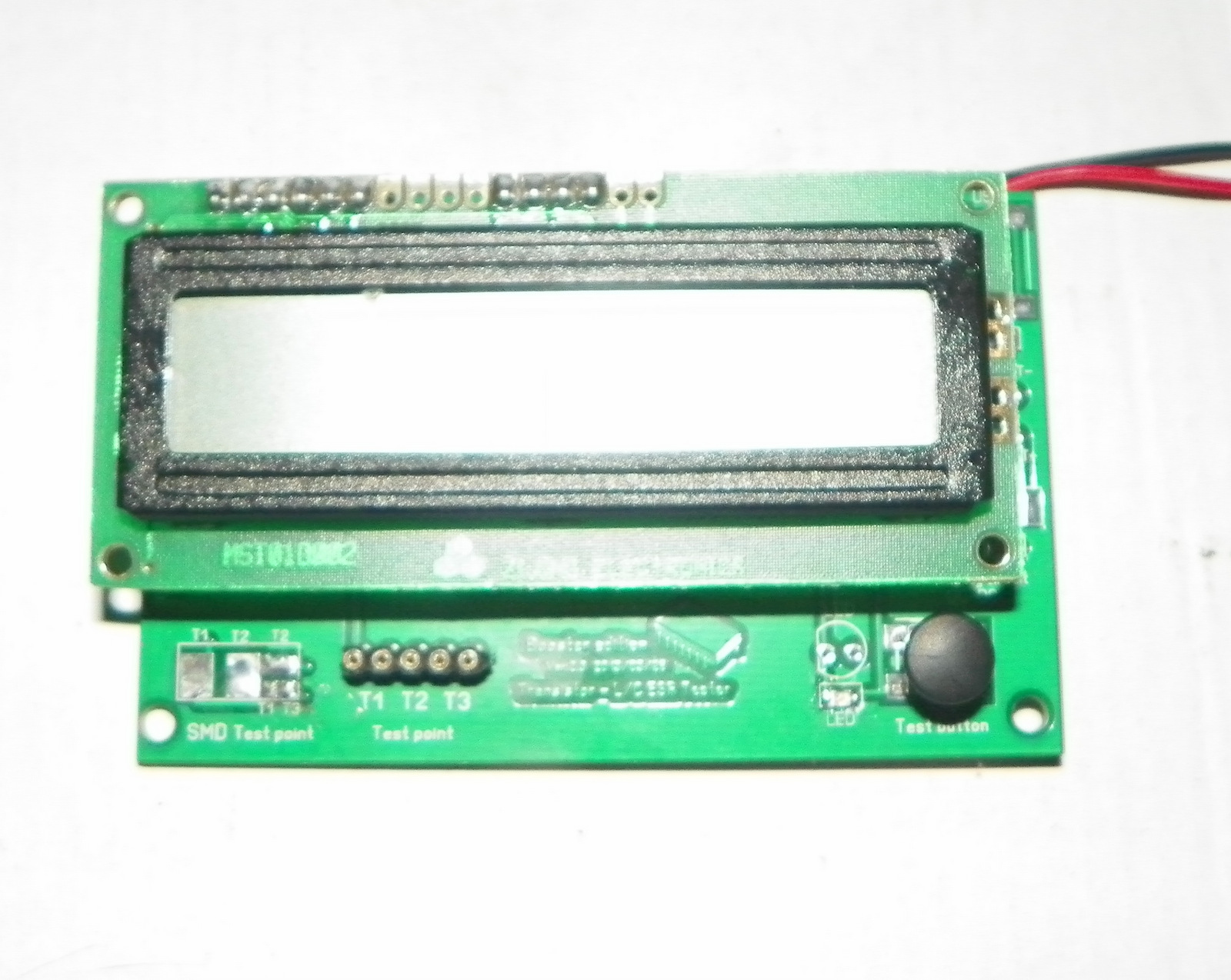

                          I just received this New-Transistor-Tester-Capacitor-ESR-Inductance-Resistor-Meter-NPN-PNP-Mosfet tester yesterday. So far it seem to be a excellent little tester. I mainly purchase the tester for testing and to help I.D. unknown SMD transistors and MOSFET. and so far it does just that.
                          testing caps and the ESR of the cap also work great. its display both value.
                          but on large caps like 470uF you have to press the test button 2 or 3 times to get the ESR value.
                          all other components get tested with no problem
                          the only bad about this tester is that you may need to solder three test leads. The surface mount test point works great, but the other test point where you insert the components leads into the test post doesn't accomdate all components leads, some components leads wont fit into the hole.
                          I have an Wavetek Multi-meter 27xt and a Blue ESR meter to compare reading. the reading where the same.
