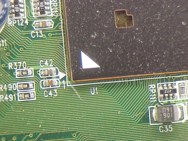

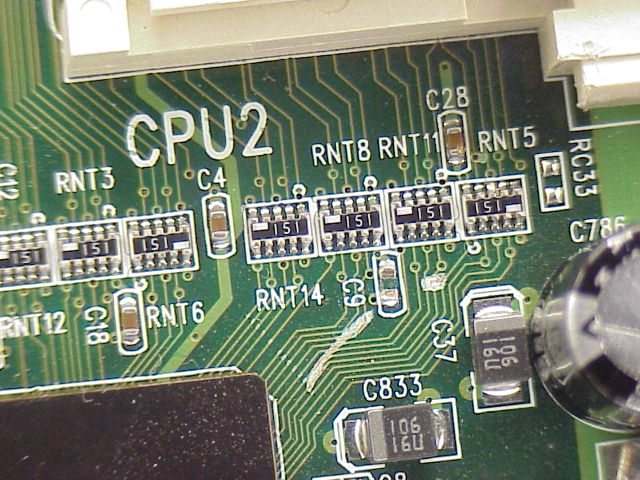

    sometimes bad caps are not the only problem.
    careless end users sometimes wreck boards beyond cost effective repair.
    careful when installing the hsf!
    looks like this board was treated like garbage before it got to topcat and it is easy to see why it failed to post after he recapped it.
    btw this WAS a supermicro 370dl3 dual p3 with scsi.

    what a shame. so many traces. can be repaired but it will be a fucker to do all that. two times dammit, confiscate the screwdriver and chop off the hand.
      I have seen MANY MANY VP6's (and many others as well) with SM components knocked off, stab wounds, cut traces, all from careless handling. Some people need not touch computers!

                yup, if it scratched a trace but it depends how deep. there is possibility to fix it though but it is quite difficult ihmo.

                  Looks like that board was "insulted" even more than twice - two are the most obvious, but notice the stab mark after the 45 degree bend the traces take, going left from C45... if the trace is completely severed, even a single hit like that in such a position (leading to the MCH) can kill a board.
                  The incident around CPU2 in the second picture was so violent that it slashed all the way through C9 and broke three traces on the other side. The guy/girl in question must have forgotten to take his/her Ritalin that day.
                  ngorge: As Will mentioned, most traces aren't carrying that much current, so even if only part of the trace remains, the board should perform fine. Mechanical damage is particularly lethal to motherboards and not always repairable (not just motherboards, its 'deadliness' tends to be underestimated in the case of chips and the human body too, but that's another issue ).

                      They could all be jumped but it would take some time and a small bottle of Jack.
