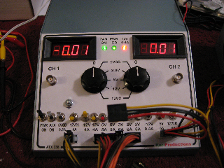

    Hello.
    I noticed something.
    There is a shortage of test equipment designed to accurately test ATX Power Supplies.
    At the low end, there's the ULTRA brand go/no-go voltage tester that's pretty useless. At the high end, there's SunMoon and higher.
    In the middle, well, there's nothing! Well, at least I couldn't find anything.
    Until now.
    Introducing the KeriProductions ATX338 PSU Load Tester. This is a two-channel load tester, allowing scope output and voltage display of two different circuits at once. The load resistors are switched via a bank of toggle switches. The ATX ON switch is interlocked to the POWER/FAN ON switch so that the fans must be turned on before the PSU can be activated.

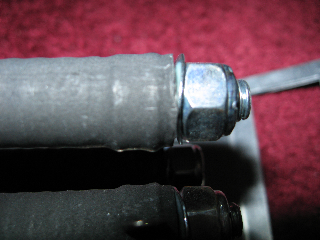

    It is based upon industrial wirewound resistors of 3Ω/50W for the 12V+, 1Ω/25W for the 5V+, .5Ω/25W (20w for now) for the 3.3V, a 10Ω/25W for the 5V standby and a 30Ω/25W for the -12V. The total wattage comes out to around 338. Which should be high enough for testing low to mid power PSUs. Extra space remains for two more resistors. They are mounted to the case with simple Carriage Bolts and have some wavy washers to allow for expansion.

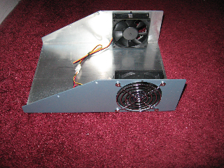

    The resistors are rated for temps up to 350C but derate rapidly over 50C The two fans appear to keep the resistors under 60C. (with the help of a borrowed infrared thermometer)
    Load testing was done tonight with the help of a recapped TruePower 380. I have not yet wired the Voltmeters or scope outputs, but did verify that the fans run, a fair bit of heat is generated, the indicators for Power, ATX Power Good Signal and the rudimentary -12V load indicator all function.

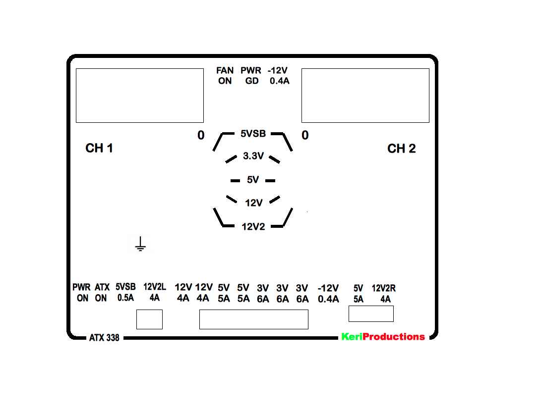

    Configuring the Velleman LED displays was an adventure, but I got them set for the 0-20V range with voltage dividing resistors despite the instructions written for people a lot smarter than me.

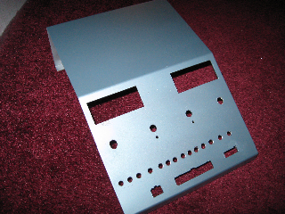

    The casing was just a case that I picked up at Fry's. After drilling a GAZILLION holes in it and grinding out the rectangular holes with a Dremel tool and a file, I painted it with high temperature paint. The Label was created with OpenOffice DRAW.
    The next step is to wire the selectors, voltmeters and scope outputs. As I understand it, decoupling caps should be attached to the scope terminals inside the case.
    I should have it finished up this weekend.
    Any comments or suggestions are welcome.

          Hello.
          OK!

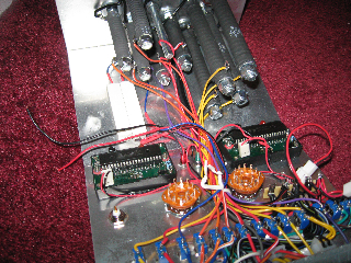

          I got the Load Tester 99.9% complete. The .1% is that I "forgot" to connect the decoupling caps on Channel 2. Oh, and 1 of the 5V resistors isn't here yet.
          So...... Off to some load testing. It works! The panel meters conveniently display voltage, the scope outputs provide signal to my scope, the fans make a reassuring drone, hot air comes out of the left side, .... in short, it does everything I expected.
          Wow, do those decoupling caps make a difference!
          On CH1 the readings are as expected, with a sawtooth ripple pattern. It gets more ripple as load is increased. The 10uf electrolytic and .1uf ceramic caps are in parallel right behind the BNC connector.
          On CH2 without the caps, there's those giant gnarly spikes all over the place. Even on the 5VSB with the PSU running. With the PSU off, the 5VSB is pretty clean, but not as clean as CH1.

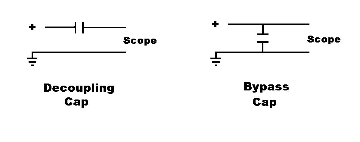

          So here's my questions:
          The decoupling caps affect the readings a lot. Aren't they distorting the signal?
          I have the scope set for a 1x probe. Is this correct for this application? The scope signal is taken from the back of a rotary selector switch that is exposed directly to voltage taken from the ATX connectors, before the load switches.
          The case (and BNC connectors) is grounded to the PSU ground wires. The power for the meters and fans is provided from a 9v wall adaptor and is completely isolated from the ATX circuits and grounds.
          If I put a "Warranty Void if label is removed or damaged" sticker on this thing will Oklahoma Wolf come snooping around with an insatiable desire to void the Warranty?

            Re: KeriProductions ATX338 PSU Load Tester
            Yeah. They're supposed to simulate motherboard filtering.
            Give it a try and we'll see

                How are the caps installed?
                I think you are using bypass caps and calling them decoupling caps.
                Decoupling caps would not simulate motherboard filter caps.
                Or rather. I don't see how they could.
                  Yes.

                    Oh! PCBONEZ, Yes, they would appear to be Bypass caps, not Decoupling ones. I read "Decoupling caps" somewhere relating to this application and adopted it without researching what "Decoupling" means in this instance. Thank You for that correction.

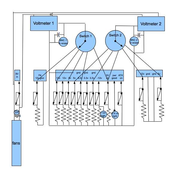

                      OK, here's more details and a schematic:
                      The KeriProductions ATX338 PSU tester is a simple set of switched power resistors cooled by two fans.
                      The resistors are all connected to the ATX, P4 and Molex 4-pin connectors through a bank of switches at one end, and a common Ground bus at the other end. Two resistors for -12v and 5vsb are considerably smaller than the others and are merely glued to the housing to dissipate heat.
                      The ON switch is actually DPDT (not shown in the schematic) with one pole running the fans and voltmeters while the other one is wired in series with the ATX ON switch to reduce the chance of running the PSU without the fans running. A fan speed, airflow or temperature sensor should really be added to stop the PSU as well.
                      The ATX ON switch pulls the ATX signal from the PSU to ground, thus starting the PSU.
                      The three indicators are "12v and 5v" LED types with built-in resistors.
                      One runs off of the 9v for the meters and fans, one is driven by the PSU's PWR GOOD signal, and the third is wired in parallel with the -12v resistor just to see if there is -12v present.
                      Two voltmeters with BNC outputs have their own rotary selector switch.
                      This allows testing of two circuits at once while using a dual-channel oscilloscope.
                      The voltmeters require 9vdc on a separate circuit to operate which is provided by a wall adaptor that also runs the two 12v cooling fans at a somewhat reduced speed.
                      The BNC outputs have two small capacitors each, a 10uf electrolytic and a 0.1 ceramic disc that emulate being connected to a motherboard and seem to be necessary. Thanks to Oklahoma Wolf at JonnyGuru for that tip.
                      And, Oops! the 2nd one isn't shown on the schematic.
                      No Ammeter is provided or needed. The resistors are of fixed values and adequate wattage. So long as the cooling fans keep the resistors under 50-70° C, (verified with an infrared thermometer), current will remain fairly constant as determined by voltage / resistance. (Ohm's law) For my reference, I printed voltage and amperage at each switch.
                      My theory of PSU testing is that the PSU need only be partially loaded to get an adequate measurement of voltage, ripple and noise.
                      It's not as dramatic as JG's SunMoon maxing out the latest PSU until it screams or explodes but I just want to test under normal loads and conditions.
                      Few computers fully load even a modest 300w PSU which this tester can (and has) overload, and a reasonable assessment of condition can be had at half power on most systems.
                      As my tester is completely manual, one must be careful in choosing how to load a PSU. Overdoing the 12v on a cheap or ancient PSU that favors 5v and 3.3v can kill it right there as can overloading the 3.3v or 5v on more modern, primarily 12v models.
                      Never depend on overload protection to work!
                      It's no fun at all to explain to someone why their PSU died during testing.
                      Fortunately, I haven't had to do that yet except for myself.
                      Have Fun!
                      Keri
                      Created and posted entirely on a Mac Pro with OODraw
                      The More You Learn The Less You Know!

                                      As for the digital vs analog thing- you could integrate what I put in my PSU tester... What I am suggesting (for your unit) is to use analog displays and have bannana jack output and a switch to connect a DMM to (if you needed a digital readout).
                                      all my psu tester is is a little device that has an atx plug, 2 6 position rotary switches, a power switch, 2 banana plugs, and a probe. what it does is it can be used to start a psu and once external load is added (if desired), you use the 2 rotary switches to set the testing voltage which is sent to the v+ banana plug. the common banana plug is always connected to ground.
                                      settings:
                                      rotor 1:
                                      1. 12v+
                                      2. 5v+
                                      3. 3.3v+
                                      4. Rotor 2
                                      5. Probe
                                      6. Ground (both plugs to ground
                                      Rotor 2:
                                      1. 5vsb
                                      2. PWR good
                                      3.12v-
                                      4. 5v-
                                      5. unused
                                      6. unused
                                      the test socket fits 20 or 24 pin sockets. anything not on the 20 pin part (4 additional ins, sata, molex, p4, pci-e, etc) you use the probe to test.
                                      to go with it I may make individual load units... they would plug into molex/p4/pci-e plugs and be used to give the amount of load that is wanted tested and how much on each rail (one molex unit would have just 12v, another would have just 5v).
                                      sigpic
                                      (Insert witty quote here)
