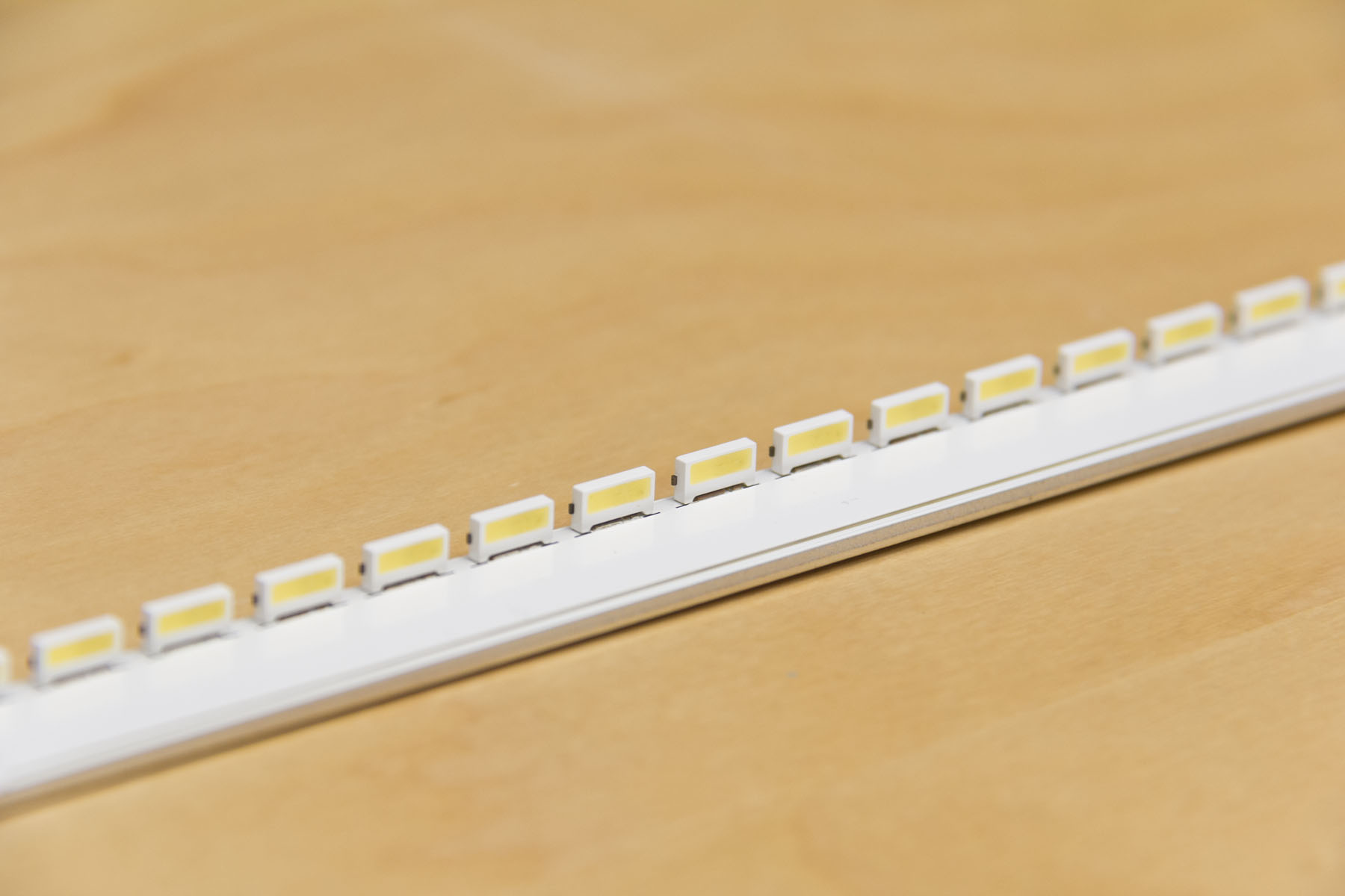

    I am working on one of the LED strips from UN55E6150, that has the LEDs that stick out, see attached image.
    I have played around with similar LED strip some time ago with no real success.
    Going at it from the top with heat gun melts the LED chip and its neighbors.
    Going at it from behind does not seem to heat it up enough to melt the solder.
    There is not enough room with the soldering iron to go at the solder points on the bottom of the chip.
    How do I go about removing and replacing one of those?

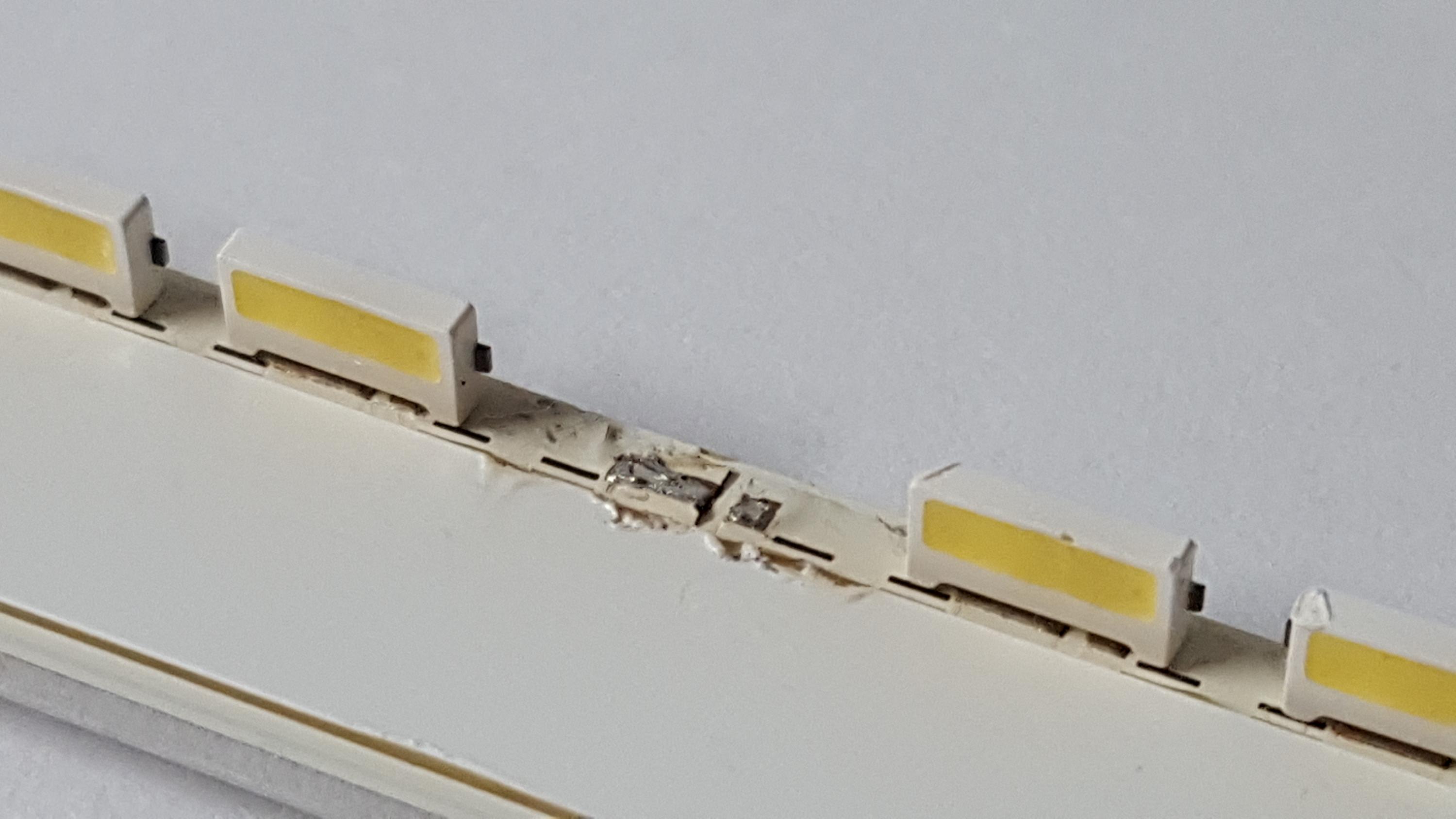

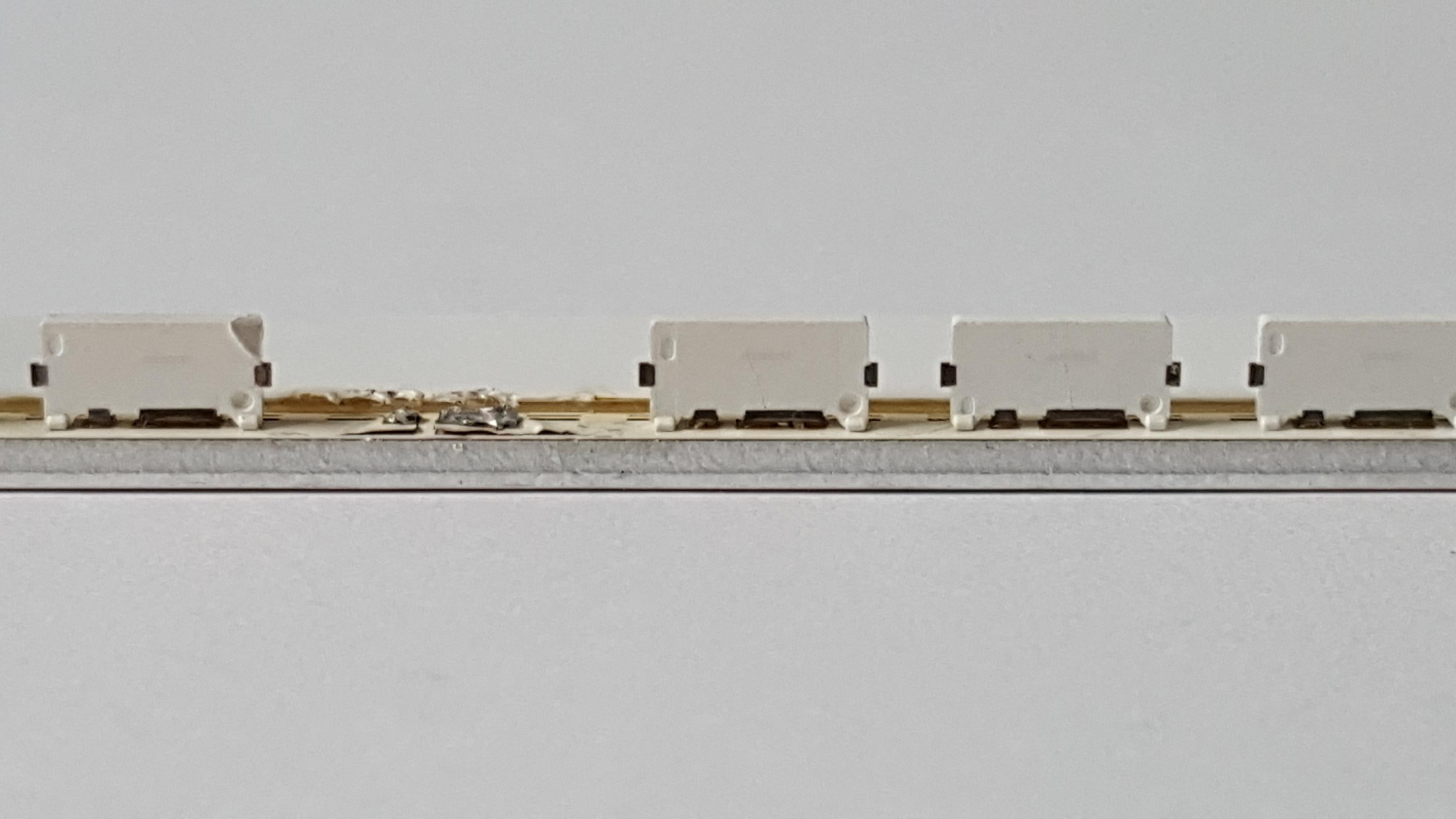

            Well, I done it, sort of.
            My failed attempts included: I have covered the adjacent chips with aluminum foil to depreciate the heat. I have blasted it with heat gun from the top and all it done was melted the plastic on the chip. Did not even loosed the solders on the PCB. I tied heating it up from the back with 350C, however the PCB is aluminum, which conducts heat really well. I was keeping the heat gun on it for 5 min until I stared to notice that the top of the LED strip itself began to warp and brown, but the chip was still on there strong.
            What I ended up doing: There is a mild gap between the PCB and the LED chip. I have taken my skinniest soldering tip and flattened it to roughly the same height. "soldering shovel " I have cracked the solder to 11 and jammed it in there. After several sweaty seconds, it came loose. See the pictures for results. Not my best work, but it worked.
            My replacement LEDs are still in mail. I will make an update to conclude this pain is the ...
