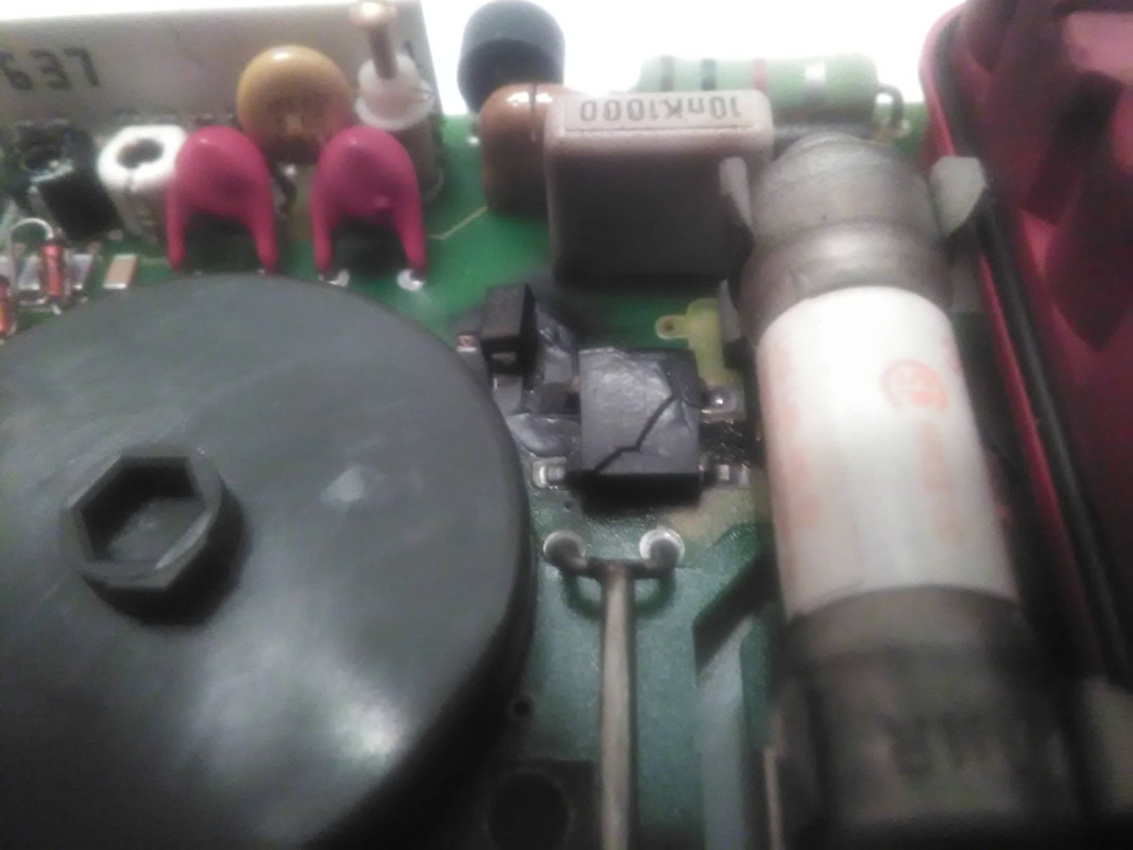

    Hi there!
    I replace caps for a living, but recently decided to try and fix a multimeter I picked up at a yard sale:
    Fluke 87-III
    It is in surprisingly good shape, needs a new battery door and case perimeter seal, seller told me it was operating intermittently.
    so I took it apart and two components are burned which I believe are the following:
    U1 - diode, SI, rectifier, bridge (4 pin chip) -burned beyond recognition (on regular 87 - this chip is BV=50V, IO=1A, p/n DF01M - not sure on 87-III)
    CR1 - diode (marked LTp01 S1G) - (1N4007 is used on regular Fluke 87)
    and one of the mainboard traces connecting those is lifted off, will need to be replaced with heavy wire I reckon
    everything else looks great including beautiful white backlit display
    apparently, some Beavis used cheap fuses rather than the correct Fluke/Bussman fast-blow and then tried to measure high voltage with the cables plugged into amps jack
    any advice on what components I might want to order at digikey? - or just any general advice?
    I fix engine computers (ECU's) so I have pretty good experience and equipment including Hakko FM-202 solder station as well as Hakko 850D hot air rework station.
    This meter also needs a good battery door and it especially needs the main rubber seal around the perimeter of the case if anyone has an extra used one. (I have PayPal!)
    thanks!

    Re: Need help on Fluke 87-III mainboard repair
    Do basic functions like volts and ohms work fine? Are measurements close to another known good multimeter?
    I don't have a Fluke 87 III (would love to have one again some day), but others do and may be able to contribute some info. I may have some high resolution pictures saved somewhere? I will have to look around.
    Let's see a picture of it and where it is on the board.
    The latest versions had the white backlight whereas the earlier versions had a green one.
    Yup, they need to be the proper fuses.
    Once the components are identified, clean the area with a generous amount of IPA and remove any carbon residue as it conducts.
    I see them on sale once a while on ebay. At $30 USD, it is way too expensive for my liking.

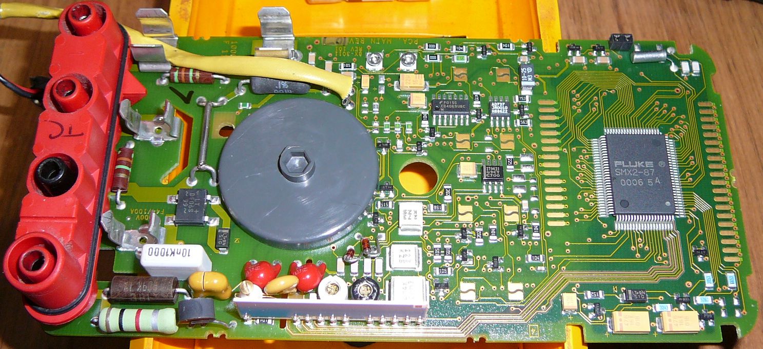

              • retiredcaps
                • Apr 2010
                • 9271
                According to pictures in this thread.
                http://www.eevblog.com/forum/repair/...ii-misbehaves/
                Picture P1120655 shows a S1G which is 400V maximum repetitive reverse voltage and DF06S as well like my Fluke 85 III. That matches your post #1 part.

                        • retiredcaps
                          • Apr 2010
                          • 9271
                          Picture P1120655 shows DF06S.

                            • retiredcaps
                              • Apr 2010
                              • 9271
                              what is significance of S1G ?
                              and are my selections at Digikey ideal?
                              The last letter denotes maximum repetitive reverse voltage. I would stick to the original that is in the meter and avoid any "upgrades".
                              In post #4, I gave you the link to DF06S. So buy S1G and DF06S from digikey and you should be good.

                              • theOracle
                                • Nov 2012
                                • 163
                                thanks for EEVBlog pics - that is exactly the meter I have!
