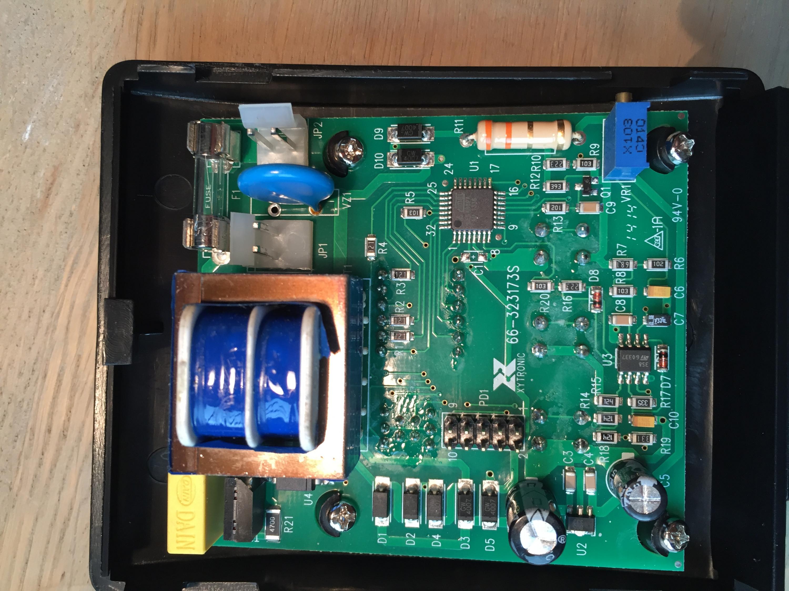

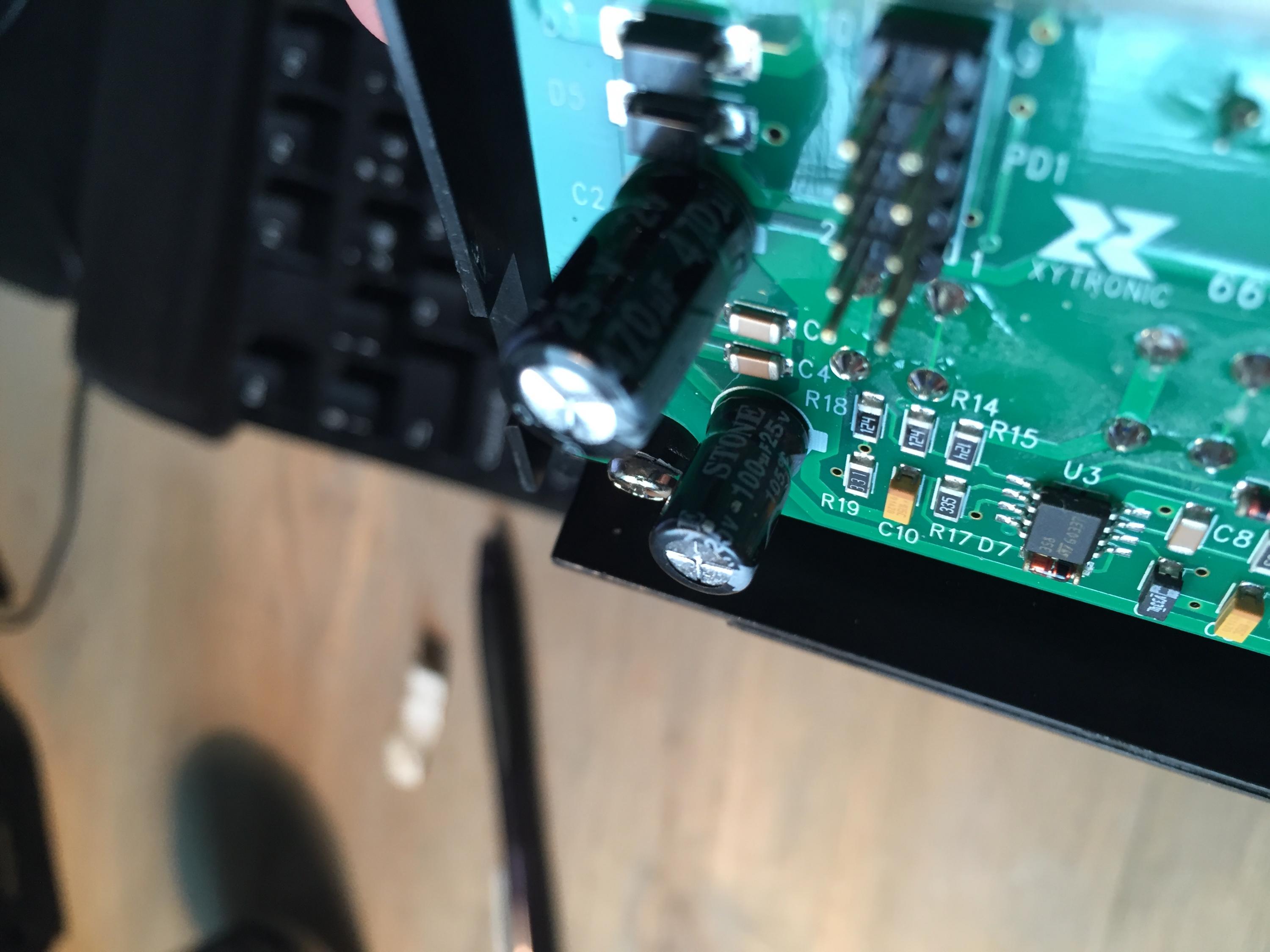

    Hello!
    Some time ago I got myself a new soldering station as I was planning to start doing some more soldering. This soldering station is mains powered so is probably not the best but it seems miles better than my old cheap one. I have not really been using it much, but I read that the Xytronic stations have bad caps so i decided to open it up.

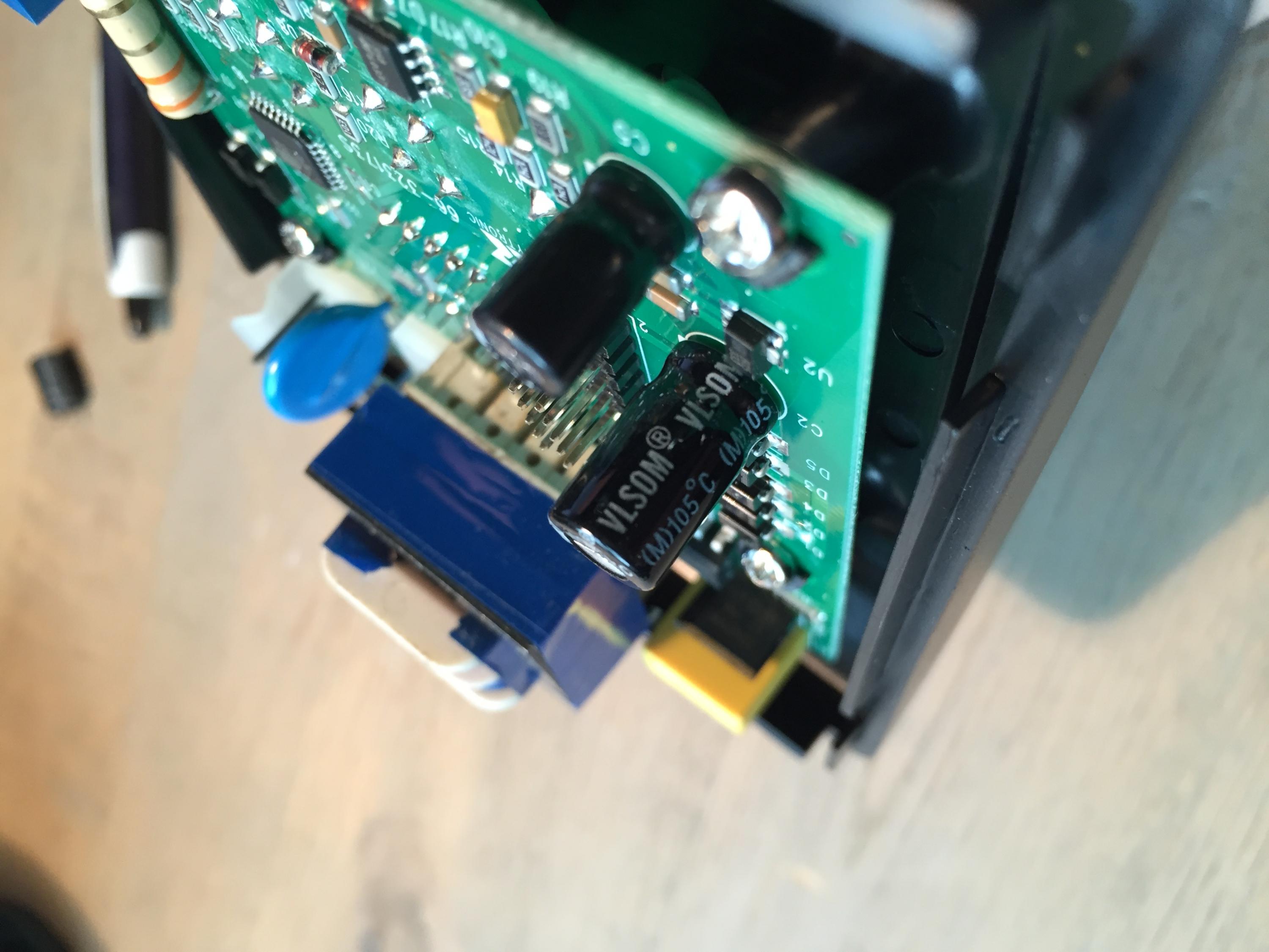

    So as far as I can see there are only 2 caps:
    VLSOM 470 uF 25V
    STONE 100 uF 25V
    So the question is if I should replace them with something better? If so what would you recommend? I can get Rubycon and Panasonic quite easily. See the attached pics for more info.
    Any input is appreciated!

    I would go with replacing these units with something better; even though my preferred brand of electrolytic capacitor is Chemi-Con, Rubycon and Panasonic are just as good.
      • 30991
      Re: Xytronic LF-389D capacitor quality
      if you choose pana, go with FR - lowest price & longest life
