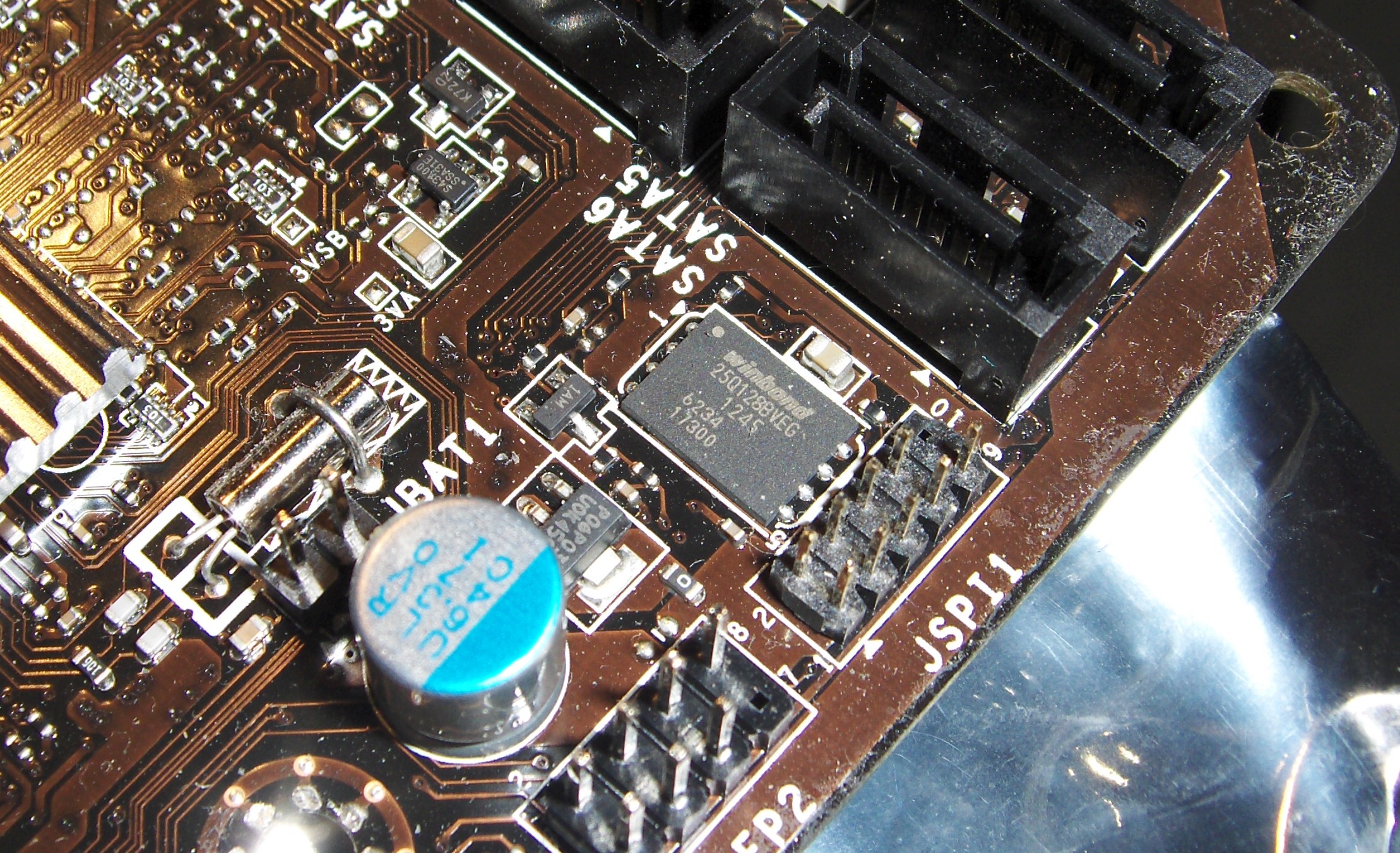

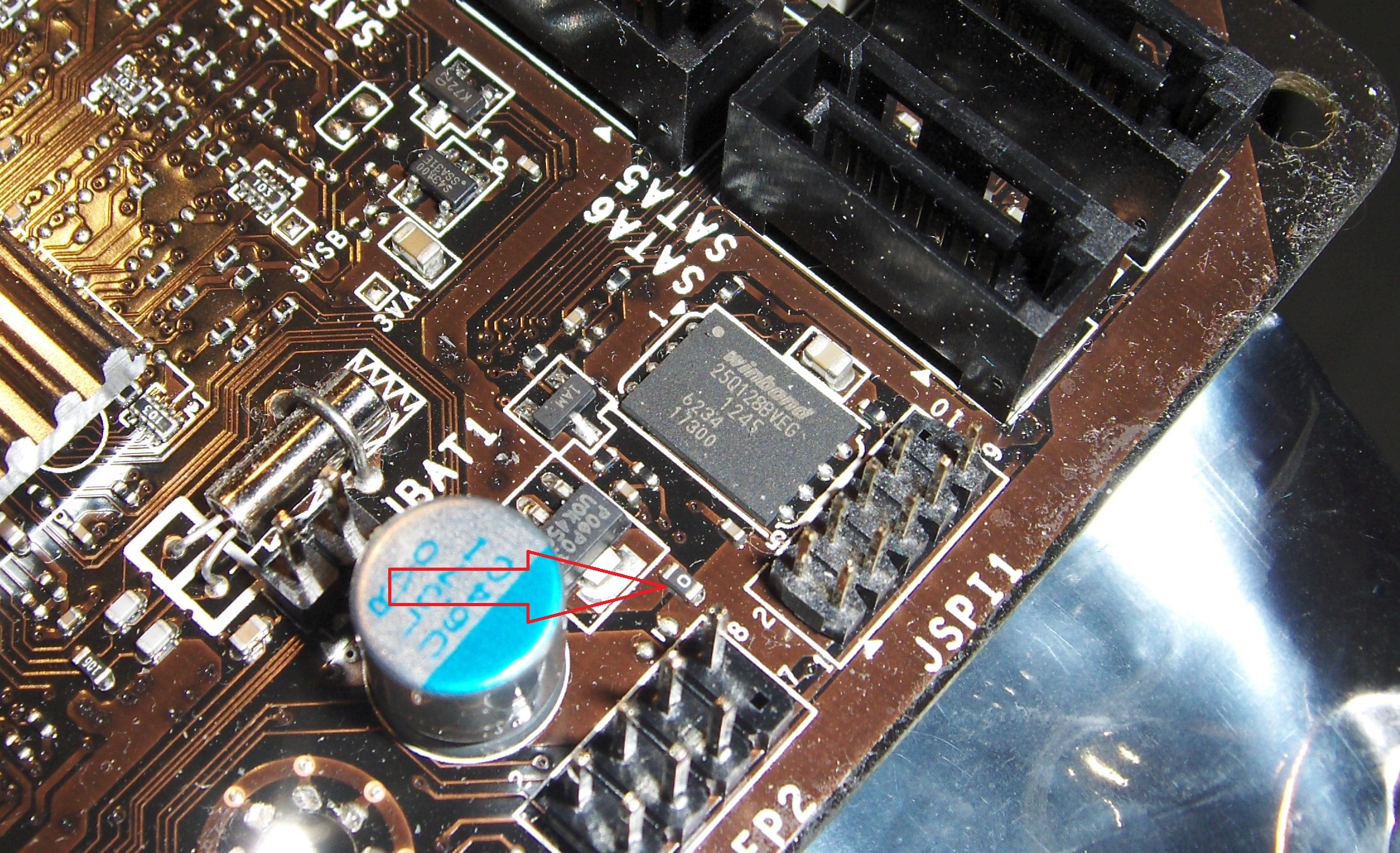

    CH341A and W25Q128BV
    I have a dead msi bord that needs to be flashed, board has spi connector below the W25Q128BV wson and I'm looking to buy a CH341A but I'm unsure if I should buy the simplest or the latest version. Latest version has the isp connector that I can hook up to the spi connector on mb.
    Should the mb be powered by atx when flashing or am I way off ?
    • 31044
    Re: CH341A and W25Q128BV
    the cheap black programmer can do that,
    but make sure that connector in the foto is actually linked to the flash and not for something else.

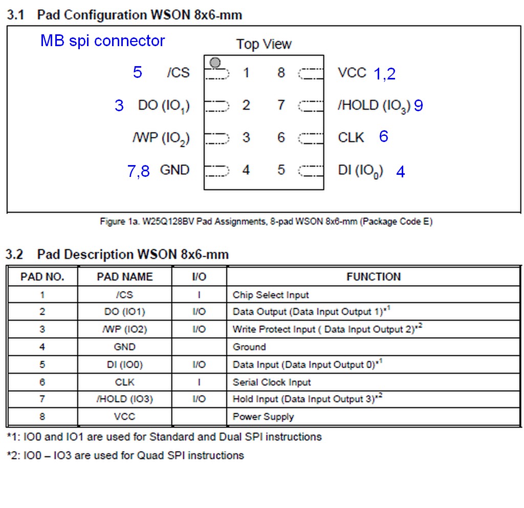

      It's hooked up to the W25Q128BV alright, every pin but wson pin3 write protect IO2 so I guess perhaps the mb is setup for standard and dual spi instructions.

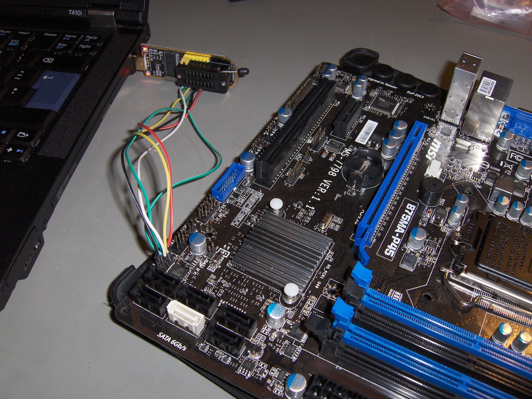

        no issues then.
        i happen to have a black programmer in my hand.
        the connector pinout is this:
        1 - CLK
        2 - CS
        3 - MOSI (DI)
        4 - MISO (DO)
        5 - GND
        6 - 3V3
        7 - 5V
        so you just need the first 5 pins - power the motherboard before you flash it.
          Ahh thanks, why should I power the mb before I flash it ?
          Should the atx psu be connected or turned on before I flash it ?
            • 31044
            connected and turned on.
            the flasher cant power the chip because it will be connected to a lot of other parts on the mobo.
            • Gabriel
              • Jan 2010
              • 620
              • Norway

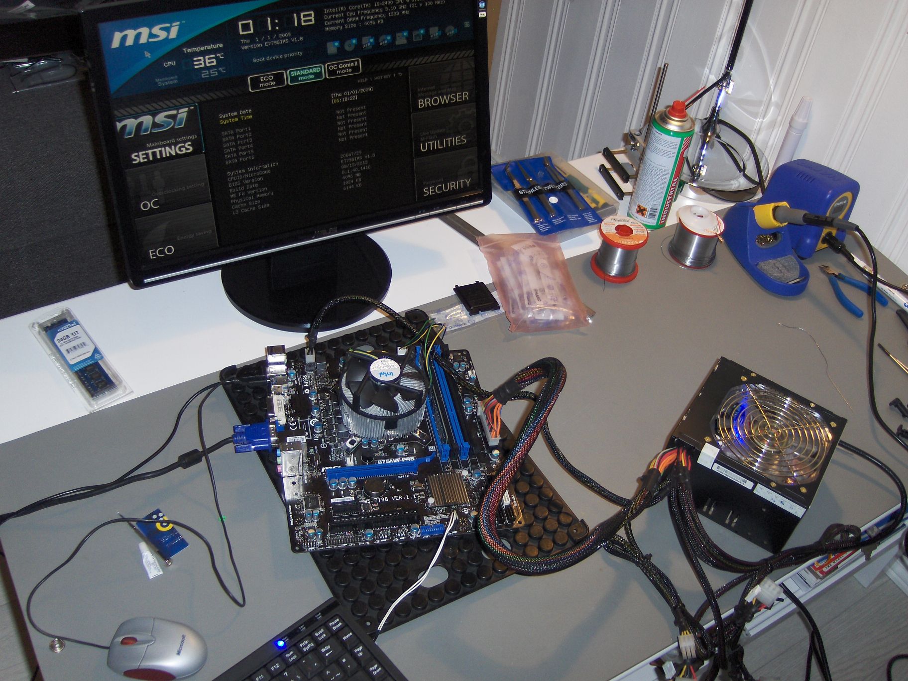

              Had som spare time today to have a look at the mb - mb would not turn on and stay on. It kept restarting every 2-3 seconds so impossible to flash chip.
              I removed the 0 ohm jumper and gave bios chip 3.3v from programmer, used sw 1.18 without problems.
              Mb now working as it should
