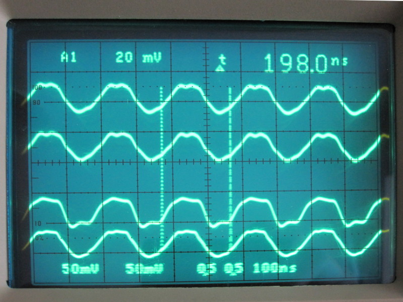

    For the heck of it and waiting till I perhaps fan find a hamfest that are selling real Tek probes, I got some chinaprobes to see how bad they were. These are "100MHz" 10/1:1 probes. I suppose I can keep them with my old VuData 20MHz, but wanted to see how bad they really were for my 300MHz Tek.
    Wow, not sure what to say about them. Perhaps I'm expecting too much and expecting the pink unicorn. And perhaps not an banana to banana comparison:
    From top to bottom are ch.1 to ch.4, and ch.1/ch.2 have full attenuators (set to DC coupling) with the cheap probes switched 10:1. Ch.3 and ch.4 have DC coupling only. Ch.3 has a RG174 with alligator clip wires and no attenuation. Ch.4 is a 1.5" piece of solid wire from the calibrator output to the input. (BTW, bottom of the screen are the attenuations for the 4 channels and the time/division. Top of screen is trigger source, trigger voltage, and time between cursor marks).
    Now I would guess that since all of the connections, especially the 4 ft of RG174U would add quite a bit of cap, but even if I disconnect it, the waveforms don't change that much, but it is noticeable. The two scope probes if disconnected do not affect the display at all, implying perhaps the 10:1 really is working.
    What I'm wondering is if the bad ringing should be tunable or perhaps that's the way it should be (I don't know how good the calibrator output should look.) The probe compensation adjust seems to be simply attenuating the signal and not affecting the ringing (I suppose the attenuation is not unexpected, after all, it is a short at high frequencies.)
    Am I using them all wrong, or is this what I get for having bad chinaprobes?

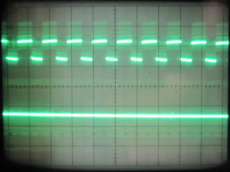

    And here's one of the probes on my Vu-Data using its probe calibrator:
    This time I guess it's clearly overcompensated/overdamped. Perhaps I'm running the Tek's calibrator a bit too fast? (Note poor Vu-Data is in chop mode...)

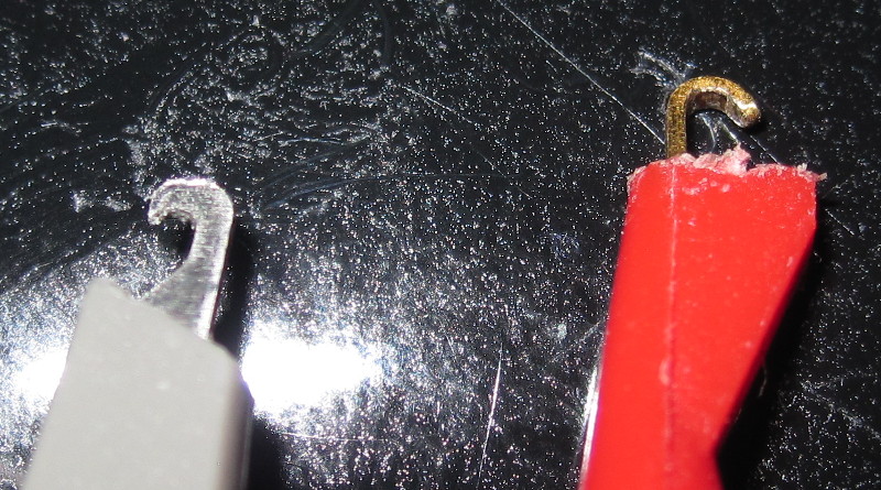

    BTW: I hate these cheap chinaprobes hooks. Every other hook I have is really "thin" - these hooks in these probes are really thick, making it probably impossible to hook onto through hole IC pins. The other spring hooks I have are "thinner"...

    Okay this was a very, very tough shot to do. Really need three hands to do this shot justice:
    Terrible. Though it is much "stronger" than the red hook, it's much less versatile.

      isnt that a bit unfair, repeat the test with the probes set 1:1 to match the other inputs.

                Yeah I need to find some way to measure rise time, I don't have any equipment to do that. The Tek scope *should* exceed the speed of the probe, or at least I would hope so - if not it needs some adjustments I ended up getting a set mainly because I did not have probes for my Vu-Data either, which these cheap probes *should* exceed.
                But yes I agree with stj - there are a lot of equipment snobs out there and use a 300MHz scope to test an audio circuit. Want to cut through that BS.
                My guess right now is that I'm far exceeding the intended bandwidth of the calibrator on the scope, or at least I'm not sure what the calibrator waveform should look like at 5MHz (the waveform is much cleaner at lower speeds as the calibrator speed tracks the time/division knob. My Vu-Data has a fixed calibrator speed so I could easily get a decent waveform that shows what I need it to show.)
