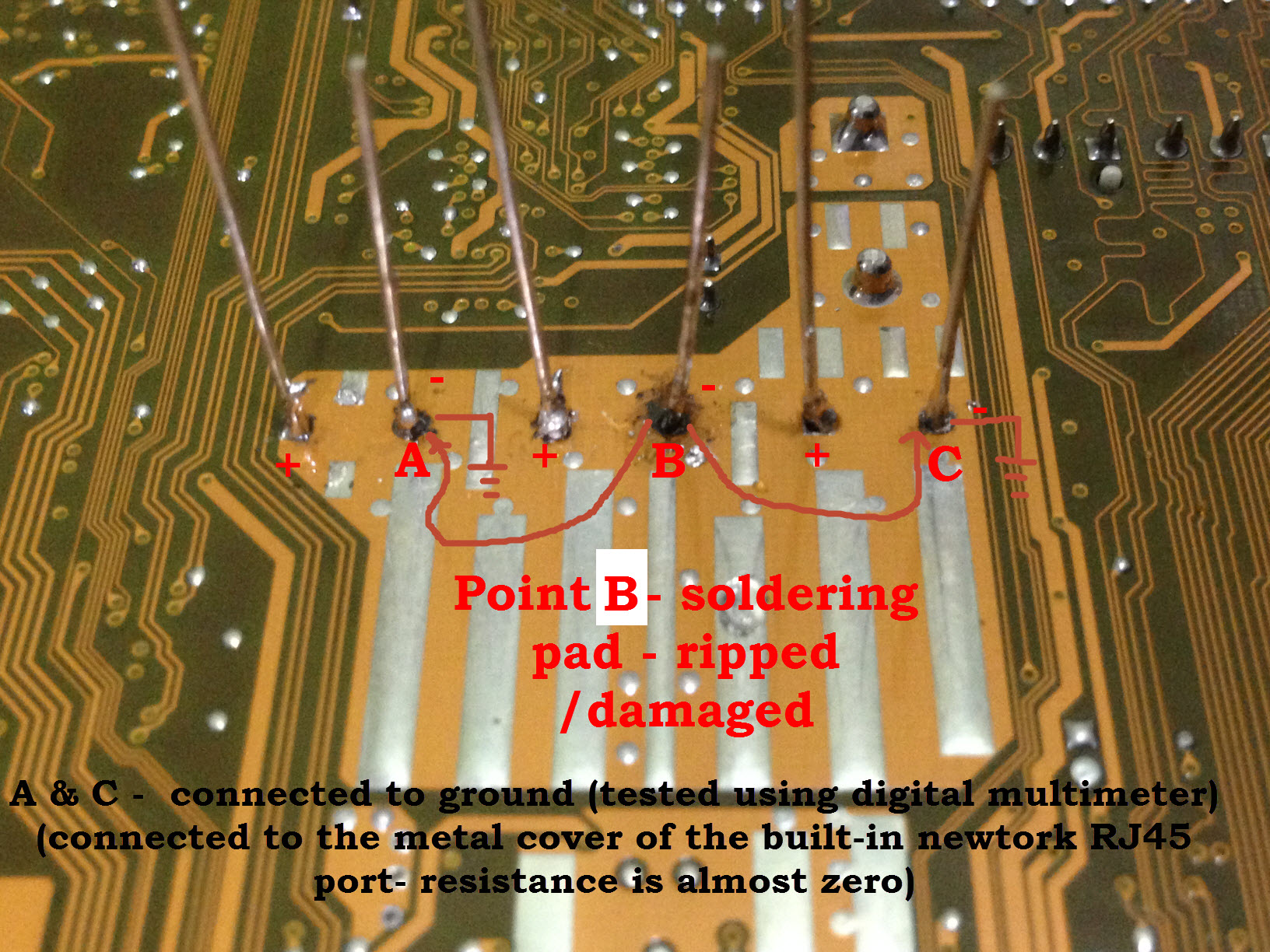

    Hi everyone,
    I bought the new capacitor kit from badcaps.net store few months ago, but did not have the chance to recap it. But now, I took some time off from my busy schedule and took some quality time in recapping this motherboard that I seldom used.
    As the title said it all, one of the capacitor soldering pad was damaged, or ripped off. Since this the "-" negative lead of the capacitor, and also I have checked ALL "-" negative leads of the capacitors for Voltage Regulator Module (VRM) is connected to ground rail using a multimeter. Meaning, the 3 units of 3300uF 6.3V capacitor are connected in parallel.
    So, my question is....can I solder a copper wire from point "B" to negative "-" lead of other capacitors, say point C or A?
    Please see the attached picture.

    Re: Asus A7N8X-E recapping work-capacitor soldering pad got ripped/damaged-need help
    Yes - perhaps leave the legs long bend over and solder together.
    One might each but cant tell from the picture.
    They would need to be insulated as would a piece of wire, just in case it ever
    got pushed onto the positive between the two.

      Thank you for your advice.
      I have soldered a piece of insulated copper wire from A to B and also another
      piece of insulated copper wire from B to C as shown on the diagram that
      I attached earlier.
      Unfortunately, the motherboard still behaving the same symptom BEFORE
      recapping and AFTER recapping.
      I have recapped all the capacitors near VRM of the CPU socket.
      I have recapped all the capacitors near VRM of the DIMM memory slots.

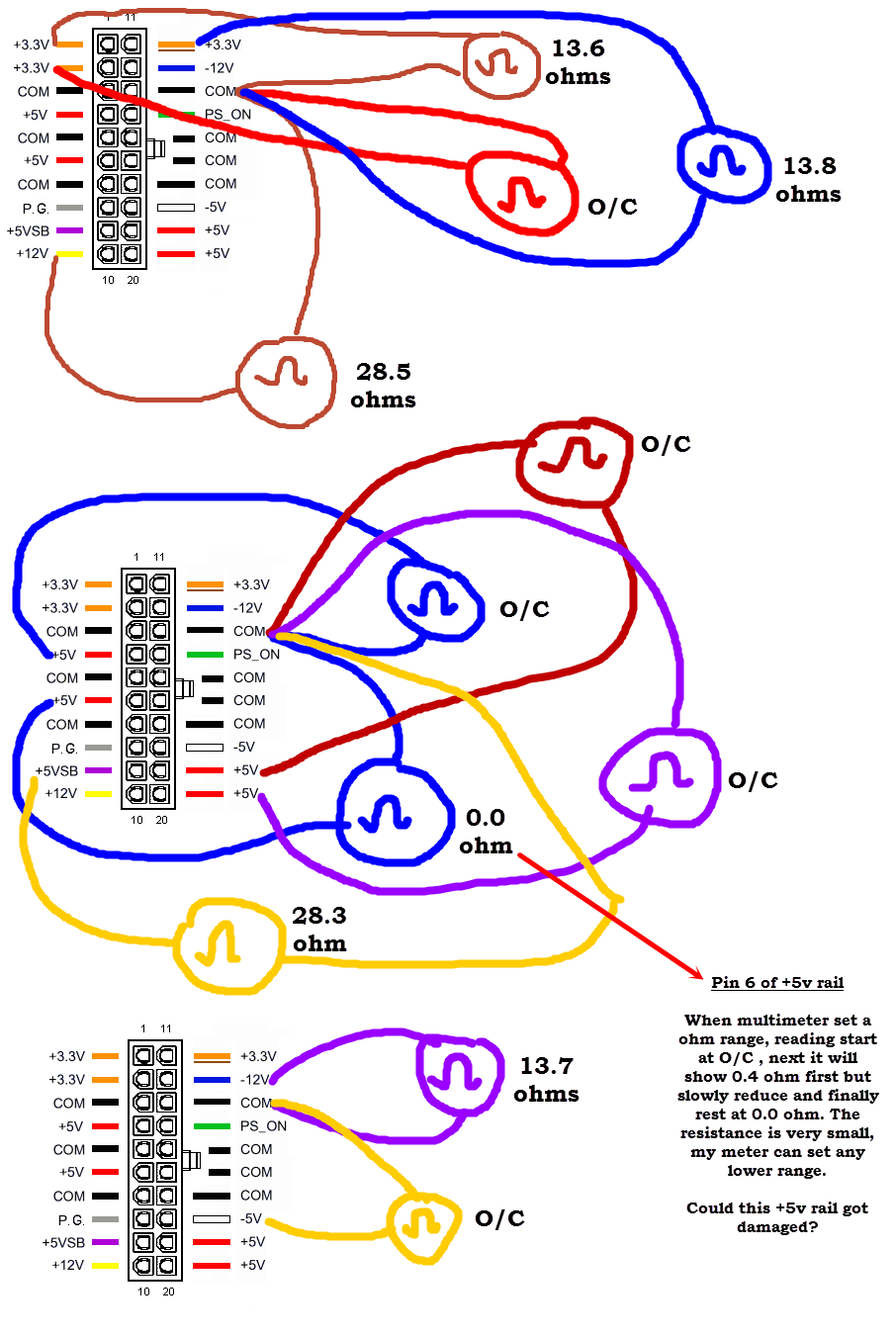

                      Those symptoms are typical for a short circuit on the motherboard (usually shorted MOSFET in one of the buck converters - i.e. VRMs). If you have a multimeter and some willingness/time, we can troubleshoot it. Sometimes it's easy to fix this issue, other times a little more challenging.
                      Also, from what I understand from you, these symptoms were present before you even attempted recapping the motherboard?
                      As for the MSI motherboard on eBay, I see that the caps on the picture appear to have an "X" vent and are blue with gold stripe. This suggests OST caps, which aren't really that great. I know some newer MSI motherboards use Teapo, and Chemicon KZG - both of which are equally crappy as OST. But sometimes, MSI do their motherboards all with Rubycon/Panasonic which are really good caps. So I think it's a bit of a lottery what you get.

                              Either way, it's very easy. The tricky part is to figure out which MOSFETs actually give bad readings, since they are installed on the motherboard. Because of this, some of them may appear shorted due to other components without actually being faulty (but I will elaborate on this as we).
                              Before we check any MOSFETs, though, first lets run a few tests which may narrow down the problem...
                              Remove motherboard from case and disconnect it from the PSU. Next, familiarize yourself with the 20-pin ATX connector. Here is a picture from the web that shows all of the pins:
                              http://image.pinout.net/pinout_netwo...atx-pinout.gif
                              Note where these pins are on your connector.
                              After this, measure resistance between the following points below on the ATX connector. Record all measurements and post them here. Also, if you have a manual multimeter, use lowest resistance scale (usually 200 Ohms, but check) when measuring the resistance. If you have an auto multimter, pay particular attention to the measurement units (i.e. whether they are Ohms, KOhms, MOhms, etc. - this matters A LOT).
                              Regardless of whether you have auto or manual multimter, always state the units after each measurement.

                                Hi momaka,
                                Thank you for replying my question.
                                I was about give up and put the motherboard to rest for good.
                                And go and buy the MSI motherboard from eBay, but your came
                                in right in time. So, oh well....may as well give it try....I have got
                                nothing to loose.
                                My multimeter is a cheap one, it does not have auto-ranging function
                                available on it. Unless, I go out spend $$$ and buy it a new one.
                                I have attached a diagram for your observation.
                                To me I think pin 6 of +5v rail is screwed?!!!, may be or may be not,
                                because the reading the resistance to ground is very very small.
                                So small that my multimeter just cannot read detect it.
                                If the this +5v rail is shorted to ground, then that will be the end of the
                                whole story, right? I can throw this motherboard away for good?

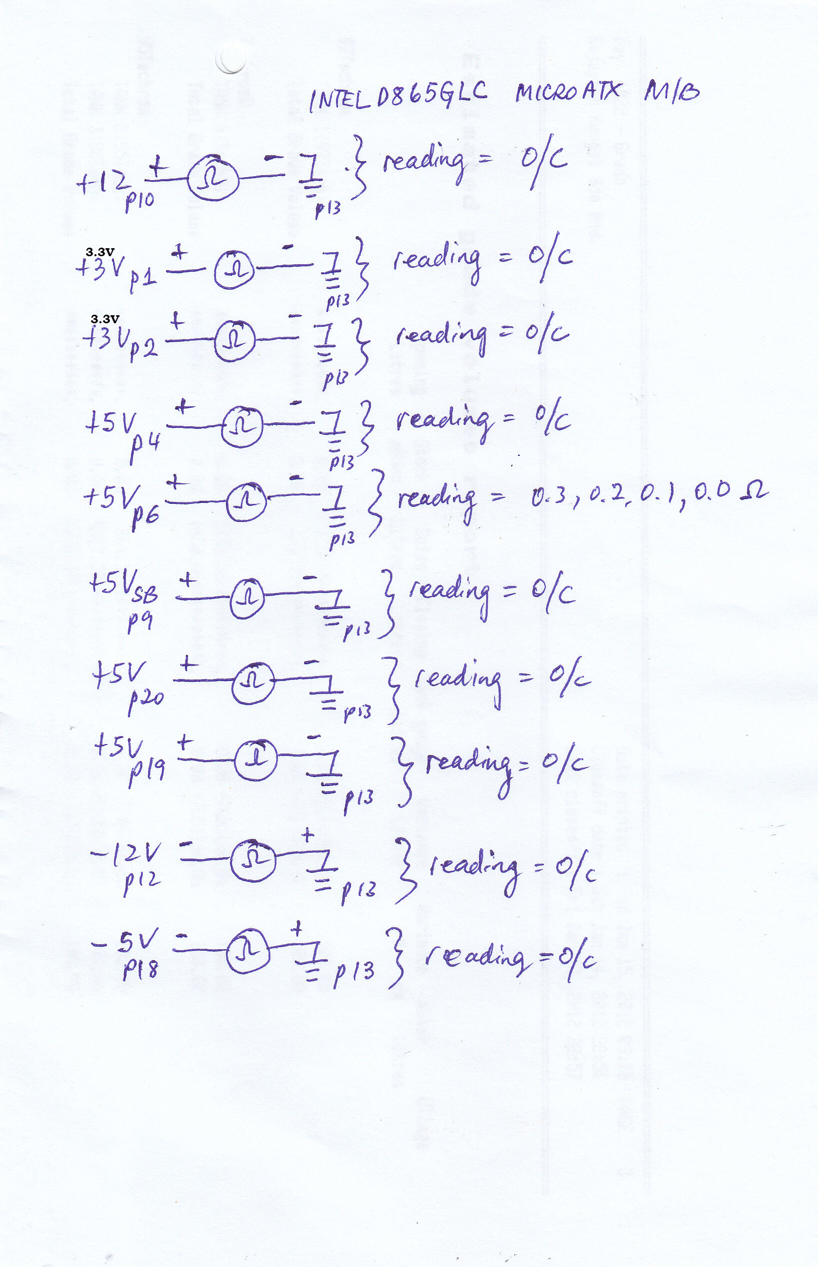

                                  I have another motherboard- Intel D865GLC Micro ATX motherboard.
                                  This motherboard does not do POST when power is turned on.
                                  When power button is pushed in and released, nothing happened.
                                  I suspect this motherboard is having bad capacitors.
                                  Because it is using:
                                  Chemicon's KZE series caps 16V 1200uf = 4 units
                                  Chemicon's KZG series caps 6.3v 820uf = 5 units
                                  Attached is the resistance reading on the motherboard's ATX socket.
                                  As you can see
                                  +12v(p10) --(+)-- ohm meter --(-)-- GND(p13) = reading is open circuit
                                  +3.3v(p1) --(+)-- ohm meter --(-)-- GND(p13) = reading is open circuit
                                  +3.3v(p2) --(+)-- ohm meter --(-)-- GND(p13) = reading is open circuit
                                  +5v(p4) --(+)-- ohm meter --(-)-- GND(p13) = reading is open circuit
                                  +5v(p6) --(+)-- ohm meter --(-)-- GND(p13) = reading is open circuit
                                  +5vsb(p9) --(+)-- ohm meter --(-)-- GND(p13) = reading is 0.3, 0.2, 0.1, 0.0 ohm
                                  +5v(p20) --(+)-- ohm meter --(-)-- GND(p13) = reading is open circuit
                                  +5v(p19) --(+)-- ohm meter --(-)-- GND(p13) = reading is open circuit
                                  -12v(p12) --(-)-- ohm --(+)-- GND(p13) = reading is open circuit
                                  -5v(p12) --(-)-- ohm --(+)-- GND(p13) = reading is open circuit
                                  (-) -ve probe
                                  (+) +ve probe
                                  So, by comparing the 2 motherboards' reading(D865GLC & A7N8X-E),
                                  can I conclude that my ASUS A7N8X-E motherboard is basically unrepairable.
                                  Since most of the +3.3v, +5v & +12v rails are short-ciruited.
                                  Your advice is much appreciated here.
                                  Thank you.

                                      Sorry, I've had classes in the last few days and not much time to respond.
                                      Continuing with the ASUS motherboard...
                                      There's no way all of the rails would have readings like that. Moreover, if the +5VSB really had 28.3 Ohms as you wrote in your diagram, the fans on the motherboard would NOT even pulse like they do.
                                      I advise you re-do these measurements or double-check that you are using your multimeter properly.
                                      Again, measure all resistances using the lowest resistance scale - i.e. usually 200 Ohms, NOT 2000 or 2k, 20k, and 2M. Also, give the multimeter at least 3-5 seconds for the numbers on the screen to settle down. And again, make sure the PSU is DISCONNECTED from the motherboard.
                                      If you are absolutely sure that you are doing everything right and you still get the same results, then do the following:
                                      Set multimter to continuity or diode test (i.e. "BEEP" mode) - these two are usually integrated on cheaper manual multimeters. Then, do just like you did with the resistance measurements... that is:
                                      - red (+) multimter probe on 12V rail pin and black (-) multimeter probe on ground pin (any ground pin is fine)
                                      - red (+) multimter probe on 5V rail pin and black (-) multimeter probe on ground pin (any ground pin is fine)
                                      - red (+) multimter probe on 3.3V rail pin and black (-) multimeter probe on ground pin (any ground pin is fine)
                                      - black (-) multimter probe on -5V rail pin and red (+) multimeter probe on ground pin (any ground pin is fine)
                                      - black (-) multimter probe on -12V rail pin and red (+) multimeter probe on ground pin (any ground pin is fine)
                                      Not really.
                                      Like I said, the symptoms of your ASUS motherboard indicate there is a short somewhere. This is usually a much easier fix. You just have to test all power-related components to find where the fault is. We start at the ATX connector to possibly narrow it down where the fault might be. If all of the readings on ATX connector appear fine, then we move on to testing individual MOSFETs in different sections of the motherboard. There's the CPU VRM, RAM VRM, and usually a bunch of other linear VRMs such as Northbridge, AGP, Southbridge, and RAM Vtt.
                                      Now if you had "spinning fans but no video" and the caps were good, then this can be anything (IMO way harder to fix than "twitches fans and dies").
