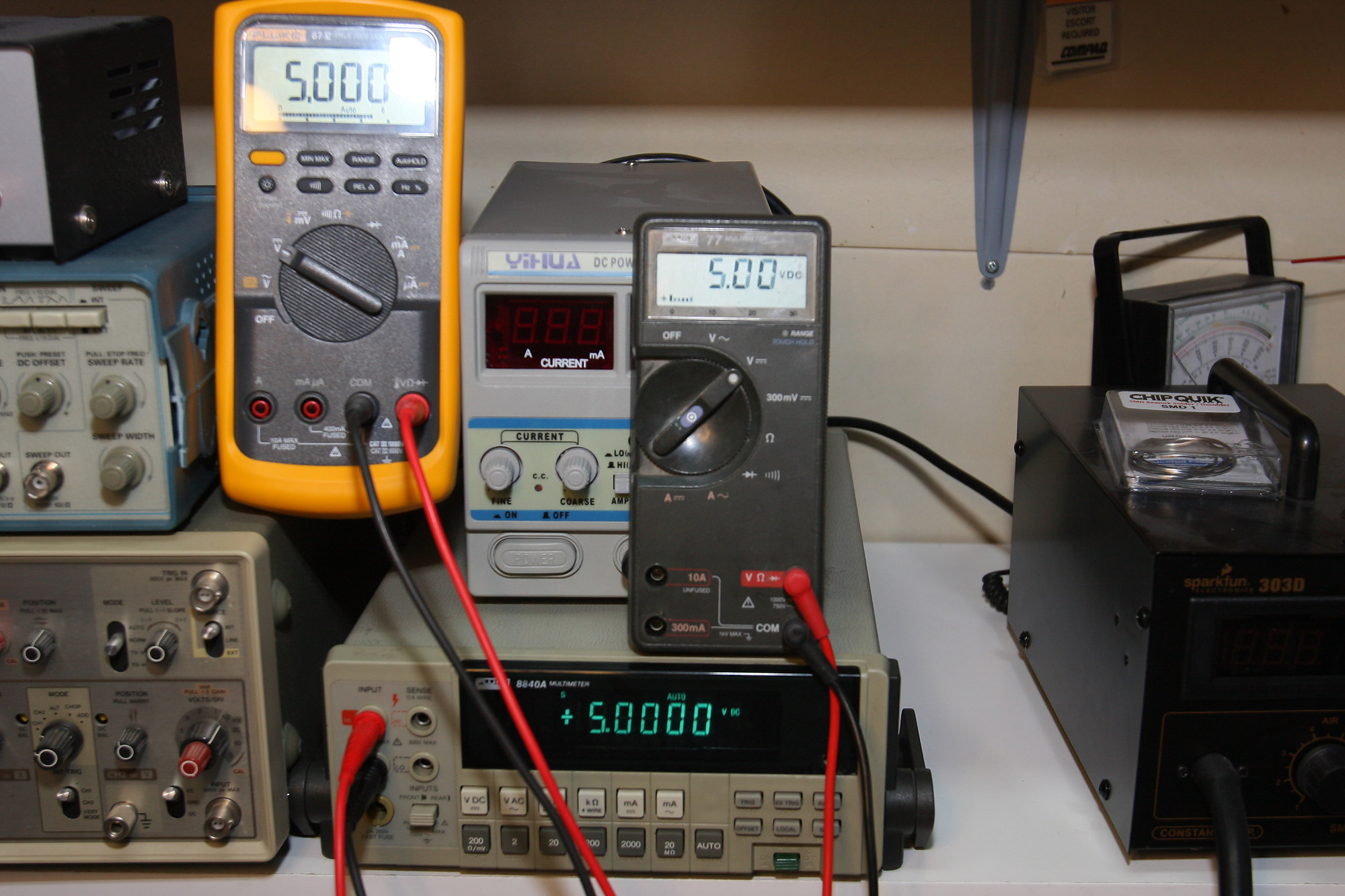

    Just a quick report on my 8840A.
    Compared to my 87-IV both meters read the same on DC volts from my lab supply. My 77 was reading a bit high so I tweaked the adjustment pot at 3.0000 V according to the 8840 and now it seems accurate as well.
    The calibration sheet for my voltage standard says the DCv is 5.0000v and by golly all of my Flukes agree.
    This is not a calibrator or any provable true standard, just a "pretty damn accurate" standard measured with a really calibrated meter at time of build.
    I was going to set up a photo of all 3 flukes, a Micronta and a 1 hung low DMM and 2 Micronta analog meters all measuring the same voltage, but I don't have the time or patience to get all of that happening on my very messy bench, so here are the 3 Flukes connected to the voltage standard.
    DC milliamps also look pretty accurate on the 8840 and the 87. Looks like my 77 has a blown fuse (who knew?)
    Resistance is off by .0002k or so, but I didn't spend any time waiting for settling or writing down accurate readings, nor do I know what the ambient temp is. My calibration sheet on the resistances was at 69F.
    Suffice it so say, for my purposes any of my Flukes are accurate enough and then some.

    Hi Smason,
    The 8840A looks great.
    It looks like your 77 might have some faded lcd segments? If yes, take it apart and clean the elastometers and pcb connectors with a qtip dipped in isopropyl alcohol.

      Hi Smason,
      Yeah I'm loving the 8840 so far. Not that there's anything wrong with my 87, I just got it into my head that I wanted a bench meter. I may have a problem developing.
      As for the 77 I think in this case it's just bad light/angle.
      It DID have a problem a couple years ago.
      It involved a fight between 2 cats and some very smelly output that leaked into the meter. I had no idea for months, till I went to use it.
      I cleaned the elastomer, and I think I actually sanded down and tinned the corroded PCB with solder to get it to work at all.

            Hi Smason,
            It looks like your 77 might have some faded lcd segments? .
            So that's been in the back of my mind all evening. I've been thinking, "well, Retiredcaps REALLY knows his meters, so he's probably right"
            So I had to go check. Decided to replace the fuse too.
            Happy to report that the display is fine. I looked at the back of the meter, 630ma fuse. OPened my fuse drawer. Had a bunch of packages of Buss fuses (you know the plastic and aluminum 5 in a pack ones) and no 630s.
            Then I spotted a ziplock baggie with about 15 of them in it, labelled 630 ma Fluke. I must pop a lot of fuses
            Oh, forgot to mention, my voltage reference is a DMMCHeck from voltagestandard.com Great little unit. Not as nice as DAve Jones' EDC Voltage standard, but certainly good enough for many people.
              I learned a lot from modemhead's blog and forum posts. Modemhead knows way more than I, but I'm going up the hockey stick curve fast though.
              In the photo, it looks like a couple of segments were dim, but you have the best view. I had a couple of 70 series multimeters that had 1 or 2 dim segments.
              You probably have over $100 worth of fuses in that drawer. I have yet to blow a fuse. I have purchased "working" multimeters with blown fuses or the odd bolt in it acting as a fuse.
              Modemhead took one apart if you want to see the insides
              http://mrmodemhead.com/blog/inside-a-multimeter-fuse/
              Oh, forgot to mention, my voltage reference is a DMMCHeck from voltagestandard.com.
              If I had one, I would be using the voltage reference that would give me the most amount of resolution. A 1.5000 reference would let me check out an extra digit on the Fluke 87V in high resolution mode and 3 decimal places on the 70 series.
                No way I paid anywhere near what the fuses go for these days. I have no idea when I purchased them, but I'd guess mid-80s. Probably from B&E or somewhere local (Not Active)
                Yes 1.5v would give another digit of accuracy. I chose the DMMcheck because it had dcv dcma and 3 precision resistors.
                Initially I was going to make my own, but after thinking about designing and etching a pcb, and the amount of work, and no way to calibrate it, I got lazy
                The Pentaref from voltagestandard.com was my second choice, but it was almost twice the price.

                  The little ceramic 630mA fuses in the 77 are not quite as expensive as the larger fiber-tube ones, fortunately.
                  The DMMCheck is incredibly useful and much easier/better than a homemade solution, but as noted, 5V is not the most convenient number for models where 1, 2, 3 or 4 is the maximum most-significant-digit. Playing with older 2000-count and 20,000-count meters like I often do, I find myself in need of a 1.9V reference.
                  I may have to pull the trigger on one of those Pentaref gadgets. Unless of course the tooth fairy drops a Fluke calibrator in my lap...
