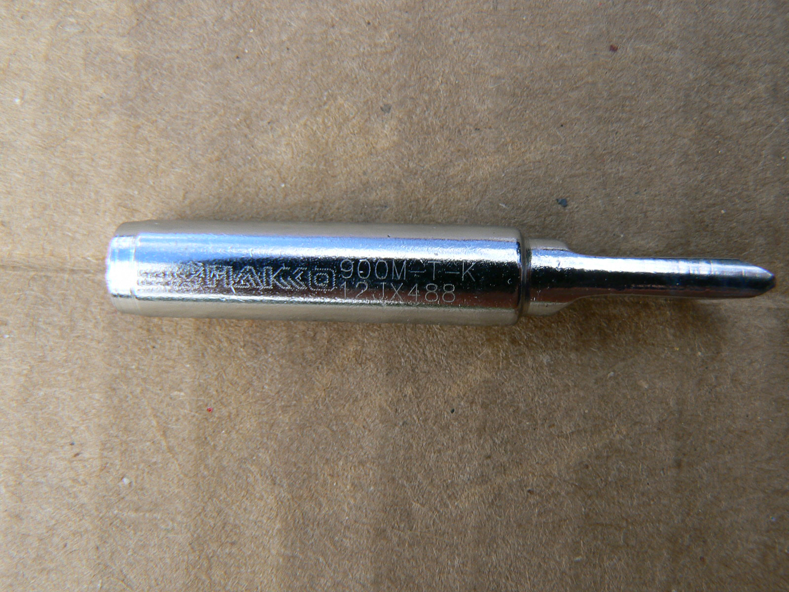

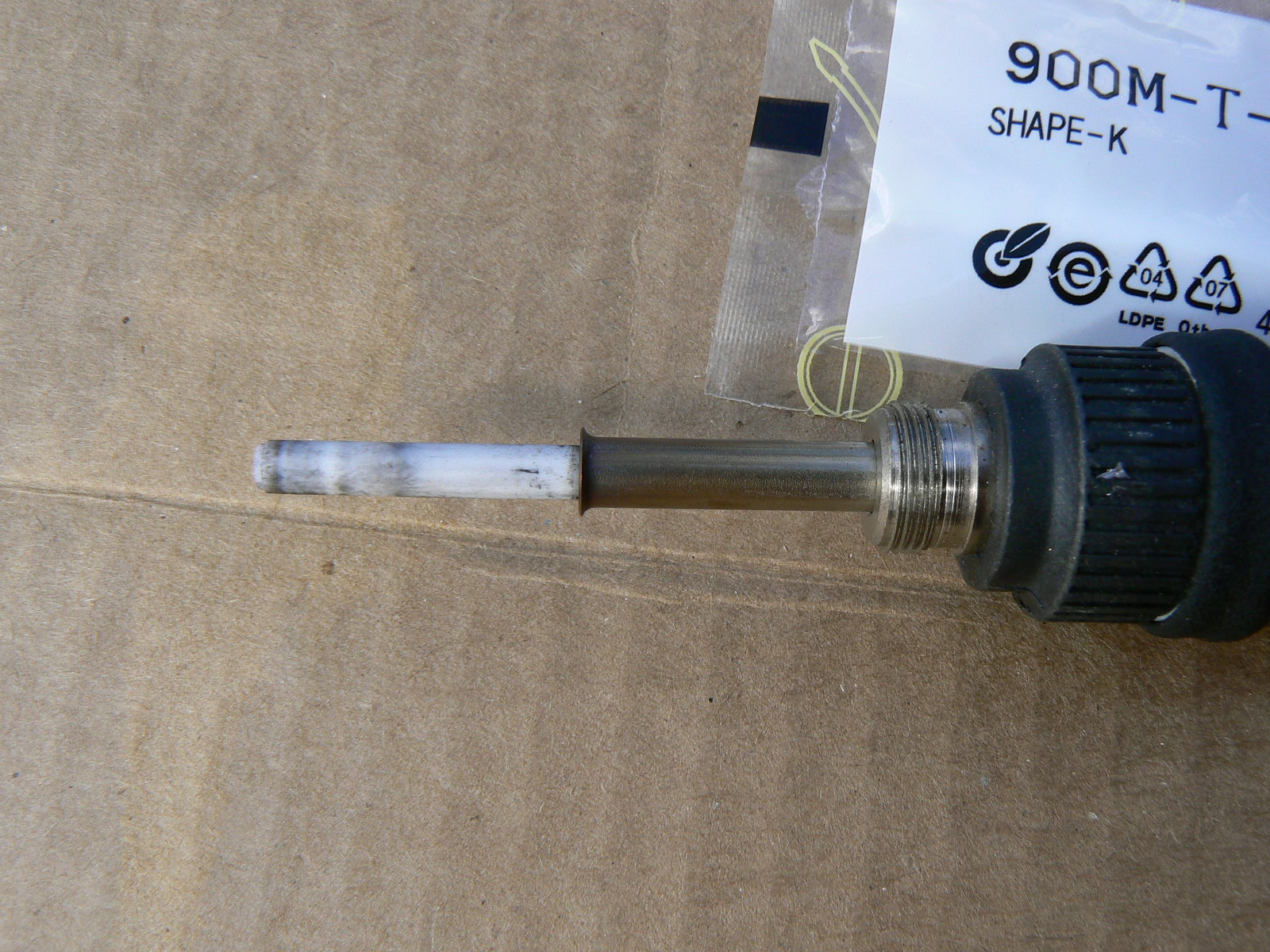

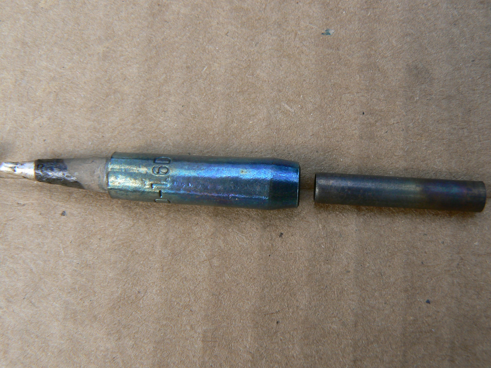

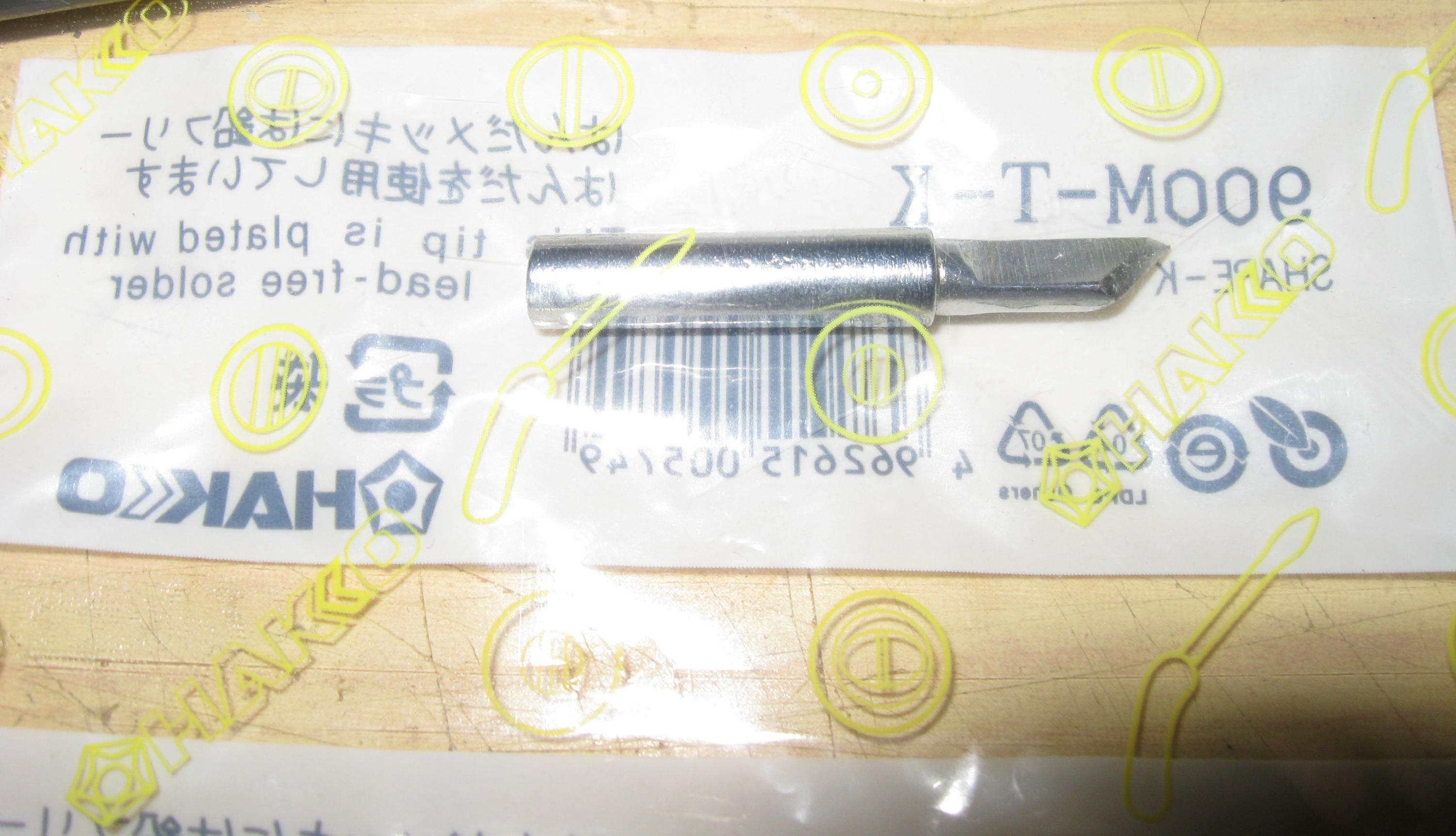

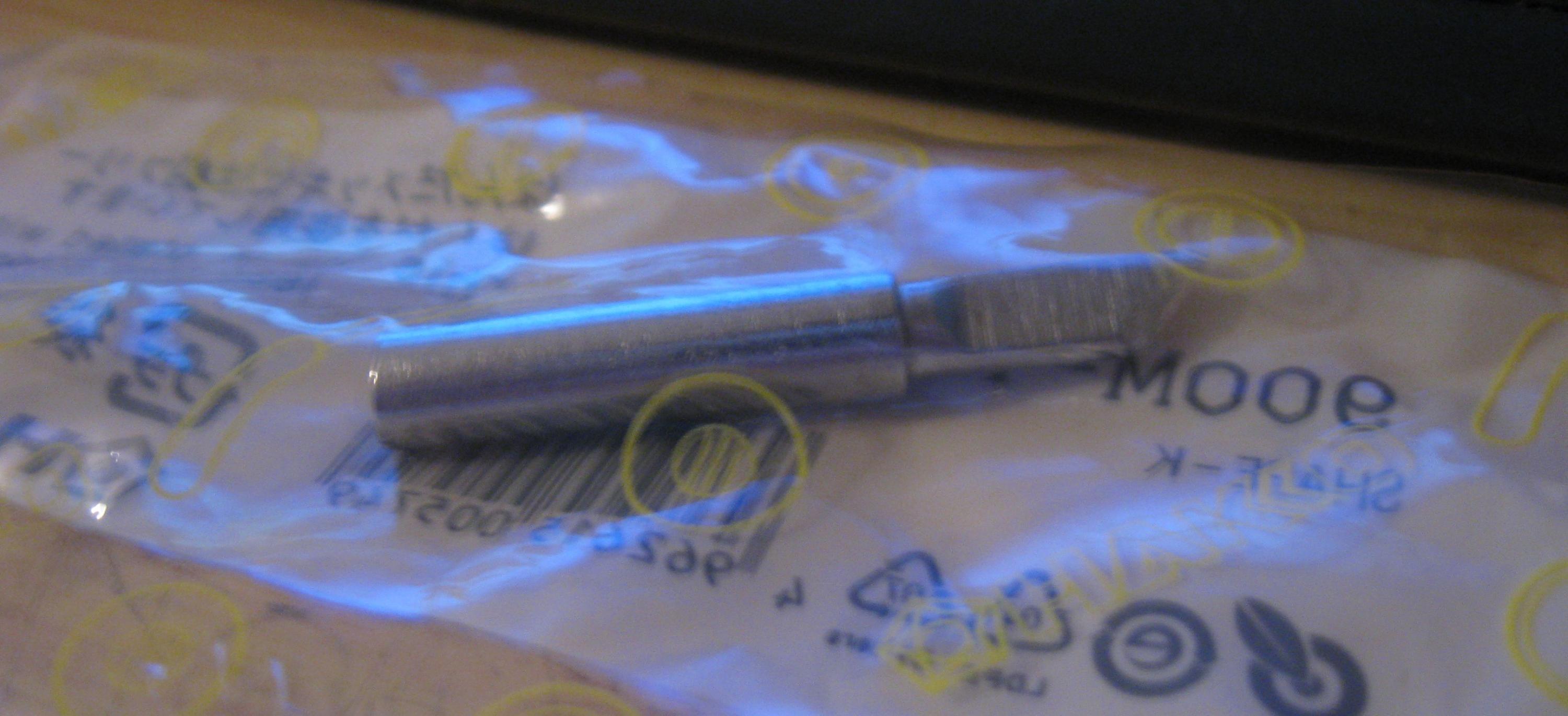

    I was hoping to get some feed back on whether or not my new "Hakko" tips are real or knock-offs. These are the first tips I have ever bought for my 936 station so I am not sure what to look for in the case of knock-off tips. My original tip has a sleeve where the new ones will not fit onto the sleeve, however they will fit if I do not use the sleeve. I have not tried to use them yet so I do not know how they perform. So, are they OEM, fake and good enough to use or fake and do not use? Constructive input would be greatly appreciated.
    Thanks,
    Lloyd

    Based on my research in the past, most, but not all the Hakko tips on ebay are fake.

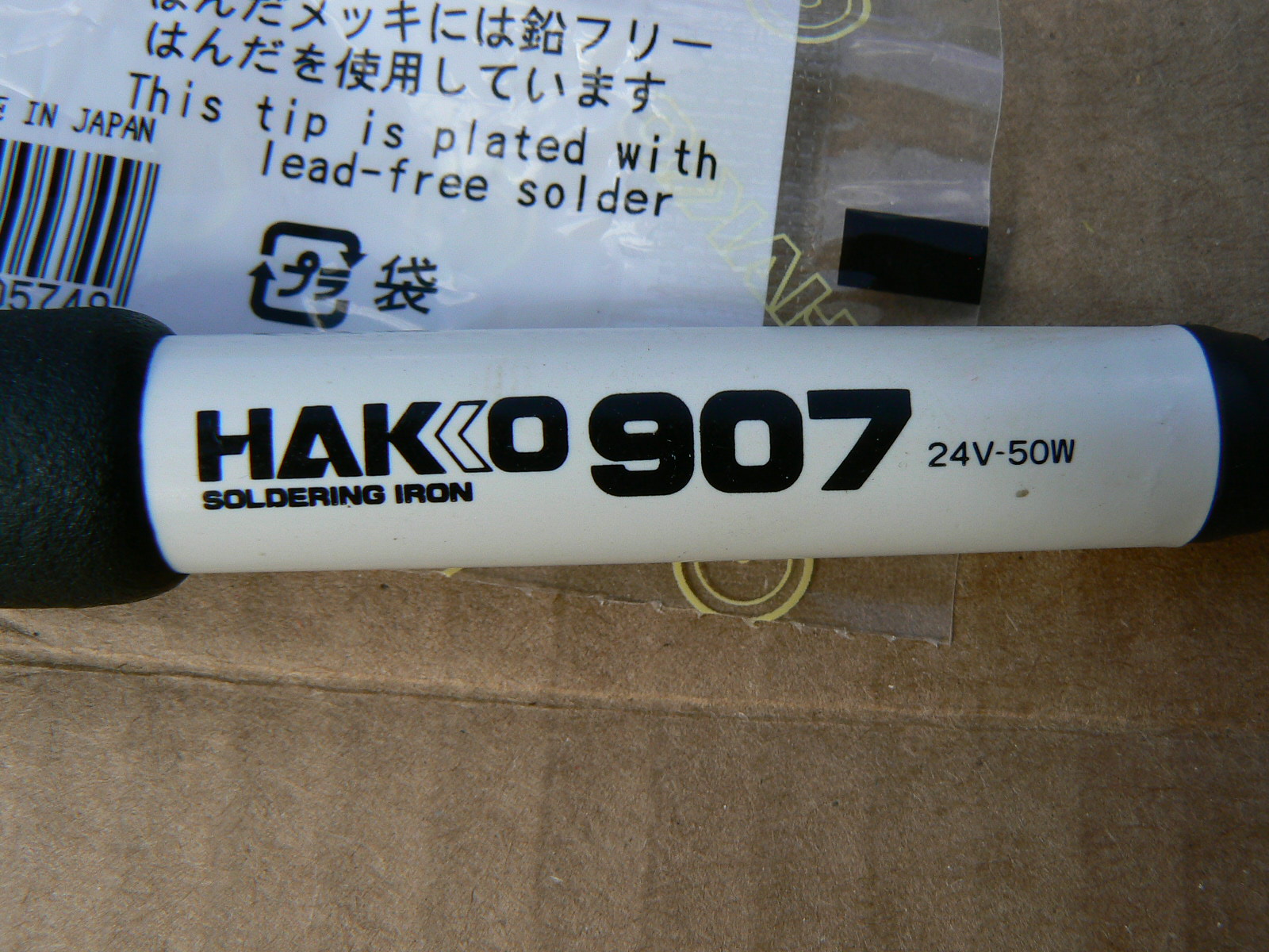

        You should look for FX888 tips, those should be compatible but a few mm longer than the old tips.
        My spare tips are probably fake, because they don't have any code engraved on them, the finishing on the not-tip side is also not perfect .. but they came sealed as a pack of 2.
        I tried another tip shape which is similar at the other end on my Hakko 907 hand piece and they fit perfectly so I don't know what to tell you.
        See attached pics

          ... My original tip has a sleeve where the new ones will not fit onto the sleeve, however they will fit if I do not use the sleeve. ...

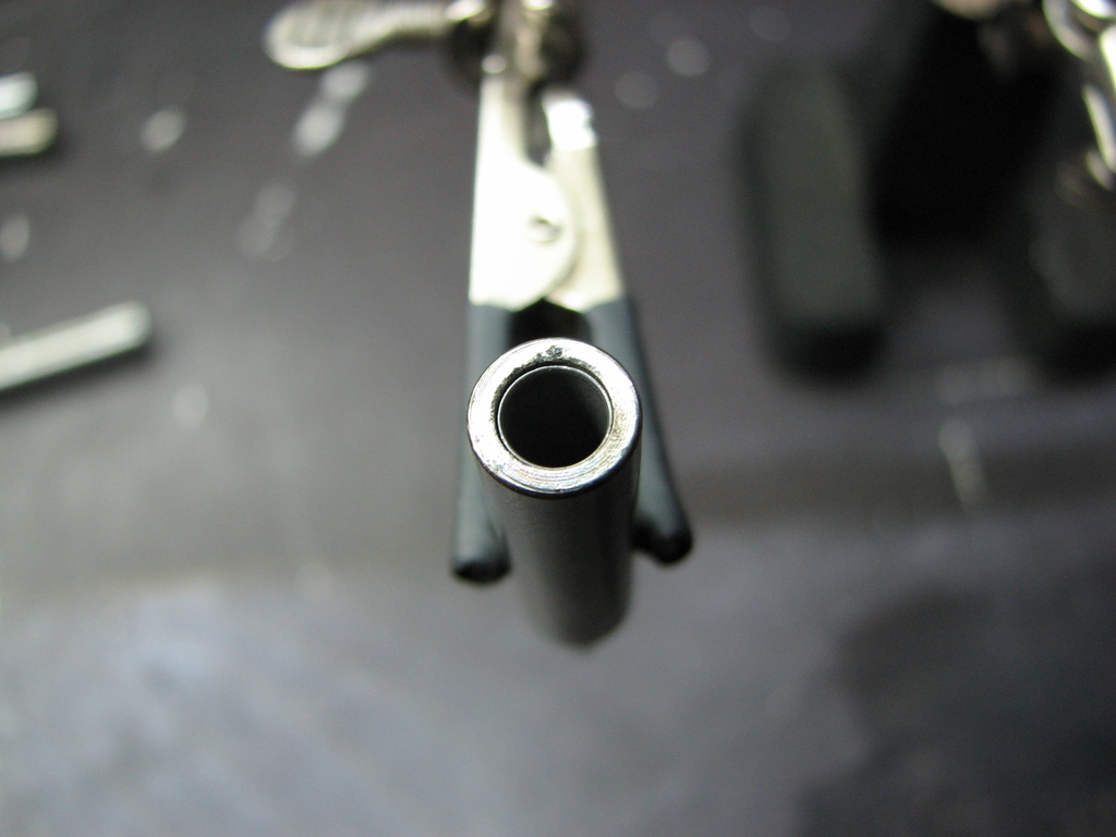

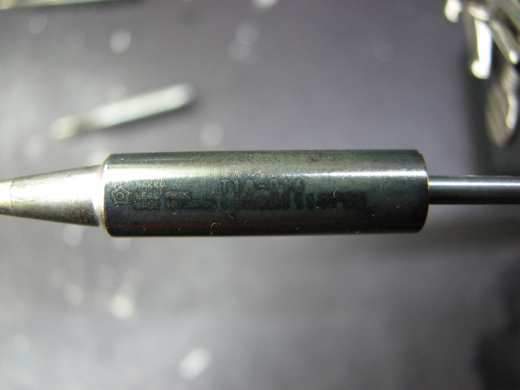

          All my tips came from tequipment.NET or hakkousa.com, so I certainly hope they're genuine. If you look really close, all of them have a thin sleeve inside. It normally doesn't come out, but it did on my oldest tip (like yours), probably from thermal cycling. I don't know how good counterfeit tips are, but I wonder if they include the sleeve?

            Thanks for the reply's everyone. Retiredcaps, I tried to order some tips from the place referenced in your provided link. The prices were good but PayPal gave me a strange message about not being able to pay the seller. So I am not sure what to make of that..... kinda makes me nervous. I think I may try the seller that sold me the 900M-T-K tips, if they are fake they did a good job IMO. At the worst I will just be out a few bucks, it is not like I am buying a truck load.
            The 900M-T-K tips were larger than I realized and way too big for most of my projects. I just need a spare 1.6D and I am going to get a 2.4D to play with for now. I will look into the FX888 tips in the future, I just want to get something on the way for now as you can see my original tip has seen better days.
            I was wondering about the sleeve, so thanks for this information. I did not notice a sleeve in the 900M-T-K tips but I will look again with a magnifying glass out of curiosity. Do the markings on the ones you get look like my new one or are they in the style of my original tip? That could be a clue also.

              Here's a couple of shots of a relatively new T18-D16, which is the replacement for 900M-T-1.6D. It fits the 907 handpiece of my older 936 station. First picture shows the markings, second picture is the internal sleeve. Strictly speaking, the markings don't look like either of yours. They look sort of 'burned' in.
                  Engraved by Laser ..
