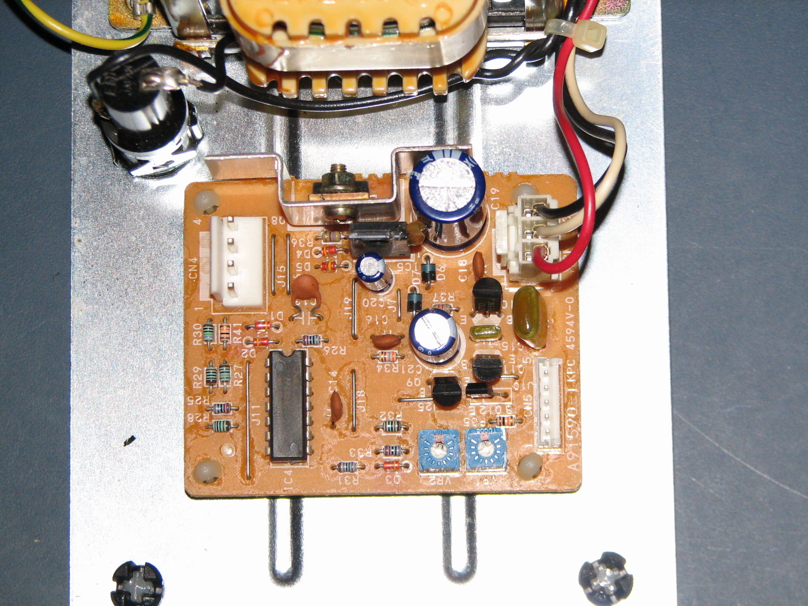

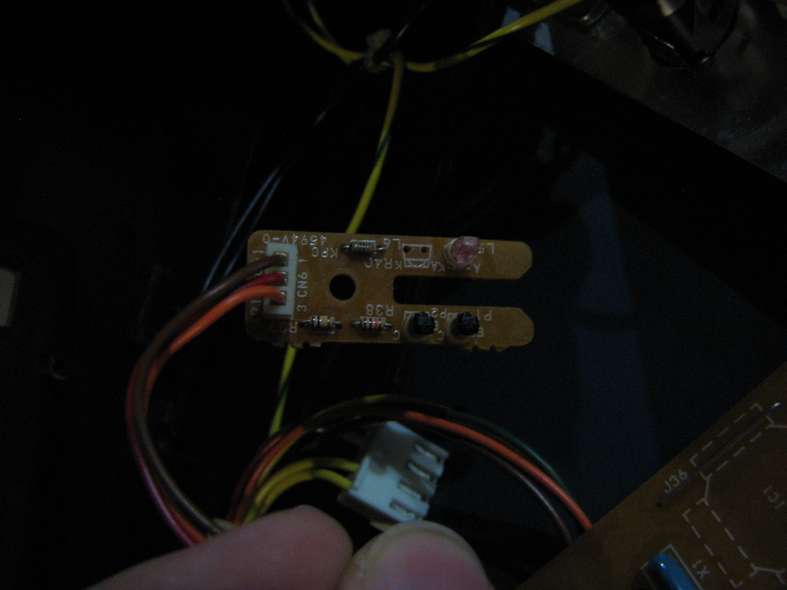

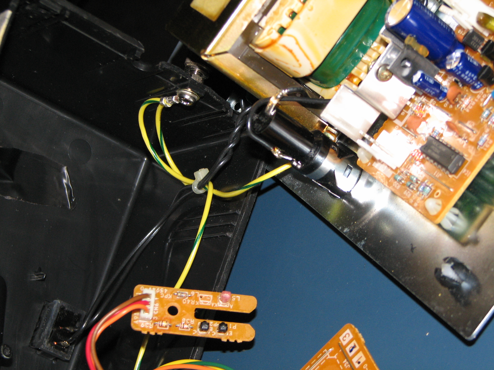

              Hey Guys, I got it in today, I Removed L6 from the sensor board as per the lockout bypass but I still am not able to adjust Temperature settings. Any Ideas?
              • cmj21973
                • 267
                Re: Hakko Soldering Iron Ebay Find!
                Post picture of board,top and bottom.

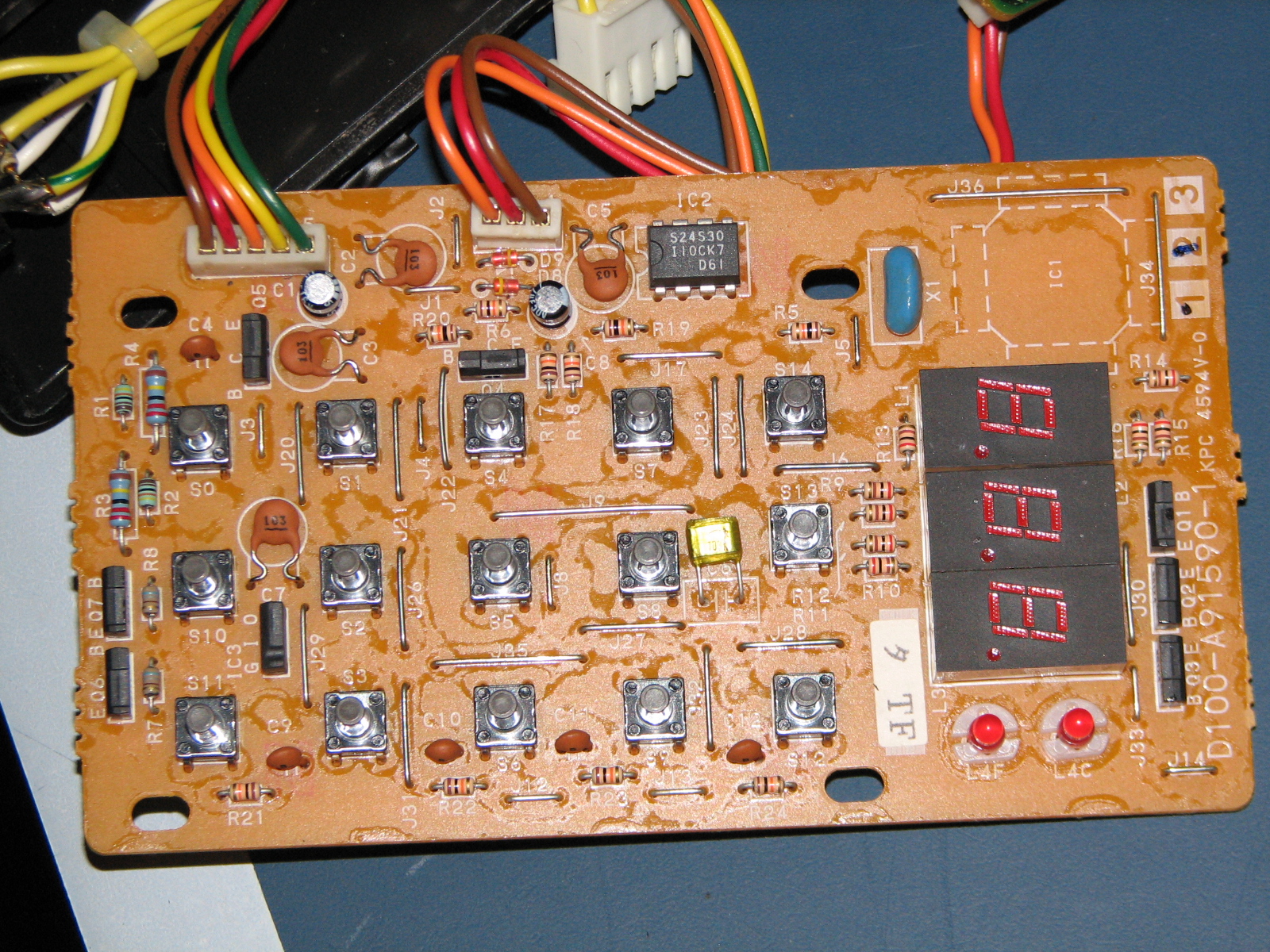

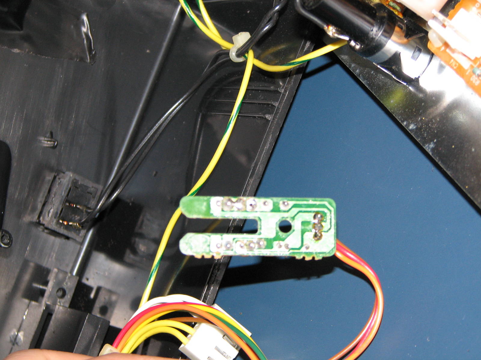

                    • ComputerGeek
                      • Oct 2011
                      • 262

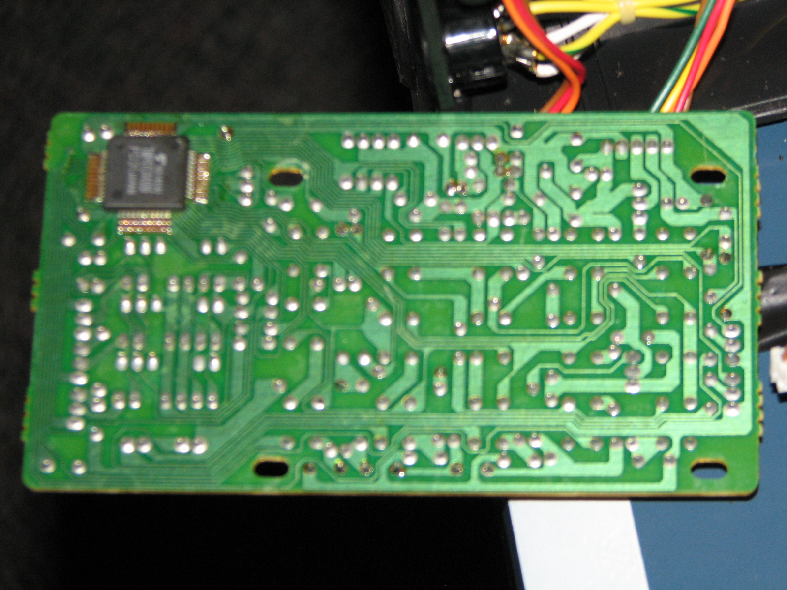

                      Here they are. I'd rather not take the board near the transformer off as I always wreck those plastic clips but if you absolutely need it, I'll get the back for you.

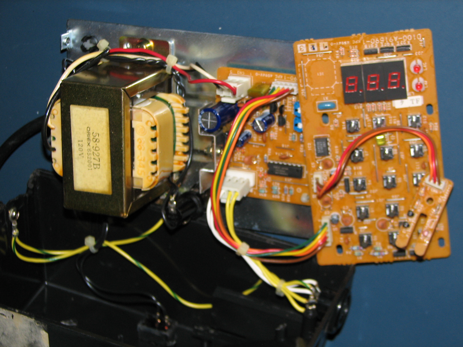

                      • cmj21973
                        • 267
                        I understand completely.
                        I hate those things. I normal replace them with nylon bolts, spacers, and nuts from hardware store.
                        Can you take an over all picture so I see how the wire cables connect the boards together.
                        Besides removing L6, did you do any touch up (reflowing) soldering on that board?
                            No I have not not touched up any of the boards. Picture is attached for the connections.
                            Also, just to make sure I am doing this right all I have to do after the lockout is disabled, is press the "R" button and then enter the number and press "S", right?
                            Originally posted by Toasty
                            Does the iron get hot?
                            Yes the Preset temp is currently set to 650F and it heats up to that temp very quickly and seems to stay there.
                            Thanks guys hope this is a simple fix.

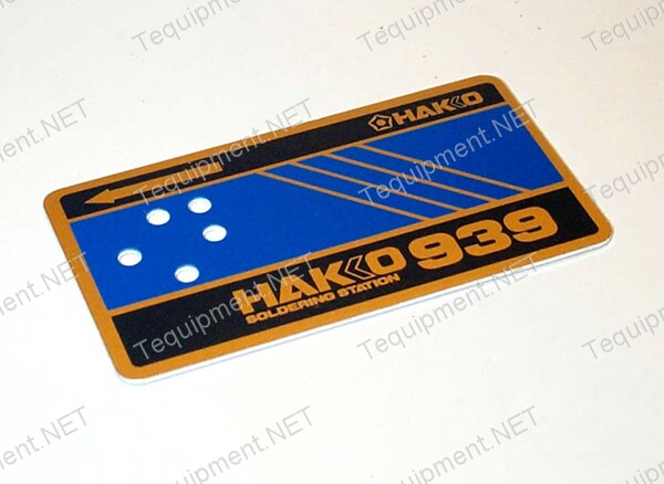

                              I'd make my own keycard and put that L6 back in. Does it even look like it's setting when you press R ?

                                  • cmj21973
                                    • 267
                                    If there isn't any solder bridges on the sensor board, then the problem is on the main board.
                                    • ComputerGeek
                                      • Oct 2011
                                      • 262
                                      Yeah, that what I was thinking. I don't see any solder bridges where do I start on the mainboard?
                                      • cmj21973
                                        • 267
                                        I've looked and can't find a schematic, so we (BADCAPS Forum) need good focused pics of the boards tops and bottoms.
                                        We need this to be able to trace the circuity.
                                        If at all possible use sunlight to illuminate boards or indoor lights, no flash.
                                        If the plastic standoffs get broke, we'll replace them with better ones.
