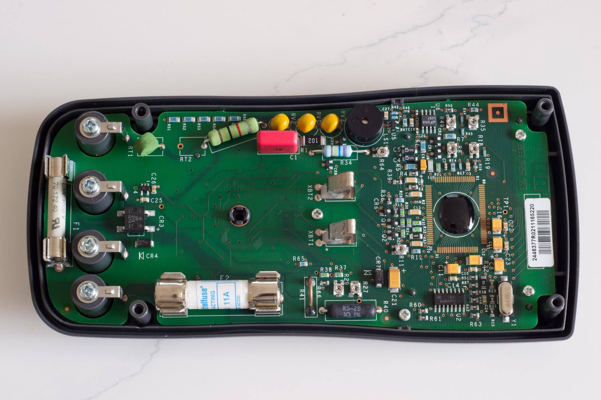

            Fluke 17B- $80
            It's a "China-only" genuine Fluke. Honestly, after looking at many reviews, there is really nothing but good things about this meter. Excellent quality construction. Just as good as USA Made fluke meters, in my opinion.
            High precision components, SMD metal films, SMD tantalums, like 3-4 MOVs, PTC, nice big resistor, high rupture fuses (HRC), really high quality input jacks, and an excellent quality PCB, similar (maybe the same) as the ones Fluke USA uses. It uses two AA batteries which I find to be so much better than 9V, which a lot of meters use. Now AAs can of course be implemented incorrectly, but for the most part, you get better battery life using AAs versus a 9V which a lot of power is typically wasted, and the cell physically has less mAh.
            Has all the functions you'd want. VAC, VDC, Resistance, Diode, Continuity, Capacitance, Current and Temperature. Good external build too. Feels like a real Fluke, according to owners.
            Only complaints is that it uses a SOB (system on a blob). They put the die right on the board instead of using a standard QFP, which isn't really an issue, just makes modding it difficult. The continuity tester is not latched, but it's quick. That's the only REAL problem I have with that. I hate non-lateched DMMs...There's also no TRMS, but few people really need TRMS, especially if you're new to the game. There's no backlight, but then again, I'm hoping none of you are trying to throw together circuits in the darkness of the night.
            So most of the shortfalls in my opinion, are not really shortfalls. They were cuts made to keep the price low, and they really do not have a bad effect on you. You probably wouldn't have much of a Fluke warranty, but if you buy from a good seller, then you'd most likely be fine if you had issues, which I doubt you will.
            I do not own it, but I've really been wooed by the fact that there is finally a cheap Fluke meter that actually lives up to Fluke standards. Tell me that doesn't look good? Again it's a "China-only" model, but there's tons of them on eBay which makes it a non issue. I think it's one of the best buys out there. Plus it's a Fluke...
            Here's one review: http://www.eevblog.com/forum/index.php?topic=4068.0. There are several other reviews out there.

              Re: I need a new multimeter but don't want to spend a fortune.
              It's a Fluke, but is not having calibration certificate, no CE/UL certifications, and so on. No closed-case calibration also.
              The one-year (or two) warranty is something that tells us that the components will drift faster than US-made Flukes.
              If you can live with this, go on.
              But in US, at $80 you can find a second-hand US-made Fluke which is a lot better.

                        I dunno. They look pretty high quality to me...I don't know about those surface mount pots...but otherwise looks good.
