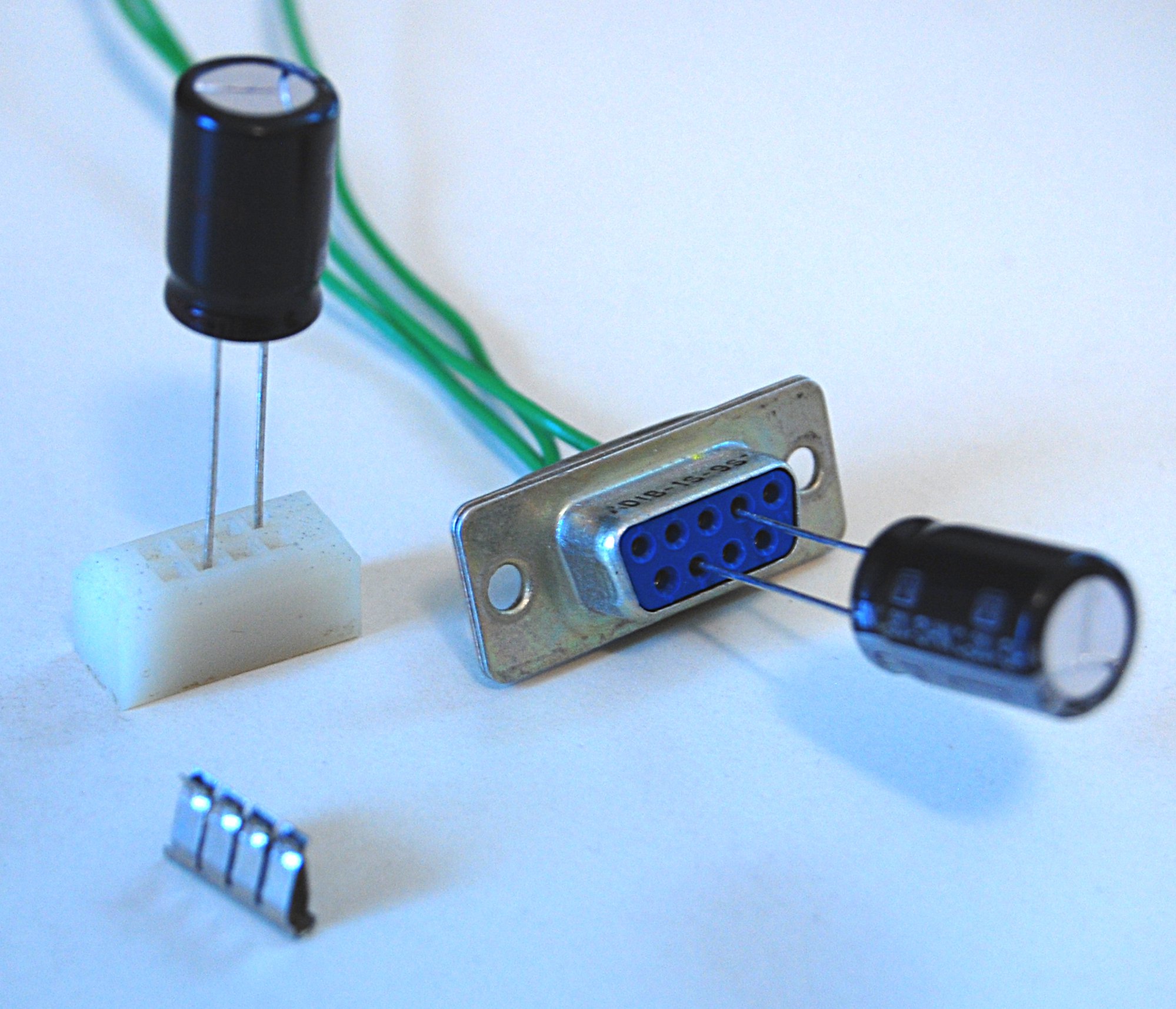

      Re: Sockets for component leads
      A picture might help:
        Originally posted by mathog
        Maybe a DC fan plug, the 3 or 4 lead type that plugs into a motherboard fan header?
        Actually, I probably do have some of those, but would have to figure out how to panel-mount them. Solder them to a PC board that could be bolted in, maybe.

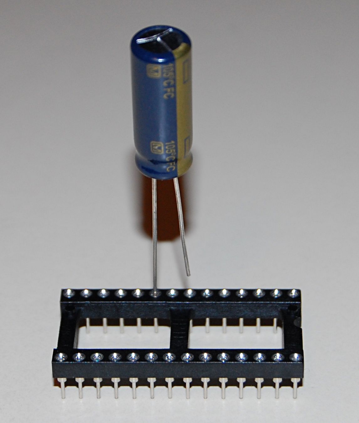

            Originally posted by yyonline
            The ESR Micro uses a DIP socket. I haven't looked, but I imagine they'd be readily available on digikey and similar sites.
            Edit: something like this:
            http://search.digikey.com/scripts/Dk...rds=16-3518-10
            There are a couple of problems with a socket. The first is visible in this picture. The other problem is that the socket pins aren't really big enough for a slip fit on standard capacitor leads, even clean ones that haven't been unsoldered from a board.
