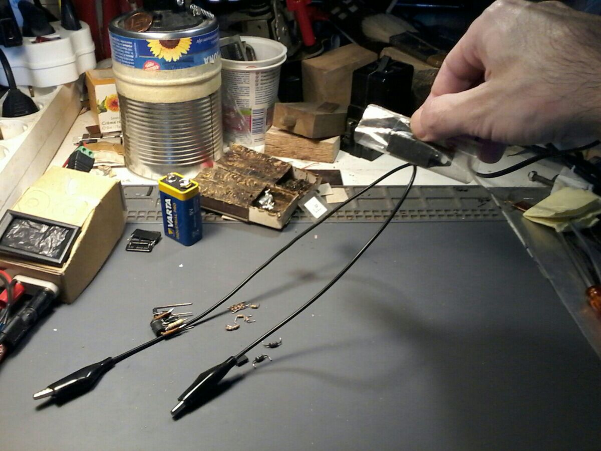

                    Yes ground clip is mounted on the station. I used that for my measurements as I read 0.7Ohm with mains ground so it does seem to be a direct connection.
                    This is not solve your problem, but be aware of chinese creativity - they may using a aluminium or ferrous wire instead of copper, and to do so is offen only plated with copper to look like copper wire... the wire have noticable resistance (about you measured) and heating while carry more amps (car bulb etc). Also, they regulary ommit soldering wire to aligator clamp, and contact is not reliable, like to coroded due to difference in material potencial...
                    On pictures is wire that hang on regular magnet - this is my test and later I do a label of this wire with "Fe".
