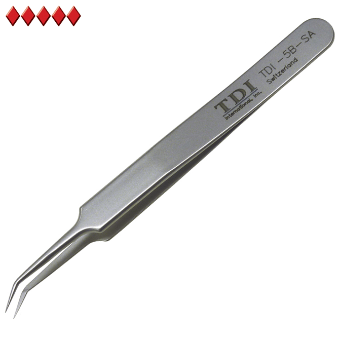

      Also, position of tip is important, has you try a bent tip, because it change position how you handle the tool...
