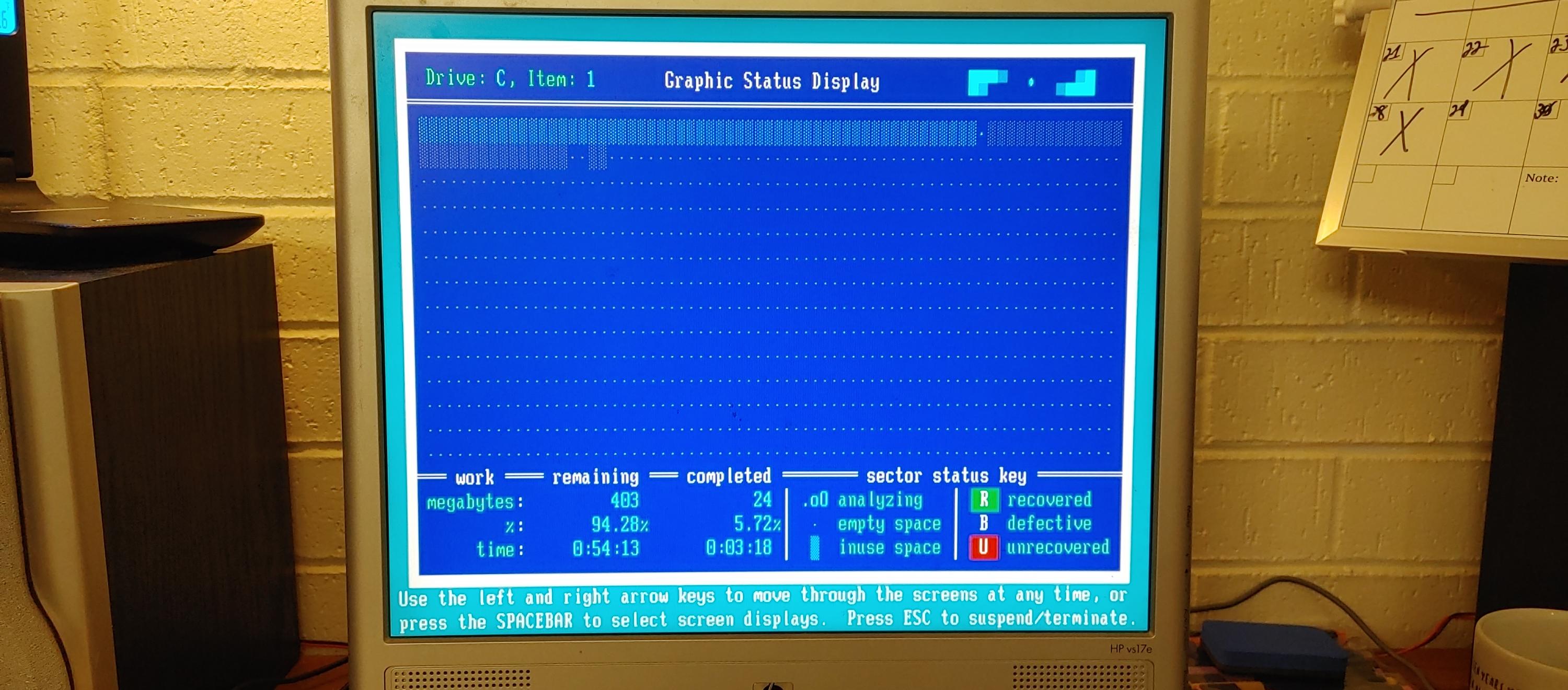

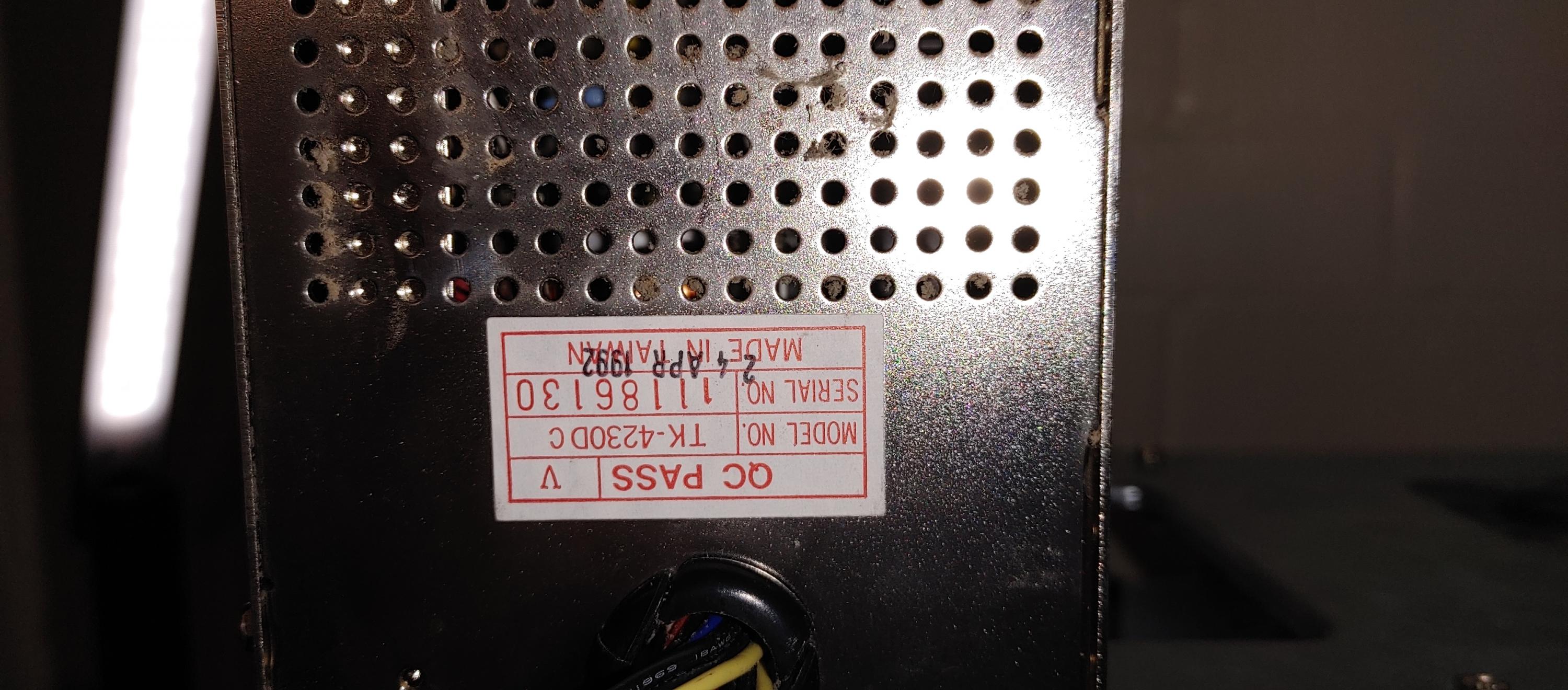

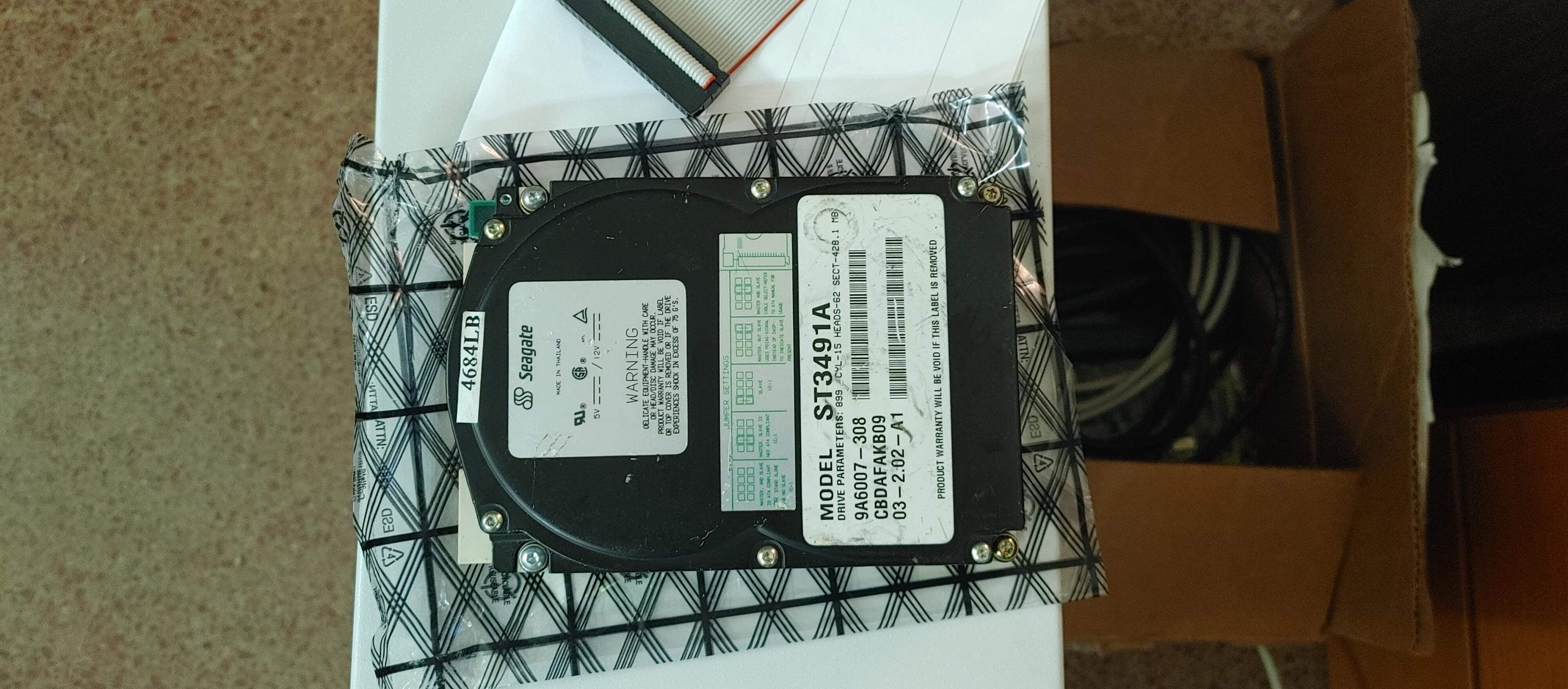

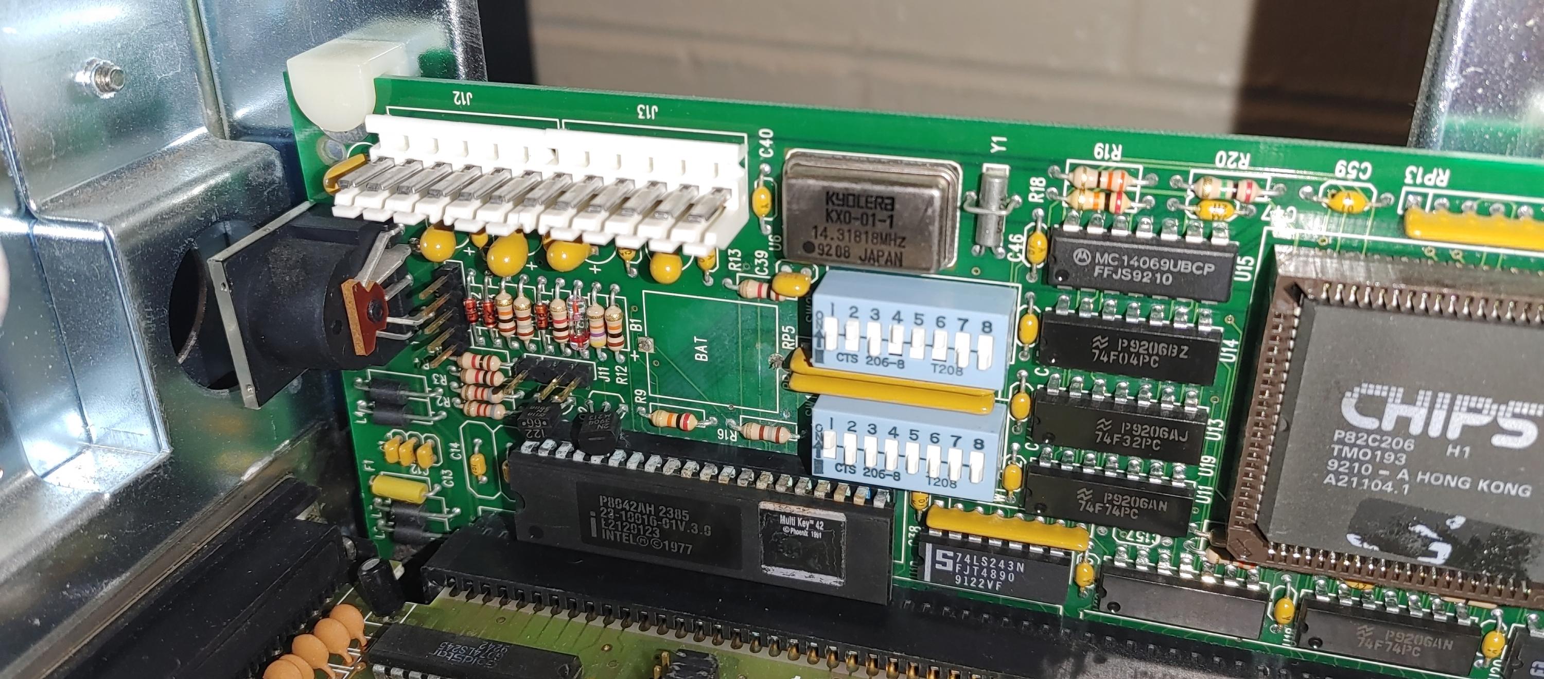

              Got the 428MB drive in, and things are looking good.
              Starting off with a followup to the battery corrosion. Got the corrosion neutralized with vinegar and mostly cleaned up. Looks much better.
              Replacement hard drive.

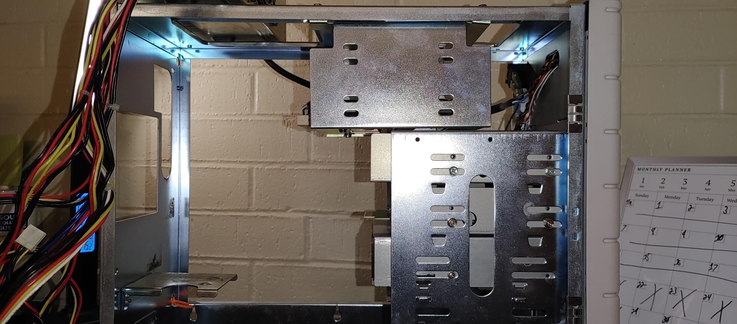

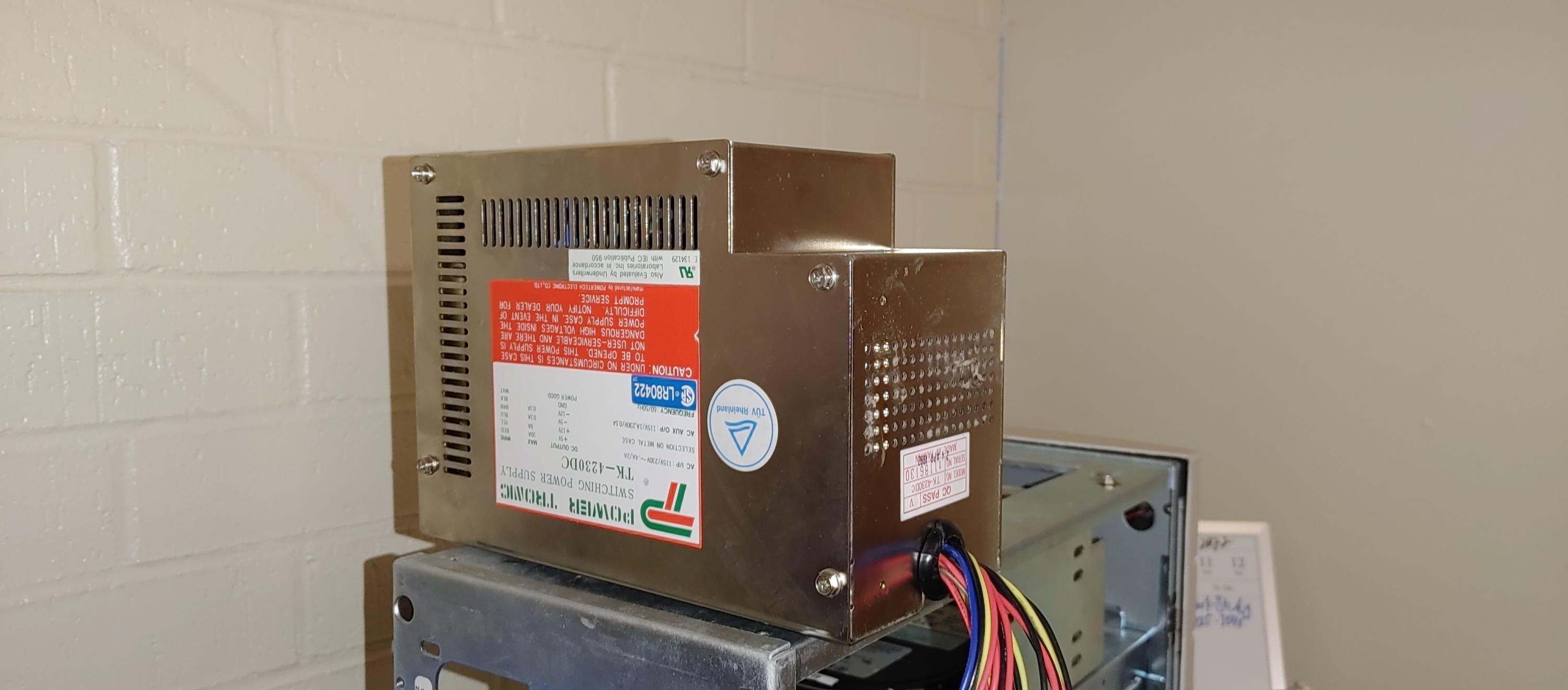

              Installed. Had to uninstall the PSU to get the drive cage out of the system.
              And here's the PSU.
              PSU manufactured April 24, 1992.

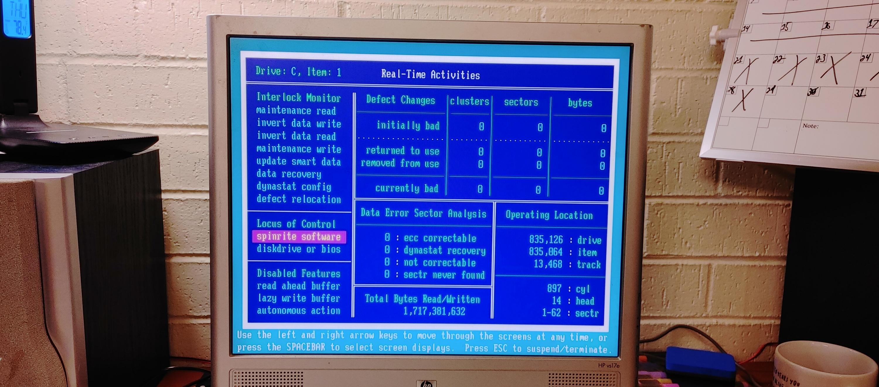

              SpinRite Level 5 time against the new hard drive.

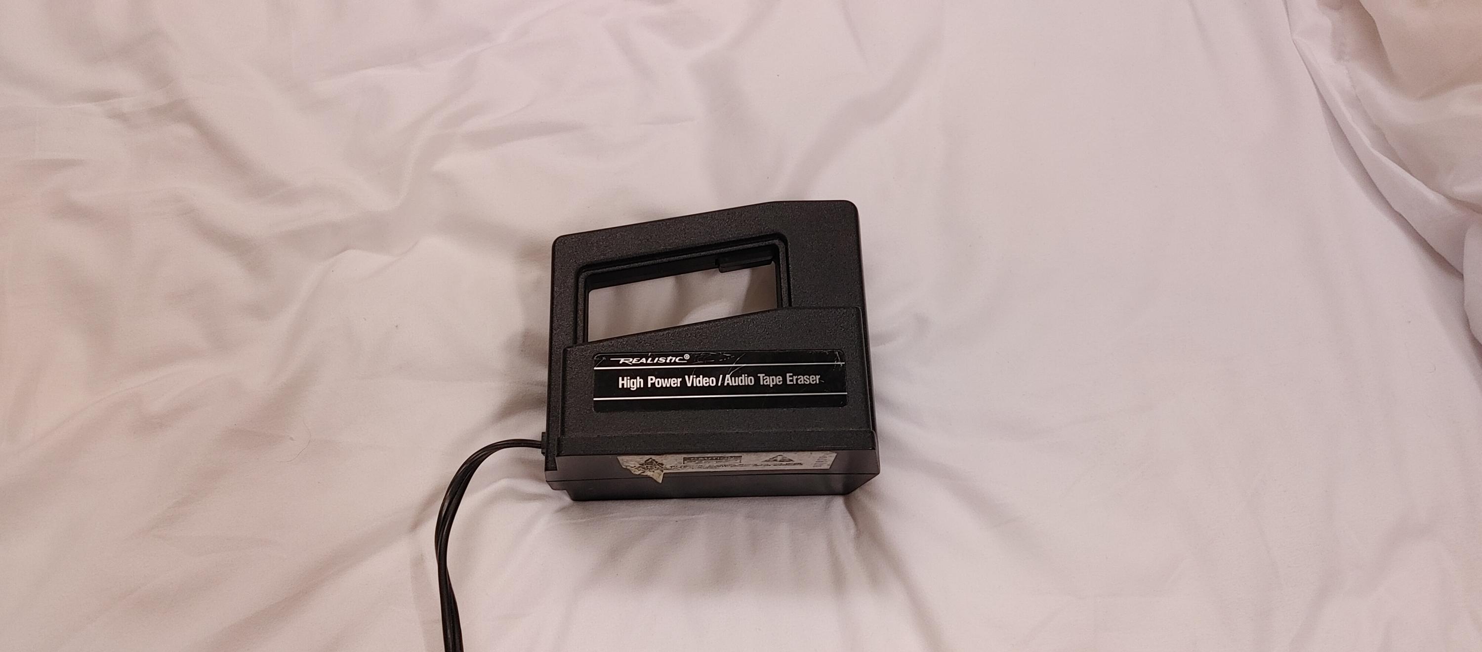

              And here's how I deal with troublesome floppy diskettes:
              And if that doesn't fix them, then this certainly will
              I did a teardown of the failed hard drive. Coming up next.

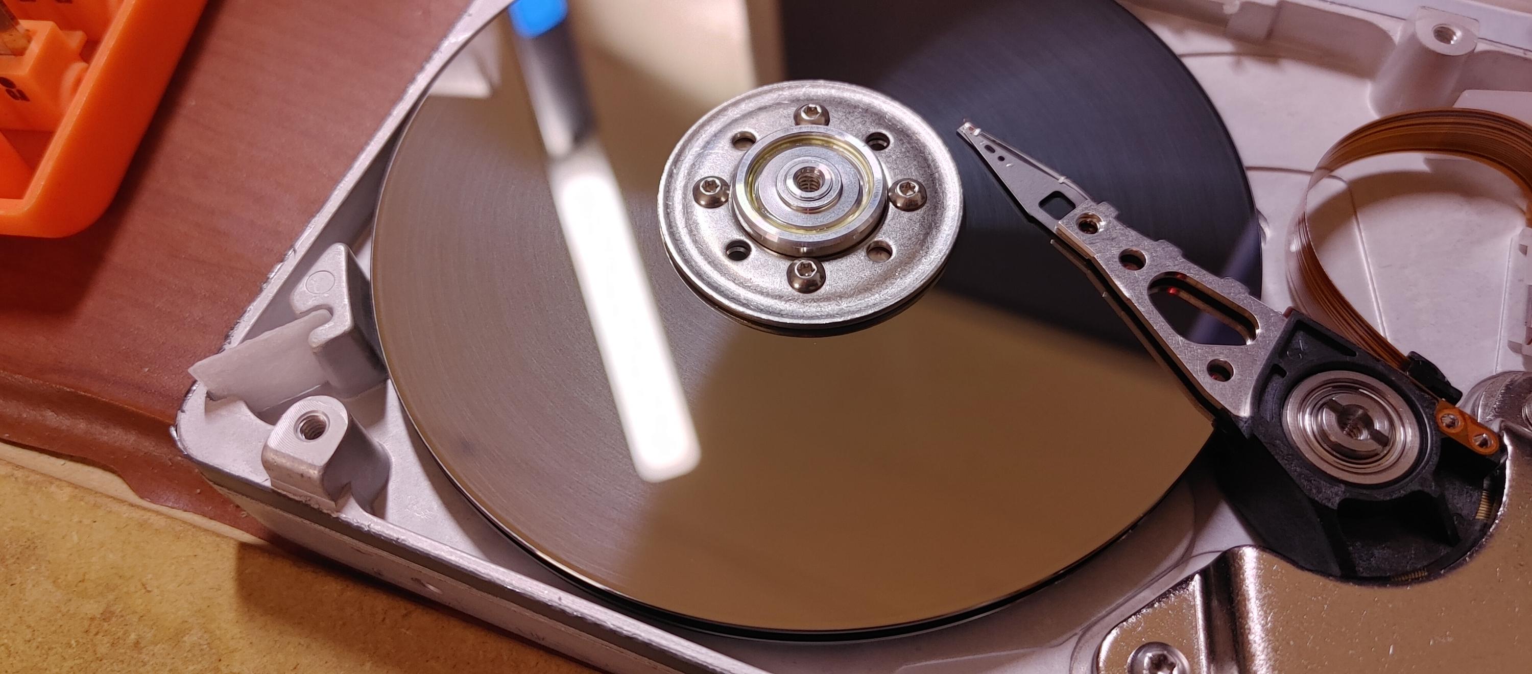

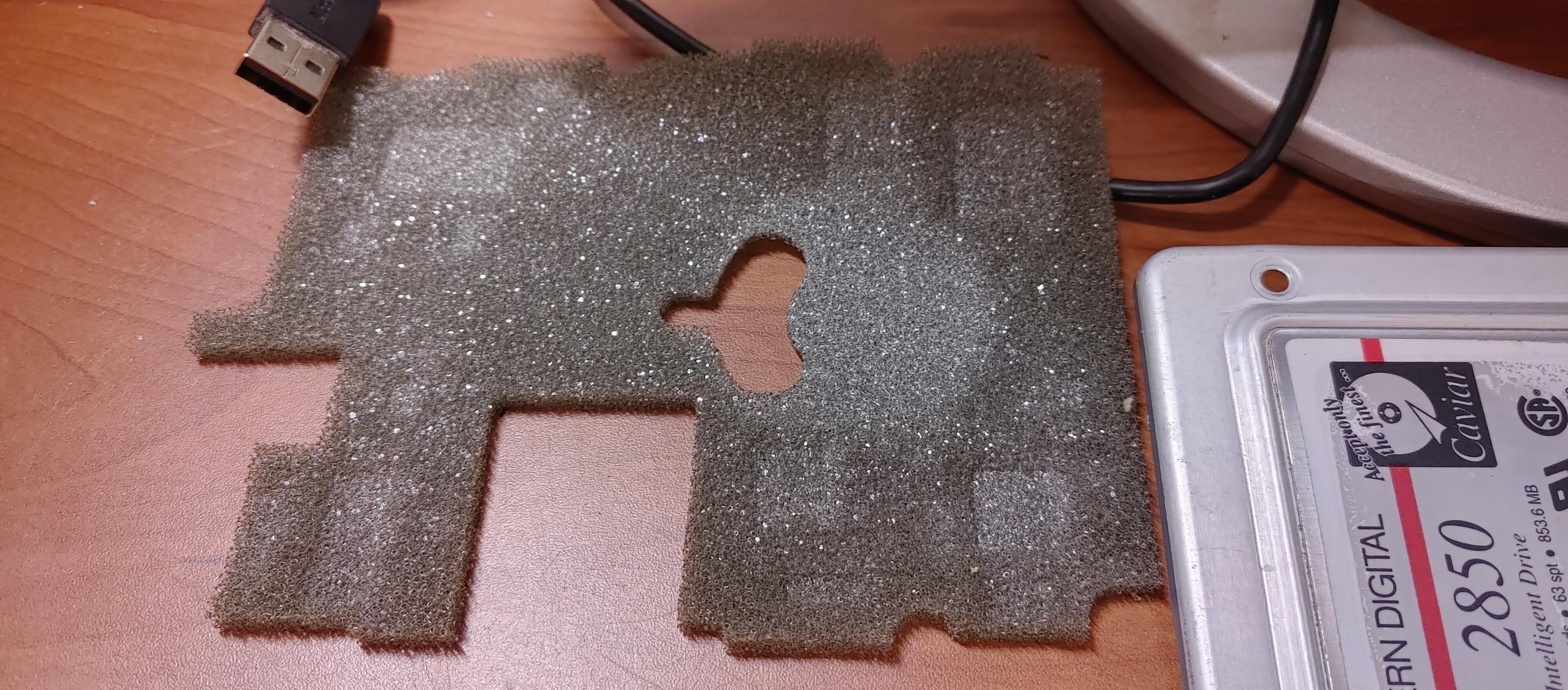

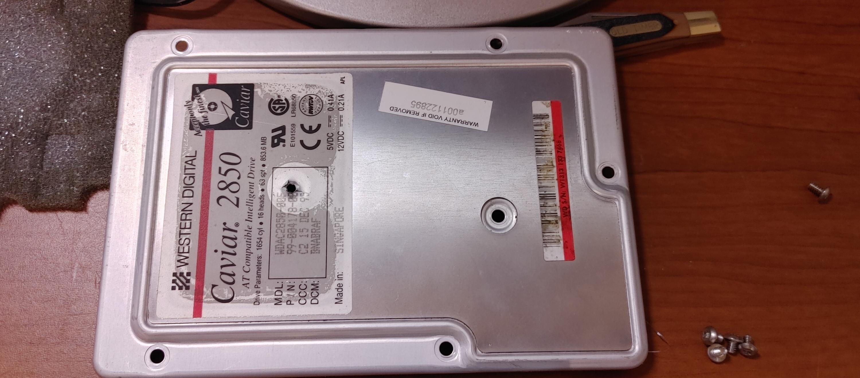

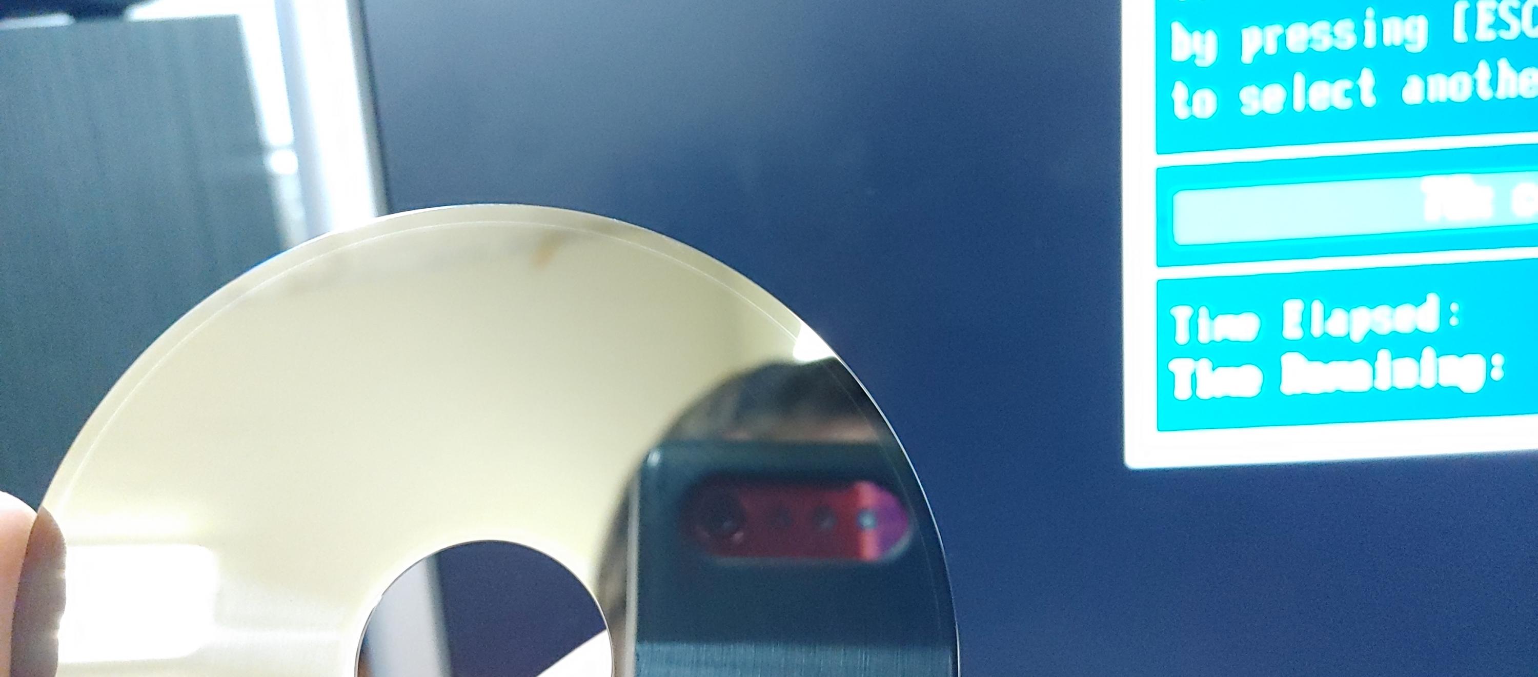

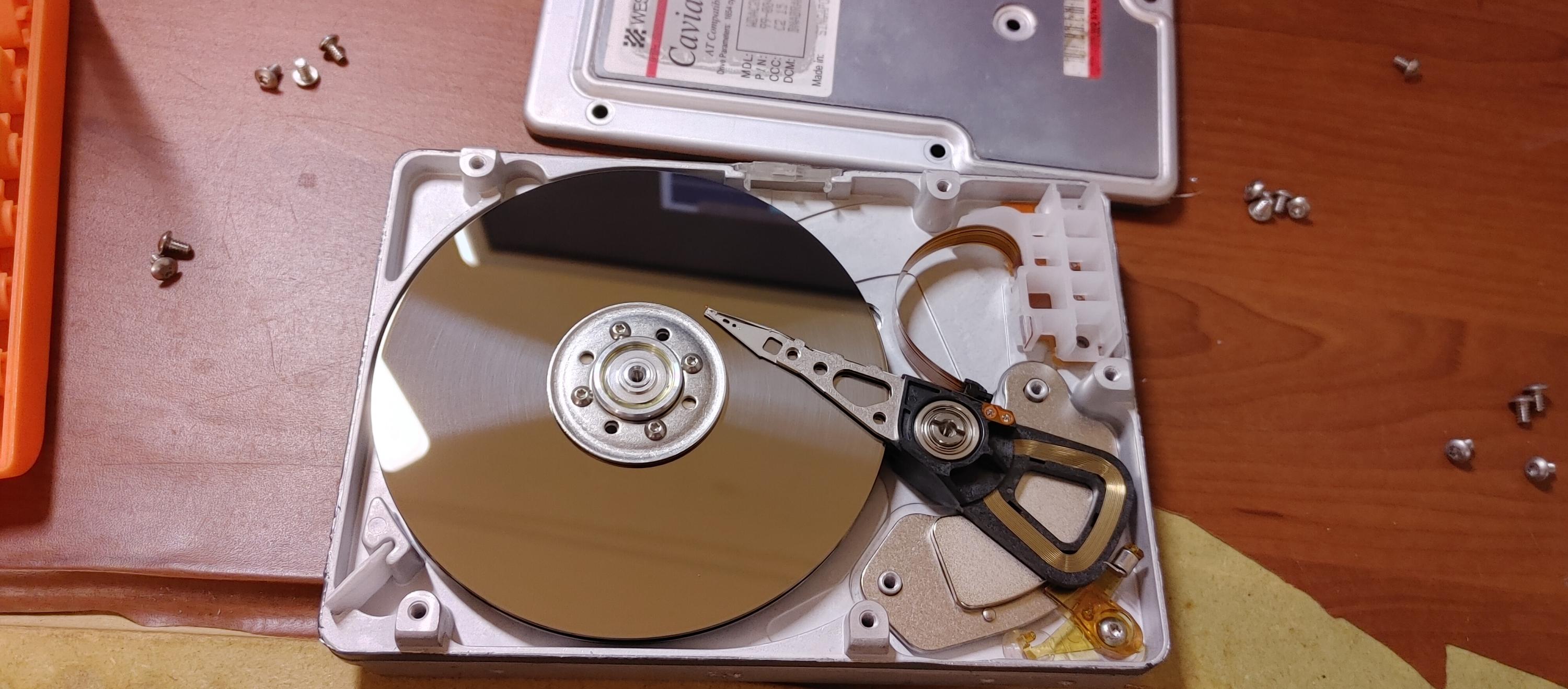

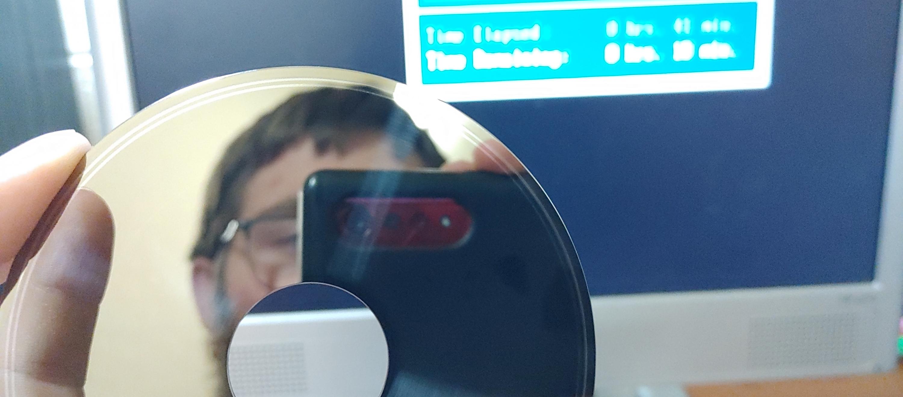

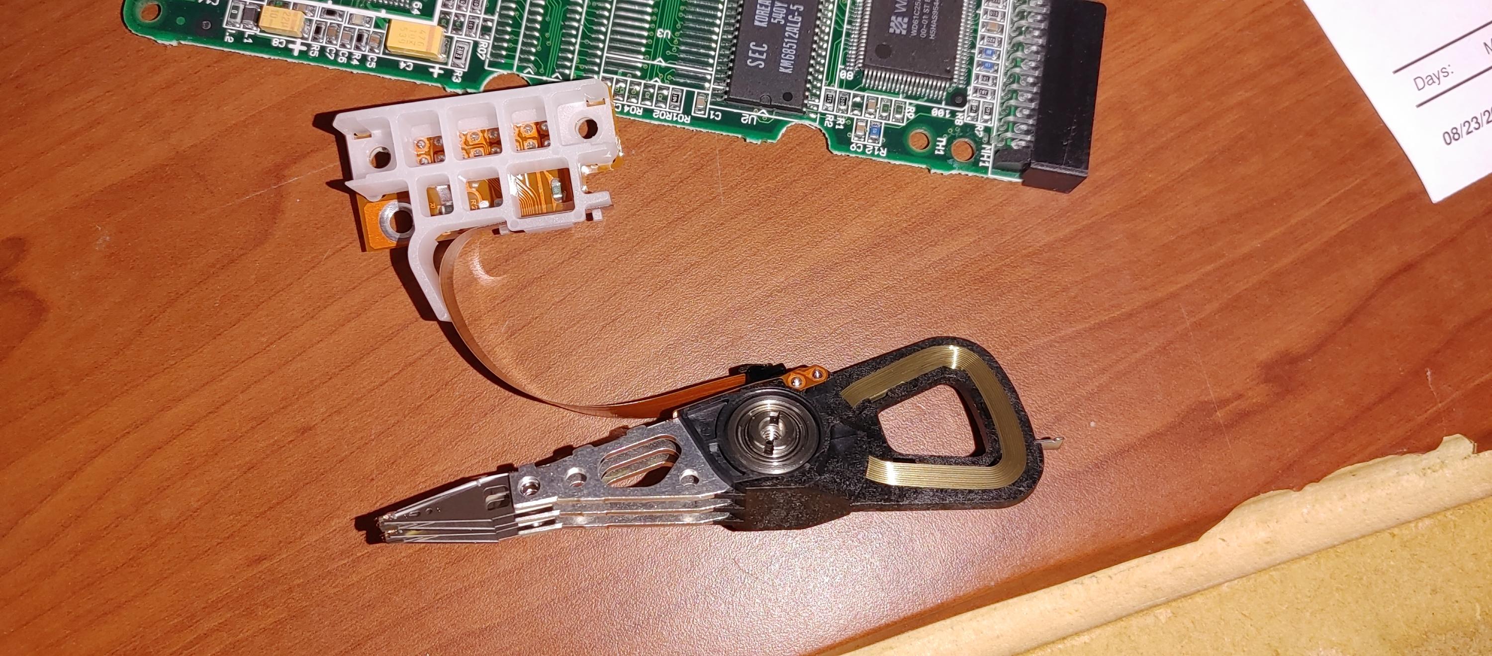

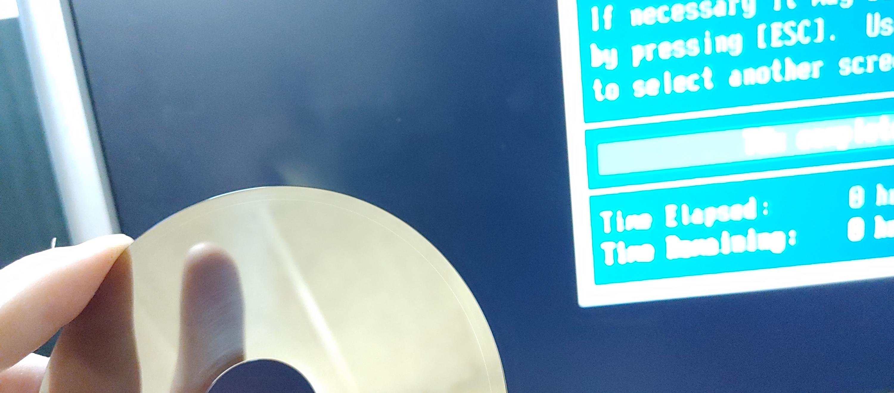

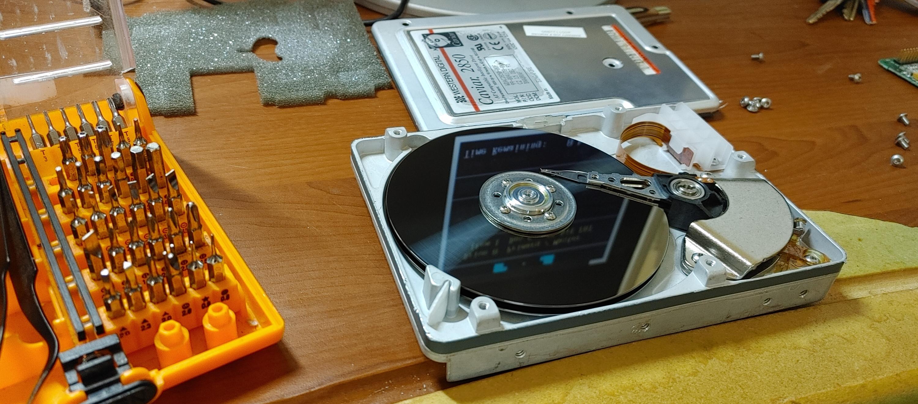

                Tearing into the failed WD 850MB hard drive to find out what went wrong.
                I'd already gotten pretty deep into the drive by this point, but what the hey. Signs of a disaster present from the moment I popped the drive open. Platters aren't supposed to have a brushed finish to them.
                A closer look at the evidence.
                Here's a different angle. You can see the damage better.

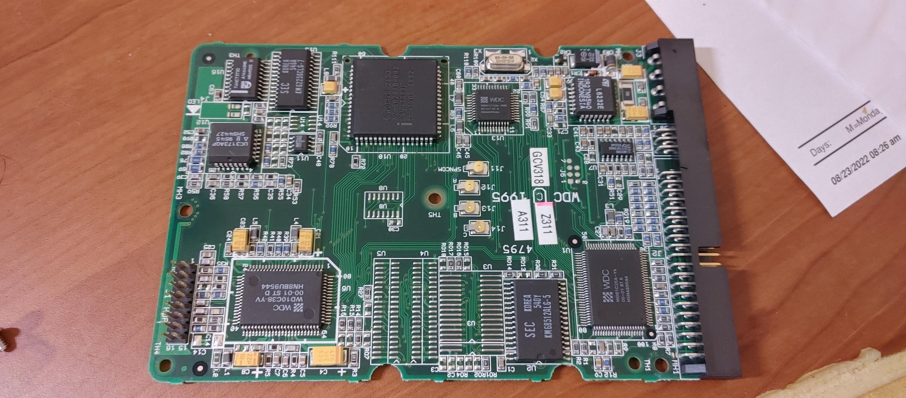

                The covered side of the drive's PCB, seeing the light of day for the first time in more than 27 years.
                Protective foam that almost didn't want to come off.
                Head stack.
                Cause of death: Head Crash. This was lurking on the bottom side of the top platter.
                Bottom platter, top side.
                Bottom platter, bottom side. Notice the brushed finish to the platters on every single platter side.

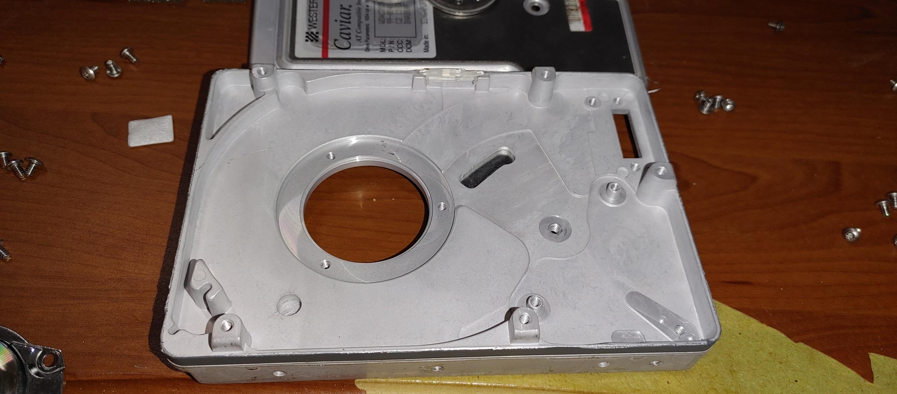

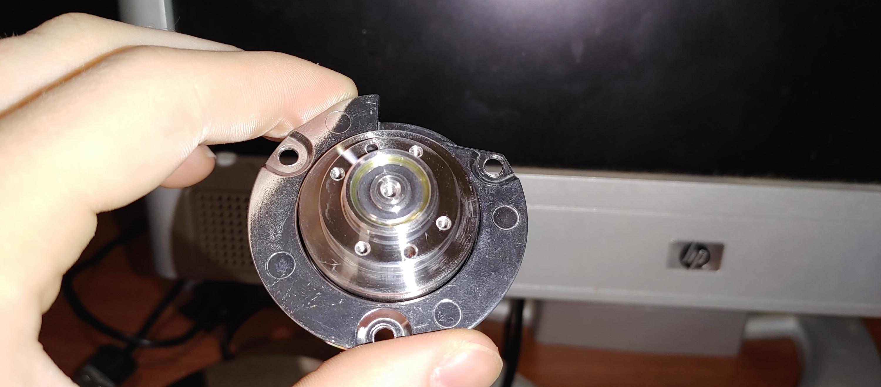

                Removable spindle motor! Still looks good.
                The drive chassis, stripped bare.
                We now return to our regularly scheduled programming...
                SpinRite 6 found nothing wrong with the replacement drive.

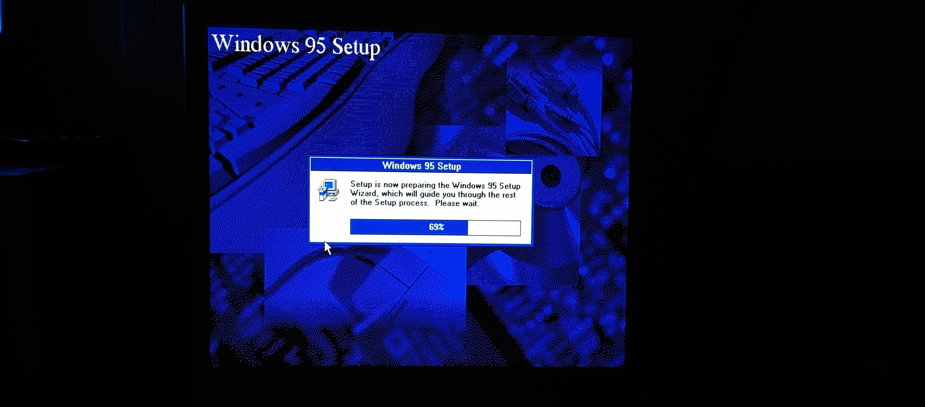

                A fresh install of DOS and now for Windows 95.
                While Windows 95 didn't take too long to install, it definitely chugs on the hard drive with only 8MB of RAM to play around with. It also breaks the drivers for the Sound Blaster Vibra/16 card, and it doesn't play nice with the card's wave controller. I'm probably gonna roll it back to WfW3.11 or OS/2.
                  Looks like it's time for a shave!!

                    about your battery leak
                    the 8042 keyboard controller socket is totally fucked and the chip pins need severly cleaning.
                    • Topcat
                      The Boss Stooge
                      • Oct 2003
                      • 16956
                      #70
                      Re: Gateway 80486-DX2/50 Revival
                      Good catch....and 100% correct!

                        Well his keyboard is working... just need to know if he can get in/out of protected mode...
                        • TechGeek
                          Computer Geek
                          • Jan 2015
                          • 2254
                          #72
                          Yep...
                          Permanently Retired Systems:
                          Kooky and Kool Systems
                          sigpic

                            I would still clean that rot off of there...
