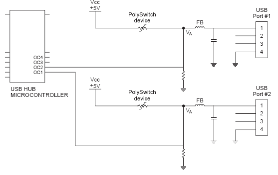

    I have had inexplicable troubles with USB.
    Could this Universal Buse be a little weak on the power side.
    My camera, give or take, 250mil, multi card reader, 100mil, wireless pointer,100mil, 802.11 transciever, 150mil.
    As you see I'm well over the 500mil limitation of this bus.
    I have a hub which I can use unpowered and yes I could drag around another small black brick to get say, four ports and 500 more milliamps of juice.
    The situation above is a laptop, but applies to any system as well.
    When my USB port is "overloaded" not only do things become unstable but,I may be off base here, I believe my caps get stressed.

    iirc there is a polyswitch to protect the usb port.
    if it trips you must remove the load to let it reset.

        I have never heard of a polyswitch?
        Could you go into that a little?

          Raycem showed this and other applications.
          Jim

            it is a overcurrent protection device that goes high resistance at a specified current.in order to cool down and reset the load must be removed.
