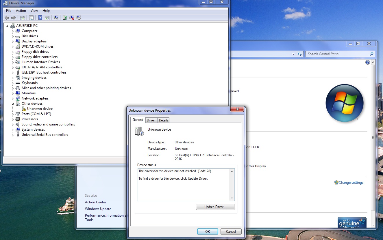

            Right, so Windows 7 works. But I have three problems.
            1. My rear speakers don't work with stereo music anymore... in other words, anything stereo only comes out the two front speakers. So the audio quality is now just shit... and I have an X-Fi!
            2. My Asus onboard wireless doesn't automatically connect no matter how hard I try.
            3. There is an unknown device on my Intel ICHR9 controller and I don't know what it is. Installing Intel chipset drivers didn't help at all.

                Well there's my problem... what kinda device is this?

                  Check the device IDs (via Details -> Hardware IDs) and search for those on the net.

                    I solved the unknown device driver through Windows update... it was called the ATK driver... whatever the hell that is... but nevertheless it solved the problem. Ironically Windows update had it under the "optional" section... optional my ass LOL.

                                  I bet you have an asus board right? the ATK ACPI driver is used for asus's motherboard monitoring program to communicate with the motherboard, is not required in any way shape or form.

                                    Yup, it's an Asus board. As stated in my sig, it's the P5K-E Wi-Fi model.
