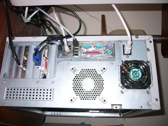

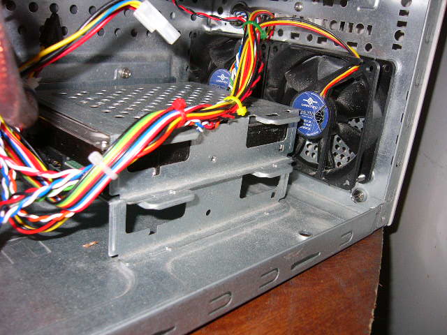

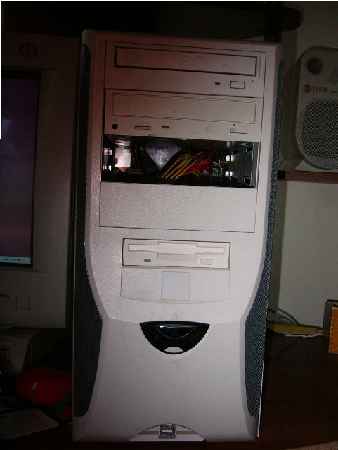

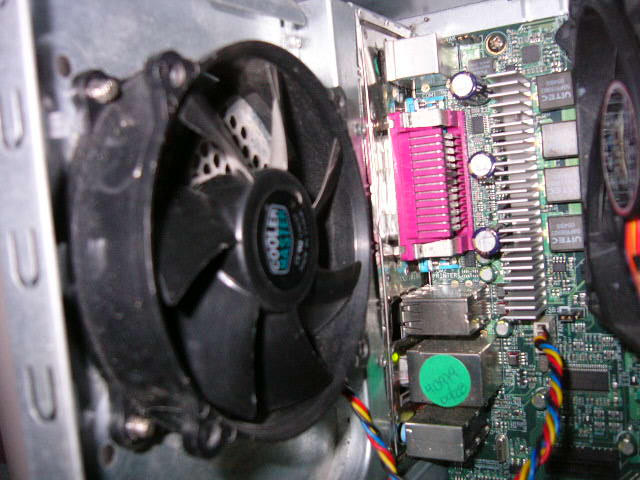

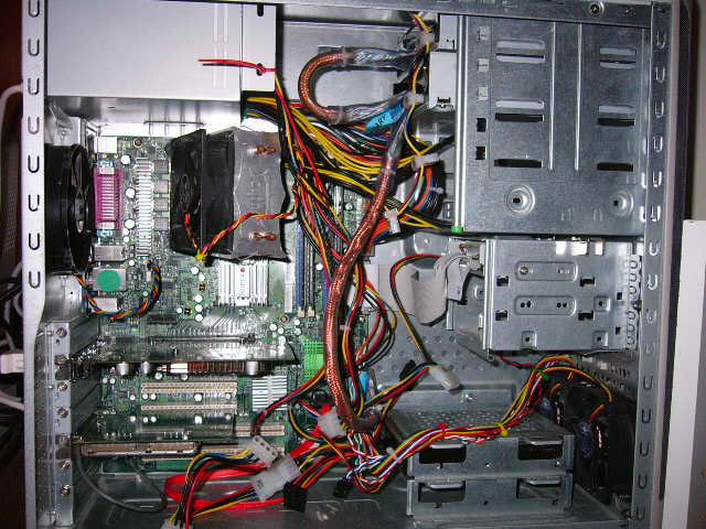

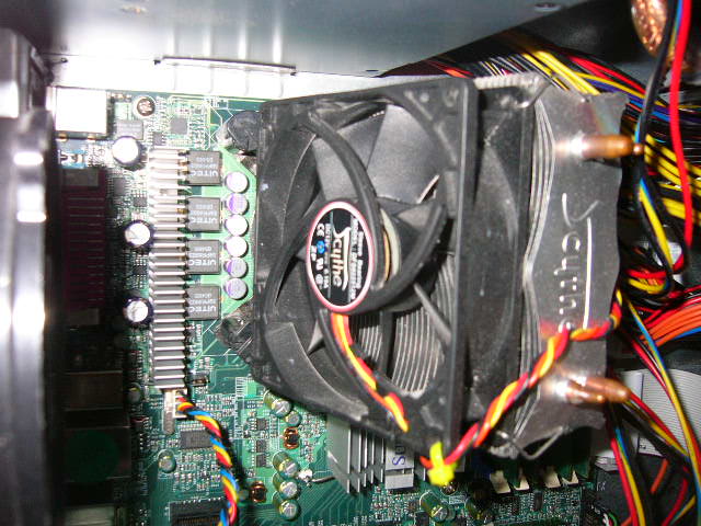

          Pics of tower #1!
          the front. missing a bay cover, sorry. the blue accents on the sides are mesh. It has 2 usb ports in the front.
          overview of the guts.
          the cooler.
          the cooler area again, but focused on the exhaust fan.
          the hard drive area. also, you can see the 2 front fans. they are 2 ball bearing, vantec stealth 80mm fans. They are very quiet, but move a lot of air. i got them with the psu (hypermicro had them for $3 a piece, so i said hell yes!). also, i streamlined the front cables with zip ties.
          whoops, forgot to rotate this one!
          the back.

            • 31204
            Re: My new tower fleet
            you get more airflow & less noise if you jigsaw the steel out infront of the fans & fit a wire guard instead of forcing the air through those tiny holes.
            • shadow
              • Feb 2007
              • 732
              Yes a simple wire guard would be a lot better for airflow than those perforated holes.
              However at the same time, those holes seem to be some what decent in size. It would be nice if they were a bit larger.
              I still have a case at home that has something like 2mm perforated holes! Now that is really bad, dust would just clog up between the fan and the 'fine mesh'.
              • ratdude747
                Black Sheep
                • Nov 2008
                • 17136
                for the fan guard, it does fine as is. besides, it is one of those odd 92mm fans with 80mm mounting. a wire guard would not cover it right. i'd rather leave it alone, the thing never goes very fast (it is pwm controlled).

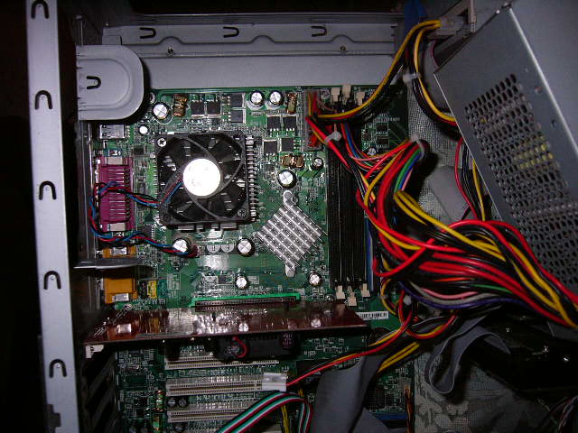

                tower 2 is dead. idk why it died, it might of been a cap substittion error:
                3900uf became 3300uf
                2700uf became 2200uf
                topcat's kit was supposed to have a slightly different set of caps. the one i got form him had that instead and an extra 1000uf cap.
                now it gives me 4 led's (cpu failure). the 1800+ might have been out of spec, so i tried the original cpu, a tested working 1ghz t-bird. same symtoms.
                it had no cmos battery. i doubt that is the problem.
                any ideas? if not, then i have no server... nuts!
                sigpic
                (Insert witty quote here)
                • seanc
                  • Nov 2008
                  • 1319
                  Unplug for a while, put a CMOS battery in, take all RAM but one stick out.

                    #29
                    i put in a cmos battery in vain.
                    it is sitting for a while... 4 error lights= bad cpu according to the manual.

                    • seanc
                      • Nov 2008
                      • 1319
                      #30
                      Any bulgers, any backwards? Checked solder joints? Got any spare caps to swap in?
                      • ratdude747
                        Black Sheep
                        • Nov 2008
                        • 17136
                        #31
                        tried that... when i put a stick back in, something shorted and i smelled something burning. thank god the bestec shut down when it shorted. its dead now.
                        well... i suck at recapping. i have no server, a cool but virtually useless case, and a mom who is mad at me for wasting money on caps for a dead board.
                        what sucks is now i have 2 useless hard drives; nothing i have can run them (remember the gaming box only has one ide channel; the other 2 have cases not meant for such hot-running drives)
                        sigpic

                            • kc8adu
                              • Nov 2003
                              • 8832
                              • U.S.A!
                              #34
                              just tell mom its cheap education.
                              as for the smell you probably got the ram in backwards and blew up the vdimm vrm.
                              i see this often.usually an easy fix.
                              fixed a ton of the compaq evo boards for this.they seem succeptable to this.
                              • ratdude747
                                Black Sheep
                                • Nov 2008
                                • 17136
                                #35
                                look. i think i f**ked it up when i soldered it. the needle method was rough on it.
                                ill probably post a wanted thread in the sales forum. it was in bad shape when i got it... and i killed it.
                                btw, all caps were in the right way, no bulgers. im sure the ram was in the right way.

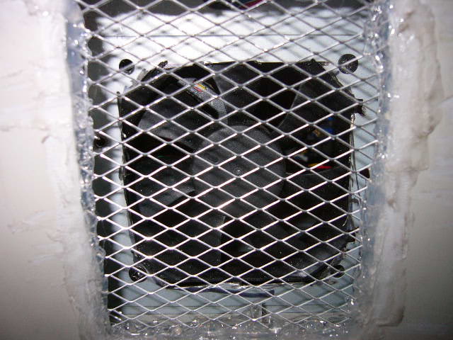

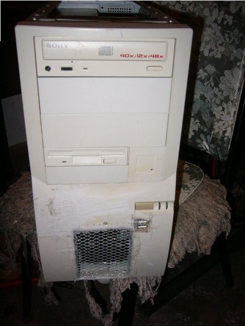

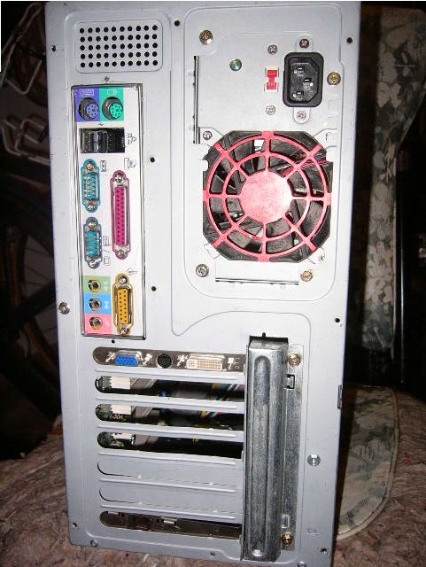

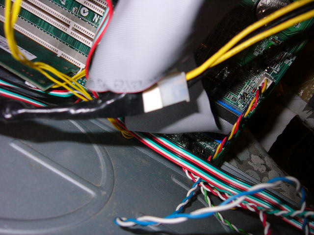

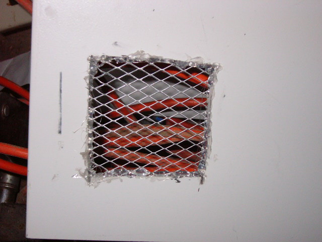

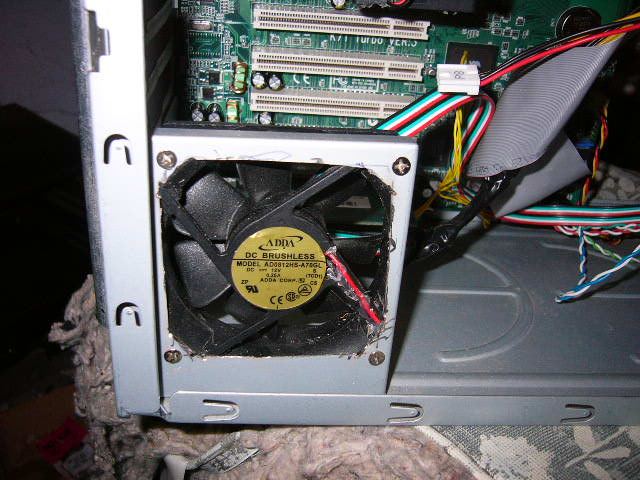

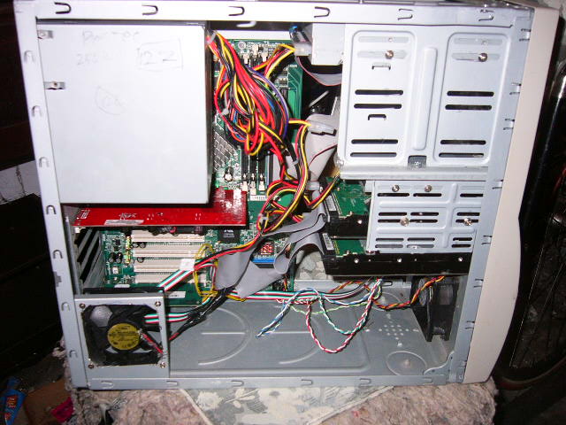

                                  pics of the dead tower #2:
                                  the front. i added a better front vent (see below), 2 usb ports, and better hard drive airflow (behind this bezel).
                                  the new front vent. the cover material is gutter-guard, hot glued in place. also, i dremeled out the existing fan mount so the fan could breathe, as this compact of a case need very good ventilation)
                                  the guts. i mounted the hard drives that way so they could breathe...
                                  the dremeled out side fan mount.
                                  the new side vent. again, hot glued gutter-guard.
                                  the p4 connector i attached to the side fan.
                                  the cpu area behind the psu. that fan (delta-made) moves a LOT of air... notice the chipset heatsink doesn't say MSI... this one has REAL fins... too bad the board is a goner.
                                  the back. i have no idea why i sharpied the fan cover of the psu.

                                        dental pic comes with a handle on it!
                                        btw, RatDude.
                                        that pc with the hole cut in the front.
                                        i'll tell you the correct method for that - for next-time.
                                        you move the fan from the inside of the metal - to the outside of the metal.
                                        then cut the front plastic skin so that the fan pokes through.
                                        it will stick out about 5-8mm usually.
                                        then screw a grill or - better yet, a filter to the outside of the fan.
                                        • ratdude747

                                          that would be uglier... the gutter guard kinda looks cool... i may paint it black. also the vent is also for the hard drives.
