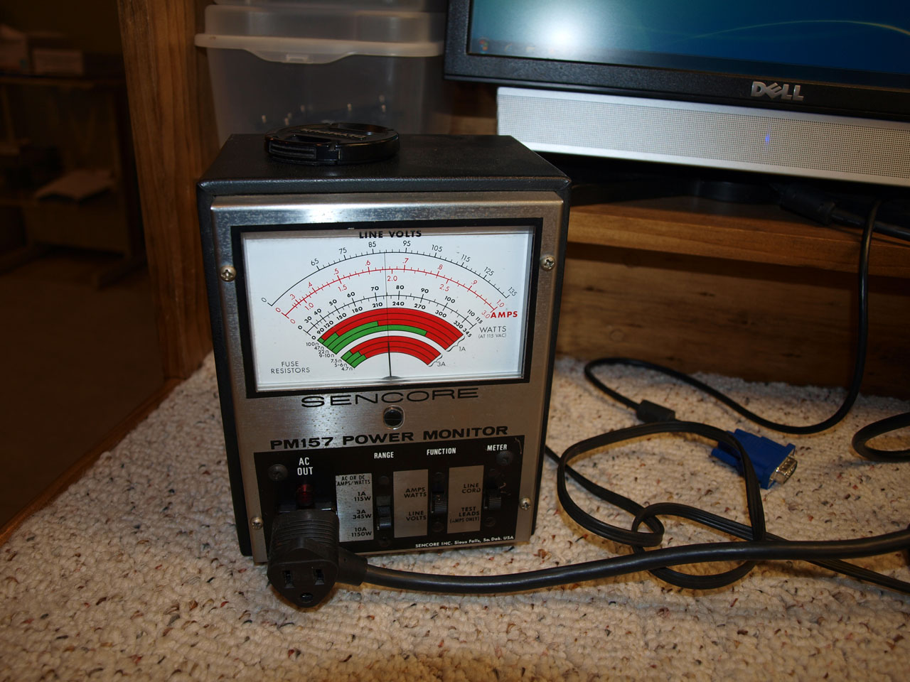

              Test system:
              Supermicro H8DA3-2
              2x AMD Opteron 8393 Quadcores @ 3.1
              64gb RAM
              2x Quadro FX5800's in SLI
              4x 2.5" 15,000RPM SAS HDD's in a RAID5
              The test bed is the above system being monitored from line with a Sencore PM157 Power Monitor on the 3A scale.

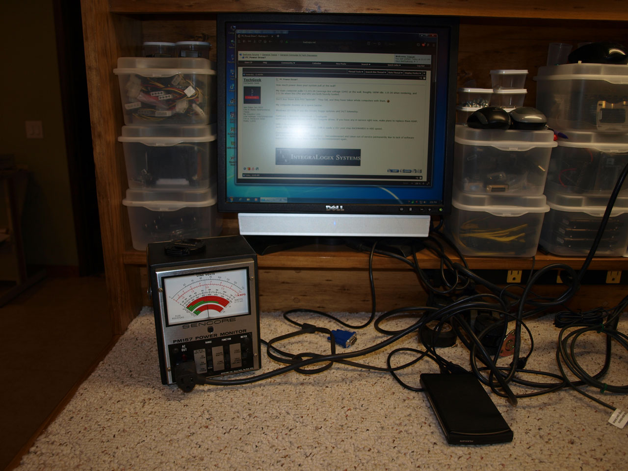

              Fully booted, sitting idle. Consistent between 1.8~2.0 amps.
              Same for web browsing, with minor up spikes during scrolling or graphical actions, didn't vary much from idle. A 4k youtube video playing kicked it up to ~2.2A during playback.

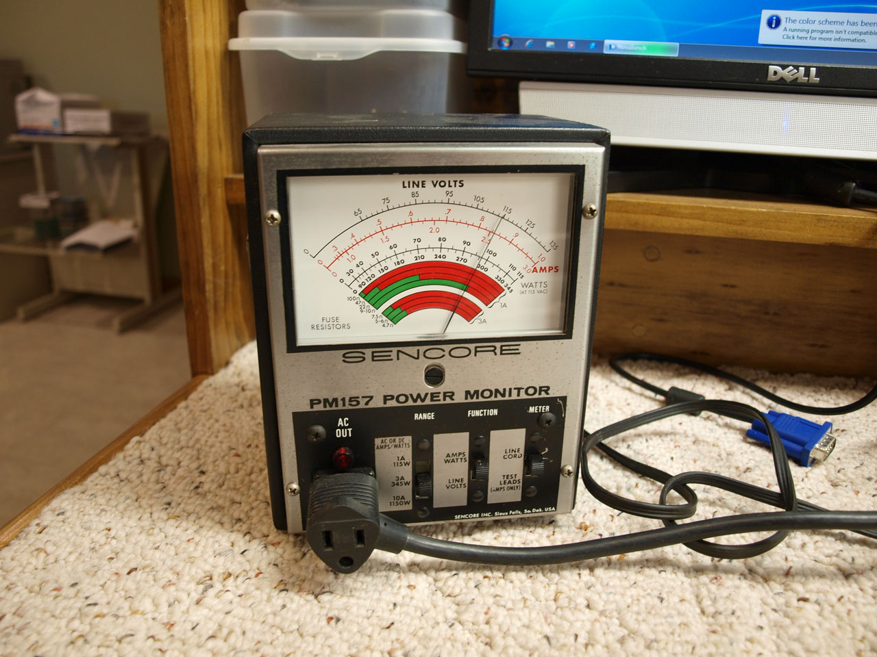

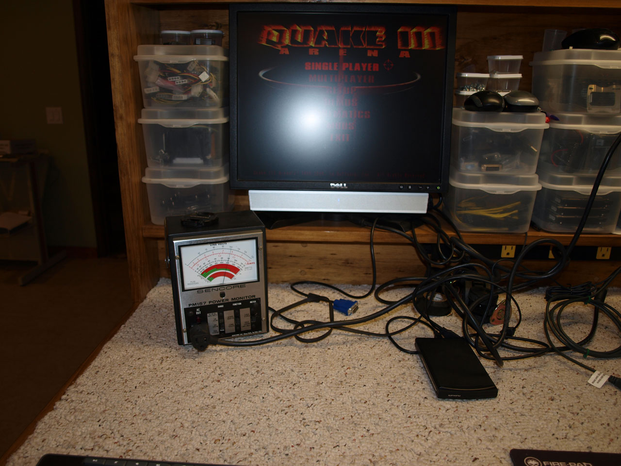

              Q3A (only game on the system at this time) loaded/playing is pretty consistent @ 2.3~2.5 amps.

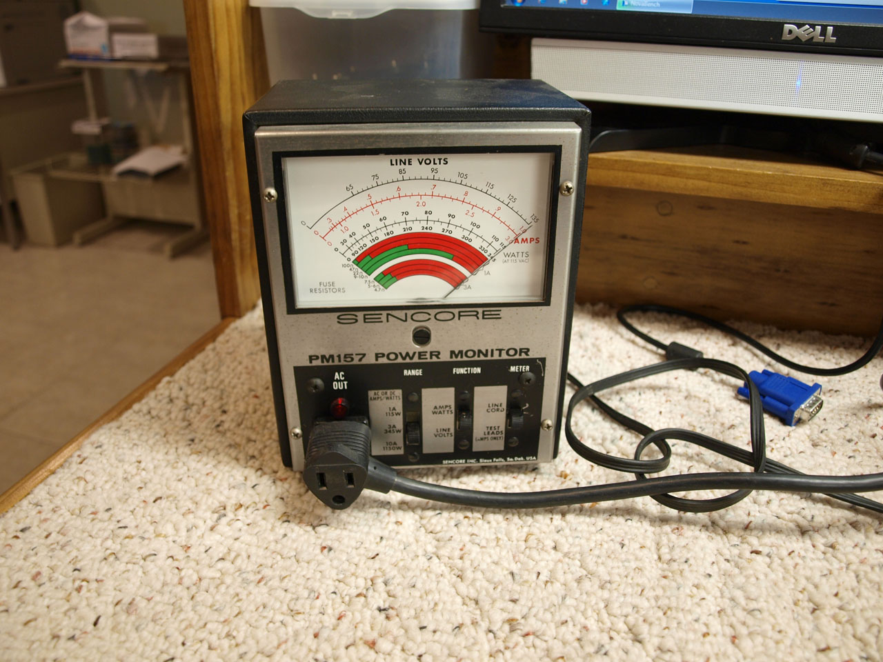

              Now I'm running Novabench. This is the HDD write test; steady 2.5A, both reads & writes.
              This is the GPU test. I'm not sure if Novabench takes advantage of SLI or not, but it bounced the needle off the scale throughout most of the test. I retested it on the 10A scale, and it never broke a 3.8A draw.
              Boot time, it danced around a little, but never pegged it out on the 3A scale.

                Can that Sencore PM157 even tell the difference between real watts versus apparent amps? I guess it doesn't matter if you have APFC but seems like a piece of equipment that has passed its prime...

                  Is this like the 'new math'? Raw amperage pulled from line, when did this change? Old meter? Indeed. Extremely accurate? Probably not. Good roundabout? I'd say yea. Unless someone has something better than a clamp meter or inline from harbor freight, feel free to share it.

                    Nah math is really old, it can't tell the difference between the real and imaginary components, i.e. phase angle of current draw.
                    Thus I'd can't even give it an accuracy assessment unless you're testing with a device with a PF very close to 1. It'd be completely wrong otherwise.

                      That would probably be beyond my knowledge.... While the numbers yielded seem to be in realistic ranges, the rest of that I can not intelligently answer....I just did the test and read the meter.

                        Ok, just warning you based on the photographs, there doesn't seem to be a way for it to discern the difference between a PF=1 and PF << 1 target device, and you'll get misleading numbers from the latter. Just mentioning it may be "obsolete" because there are devices out there that can tell the difference.
                        I suspect you probably use a APFC PSU so the numbers shouldn't be that far off from real power consumption. Just that a non PFC PSU will give "wattage" numbers larger than real power consumption - if you have an APFC and a non PFC PSU giving the same numbers, the APFC unit is drawing more money from your wallet at the power company.
                        (And as an addendum, this is not a "bad" thing. It's just that you'd actually be using that power, versus wasting it or unable to utilize it in the case of the non-PFC PSU!)

                            It's always nice learning something on my own forum. Thanks for the information. FWIW, this PSU is a Supermicro PWS-865-PQ 865w unit. I should have put that in my original post; it seems pertinent information.

                                      Originally posted by Topcat
                                      Yes, I understand the concept. I think perhaps my question was rather how would a 'modern' say "Kill-A-Watt" read this versus the trusty old Sencore?
                                      Not quite sure... but I think that Sencore (or just any AC ammeter) likely just measure the voltage drop over a current shut and then amplifies the magnitude of that to give a reading on the scale.
                                      Whereas with the Kill-A-Watt, it measures not only that but also the AC voltages before and after the current shunt, and probably some other parameters about the voltage waveform. From these, it's likely what enables it to calculate the real power.
