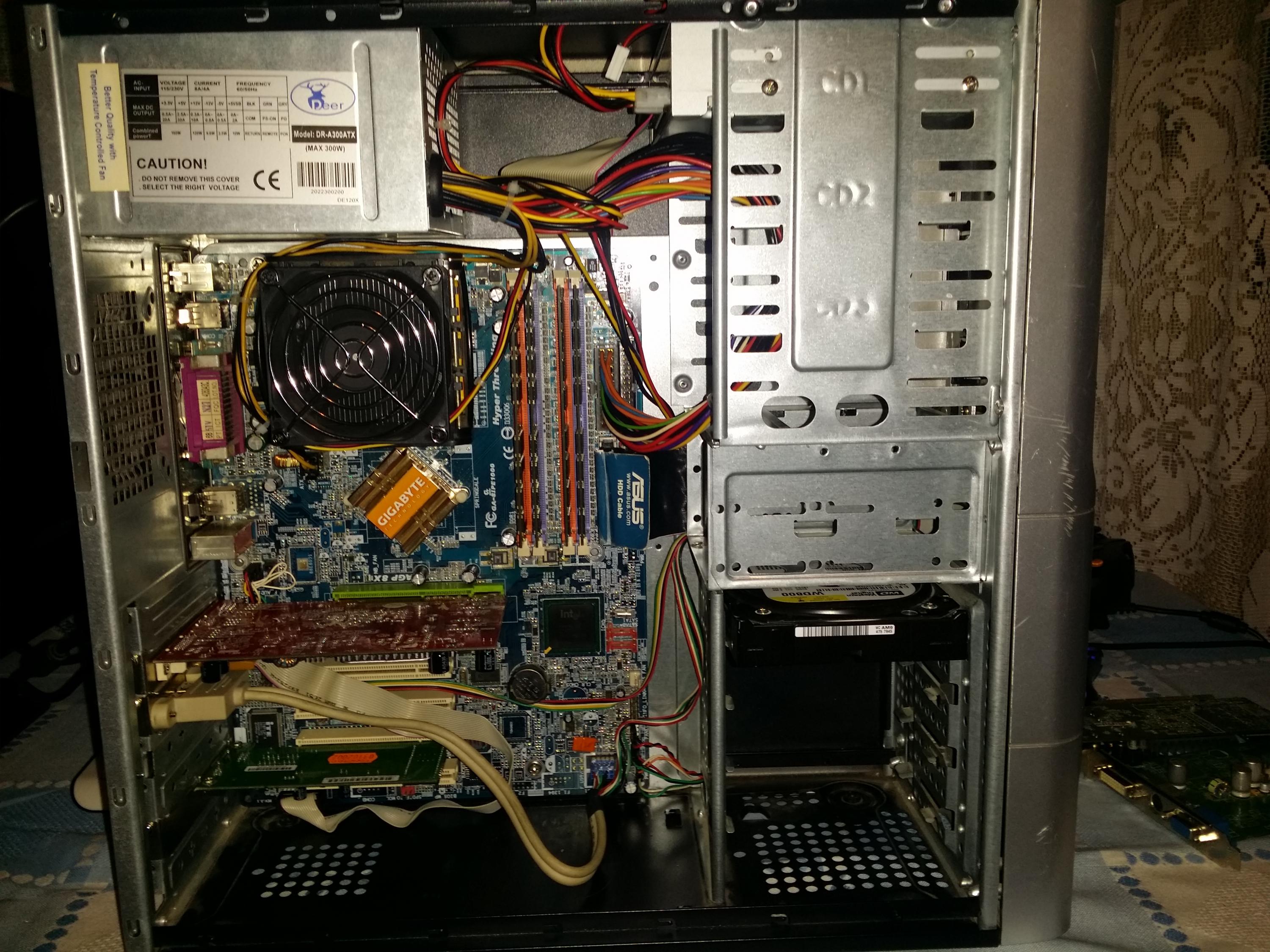

                  1:
                  Gigabyte GA-8IPE1000
                  Pentium 4 2.8GHz Northwood
                  Deer DR-A300ATX (recapped and modified)
                  2.75GB RAM (2x1GB, 1x512 and 1x256)
                  Palit Geforce FX5500 256MB
                  RTL8139 PCI NIC
                  WDC WD800JB 80GB IDE HDD
                  TSSTCorp SH-222A DVD-RW
                  Delux MT375 case

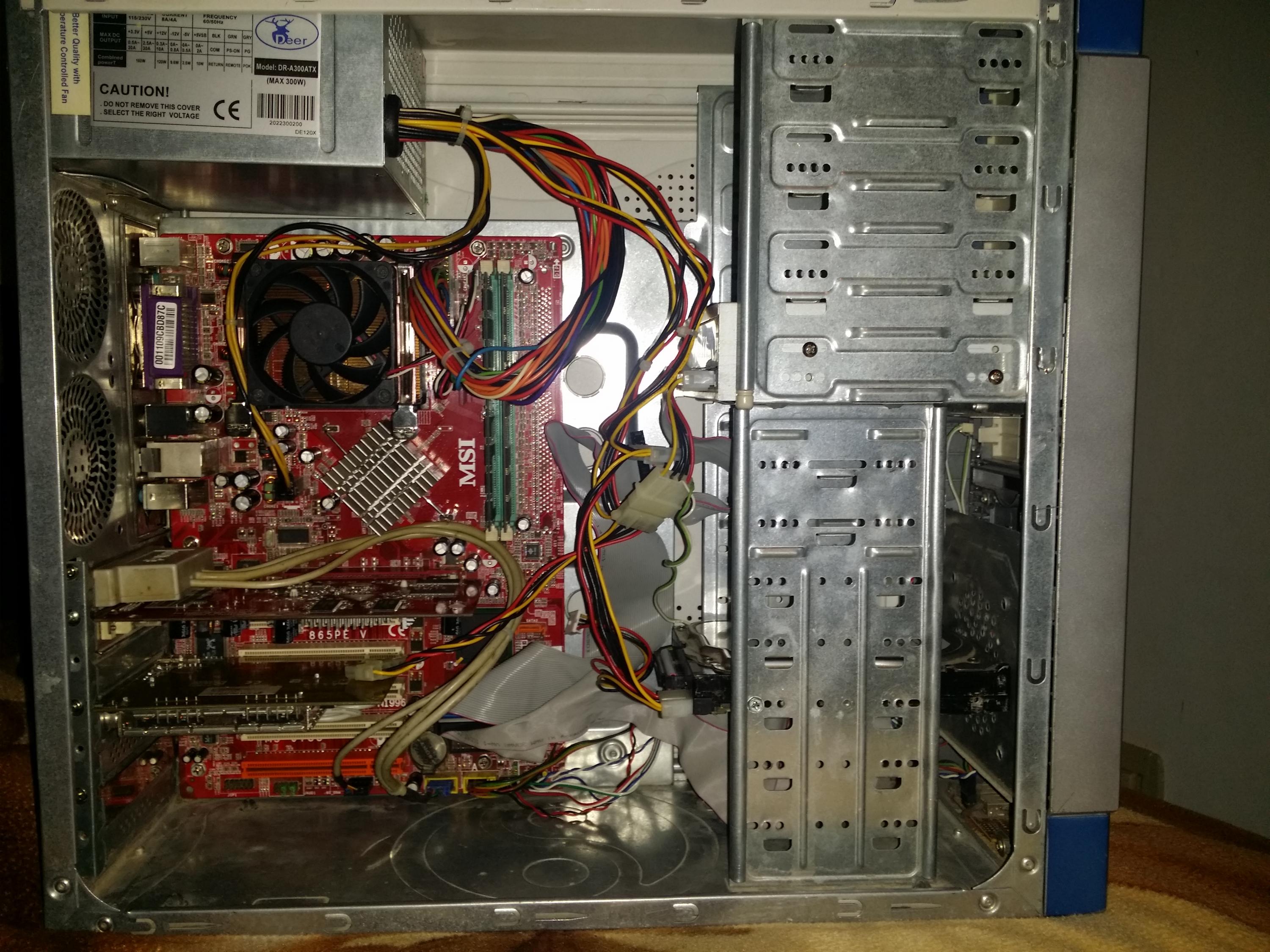

                  3:
                  MSI 848P Neo2-V
                  Pentium 4 2.8GHz
                  ANS LC-B350ATX (recapped and modified)
                  1GB RAM
                  Palit Radeon 9550 128MB AGP8x
                  TSSTCorp SH-S162D DVD-RW
                  Pixelview PV-TV304P+ TV Tuner
                  JNC RJA FQ-8670 case

                    Cool!
                    I like the cable management in that ASUS P5GC-MX/1333 system.
                    The case of the MSI 848P Neo2-V system looks awfully cheap, though (I can see the metal is bent in quite a few places on the HDD cage from the HDD screws ).

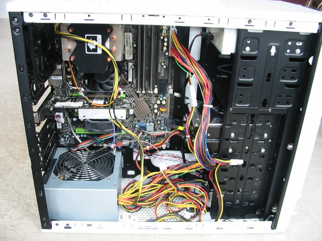

                                  my E-VGA 780i-SLI PC "build"

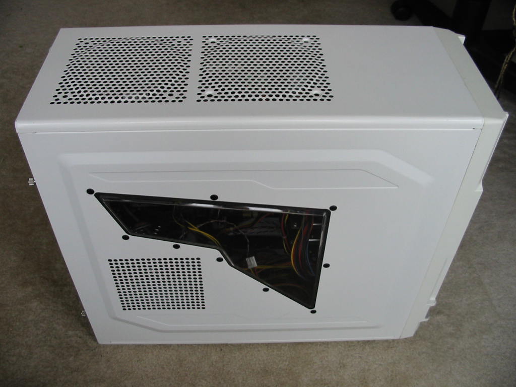

                                  New year and time for new PC builds, right?
                                  Well, okay, this build isn't exactly “new” stuff, nor did I start it this year. Rather, some of its parts have been waiting on my shelf since 2015-2016 or so. I actually started the build last Spring (2017) as a test for some of the parts, like the motherboard… but more on that below. First, some pictures of the case:
                                  Yeah, honestly, I'm not really a fan of these newer “gamer” cases, but it fit the style of the whole PC in many ways: for one, this was meant to be as the “newest/latest” gaming PC in my collection, and I feel the hardware inside is equally-matching to the quality/looks (or lack thereof) too. Speaking of which, here are the hardware specs (which are probably still subject to change):
                                  CPU: Intel Core 2 Quad Q6600
                                  Motherboard: E-VGA 780i-SLI (model 132-CK-NF78-A1)
                                  RAM: 6 GB (3x2GB) Corsair XMS PC-6400 DDR2, 5-5-5-18, 1.80V, ver:4.3
                                  Video Card: MSI GeForce GT 430 GT 1GB DDR3 (model N430GT-MD1GD3/OC/LP)
                                  CPU cooler: Dell XPS 630 (0N764D) 4-copper heatpipe cooler
                                  HDD: 500 GB Samsung (Seagate?) HDD
                                  PSU: 400W FSP/Sparkle AX400-PN REV-1 (recapped)
                                  Case: Thermaltake Commander MS-I Snow Edition
                                  Some parts history “fun facts”:
                                  The Intel Q6600 CPU was a $4 eBay special from a few years back (when they were still worth about $20-25). The seller simply had it mislabeled in the auction as a E6600, implying a Core 2 Duo. So I got lucky with that one, as I literally saw it a few hours before it was ending. No one even bid on it!
                                  The EVGA mobo was an eBay “special” too: it was listed as “for parts or repair”, because seller said his PSU blew up one day and the mobo “released some smoke”. Perhaps it really did. But I think I found the culprit! - A tiny SOT-23 regulator transistor for one of the AUX fan connectors was blown open (literally and electrically).
                                  https://www.badcaps.net/forum/attach...1&d=1552873811
                                  Aside form that, though, nothing else was wrong with the board. Thus, it ended up being a steal for the $20-odd I paid with the shipping (which is a lot less than these boards still go for currently.)
                                  The CPU cooler… was also from eBay (yes, perhaps I do have an addiction. ) It was just the cheapest 4-heatpipe cooler I could find anywhere – even cheaper than the no-name Chinese versions. And it's a Dell Precision/XPS high-quality part, so I couldn't go wrong for $11 shipped, right? Only con was that there was no mounting hardware with it, so I had to come up with my own… but when has that ever stopped me?
                                  As for the RAM, video card, and case – these all came from my last job as scrap parts. In particular, the RAM and video card were recycle-bin picks. The GPU had a completely seized fan and the RAM was actually 4 matched sticks, but one ended up being finicky / not wanting to detect (hence why the system ended with 6 GB). Meanwhile, the case wasn't a recycle-bin pick… but it was headed there – a co-worker brought it for recycling for a friend of his. I asked why, as the case didn't seem that awful (despite being a lot more dirty than pictured above), but didn't get an answer. Since he saw I was interested, he asked if I wanted it. And I couldn't say ‘no'. Gave him a fiver to get coffee / snack on me.
                                  Finally, the PSU: I got it in a bundle of PC hardware also a few years back… from eBay again, of course. (Yup, definitely an eBay junkie. ) I was mainly after a cheap 80 GB WD HDD, but then saw the seller also had a socket 754 mobo going for cheap, and a PSU in another auction. No one bid on the items and the seller re-listed all of them even cheaper. After no one seemed to be interesting again the second time, I decided to try getting them all… and I did. The K8V-SE Deluxe mobo is actually still running in the repainted/restored Pac-Man case I posted on BCN.

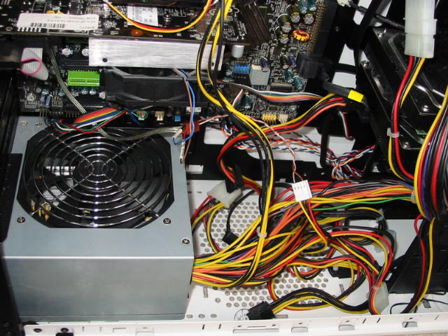

                                  So anyways, that's all for the parts. Now for some internal shots…
                                  WARNING! Try not to fall off your chairs from laughing.
                                  Did anyone say this belongs in the Ghetto Mod Thread? I hear you! And I don't disagree at all. Indeed this is far from a clean build… but quite regular for my “toy” / “gaming” PC boxes, which I typically literally slap together just to try some new game (or set of games) that I haven't tried/played before. Case in point with the slapping together: the beautiful cable management. But it's more than just a mess of wires if you look closely. In the 2nd and 3rd pictures for example, you can see some telephone/ethernet wire strands going between a floppy connector and a fan connector – that's for the rear 120 mm fan, which is wired for constant 7V (positive wire to 12V rail and negative to 5V rail for 7V difference ). And while at it, why not run the GPU's ghetto-mounted 70 mm fan also from that same tap by shoving the wires right into the rear fan's connector? Makes sense, right? Speaking of the GPU, and why I modded it – more on that here. But hey, at least I have a very short SATA cable going between the HDD and motherboard, so that is clean. (Though the real reason for this is that I have quite a few short SATA cables from scrapped Xbox 360s that I don't have much use for… so any chance I get, I shove them somewhere ).
                                  The 4th picture shows the mighty Dell CPU cooler. It is quite nice actually. What's not so “nice” is my way of mounting it to the motherboard:
                                  Yup, those are wooden “nuts”. But hey, they work quite well and at least I am not warping the crap out of the board, like those stock Intel heatsinks. This is because the Dell cooler actually has spring-loaded screws.
                                  In terms of cooling, this Dell tower cooler is quite good, thanks to its 4 heatpipes and 92 mm, 3600 RPM fan - a real screamer no doubt! (Probably a Delta, I imagine.) Of course, being PWM and all, I have it running much slower. In fact, when the PC is idle, the CPU fan spins at around 700-800 RPM, keeping the CPU to around 38-40°C in a 18-20°C ambient room temperature. Under load, however, it's quite different. I set the fan curve to kick at max speed when the CPU is at 70°C. This means for temperatures in between, the CPU fan varies between 800 and 3600 RPM. To see how the fan/cooing performs, I tried OCCT's Intel LinPack test on all cores. With that, the CPU reaches around 50-53°C and the fan kicks up to about 2500 RPM – which is rather audible. But I like to keep things cool. In practice, of course, no matter how I load the CPU (even in newer games), I never see the CPU use (and Pd) go as high as the OCCT LinPack test. Thus, the CPU fan rarely goes above 2000 RPM, if even that.
                                  Of course, worth noting is that I do have the CPU running at stock 2.4 GHz speed *and* under-volted to 1.16125V, which does reduce the heat output (CPU is perfectly stable at that voltage in OCCT LinPack). This is probably what allows the PC to stay quiet, more or less. In fact, the loudest part about this build is the Northbridge fan.
                                  Speaking of which, the stock NB fan that originally comes with this motherboard is just a puny 50 mm screamer that can barely keep the NB under 55°C running full speed in 20°C room temperature (and an open case, at that). With hotter ambient temps, one has to wonder how high the NB temperature goes. And of course this being an nVidia chipset from the bumpgate era, it's no wonder why there are just as many of these motherboards dead as there are working ones.
                                  For this reason, I gutted the stock 50 mm NB fan and installed my own 70 mm fan. Originally, I had an Xbox 360 fan on that too (it was the one from the GPU, actually), and it worked quite well. But I didn't want to risk the fan wiring coming loose and letting the NB overheat. So instead, I installed a normal 3-pin 70 mm fan connected to the motherboard's NB fan header. This allows me to (supposedly) control its speed from BIOS too (which doesn't seem to work that well on my board, actually.) Either way, my NB temperatures didn't improve at all: about 52°C with the motherboard sitting idle in 18-19°C room and close to 55-56°C after several hours of gaming… which, BTW, also raises my room temperature to 20°C (so this PC nicely doubles as a space heater! ) But at least my 70 mm NB fan runs more quiet than the stock 50 mm one. If one really wants to improve the NB/SB cooling on this motherboard, the stock chipset cooler needs to go. I'm not sure who designed it (whether it was EVGA or Intel, as this motherboard is made by Intel), but there are just so many flaws with it. It seems to mostly spread the heat around the board and not really actually remove it. I bet even a stock AMD Athlon 64 CPU heasink on the chipset will cool it better (and this is what I might actually do some day.)
                                  But for now, that's all there is to this PC.
