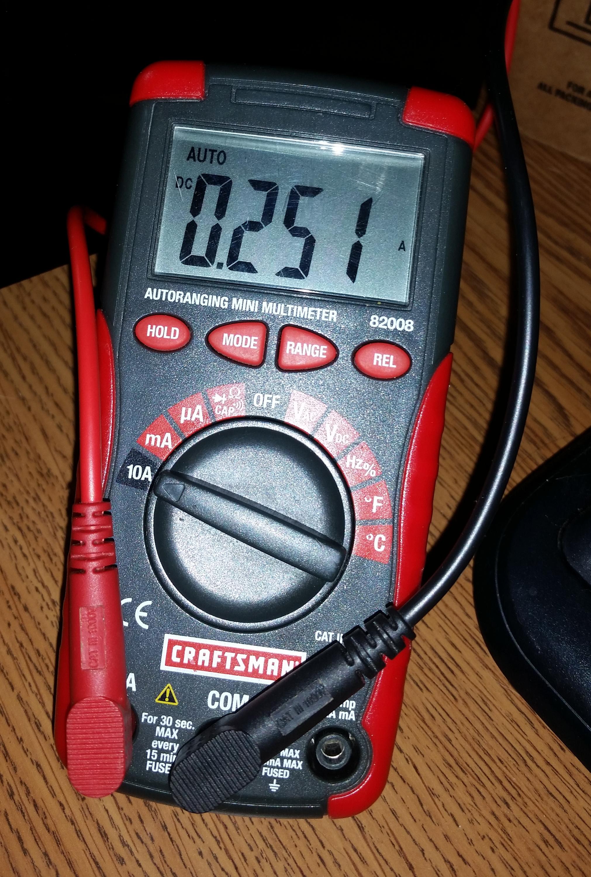

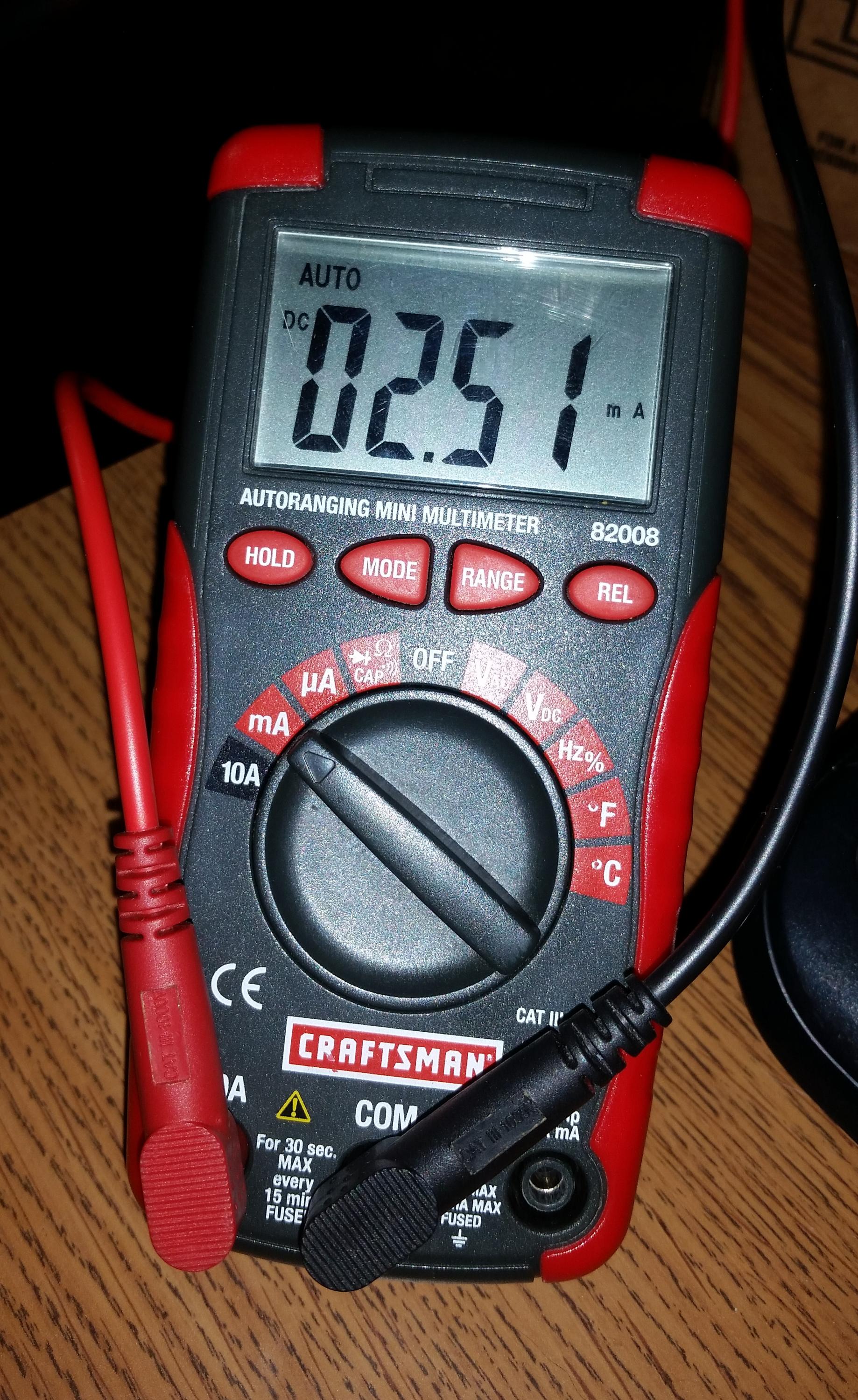

    So my Multimeter thinks 0.25 A = 2.5mA
    This is 5V with a 20 Ohm resistor for a load
    My meter can only display Amps correctly and it thinks you convert A to mA by dividing by 10

    Re: So my Multimeter thinks 0.25 A = 2.5mA
    User error.
    Supposed to use the other jack for the mA mode.
