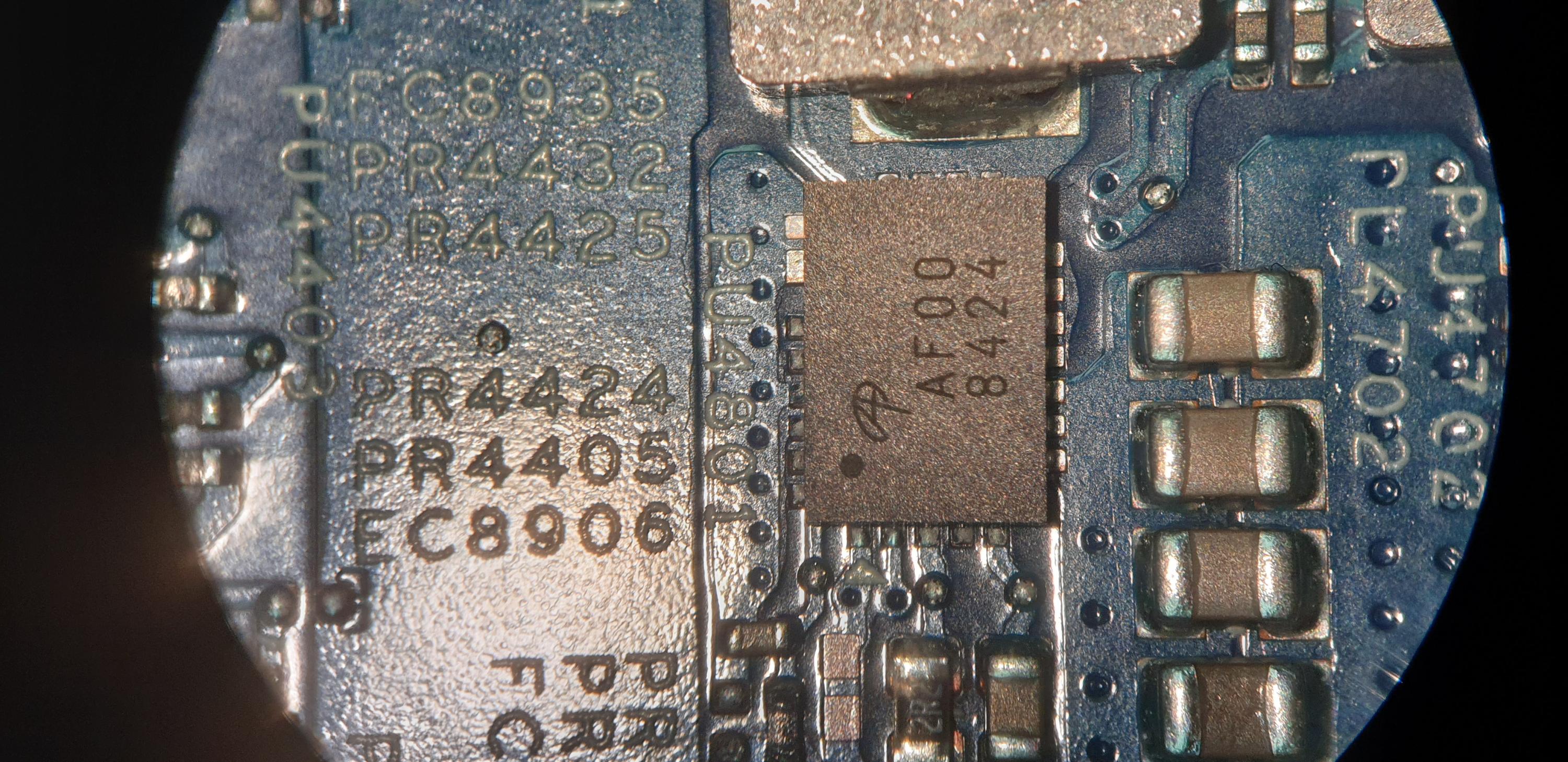

    Can someone tell me what that part is called? I couldn't find a datasheet.

    could be AOZ5547QI

      I agree with stj, it is a Alpha & omega AOZ5547QI
      Part # AF00
      Y=8
      W=4
      lot code = 24
