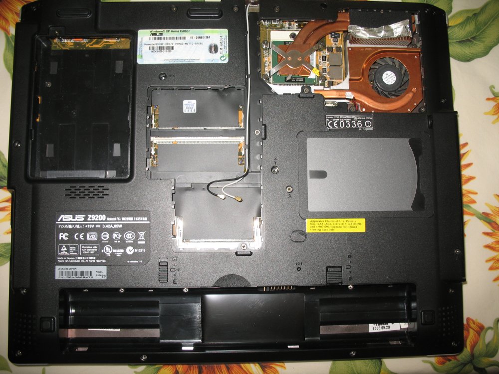

    My sister's laptop Asus Z9200 VA is dead, if you start it up it shut down within 10 seconds and than restarts again in an endless loop.
    AFAIK it is 3 and half years old and was paid more than 1500€ but since it is out of warranty my brother-in-law bought a new laptop instead of send this one to service.
    He asked me if I want to try to repair or if I want to sell it as spare parts for someone who need some pieces.
    I really don't know how to start to troubleshoot it, what I see is it shuts down after 10 seconds. I don't hear the CPU fan starting while usually in laptop it starts immediately.
    It has begun with problematic boot and random freezing and within 2 weeks it doesn't start at all.
    Is there anybody here with experience on this laptop?
    Any suggestion is really appreciated.
    Ciao
    Gianni

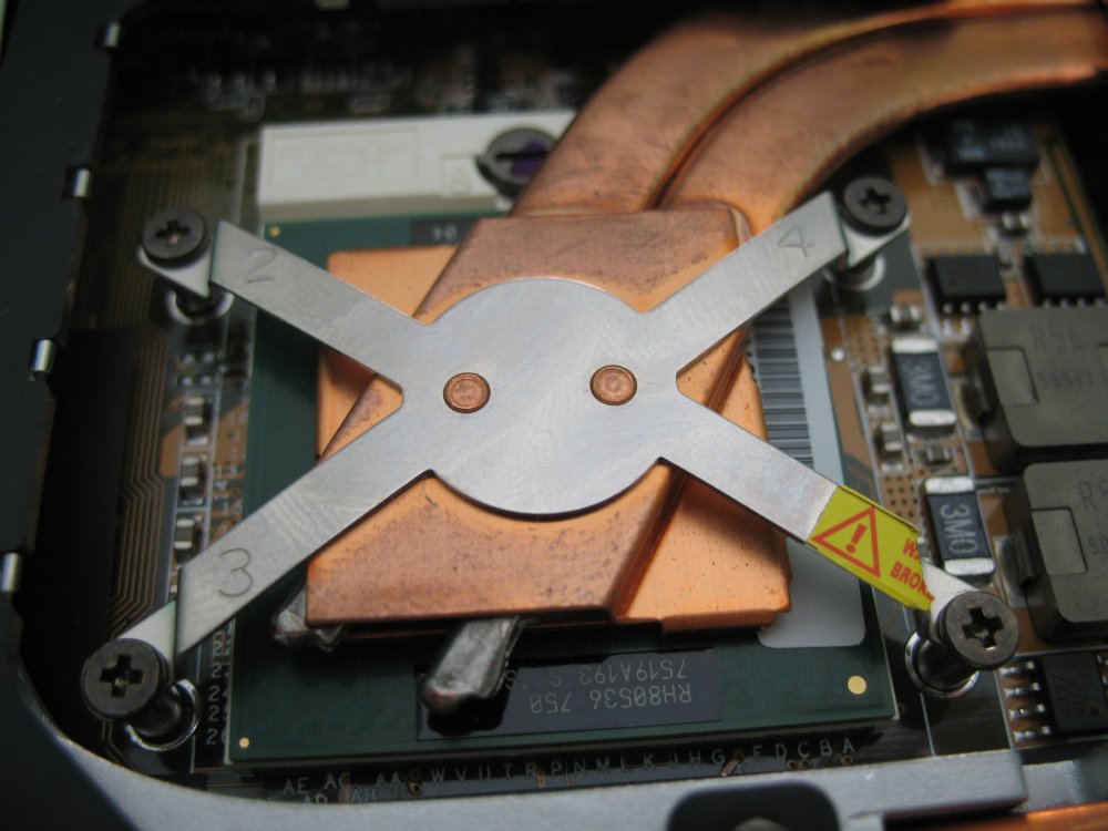

            @ Wizard: I have not spare memory of this type so I can't test them and I'm not going to buy one just to make a test.
            @ kc8adu: no, the green leds "power indicator" and "Drive Activity Indicator" turn on and the CDRom runs. After 10 seconds the "Drive Activity Indicator" led and CDRom turn off and after few seconds they restart.
            I don't see anything on the screen and not sound from speaker or buzzer.
            @ zandrax: thanks for the manual. The Ac adaptor is ok, it charges the battery.
            I don't seen anything connecting a VGA monitor.

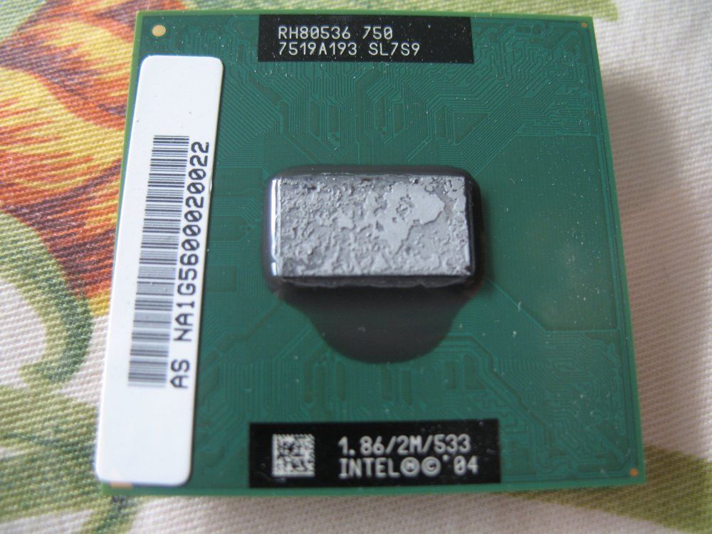

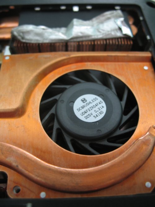

            I have removed the HD, WI-Fi module and Ram. There are 2 Ram stick, I have tried one per time and swapped but nothing change.

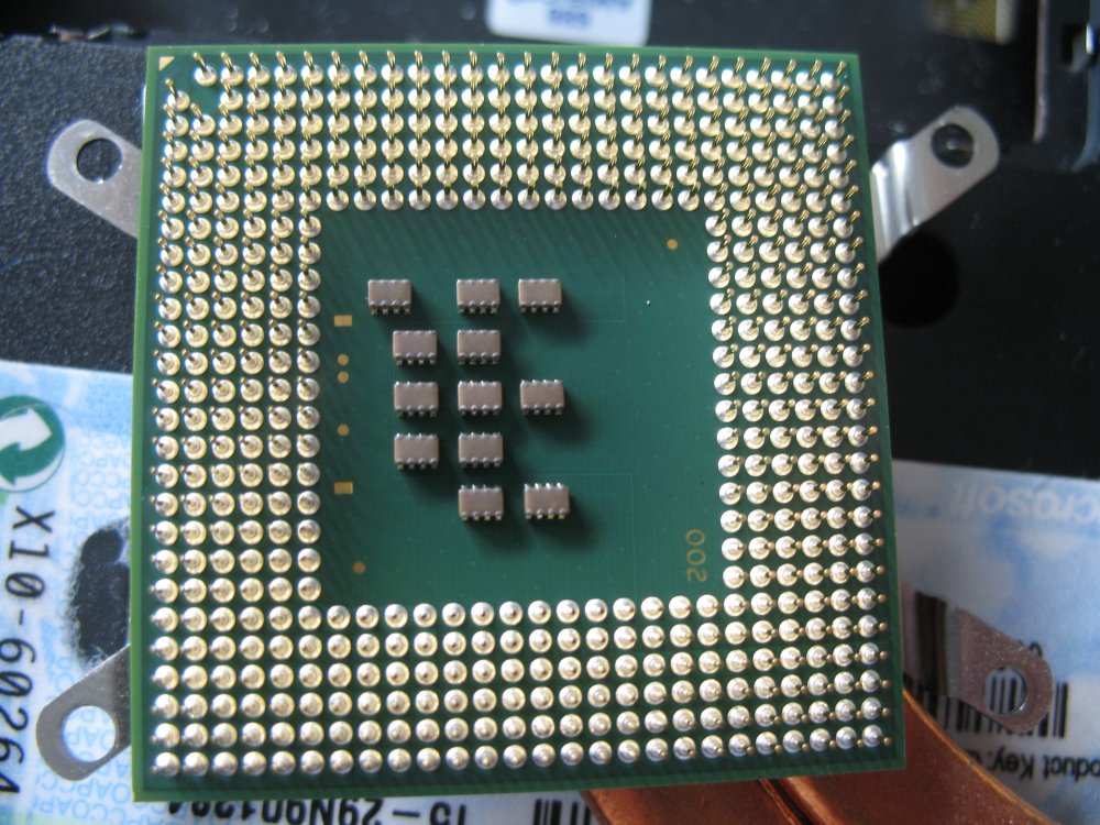

            I have removed the CPU/HS cover but there's no much dust. What I see is the fan not spinning up and the processor gets very hot, I can't keep my finger on it.
            I tried to feed the FAN with an external PSU, it doesn't run at all.
            I think the FAN is dead and the processor is fried.
            If I remove the processor and start the notebook, should I see something or hear something or the notebook stays completely off?
            Here few pics.

              Looks like you have quick access to the CPU. Why don't you remove the heat sink and see if the CPU is fried.
              I was told before that if laptop keeps re-booting before getting into Windows, good chance it is the CPU. But you will need another CPU to sub in.
              I think if you remove CPU, it will loop the same....

                find another fan/cooler. if that fails, replace the cpu.

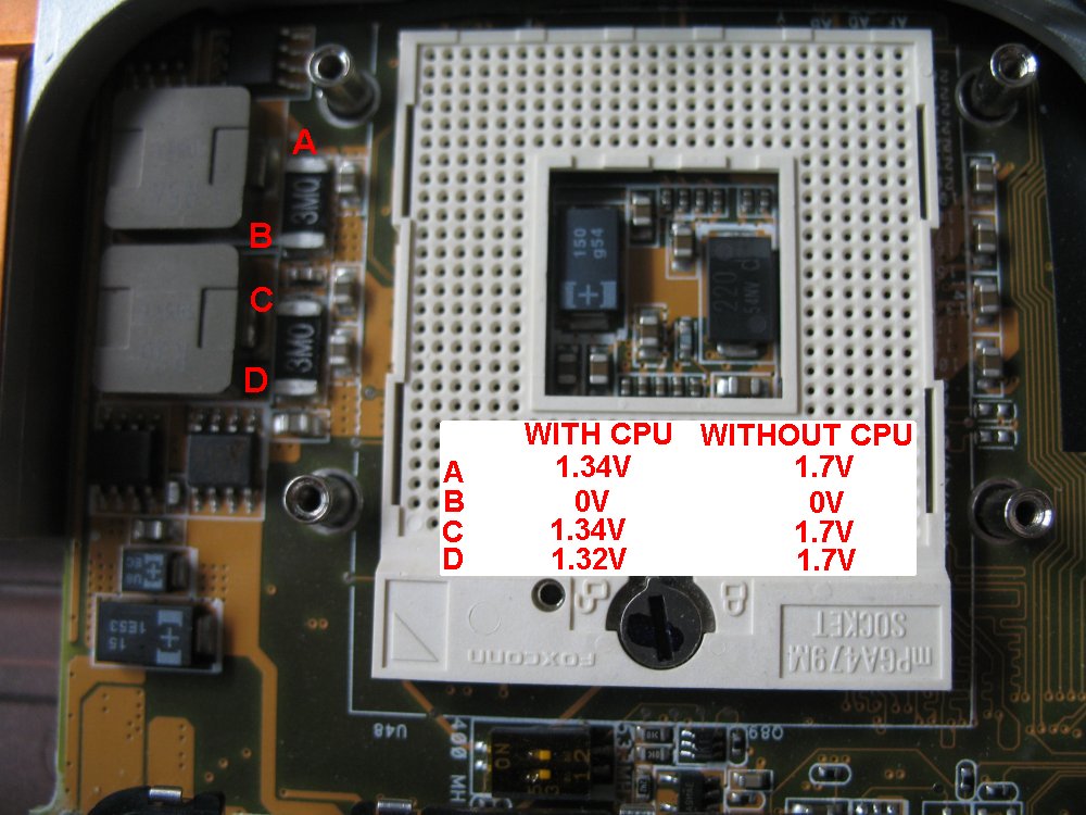

                            Yesterday before I removed the CPU to have a look I measured the voltage on 2 blacks components that look like resistors:
                            on the first one I measured 1.34V, on the other one the voltage is almost identical on both side, it is 1.34V and 1.32V.
                            Afterward I removed the CPU and I measured again the voltages and they were 1.7V.
                            I don't know if they are correct.
                            Without the CPU, the notebook doesn't loop with on/off cycles, but it stays on; I can hear the HD running.
                            I have observed that the area between HD and CPU become quite warm, probably due to the dead FAN.
                            AFAIK the CPU has thermal shutdown against over temperature so it should not be fried, or am I wrong?
                            I'm afraid that the dead FAN has damage something else like NB or SB.
                            I have to ask friends if somebody has a CPU hanging around.

                                yes, you have a bad cooler. order a new cooler first, see what that does. if no go then order the cpu. that should fix it.

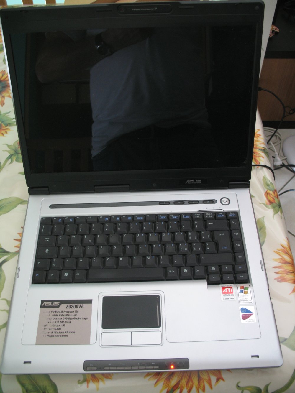

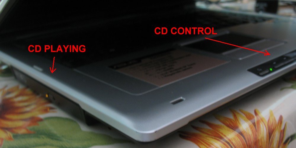

                                  @ kc8adu: in your situations were you be able to see something on the screen? I'm not expert but I think that even with the dead FAN the notebook should be able to start posting before shutting down.
                                  The heatpipe seems good because the temperature from CPU to the heatsink seems homogeneous.
                                  I did 2 test today: I put a CD audio into DVD drive and using the front button control I'm able to listen music. I removed the memory and tried again to play the CD but the notebook was mute.
                                  I don't know if using this feature the CPU is involved, anyway both memory and DVD drive are good.

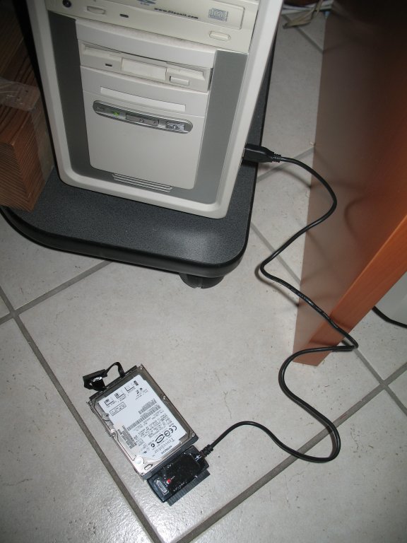

                                  I removed the HD and I connected to my PC: it is good.
                                  I have formatted it to remove my sister files.
                                  If to play music the notebook needs the CPU, than also the Centrino 750 is good. Maybe I have to do this test without the CPU installed.
                                  Here two pics of today's test.

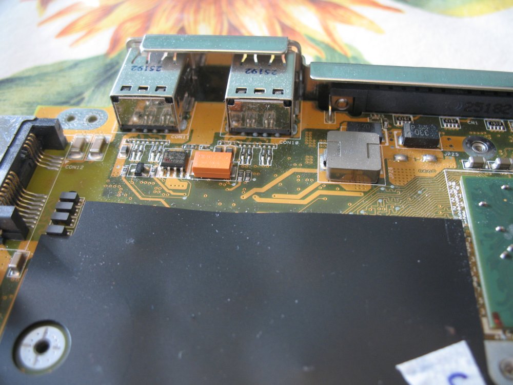

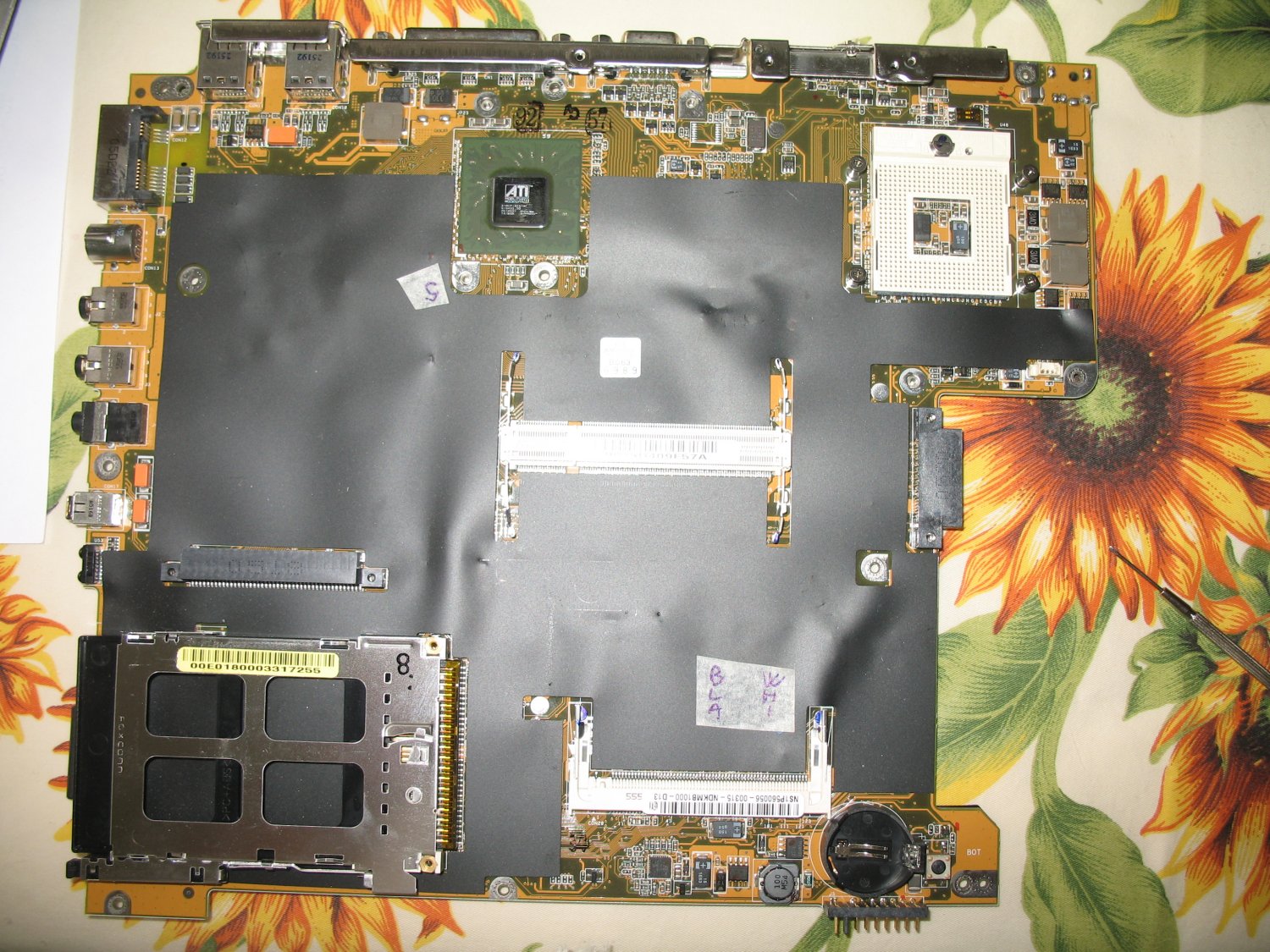

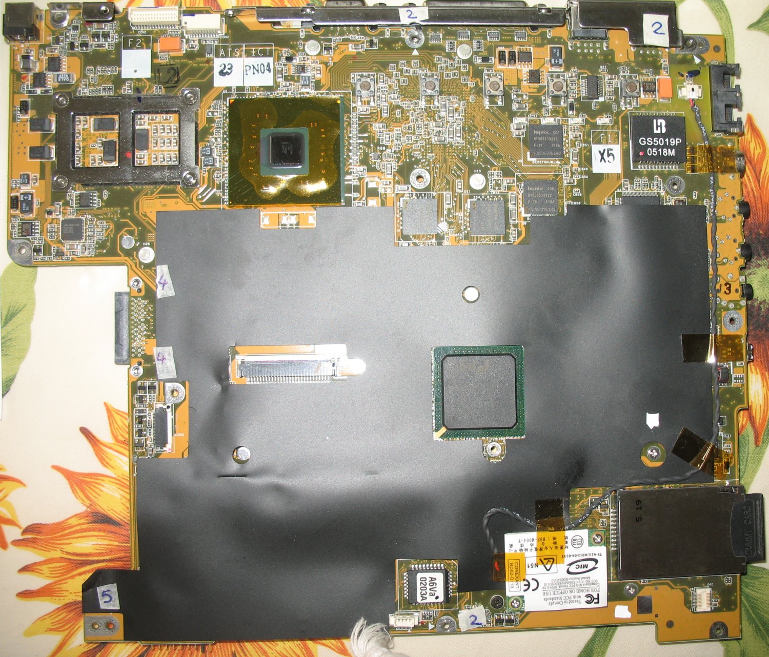

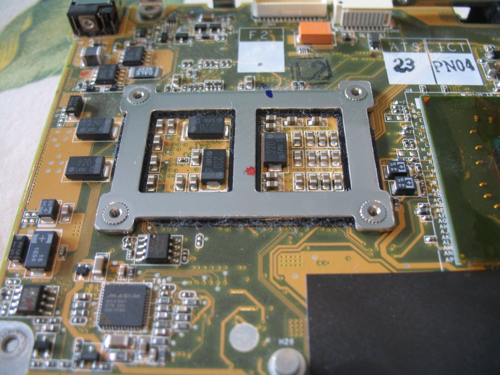

                                      @ digge: you are right, to remove the DVD drive you must remove only 2 screws but...... to reach them you have to remove most of external screws.
                                      Originally posted by digge
                                      I doubt your cpu is busted. If the screen goes on and everything its like super slim chance the cpu is busted. 99.9% of the time if a cpu is broken the system wont even POST.
                                      I don't get you: the screen doesn't show anything, I see nothing even on VGA output, I hear only the DVD drive running and LED going on and off. This means no POST at all or am I wrong? If it doesn't POST the CPU is dead?

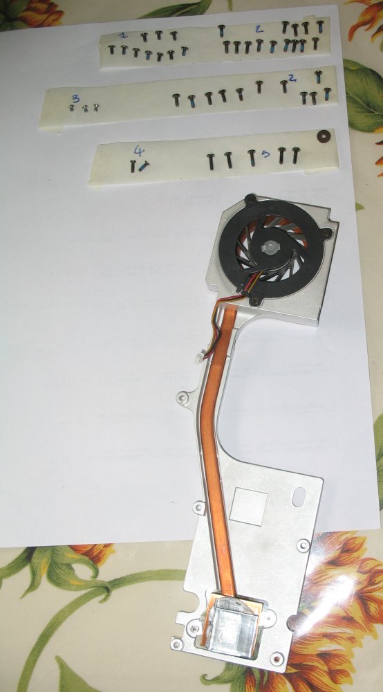

                                      This afternoon I was alone at home so it was quiet to allow me to work in peace, I took a deep a long breath and I disassembled the notebook.
                                      It was necessary if I want to replace the dead FAN because the screws are on the opposite side of the CPU cover.
                                      It took me 2 hours to disassemble the notebook.
                                      I don't see any visible sign of damage like burnt part.
                                      Before I started to disassemble it I removed the CPU and try to play a CD audio: it doesn't work but I don't know if that means the CPU is ok.

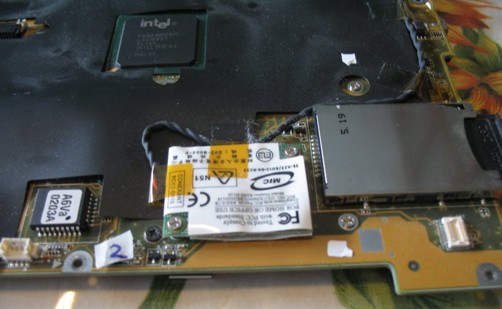

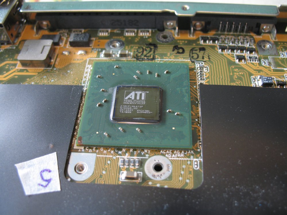

                                      Here some pics of the board.
                                      Now I have to order a new FAN, for sure I need it.
                                      I really don't not if it is worth to order also a CPU, but reading lucky13's suggestion it is a possibility.
                                      Is there anything I can check/test on the board before I reassemble it?
                                      It will take some days before I get a new FAN so I have time to check the board but I really don't know what to look for.
