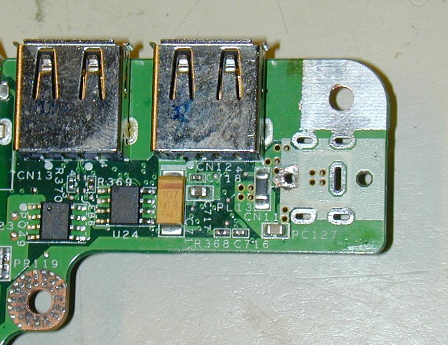

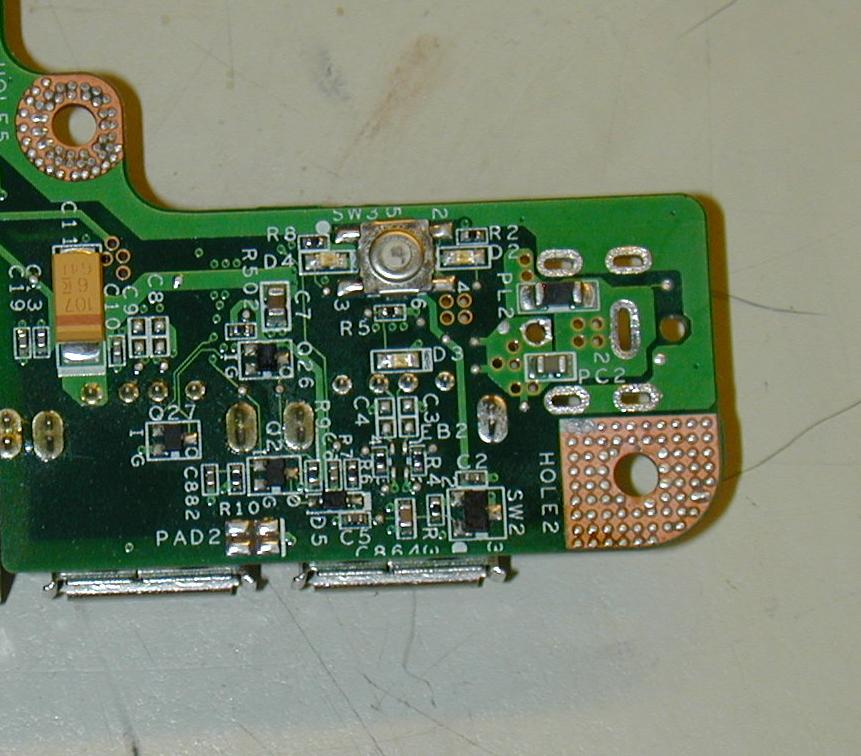

    Gateway MA3 (MX6426) DC jack PCB short
    There seems to be a dead short between the throughhole (+19VDC) and neutral/ground plane somewhere on or in the PCB. On one side there is a PC127 and PL13 and the other side has PC2 and PL2. If I interpret this right, they are Power Capacitors and Power (L)Inductors.
    Either one or both capacitors are shorted or there is a short inside the PCB on another layer.
    If this SM capacitor would short I think I'd see some discoloration, yeah?
    It might be an internal short but I can't test/prove or fix that I don't think....but maybe I'm being pessimistic.
    Noob question: What's the use of these tiny value capacitors bridging the + an - pads?
    What do you think?
    What's my next step?
    Here's a couple pics....
    The jack has been removed and solderpads and vias cleaned up.
    On the second pic you can see a scorch mark and slight disturbance on the round pin pad.

    Re: Gateway MA3 (MX6426) DC jack PCB short
    first suspects are pc2 and pc127.
    the pl's are inductors.
    i have repaired several of these and found mlcc shorts in several areas.
      I removed the capacitors and they aren't shorted. The board is still shorted. Must be further down the line....but it could be anywhere. I don't now how to test without popping bunches of components off. If there was a way of isolating that section of the board, that would be something to work with.
      What's next?
