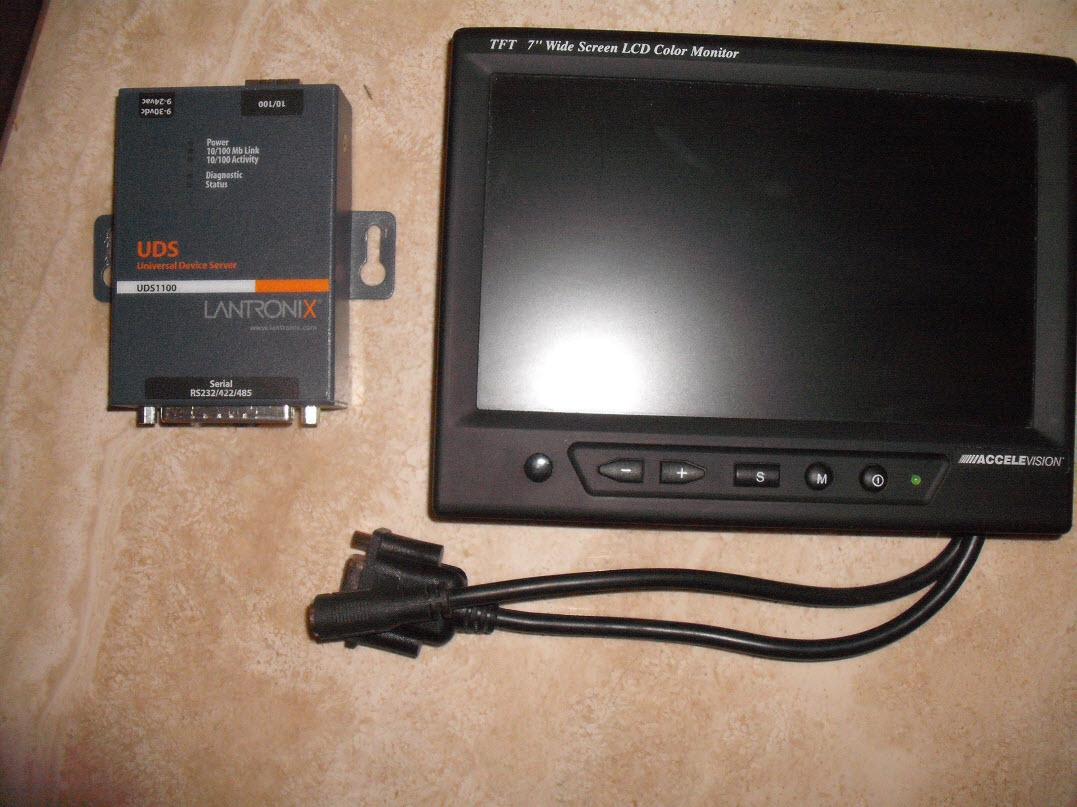

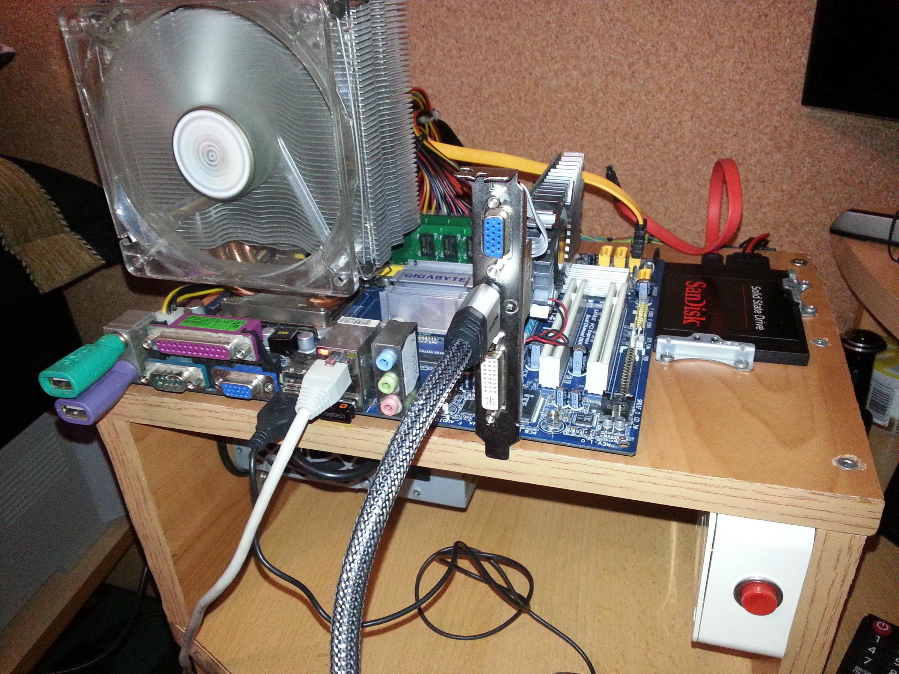

                          I have several "headless" devices. Those with LoM are relatively easy to support when something goes wrong -- I just log into the LoM port from some other machine.
                          Those that don't have the necessary LoM hardware boot kernels that are built with "serial console" support -- if the kernel can get loaded, I can access the box via a serial port or "single port terminal server" (left side of photo).
                          If the kernel won't boot, then I keep a small (7 inch) monitor handy (right side of photo) that I can carry to whichever box is giving me problems (I keep a VGA cable plugged into each headless machine just so I don't have to go fishing around trying to plug in a cable, when needed).
