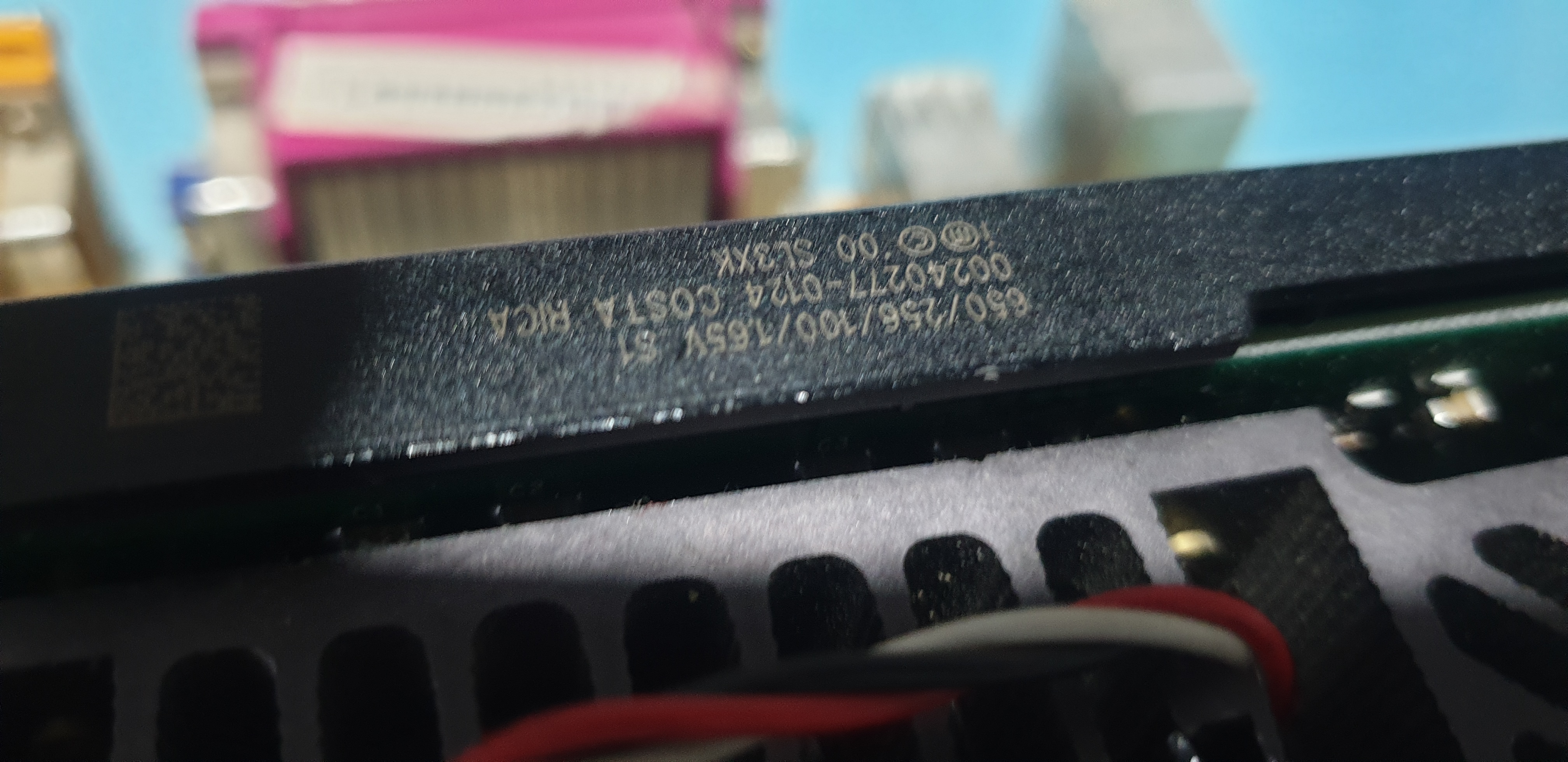

Just for fun I found a BIOS that works and is retail on the Micron board you sent me. It's a Freetech branded AMI BIOS, chipset SiS 460.
The only small downside - it's DX2 only. DX4 boots as well but only at 66MHz.Main rig:

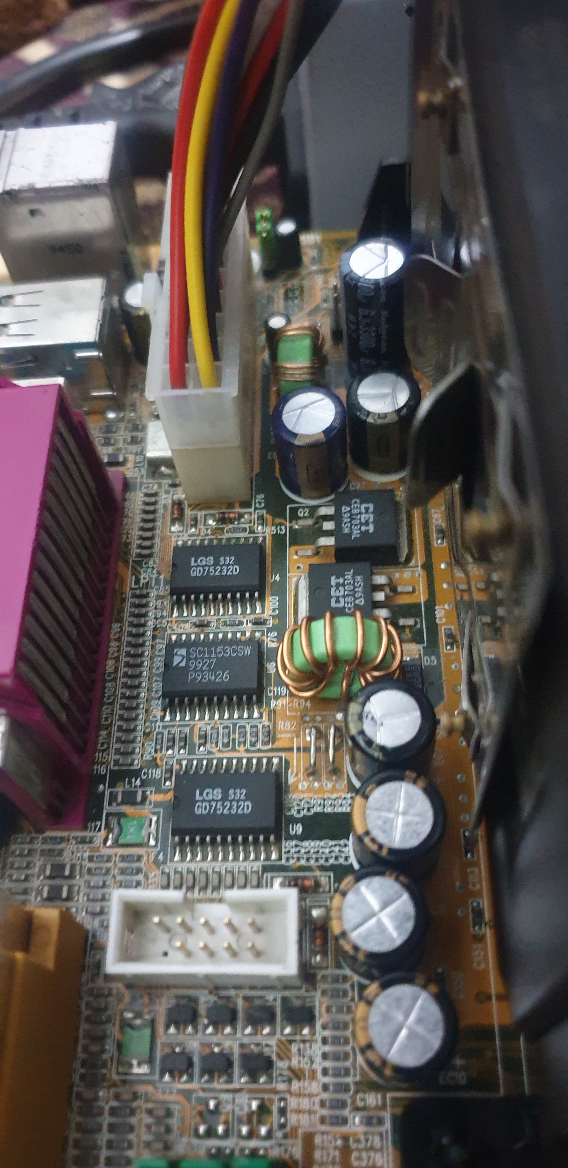

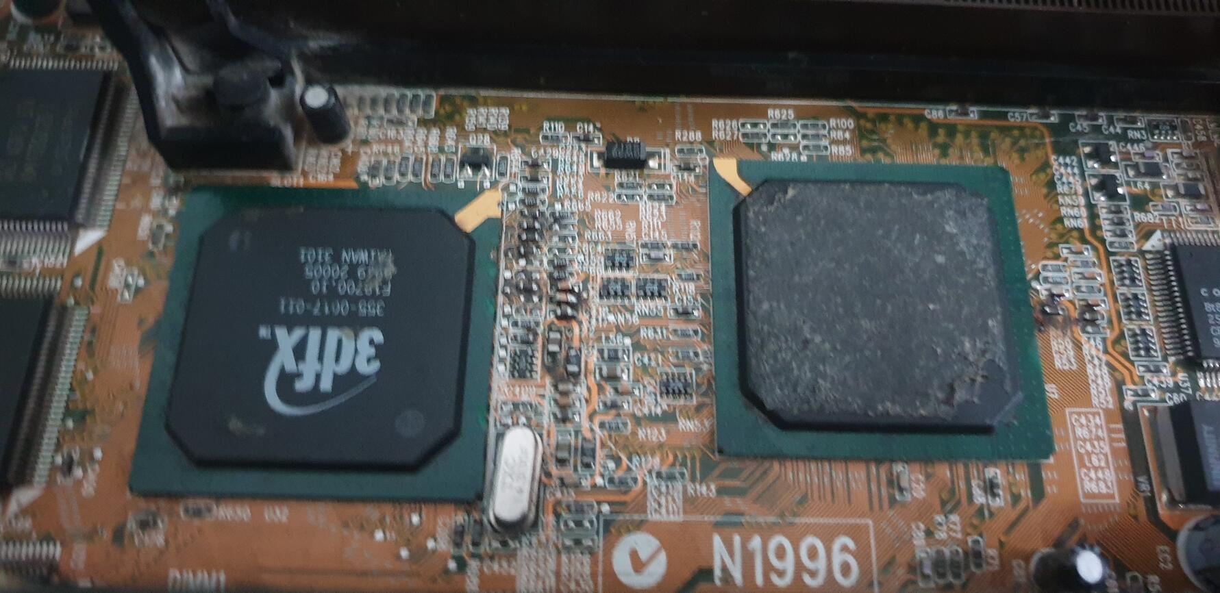

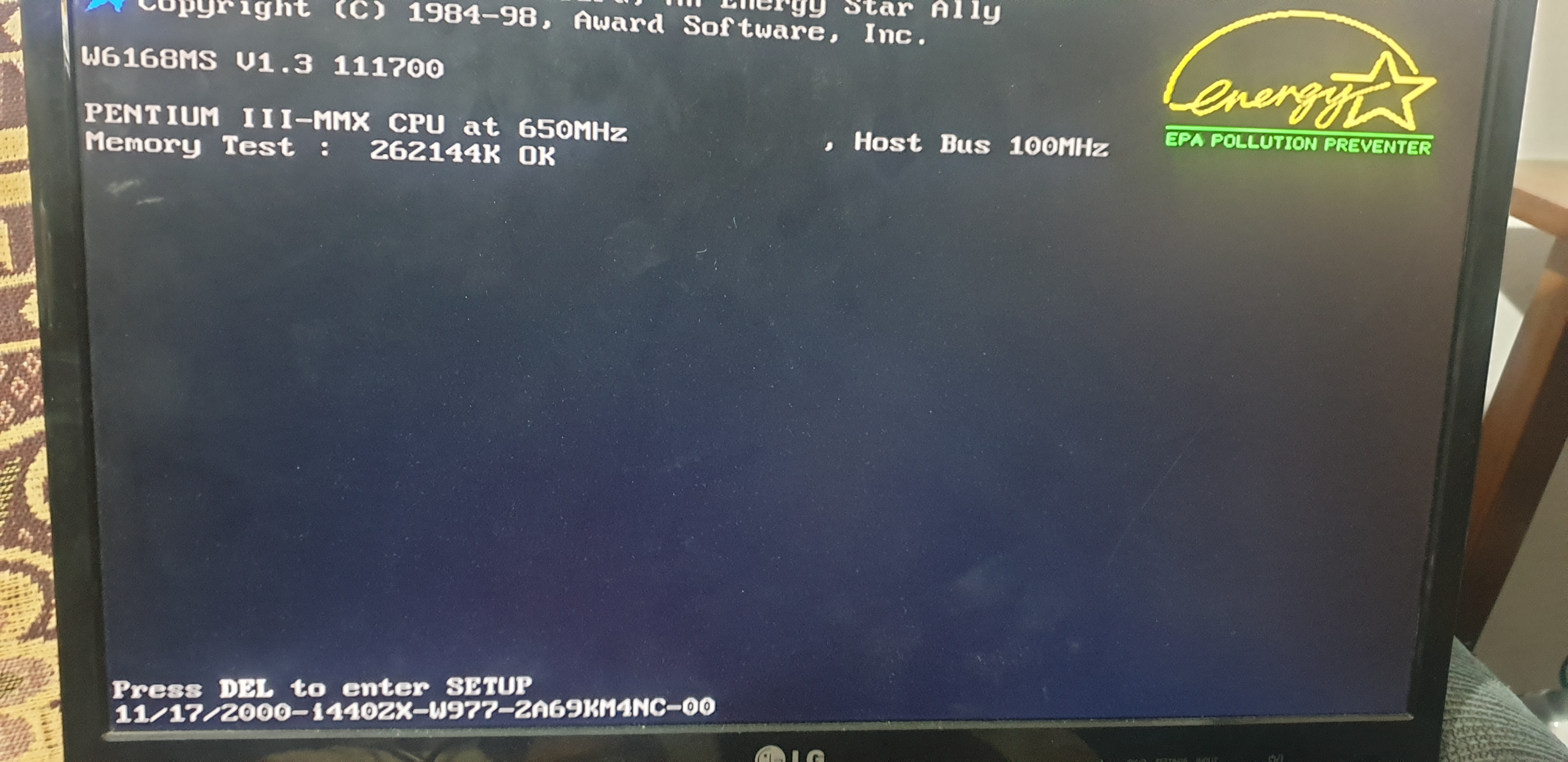

In the meantime, the MSI 6168 w/ the 440ZX chipset showed up. Clearly off the scrappers as the whole bunch of SMD resistors on the 3dfx chip's side were absolutely OBLITERATED
Unfortunately, the pic I have is after I managed to rebuild the whole side of resistors.

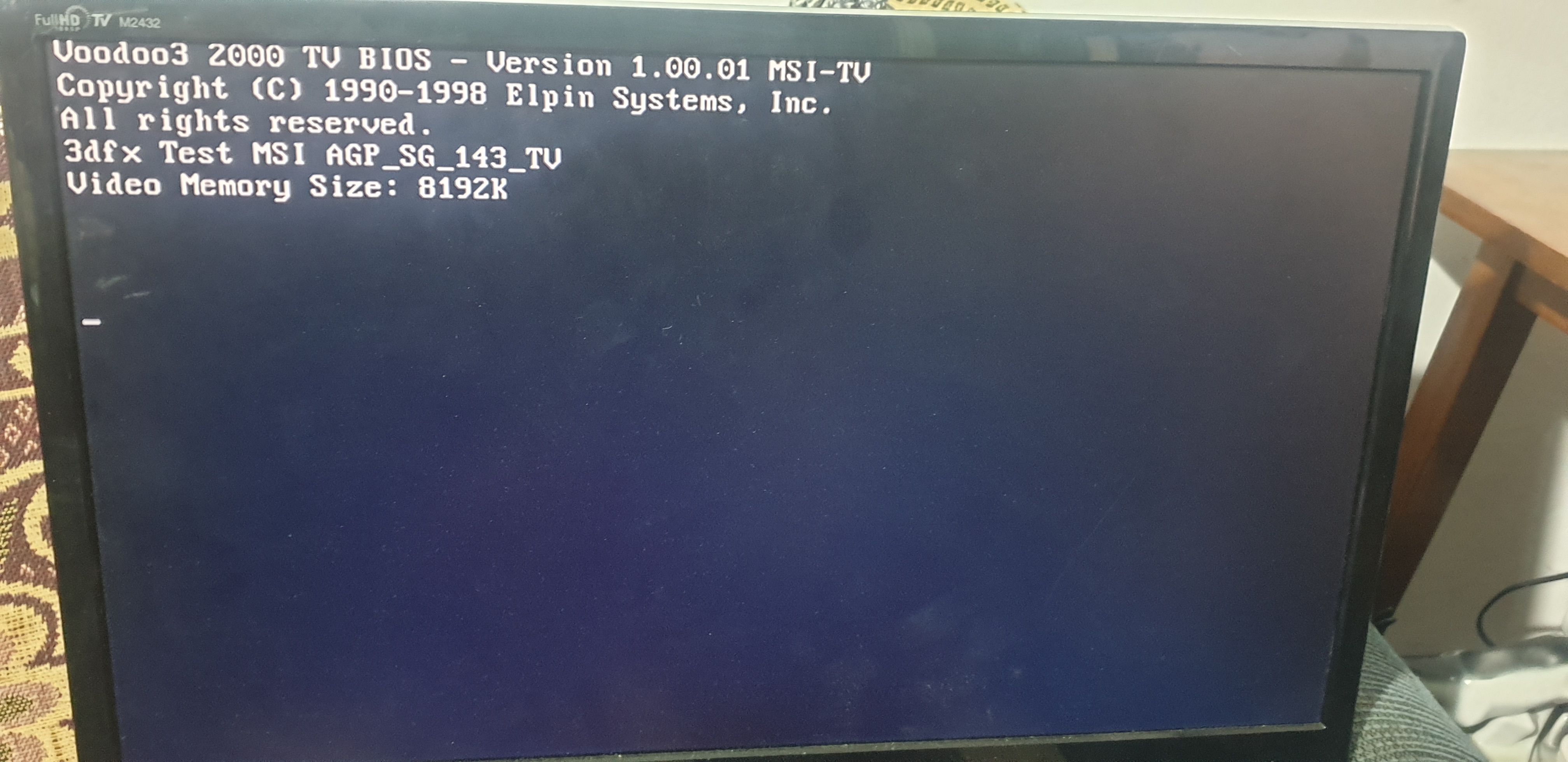

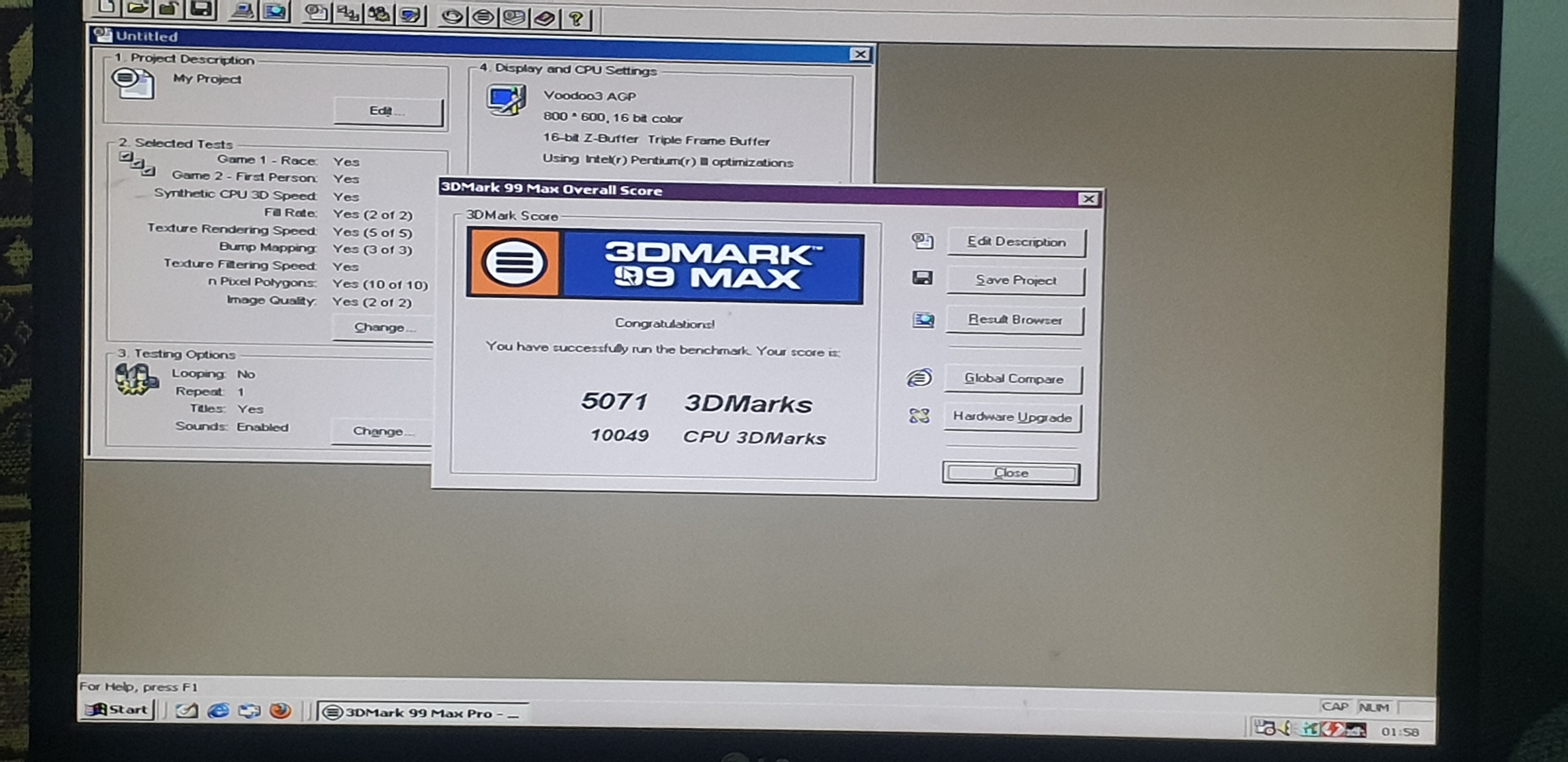

Finally, the "rebirth" of the Voodoo board
And a 3dmark99 score w/ the onboard V3 2000.

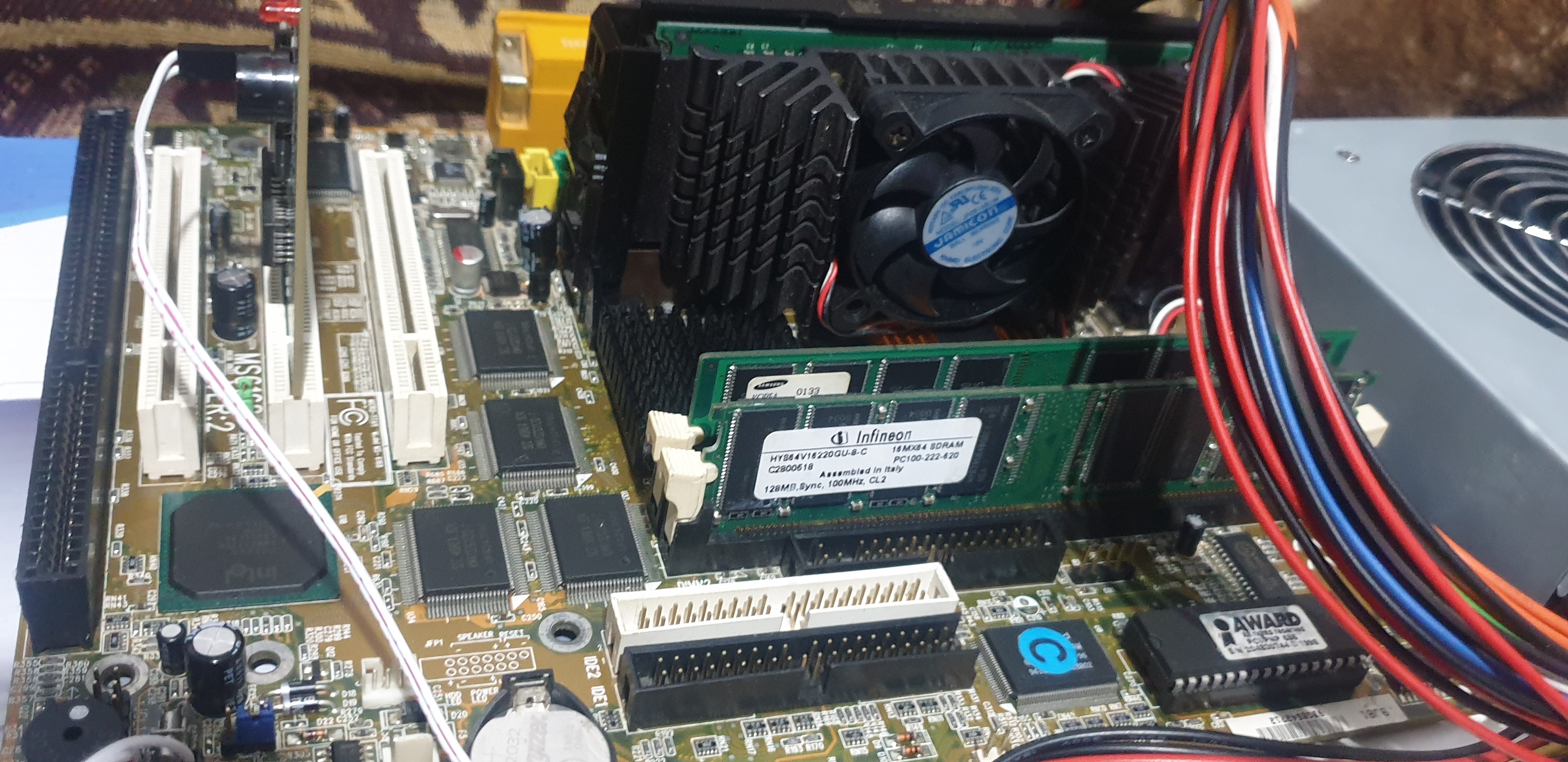

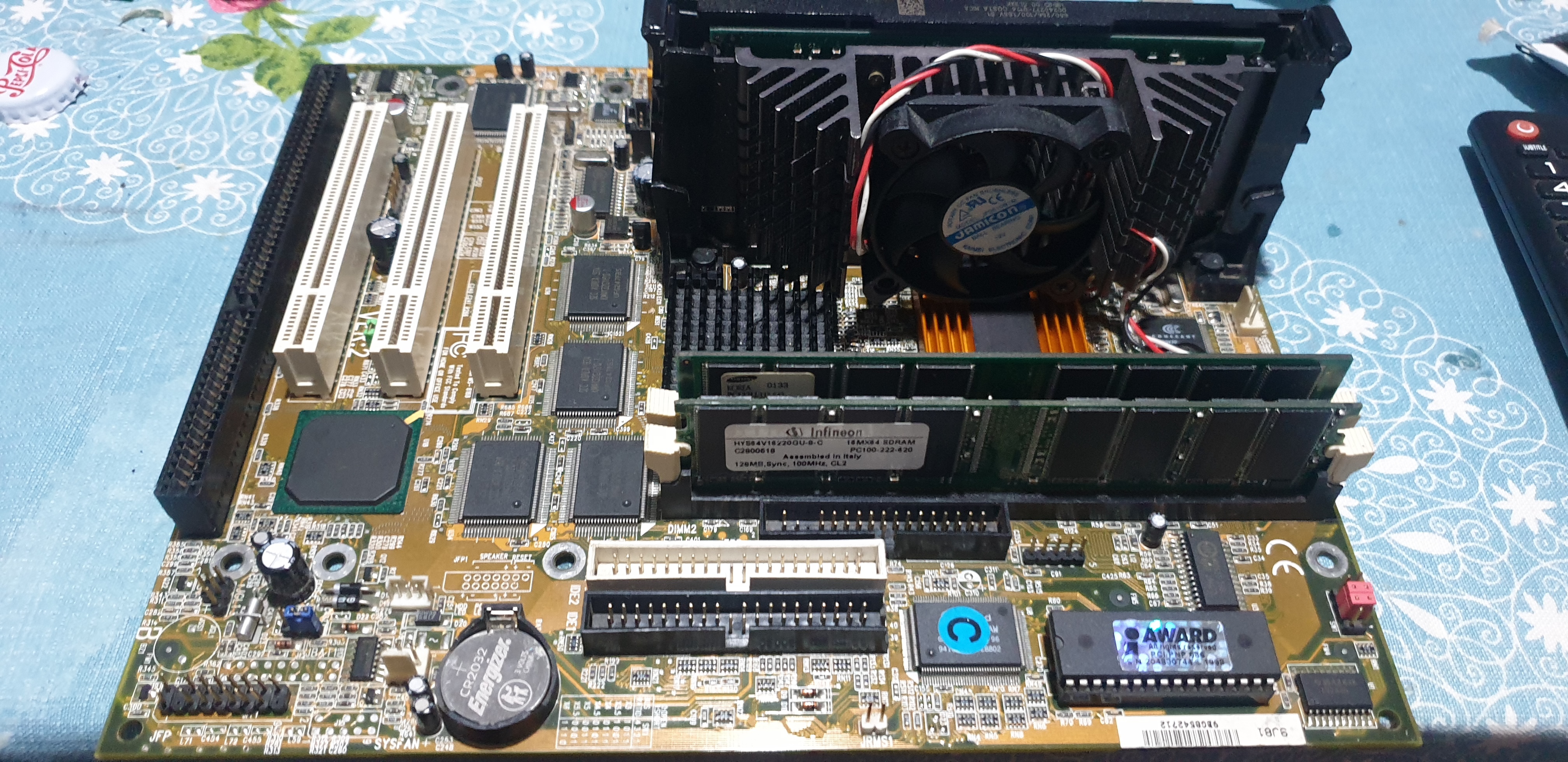

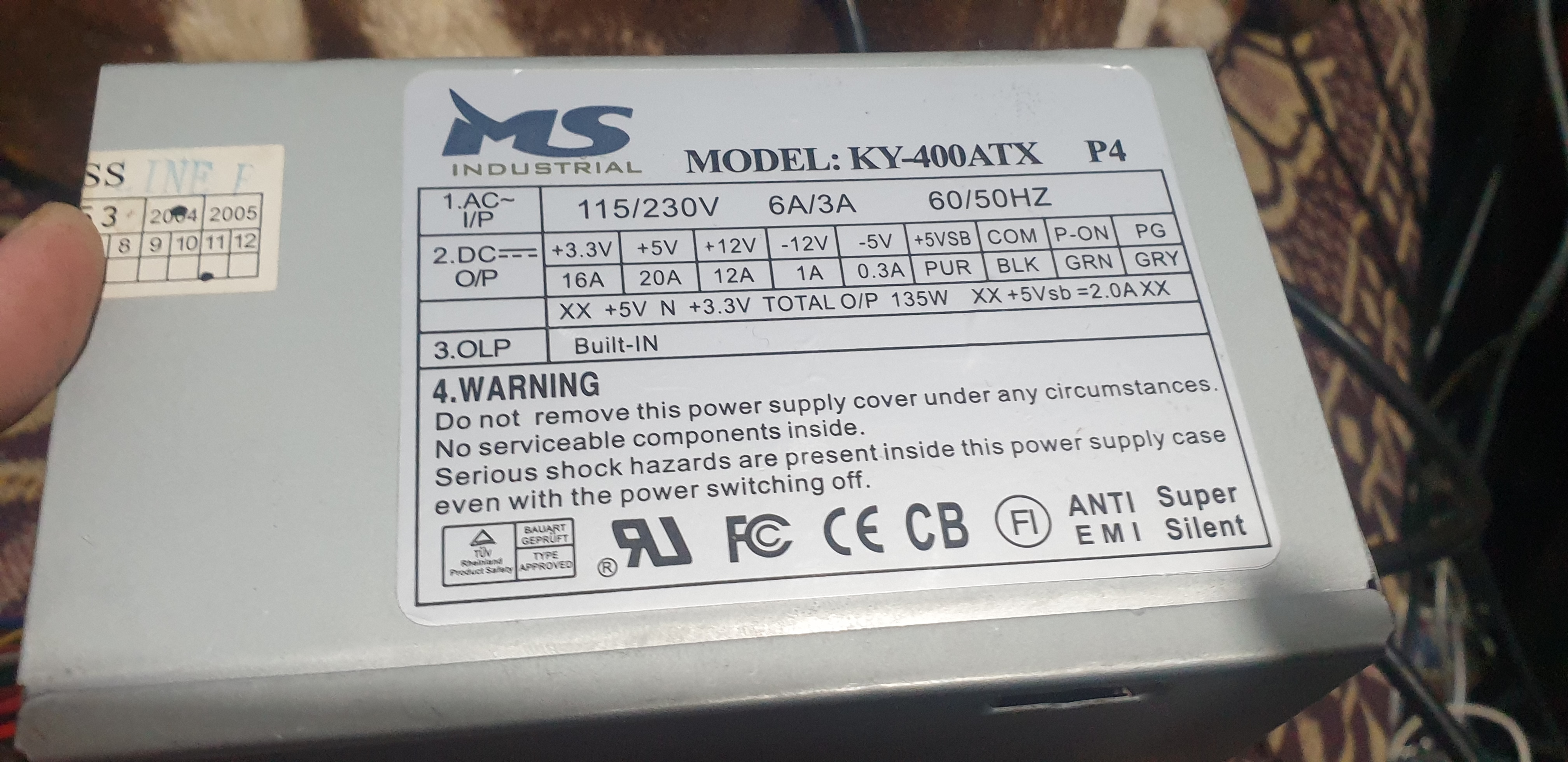

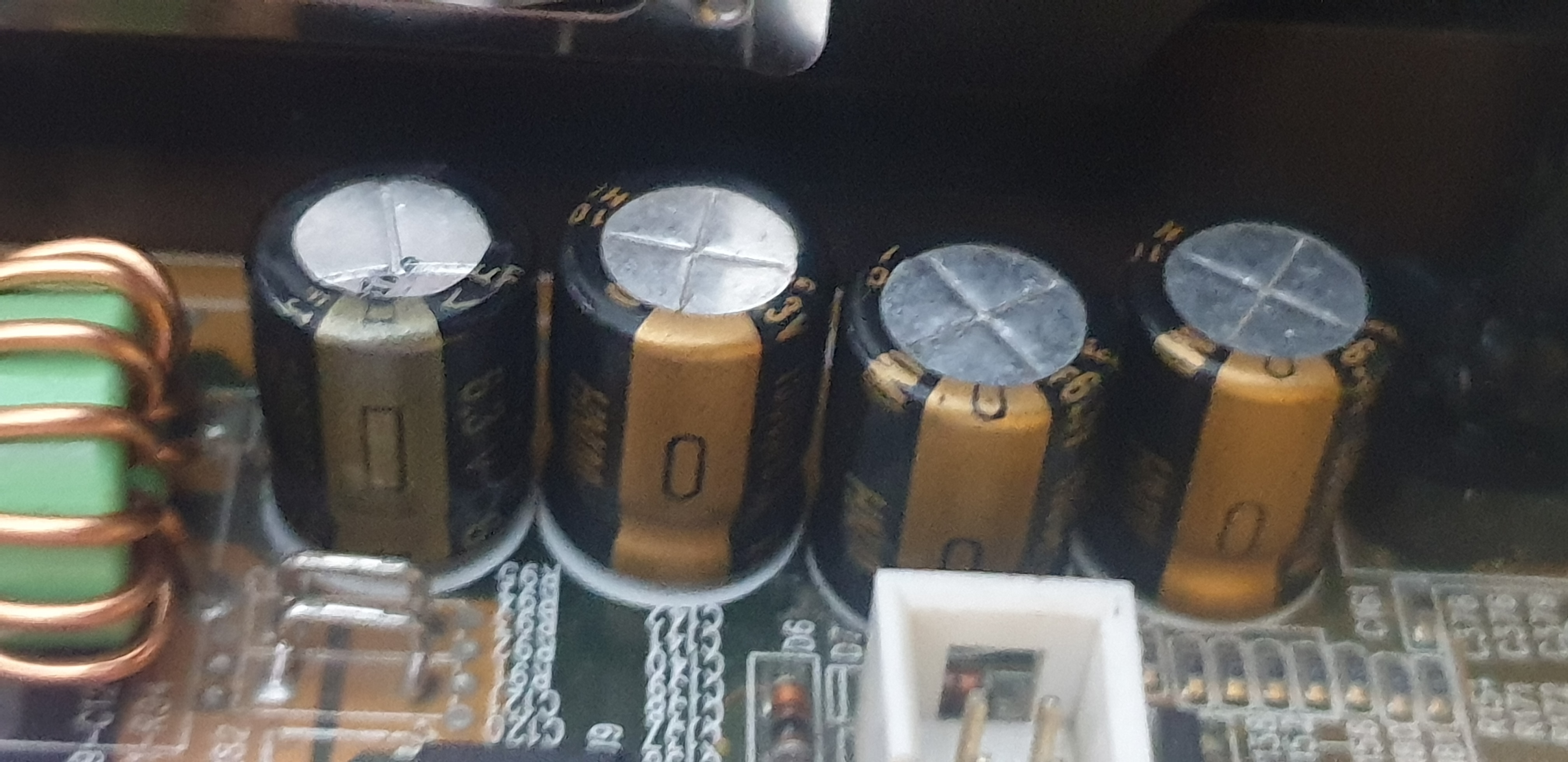

Some moar work on the beautiful MSI mobo from my previous post. I just wasn't happy using 16v 1500uF Rubies... so I switched to smaller 1500uG 6.3v Nichicon HN and a lone Panny FJ of same value to complete the count.
The MS-Industrial (Sun Pro) PSU you see was also recapped prior for a MSI 850 Pro5 build (with the AT styled Auxiliary connecto that ultimately fell flat due to the board's AGP being dead
I'm in negotiations with two of my friends for Slot A board instead... but if anyone has an ABIT KA7 laying around they'd be willin' to part to, I'm open to offers. I ordered a Pluto Athlon @ 700MHz thay should be here next week... it's one of those monsters with TWO fans.

There's a lot of cool stuff here. I haven't had a chance to mess around with computer stuff for a while. I would need to buy more stuff (starting with a spare power supply for testing), find a place to store it, and answer questions from people who just want to scrap everything that won't officially run Windows 11.
I see some damage on the side of the Voodoo 3 chip, so it's good that it still works.Comment
Thankfully the 3dfx chip didn't take much damage. Just a bit of small dents that don't affect the chip.Main rig:
