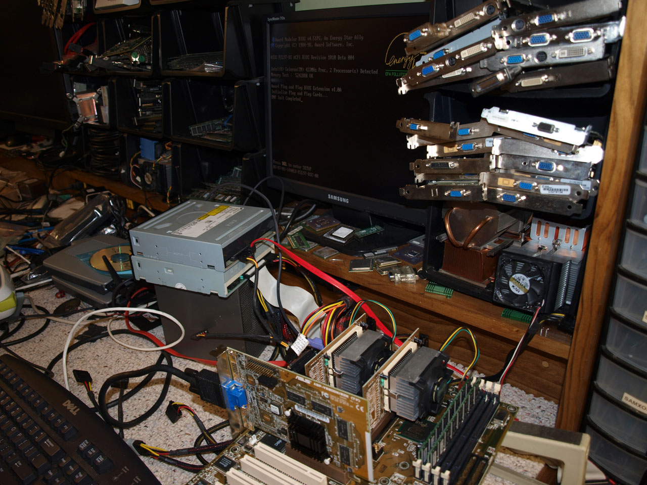

Dual Celeron Weirdness Build....
  • Topcat
    The Boss Stooge
    • Oct 2003
    • 16956
    ...and it's NOT a BP6!!
    This was made possible by some weird brand of slotkets that tout supporting dual CPU's, but do not support Coppermines.....interesting indeed.....but they worked. The motherboard is an Asus P2L97-D, which is a LX chipset and hellbound to 66FSB. The LX chipset will not run anything higher (like 100, even with CPU's rated for 100FSB)....albeit, I did try 75, it runs stable @ 466....
    More later when I tinker with it. Another slow worthless retro rig....but I enjoy this stuff.

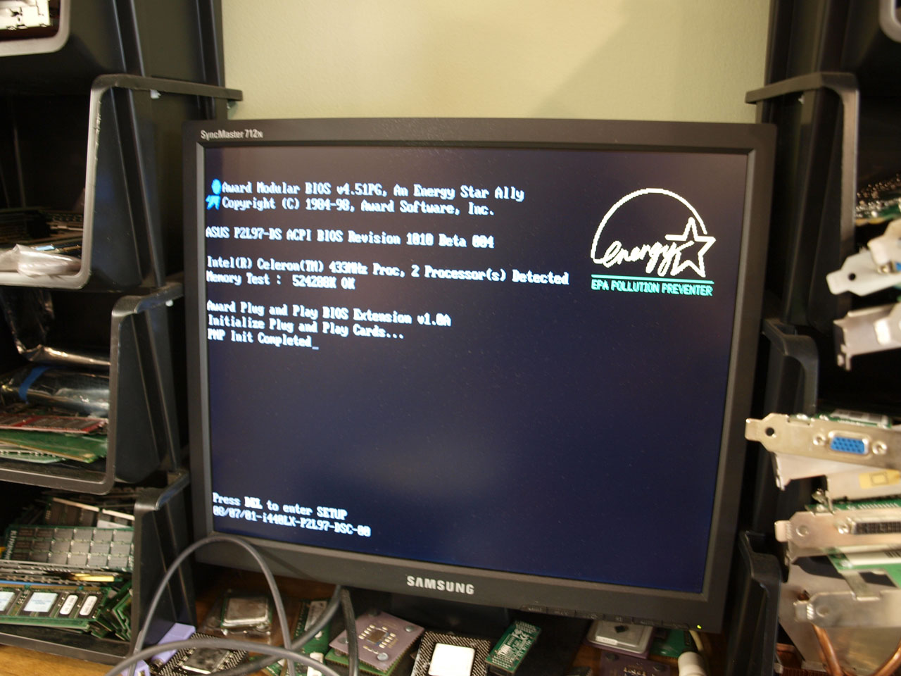

    Re: Dual Celeron Weirdness Build....
    testing CPU's I have on hand.... 433's run stable @ 466/75. Pair of 500's run @ 563/75, stable... Curiousity got the better of me and I picked up a pair of 533's (fastest Medocino Celeron) cheap, seeing if they'll run @ 600/75. I didn't bother with 83FSB, its never been known to be stable because of the PCI & AGP dividers...but if the CPU can hack it, 75 tends to be solid....Many Mendocino's don't even mind 100, but with this chipset, its not an option.
    This post created from it, @ 563/75 on win2k.

                Originally posted by Topcat
                ...Curiousity got the better of me and I picked up a pair of 533's (fastest Medocino Celeron) cheap, seeing if they'll run @ 600/75...
                This OC test did not work. It was never stable. I even tried them in a BP6, which allows for better tweaking....while it yielded better results, it was never stable....and I ran the vcore up to 2.3v.
                I stuck the 533's back in the Asus P2L97-D, and will run them at stock speed....for a board that was never able to run anything in a dual configuration faster than a pentium2 @333, dual 533 with full speed L2 caches is a mega win!
