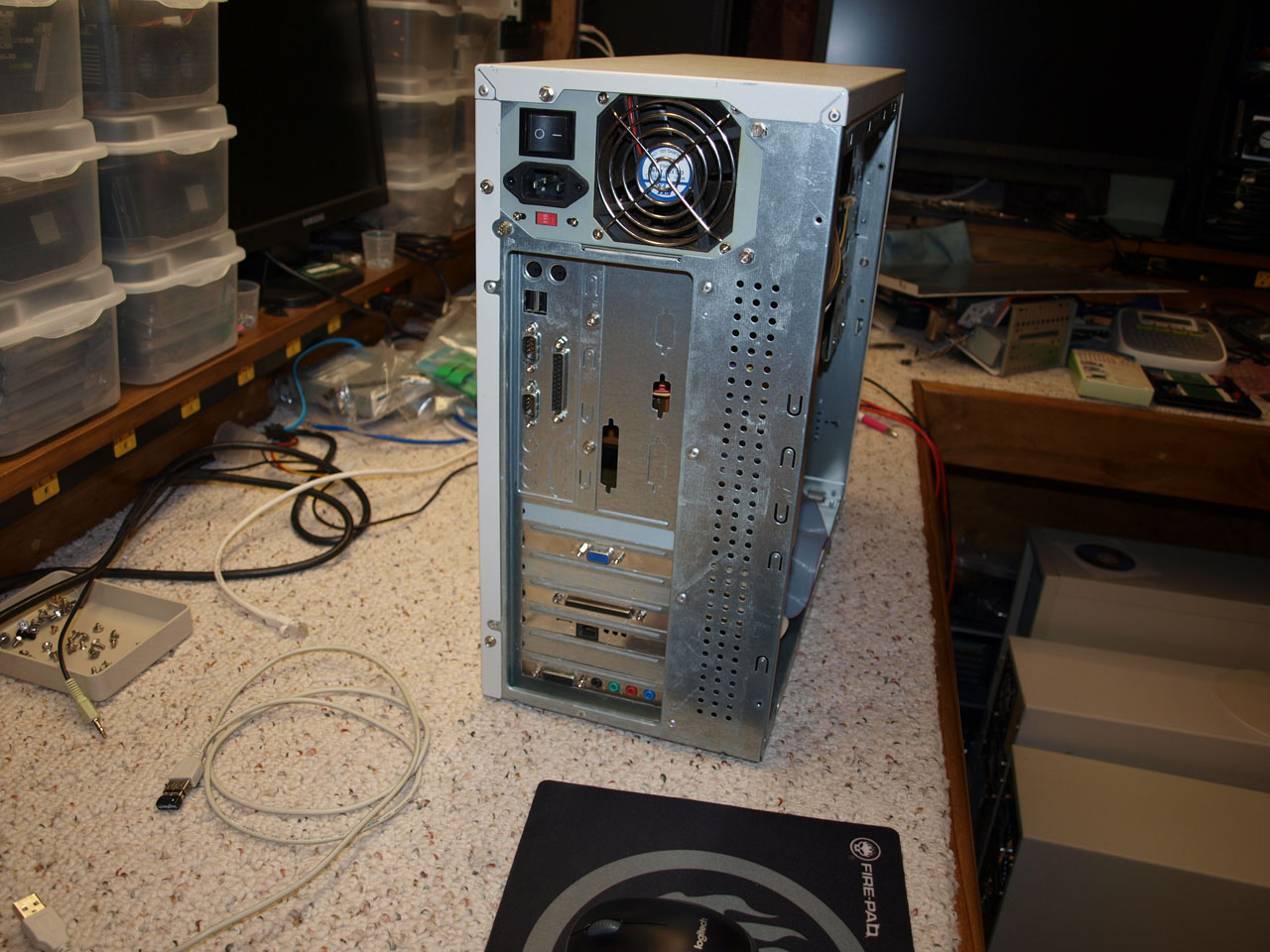

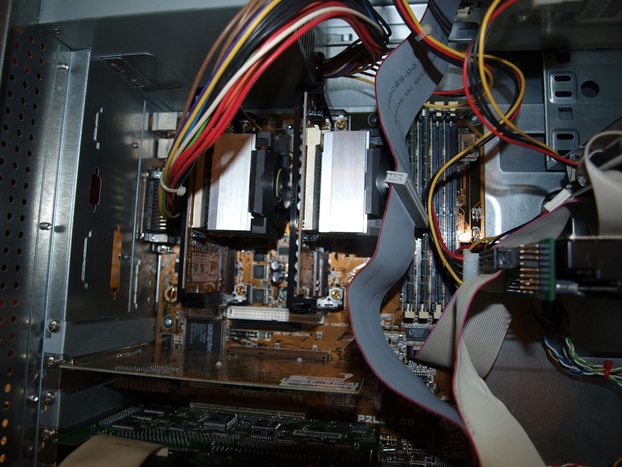

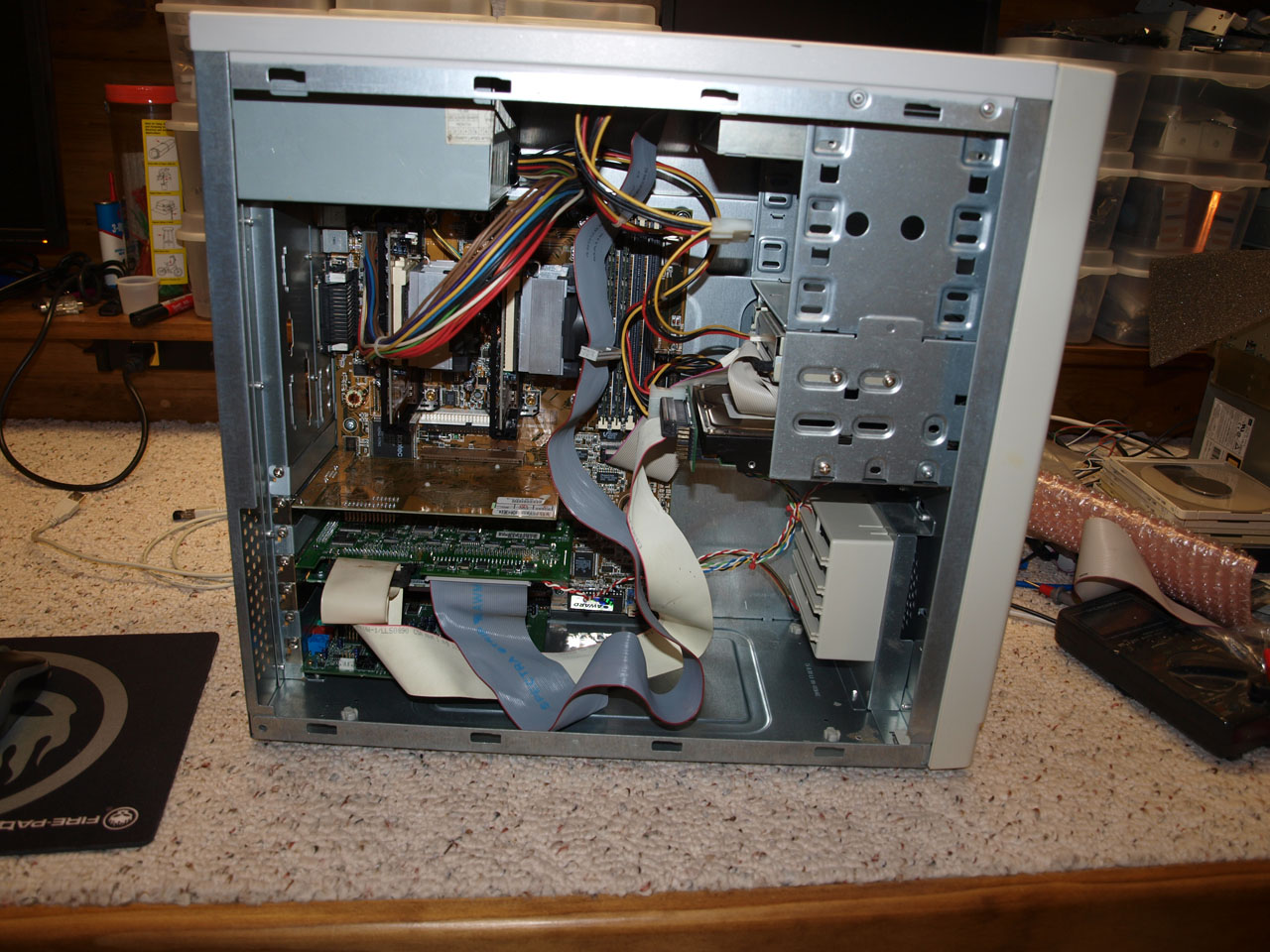

        ...and another one concluded... The case isn't the greatest of quality, but its decent...and in good condition. Fine for this build, which isn't too terribly valuable, it's just a strange SMP novelty.
        Pics as promised for this goofy little build....
        Innards...
        CPU's
        Butt shot. IO plate with the case fit this motherboard. I am out of blanks for those 2 punched out ports (1 serial, 1 parallel).

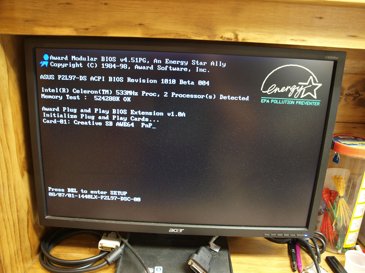

        Totally awesome POST screen showing both CPU's.

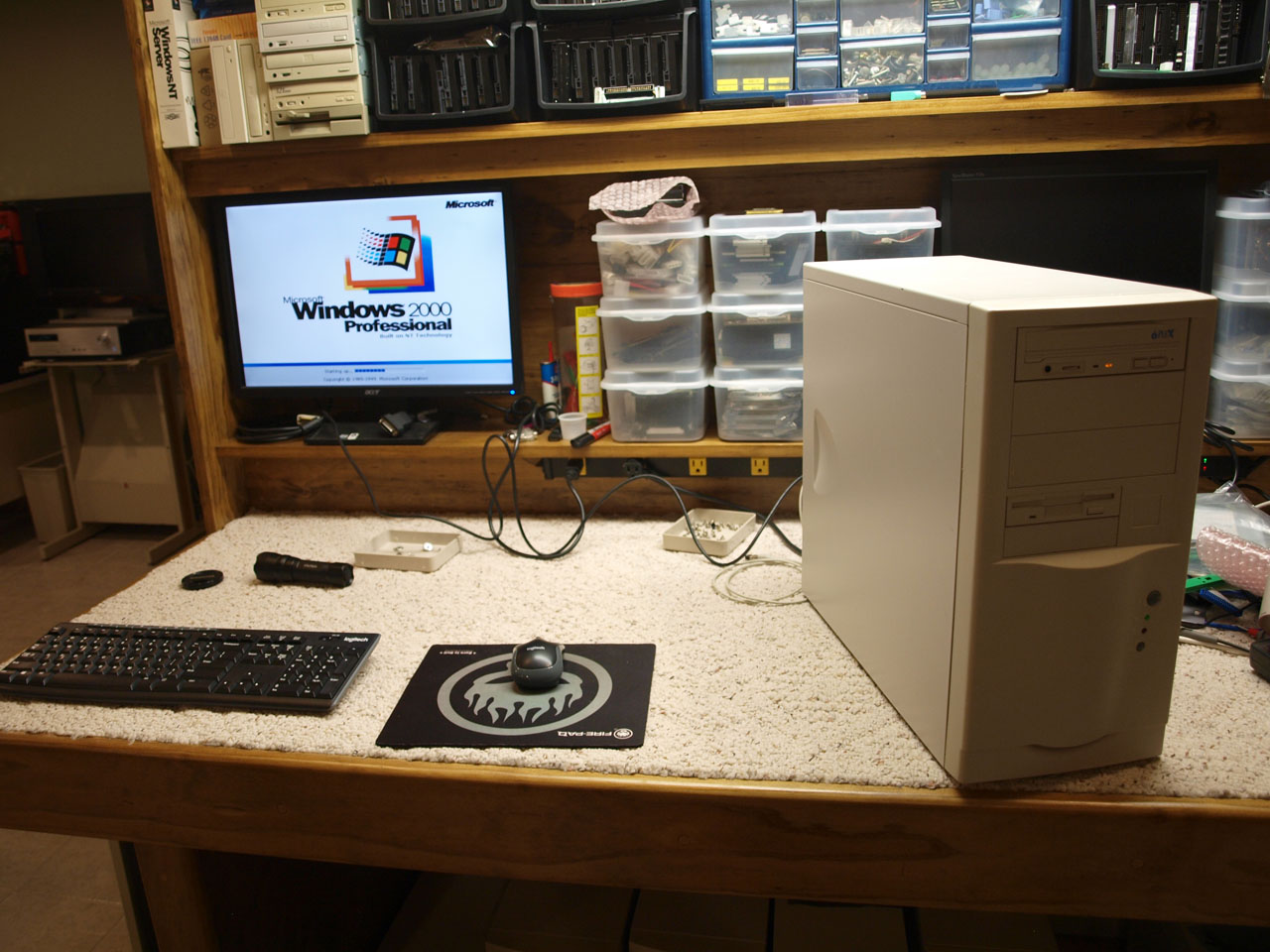

        XP would be ok on this, but Win2k is a bit better performance-wise on CPU's this slow.

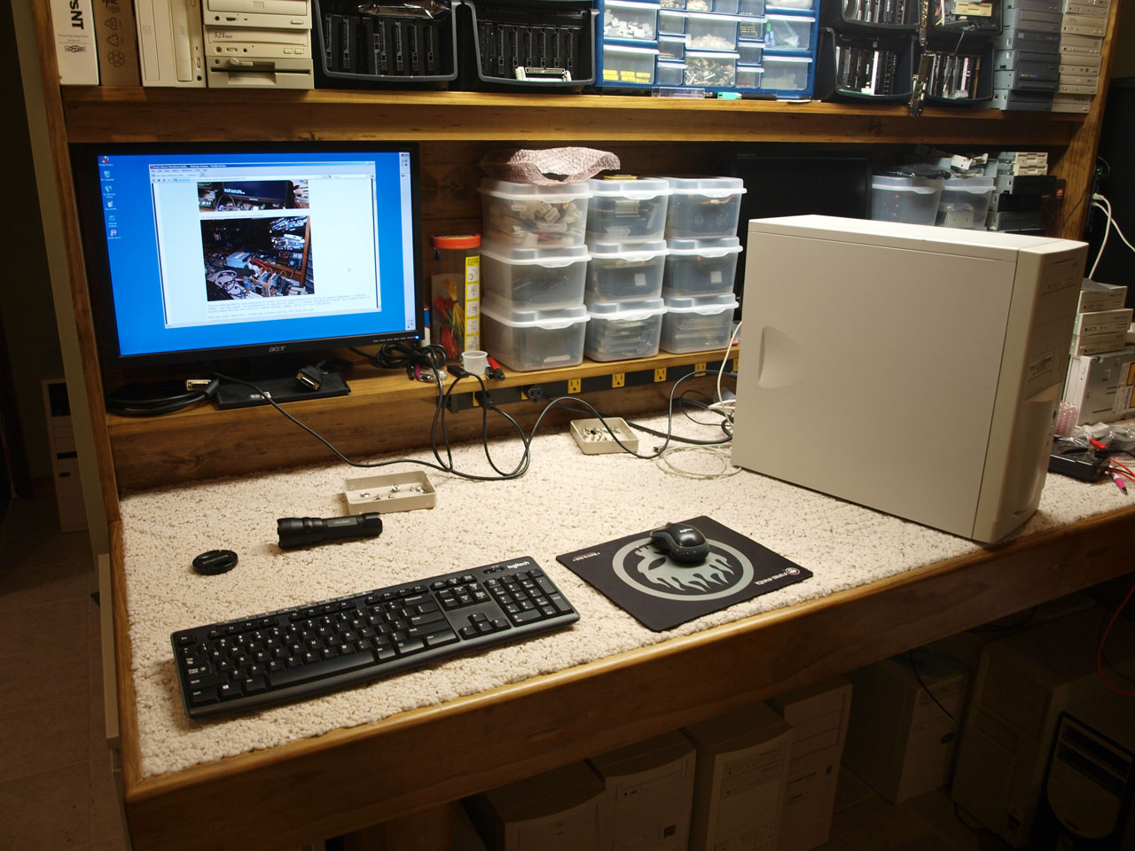

        Up & running.....FF12 as usual.
        Specs as follows:
        Asus P2L97-DS
        2x Celeron 533's
        512mb SDRAM (supports 1gb EDO or 512mb SDRAM, I chose the faster option)
        Nvidia RIVA TNT2 64mb GPU
        Adaptec U2 SCSI Controller
        AWE64 Sound
        18gb 10k RPM SCSI HDD
        Plextor 6Plex SCSI cdrom
