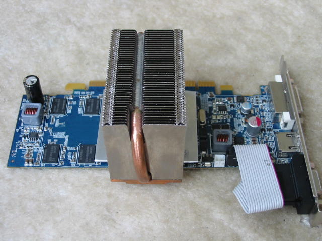

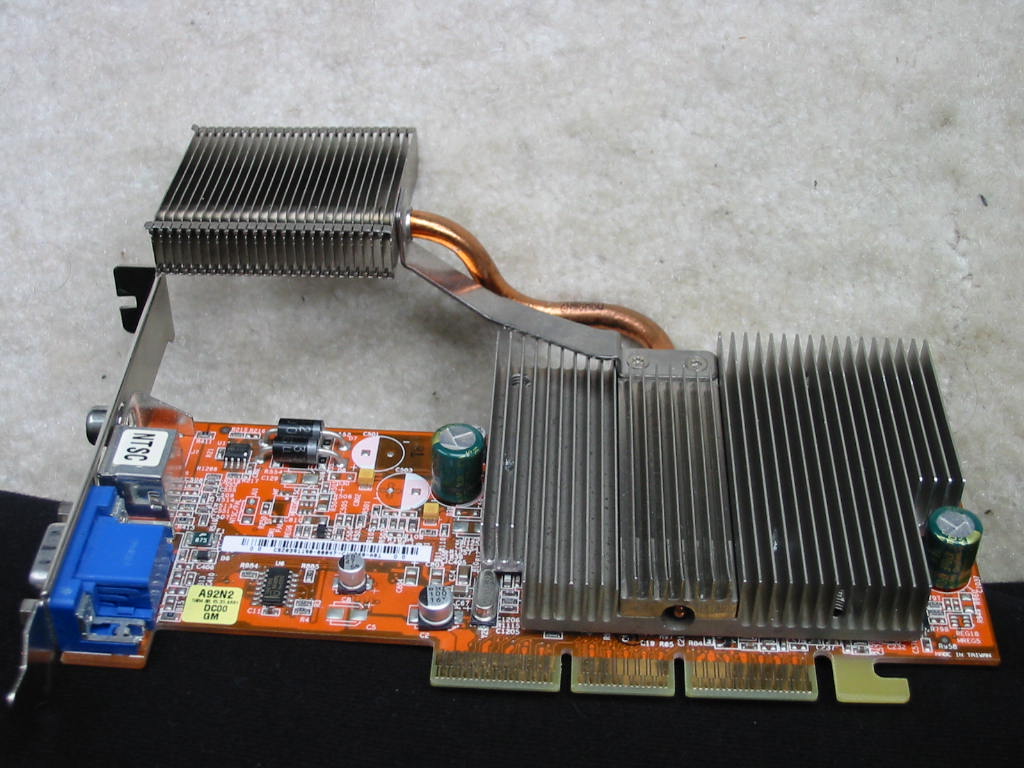

That being said, I will start with one of my home-brew coolers that I made for an ASUS Radeon 9200 SE (“slow edition” … I know, don’t laugh!) 64 MB AGP video card. Here is how the card looked originally:

This video card was in my first own gaming computer back in the early 2000’s, and hence I have a bit of a sentimental attachment to it. Therefore, I wanted to make sure it’s cooled well, even though it is a Radeon R200 series-based (RV280) video card, and these just don’t suffer from failures and artifacts (mostly due to the GPU being an oldschool wire-bond chip.) Nevertheless, the card’s stock cooler would always get pretty much scorching hot during gaming, so I always had an 80 mm fan running and pointed at it back in the day. But since I have so many Xbox 360 CPU and GPU heatsinks that I have no particular use for, I figured this trusty old video card could get a slight upgrade. Why not, right?

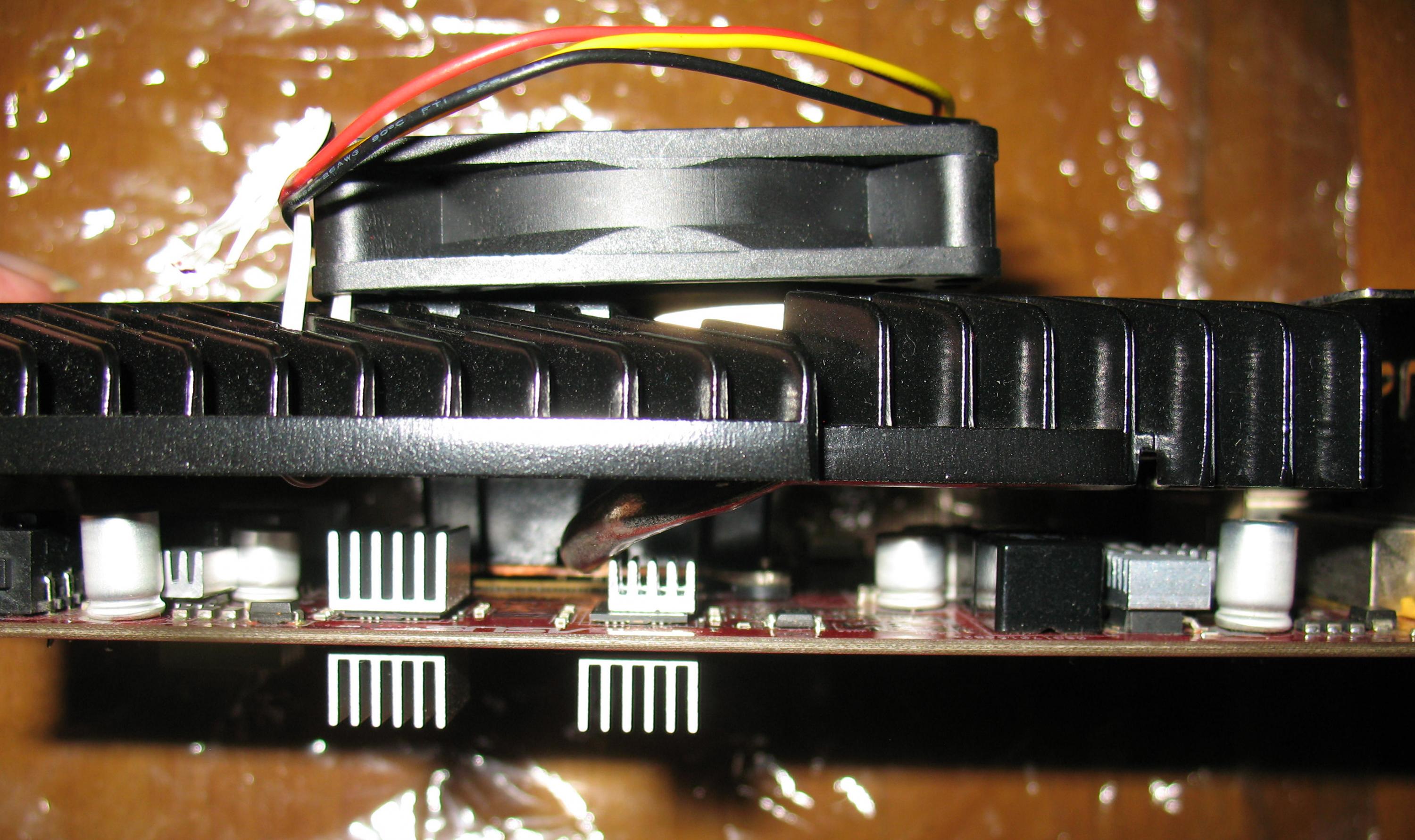

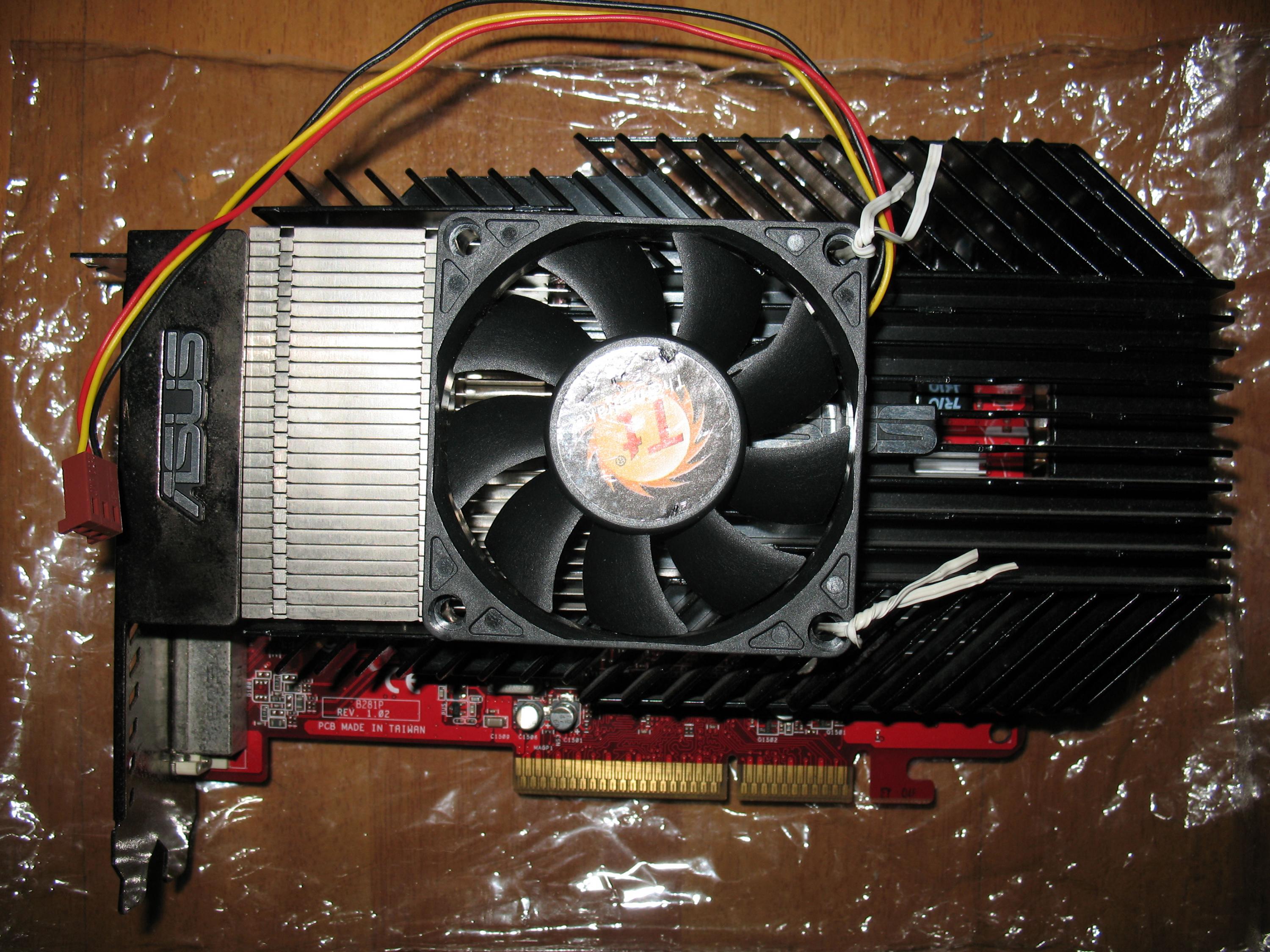

So here’s the result of that:
https://www.badcaps.net/forum/attach...1&d=1530570530

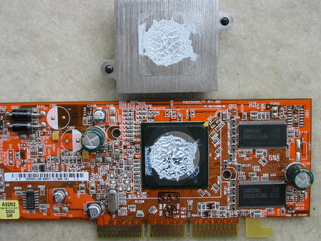

The new heatsink fit like a glove. I just needed to make minor cuts in two of the corners in order to get around various components on the board. Other than that, there wasn’t much else to this mod. Like many of the early Radeon video cards, screw distance is standard 55 mm diagonally for this card and only 2 screws hold the cooler. Speaking of which, here is what was under the original one:
ASUS didn’t use much thermal compound and it was the cheap white stuff. Surprisingly, though, it was still all very moist. I guess my early cooling mod with the 80 mm fan back in the days has paid off.
With the new heatsink I made above, the video card will still get pretty toasty without any fans or other active cooling, but not as much as with the stock cooler, thanks to the largely increased surface area. And adding even a slow-turning 80 mm fan running at 5V is enough to keep it cool.
Unfortunately, this video card is too old to have any temperature monitoring, so I couldn’t probe how much cooler it is running than before (Normally, I like to make temperature graphs of before and after). But if I had to guess, the original heatsink would probably run around 50-60°C under full load. With the modded Xbox 360 GPU rev 2 heatsink above, I don’t think the card goes above 50-55°C without active cooling, based on touch. Of course, the room temperature can affect those readings quite a bit too. But I did my tests in the same day with same room temperature, which was around 22°C / 73-74°F that day.

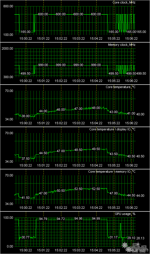

Also, here’s a GPU-Z screenshot, just because I always like to include it:
