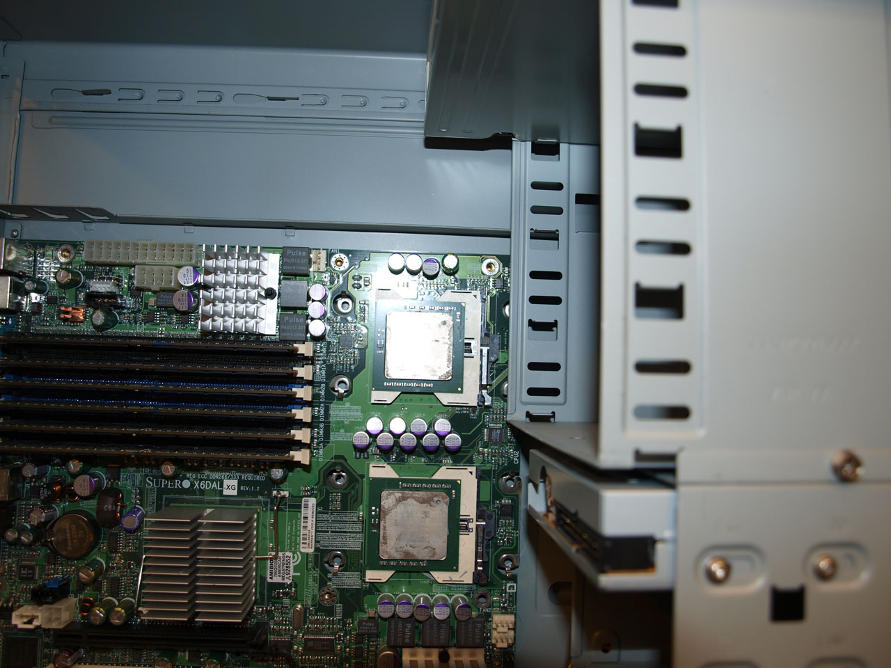

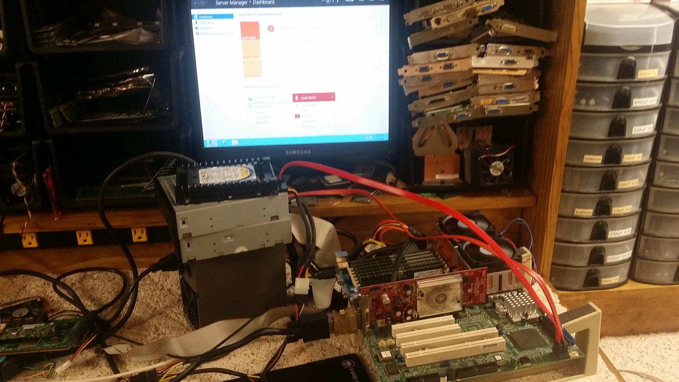

    I diddled around with this a little this morning... Mainly for testing purposes to make sure I have working hardware. This test is with the Irwindale processors. Of course this post was created from it. Wtaerfox 56.1.0 functions excellent on it. Quick load and smooth as silk browsing....although I haven't put it through the youtube test....
    I now remembered one of the sucky parts about SCSI, its the slowest booting bastard, even though its U320 with a 15k RPM HDD. Once it boots, its fine (benchmarks to come when I get it to a permanent state).
    Missing caddies located and replaced.
    CPU-Z:
    More to come, but back to my other project for now.

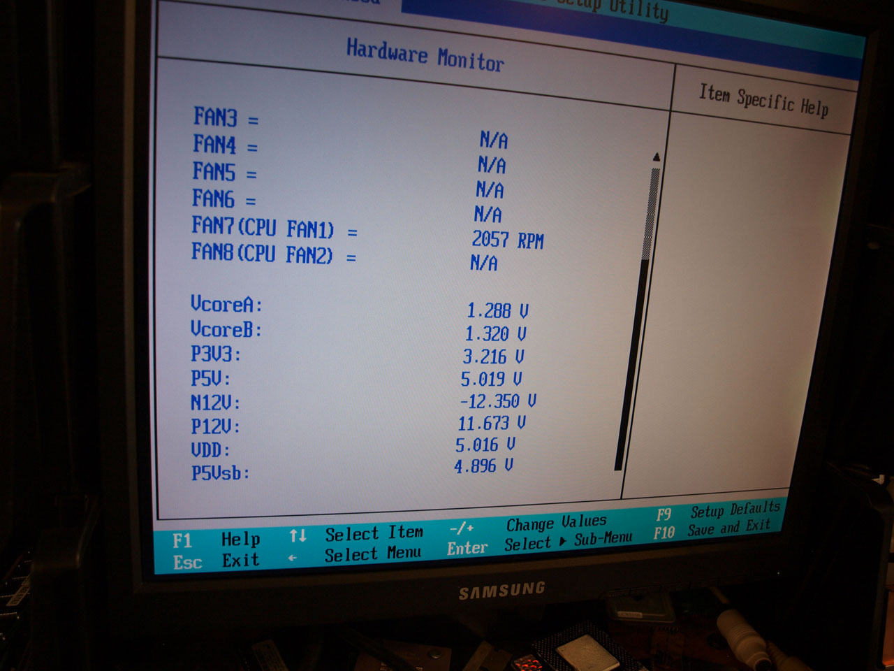

    CPU-Z shows wrong Vcore value, SMH...

      Now that you mention it, yea. If they were running at 2.6v, they'd be melting.
      Just to be sure, I checked the BIOS monitoring, its where it should be. Bug in CPU-Z I guess....my *guess* would be that CPU-Z is adding the 2 VCORE values into one reading.

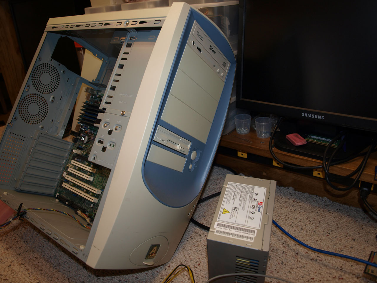

        Originally posted by Topcat
        This system was the freebie from the county. Stellar solid Enlight case with Enlight 470w PSU. I did the usual inspection of the PSU (whch appeared to be working)....and lo & behold, some bad fukyou caps, but otherwise its a very beefy PSU.
        still a garbage PSU, as are (almost) all Topower made ones.
        That one looks like it doesn't have the active PFC Board, does it??
        And its either P4 or P5 series...
        And the big heatsinks are due to really shity efficiency - the one's I've seen are around 65%, maybe lower 70% range...
        Even if it seems fine, I'd throw it away and use a more trustworthy unit...

            Re: Paxville or Bust! The Supermicro X6DA8 Project
            I'm not using that PSU in this build, I haven't even messed with it beyond taking the cover off. I have a couple Supermicro PSU's to choose from (a 865W and a 665W, both are Ablecom built), and those are bulletproof.
            The pics shown are using a bench supply, Antec HE650 (seasonic & recapped)....good PSU's.

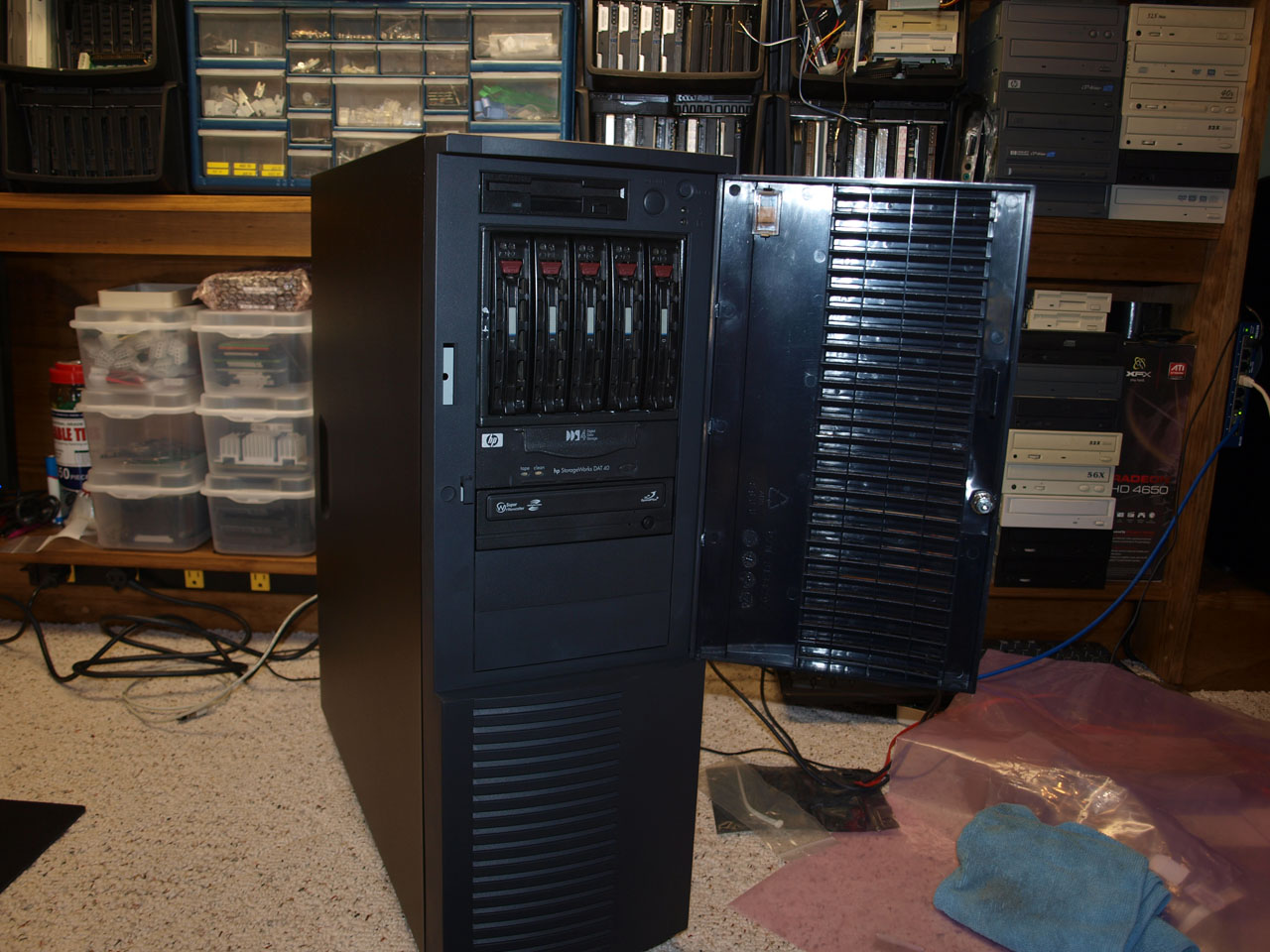

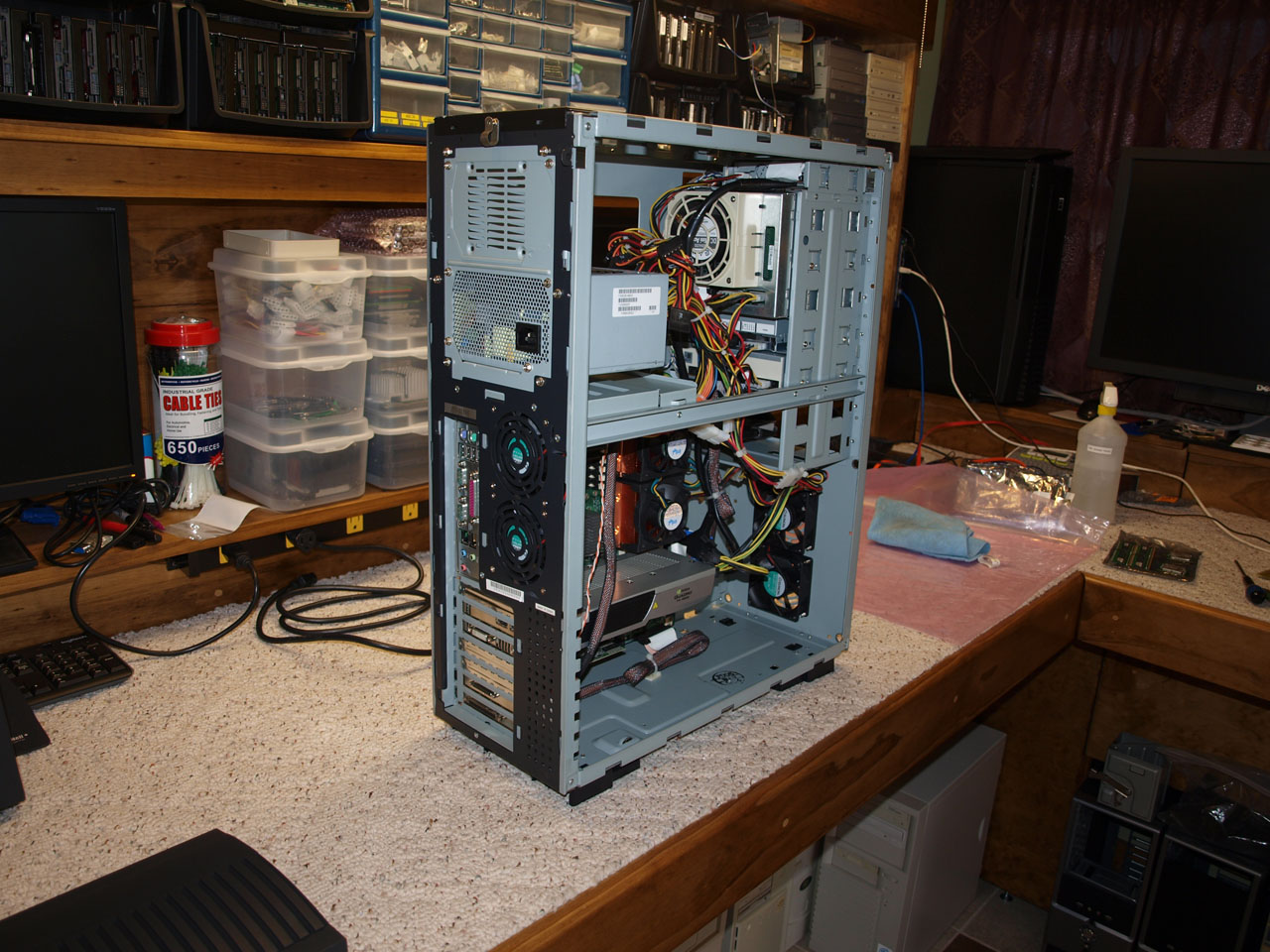

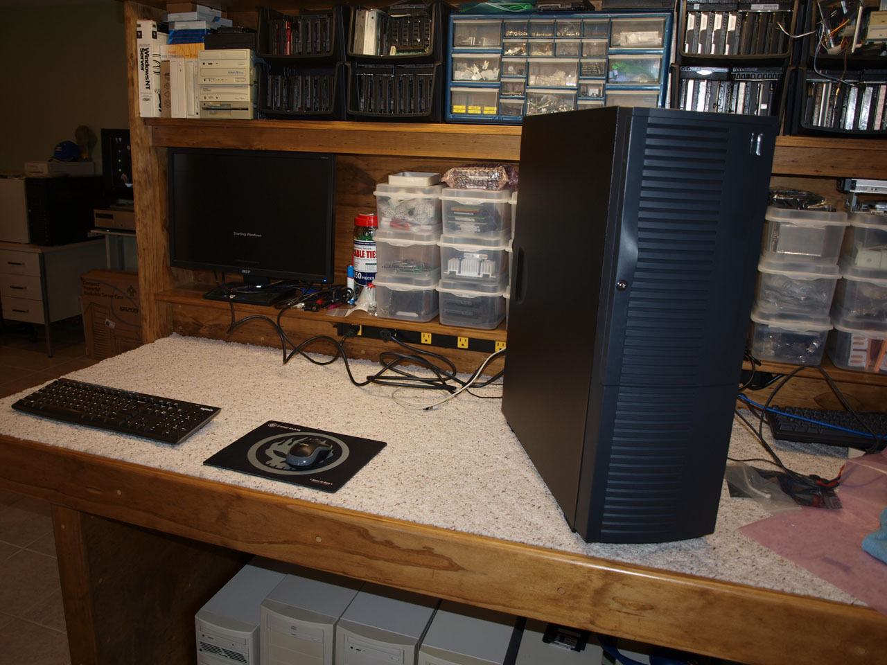

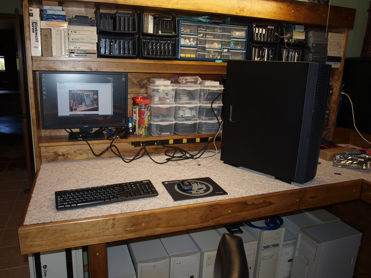

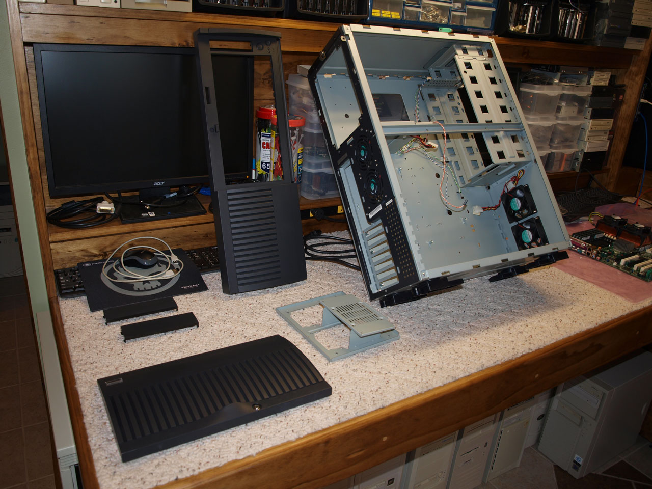

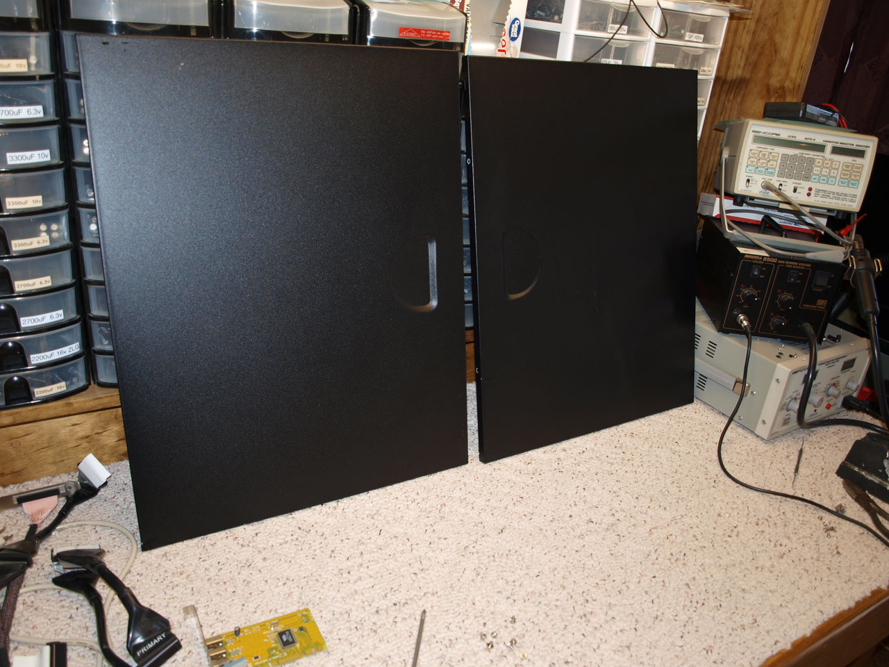

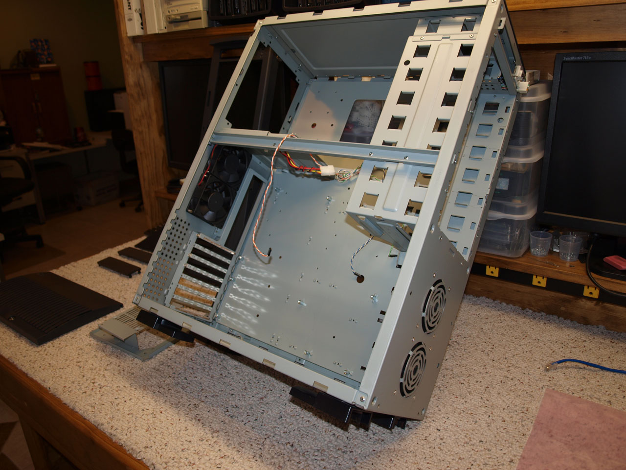

              I piddled around with it a little this morning, I got the case debadged, sticky goo removed, and washed out.
              Just a few pics...
              So much awesome!
              Even more elderly PC awesome!
              More later.

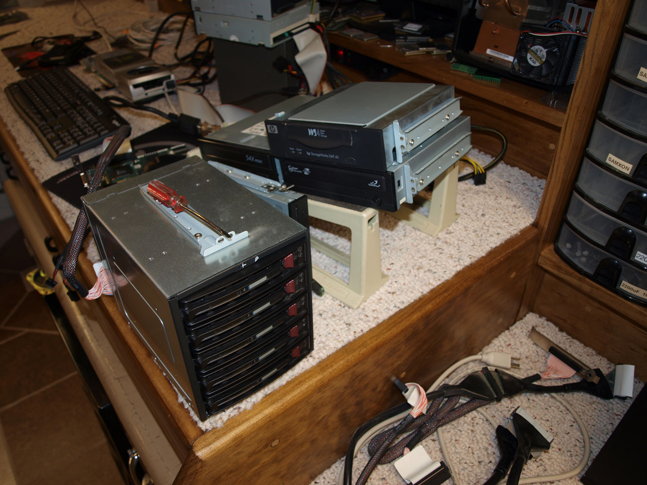

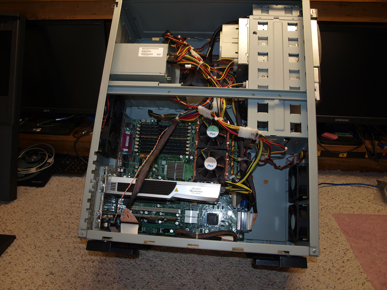

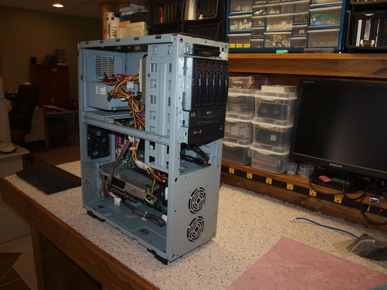

                I assembled this system this morning. Its so nice working with well-built cases!!
                I ended up using a 500w Supermicro PSU (Not sure who OEM'd this one)...Yes RD, its that one that came out of one of your new cases many moons ago. I used it in another system, and sold it a few years ago....the client upgraded and I ended up with that system back...and here we are.
                Anyway, I want to change HDD's around a bit. It's running a single 146gb 15k RPM. I want to get a few more and try a few different SCSI RAID configs, for benchmarking & testing purposes....but its running & stable right now, in an awesome & clean case. Fun project for under 100 bucks!
                Photographic goodness....

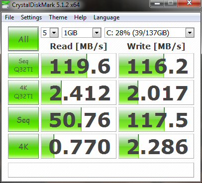

                Here's the Crystal DiskMark for a single drive U320 15k RPM on an Adaptec 2120S RAID controller....yikes its slow compared to SAS! I'll retest this when I can run it in a raid0/10.
                I'll hunt down some drives whenever I have some more free time... This post of course created from the freshly assembled Irwindale Awesomeness.
                    No, this one is actually a pretty reliable PSU. Just has pretty low efficiency, like you said. It's basically a 5V design with a "beefed-up" 12V rail. Of course, like any oldschool design like that, don't expect to pull full total label power on the 12V rail or even half of that without some serious sag on the 12V rail. But all in all, it's a good PSU and is more than adequate for the system that it was running (sans the Quaddro FX4800, of course).
                    That said, be glad this PSU didn't come with APFC. Otherwise, that efficiency number would have been even worse. Not to mention make a big dent in reliability. Only real server-grade PSUs can be considered reliable with APFC, at least from what I've seen. The APFC garbage we see in consumer units today is just a ticking time bomb. A few years and *bang* goes the primary cap(s). I have seen very very FEW oldschool PSUs with voltage-doubler circuit have their primary caps go bang (usually, it's from incident with the 115/230V switch set to 115V on 230V mains). In contrast, I have seen a considerable amount of "modern" units with blown APFC circuits / primary caps - even with Japanese brands.

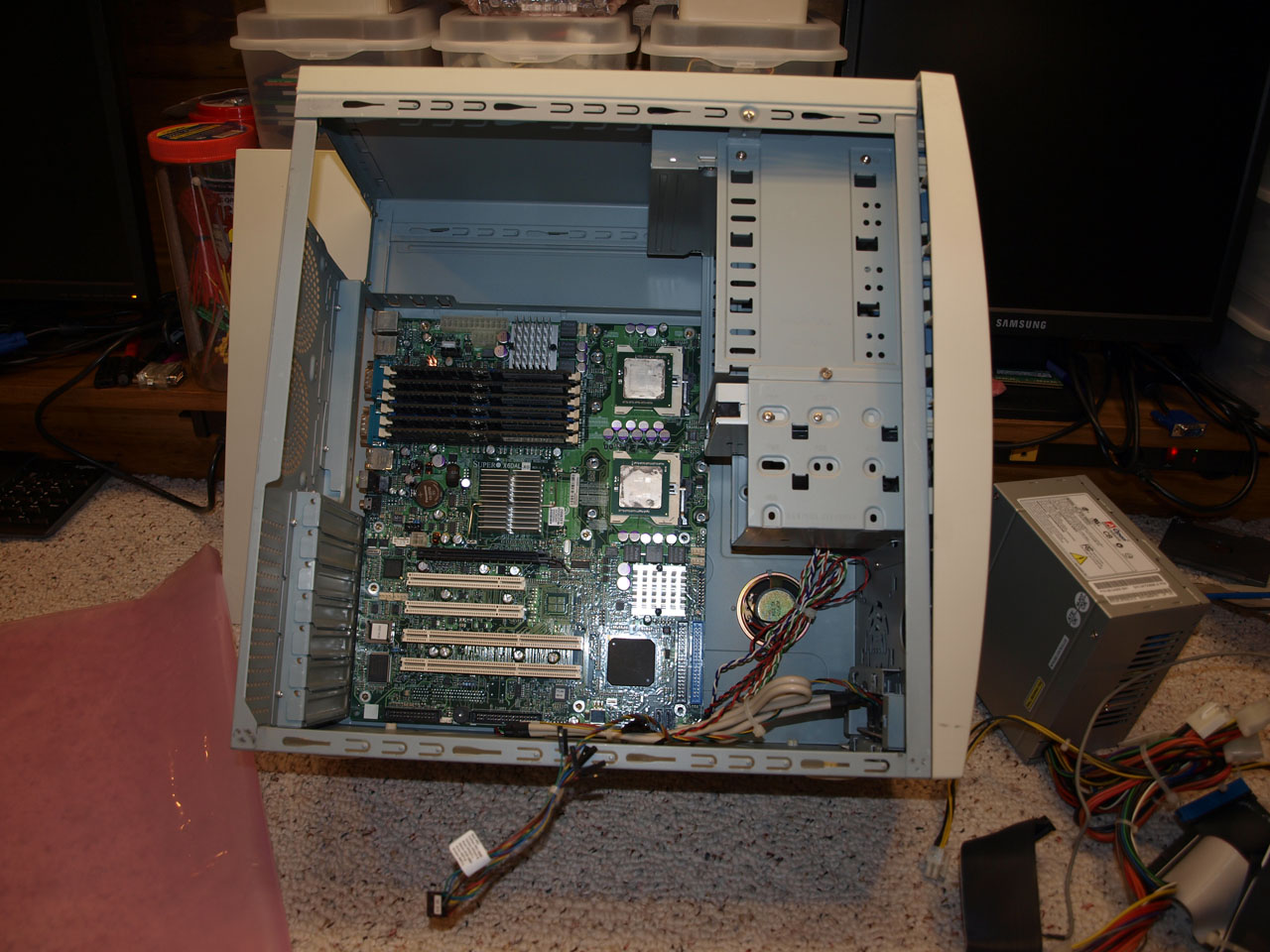

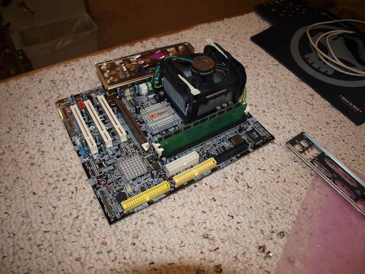

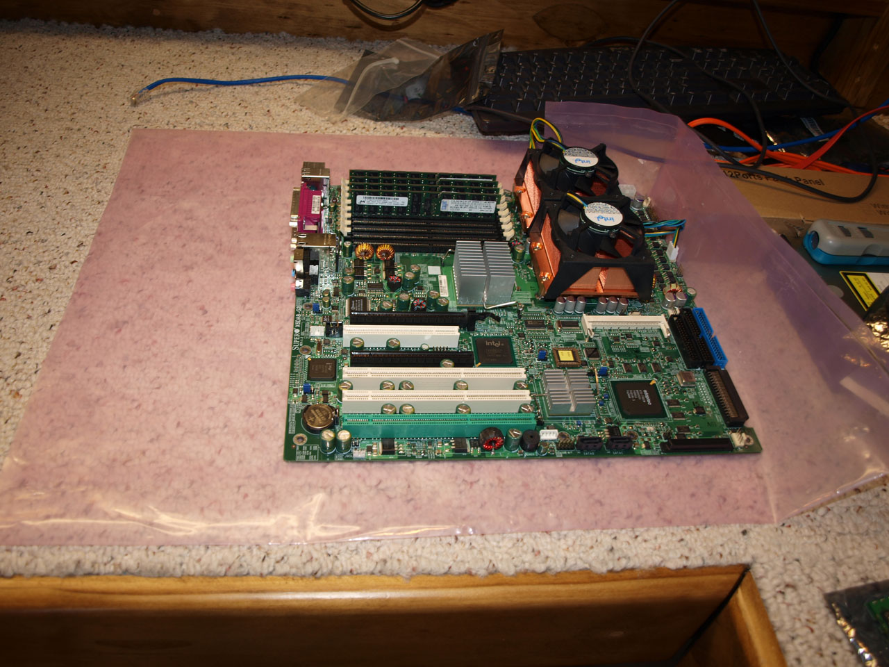

                                    ...and here's the start...I'll just throw this build into this thread since they're kind of 'cousins', no need for a new one.
                                    What better use for an old beige Aopen case...
                                    Some modifying will be required (which makes it more fun anyway):
                                    Old mATX P4 system (momaka, let me know if you want it, it works).
                                    More to come....
