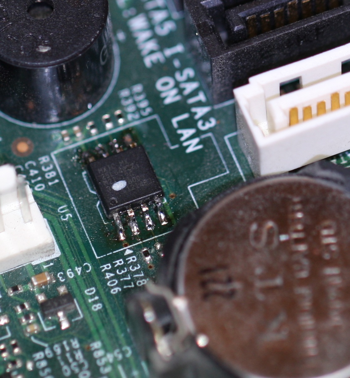

            Anyway, I tried first to recover it using the BIOS recovery method quoted by pfcom below.
            However as pfcom says it seems whenever the CATERR LED is lit you're basically fucked, and it was on this board...

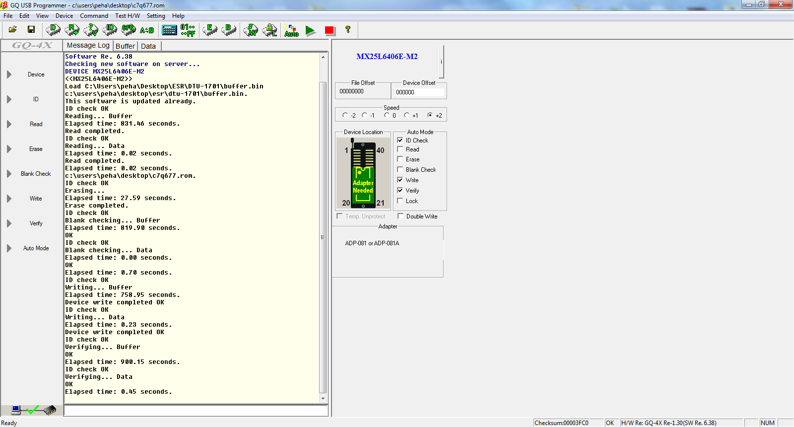

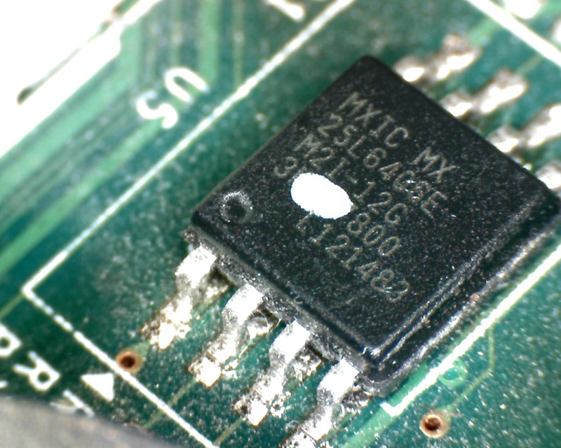

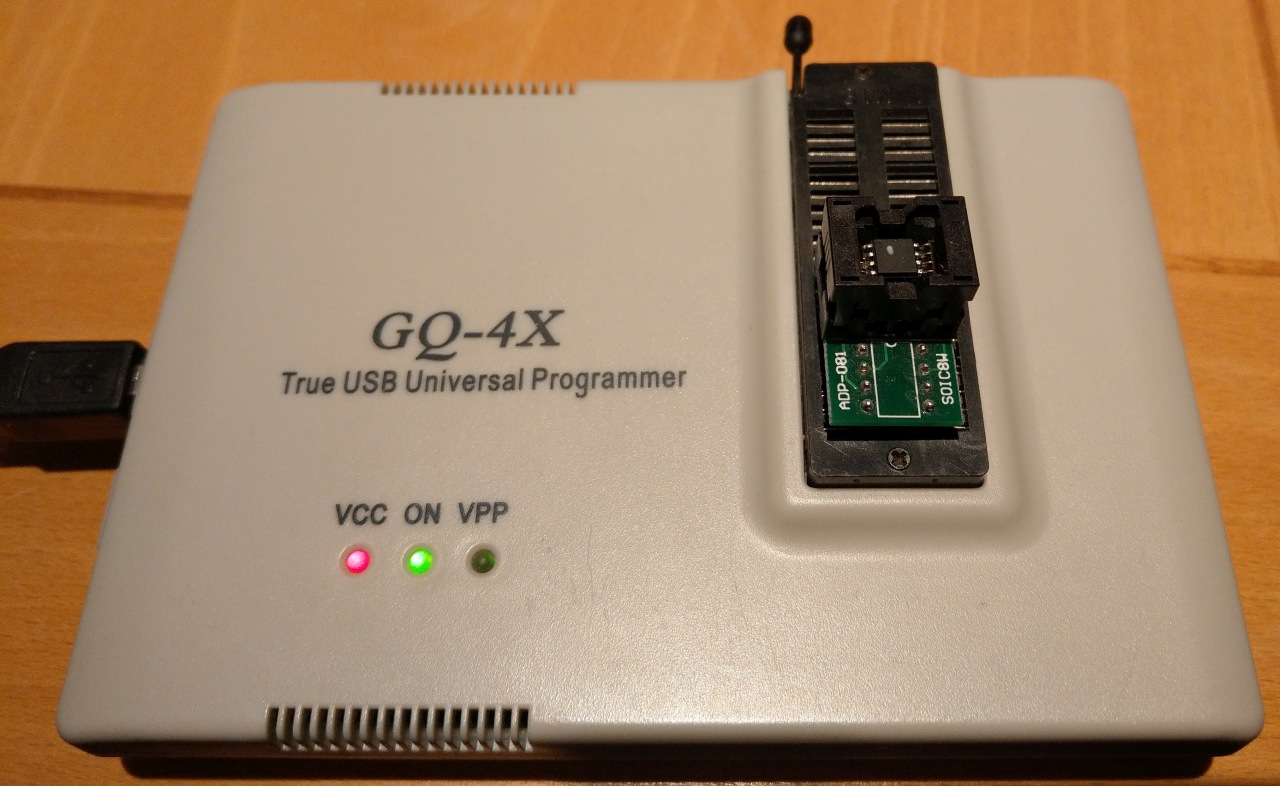

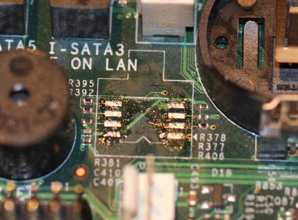

            So I desoldered the little Macronix MX25L6406E BIOS chip and flashed the latest BIOS using my Willem GQ-4X programmer and the ADP-081 adapter.

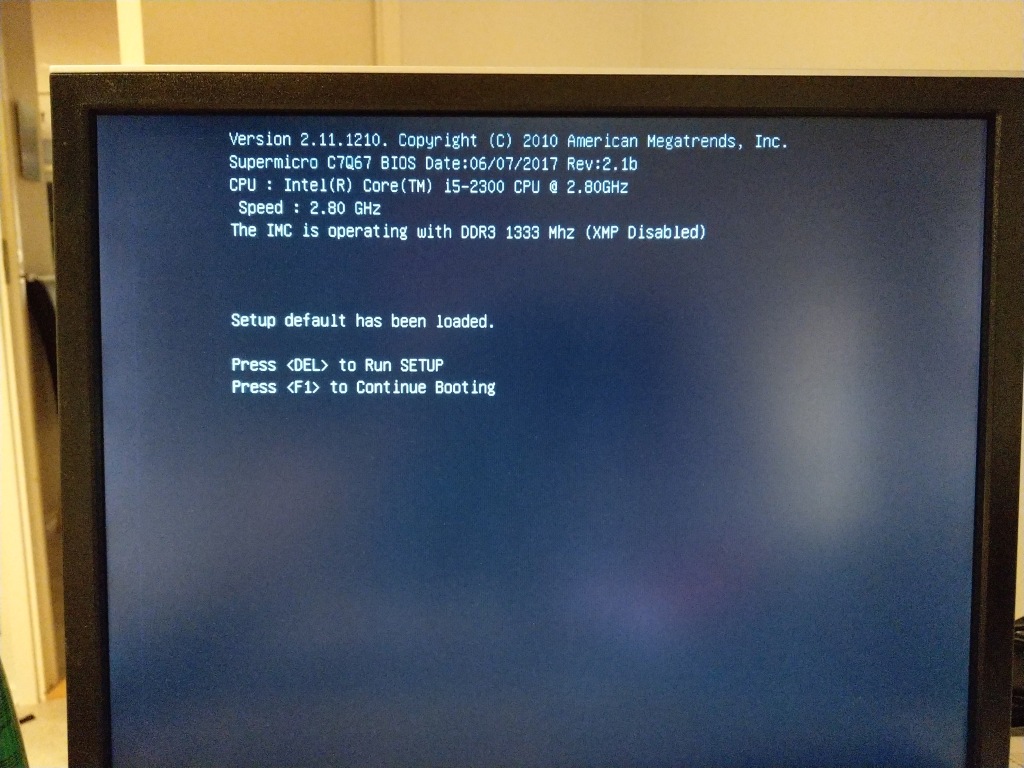

            Board POST:ed just fine after that endevour: It should be illegal to not put a socketed BIOS chip or a ICSP port so it can be programmed, but I digress.
