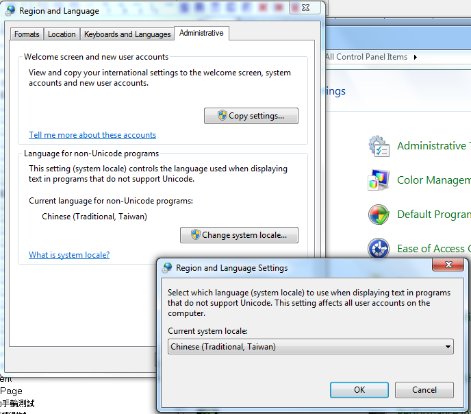

                          Re: Converting hex to Chinese.
                          Did you ever try just changing the system locale to Chinese?
                          See the following photo:
                          I program PLC's using a software by Fatek called WinProLadder.
                          The program is not Unicode aware, so when I load a project file written by the Taiwanese machine builder all the projects comments show up as gibberish.
                          But if I change the system locale and reboot (which is very annoying) as the picture above shows then the Chinese characters show up fine.
                          Of course I have to then change it back when I'm done with WinProLadder else everything else on my PC which is not Unicode aware will display the wrong characters...
                          I found an old abandoned Microsoft program called "AppLocale" that gets around that.
                          I'm using the modified version called pAppLocale from that Wikipedia page.

                            Actually, I did. For 7 though, I had to convert to Ultimate. And because I'm running in a virtual machine, I only had a key for Home Premium. I know this isn't right, but I built a KVM BIOS for the HPE DL380 Gen 9 that had SLIC 2.1 data specifically for the DL380 Gen 9. I then used the Windows Anytime Upgrade and some key I found online to upgrade 7 to Ultimate. The key didn't work though, it wouldn't activate, so I had to do the SLIC BIOS stuff and use an HP Ultimate pre-activation key with the cert, which worked fine.
                            I installed all the languages, I switched the Locale, but it didn't help. The reason is because although the language is in Chinese, in the actual program, they have the codeset set to 1033, English. The goal was to change that to Chinese, which isn't hard, using something like PE Explorer (or even a free alternative), but the Wise Installation program they used to create the Setup.exe has checksums, many. And I was following it in the debugger, but it was taking too much time. It extracts some wise programs, names them with a .tmp extension, executes another wise program (the main one). The actually programs are encrypted, and breaking that encryption is a pain. It'd take months to follow it all, for someone like me. I could never actually find the Chinese characters in the program, using the disassembler, because of the encryption or compression it uses. What a pain in the butt. Anyway, I just installed with all the giberish and I think it works, even though everything's gibberish (file names, device names, menus, etc). But I can find my way around. They attempt some English stuff, there's some English DLL file and a Chinese one.
                            If you understand PLC Ladder Logic, maybe you could help. On the HMI touch screen device, the columns for the BGA don't make sense. We know what they do, but we want to rename them. Would that be in the PLC Ladder Logic or would that be something in the actually HMI firmware code or something?

                              That does not make sense, if the program only supports Chinese surely with a Chinese Windows install you'd get Chinese?
                              Did you actually change the setting I show above, which is "Language for non-Unicode programs"
                              (That setting does not change the system language, and does not require Ultimate AFAIK).
                                  I must be in the wrong place, because when I go to Control Panel -> Region and Language, I set it, it changes the Recycle Bin to Chinese, etc.
                                        Let me try to explain better. The text is in Chinese, but with a resource editor, we see the code page in the file is set to English. When I run it, it picks 1033 for me, but the text is still in Chinese. I think the programmers thought they could just pick the English code-set and it'd convert the language itself to English. I don't think they realized they had to actually write the text in English as well, hence the reason it shows up as junk.
                                        If it picks English obviously your operating system is telling the program that your system language is English.
                                        Otherwise you'd get Chinese!
                                        The screenshot I showed above of how to change the Language for non-Unicode programs in Windows 7 is pretty much the same in Windows 10 too.
                                        They have just split Region & Language into separate entities.
                                        The path for 7 and 10 is: Control Panel > Region (& Language) > Administrative > Change System Locale
