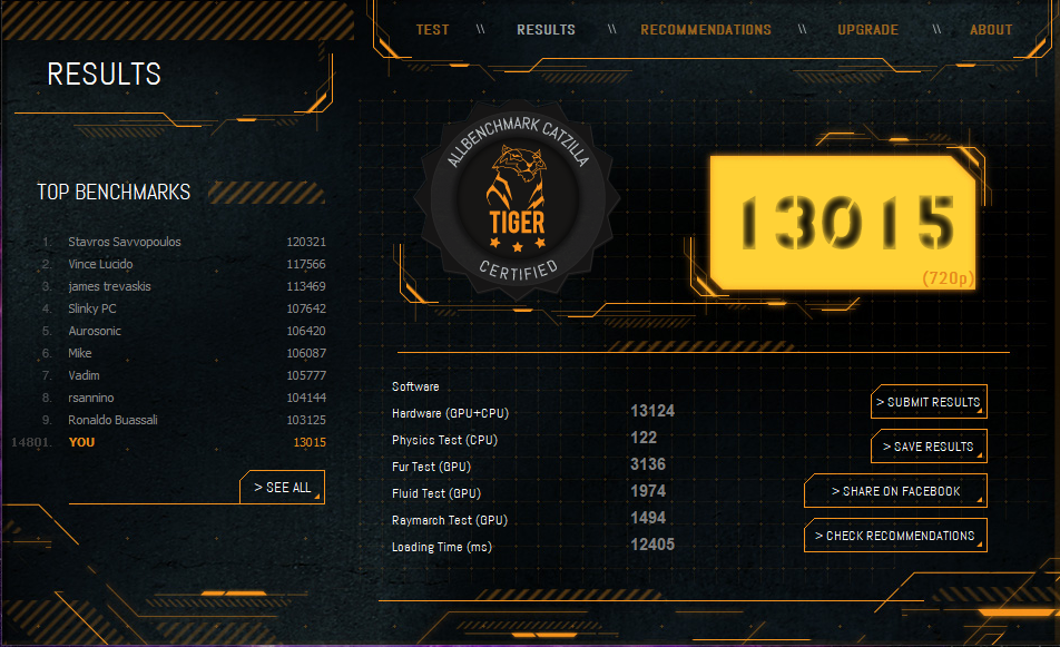

                      I think the issue is Novabench, not the system.
                      Ran catzilla, and got a very good score:
                      I've been getting scores in the 11000-13000 range on my other GTX970 based systems... this one is the fastest, and the benchmark shows it.
                      Go figure.

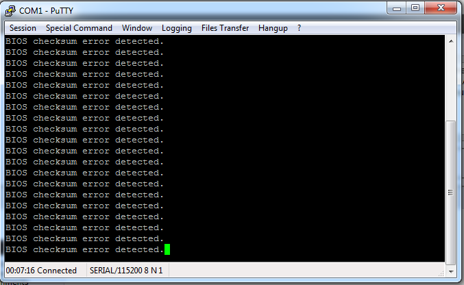

                        I've done bricked her again... in a vain attempt to try get some less obnoxious fan curves, I decided to update the BIOS (which was already updated! )... and also the CPU microcode. BAD idea to do on the same boot... corrupted the BIOS checksum per hooking up over a null serial cable.
                        Sadly, all it's doing is giving that message with no way to tell it to shut up and take a new file.
                        Somewhere I probably have the new chip I bought several years ago... maybe. It's been a long time...

                                She's fixed. Serial trick again. Forgot that I have to connect as soon as it powers up and answer the prompts very, very quickly.
                                Why am I such a freaking IDIOT?

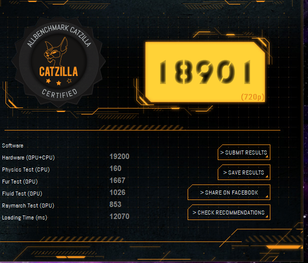

                                      I know it's not a game, but I did several Catzilla benchmarks... from that system's thread (which I never posted the finished build, apparently???):
                                      Originally posted by ratdude747 View Post
                                      Was finally able to run catzilla…
                                      Single GPU system (the mismatched evga gtx 970 SSC) for comparison (dual low voltage xeon hapertowns):
                                      SLI is indeed working... almost double in the gpu parameters. Yay?
                                      That wasn't on the final setup either. Running off a single clay pigeon HDD... among other things optimized later. But the GPU scores were doubled, which indicates that SLI was making a substantial difference, at least in that case.
                                      As far as I'm concerned, as long as Nvidia and OEMs supports it, it can't be dead... practicality aside.

                                          For the record, I just catzilla'd it in it's final form:
                                          A bit better... not as good as this thread's actual system (per a prior post) but the GPU scores are what made it worth building. For games that are more GPU intensive this isn't a bad setup... which WOW certainly isn't. Dunno. It ran well and I happened to have half the hardware sitting (and I needed another win10 capable workstation anyway)... but that's for that system's thread; I need to figure out where my pics went (or why I never posted them)...
