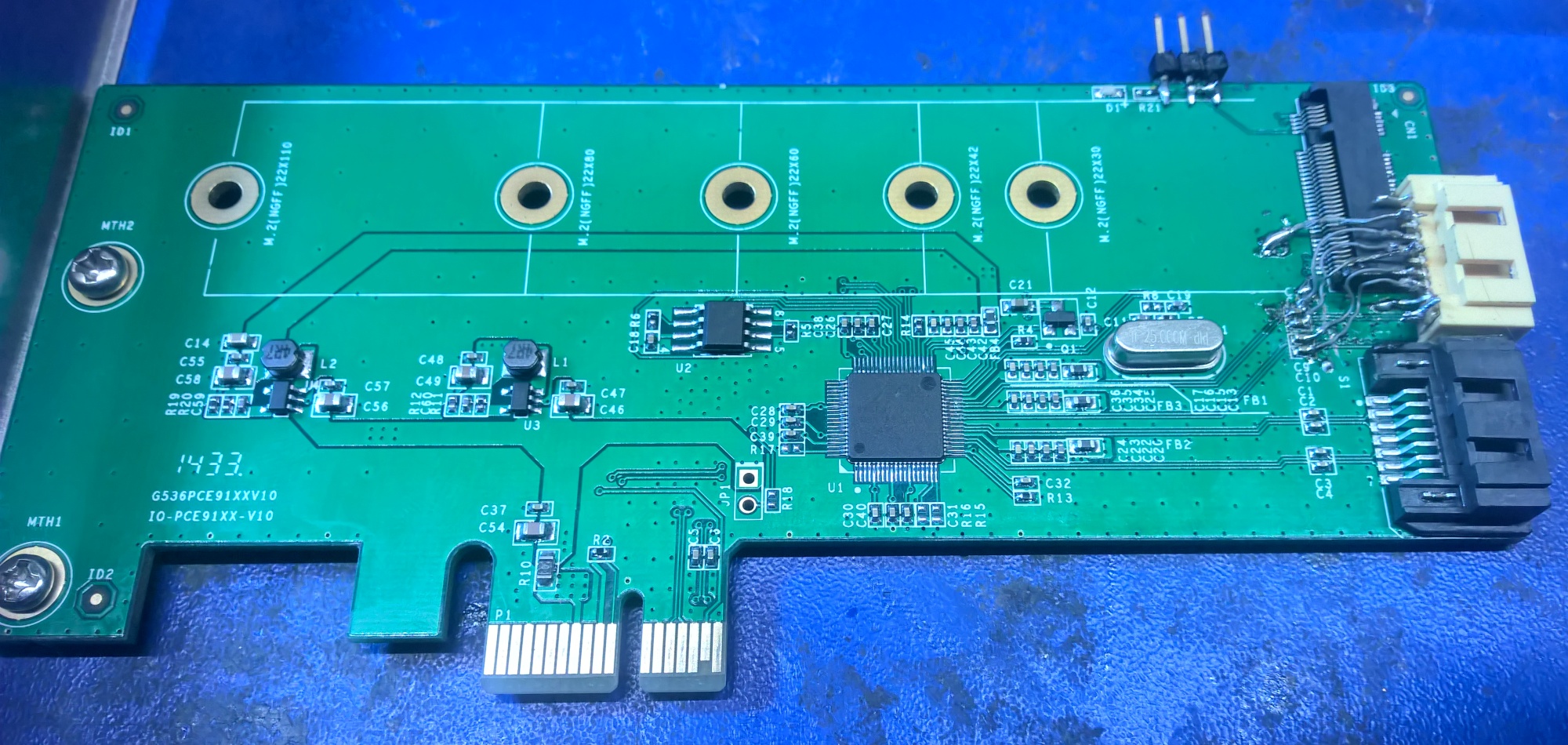

Update: I installed this M.2+SATA III card to PCI-E 2.0 1x adapter card that i'd bought a while back. Why M.2, you would ask? Well, that's because it's the only card i found on ebay with the Marvell 88SE9130 chipset which supports HyperDuo technology (see here for an in-depth review).
I knew that with the bandwidth limitation of a PCI-E 1x slot, any adapter is not going to get anywhere near native SATA III speeds, as the maximum theoretical throughput of a PCI-E 2.0 1x slot (which is the case here, it's even worse for a 1st gen x1) is 5Gbps, as opposed to the maximum theoretical speed of 6Gbps for a single SATA III port. So there was not much incentive to spend money on a SATA III card for the SSD alone as it would give little benefit vs the motherboard SATA II ports. But this HyperDuo thing seemed interesting, so i bought it. What HyperDuo is, it's SSD auto-tiering, similar to Fusion Drive on a Mac - where SSD and a spinning disk are combined into one logical drive, with the most frequently used data automatically cached to the SSD, effectively giving you the best of both worlds - a large, cheap drive and high speed.

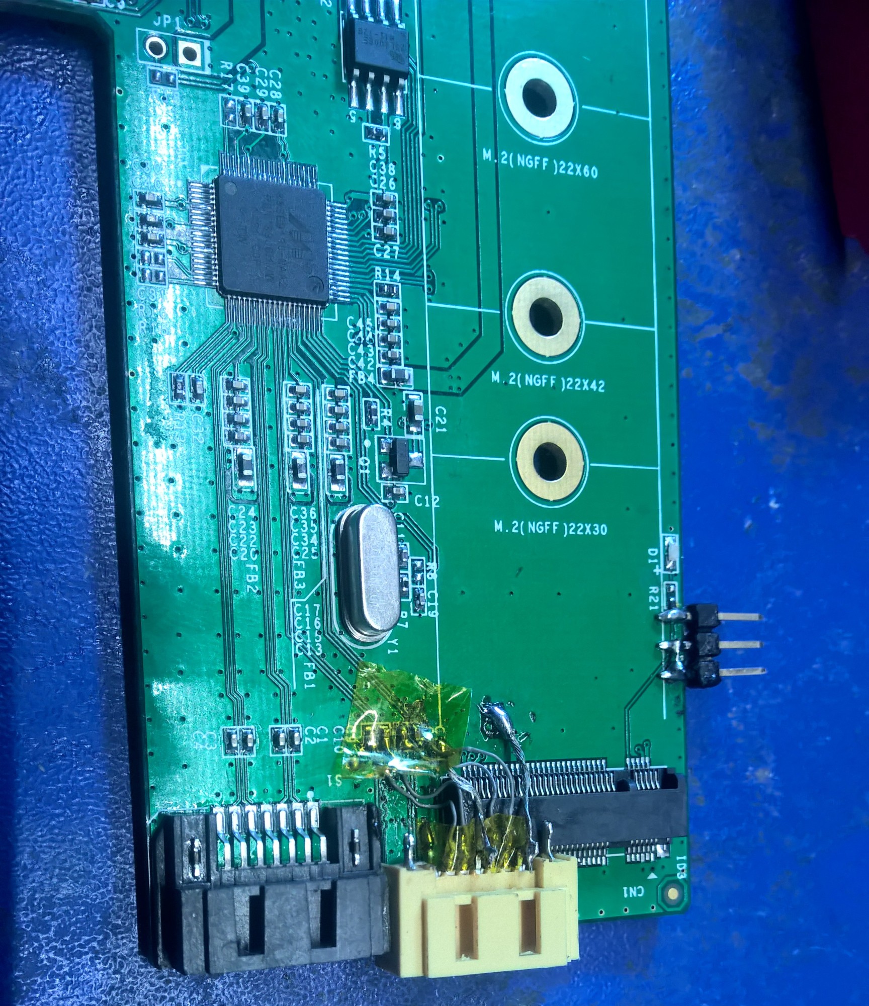

It was obviously left to myself to hack on another SATA port to the card as i had no intention of buying a M.2 SSD - the card uses the SATA connection of the M.2 slot so only SATA SSDs in M.2 form factor are supported, no black magic there. I kept my Samsung PM951 128GB SSD and eventually settled on a recovered 1TB Seagate 7200.11 for the spinner side. I wanted to buy a WD Black for this purpose but hey, this drive was free.

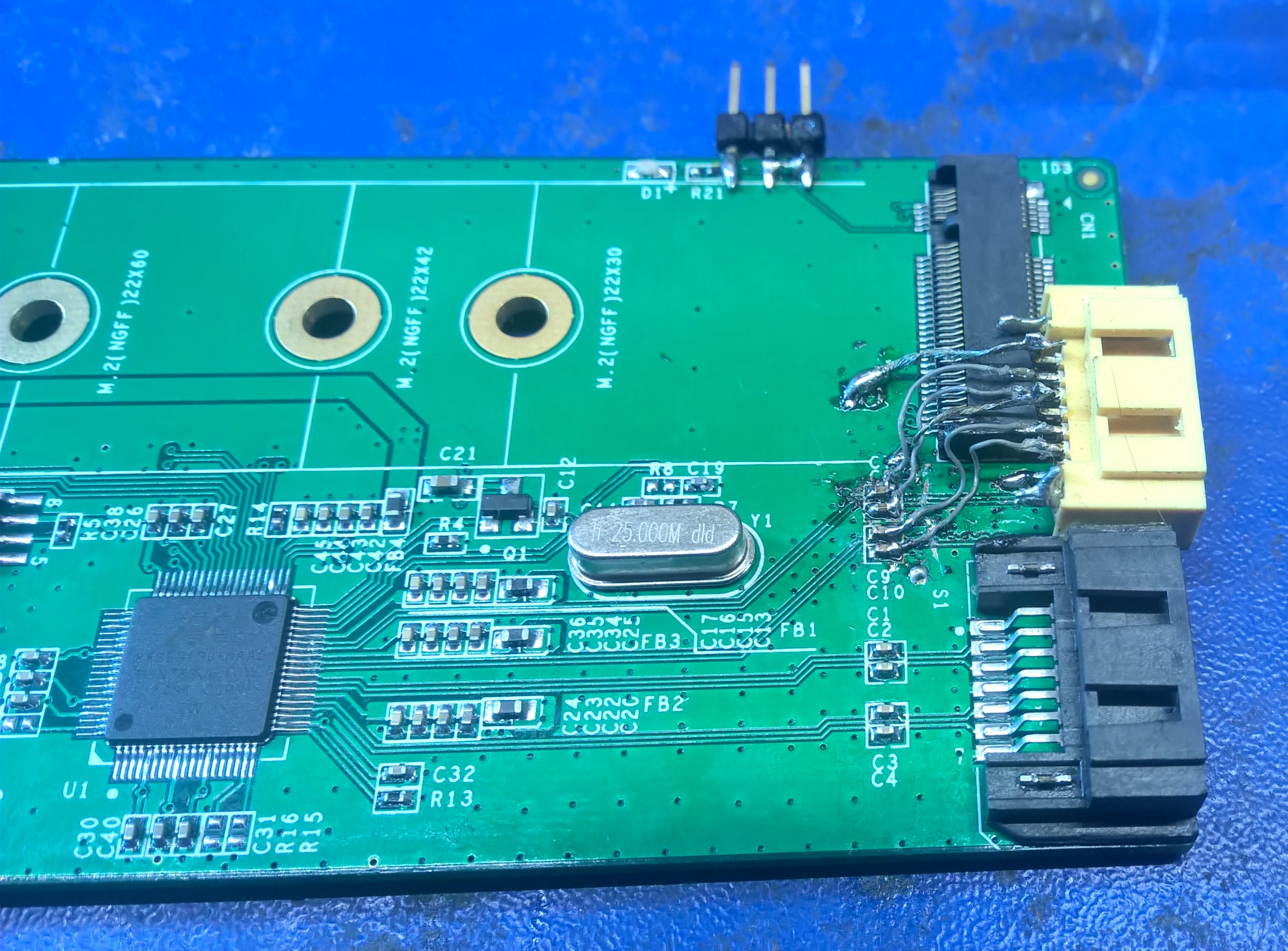

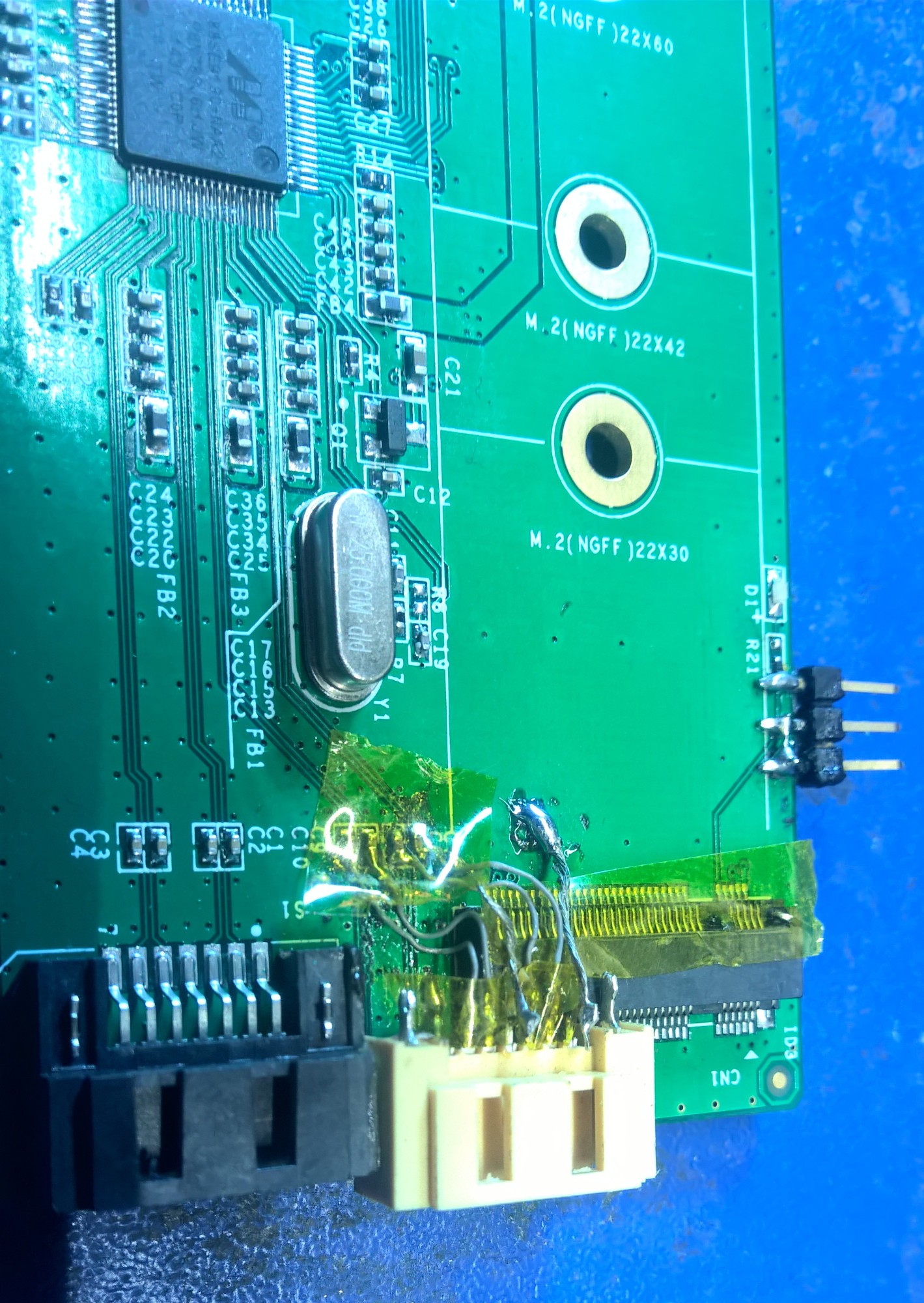

I put a second SATA port on the card, cutting off the tracks to the M.2 slot close to the coupling capacitors. This is very important, as due signal to reflection effects on the unterminated transmission line, it is going to cause trouble if you leave them connected. Before i cut them, i was either getting that port detected at just 1.5Gbps (SATA I speed) or the card would just hang POST when a drive was connected to that port.

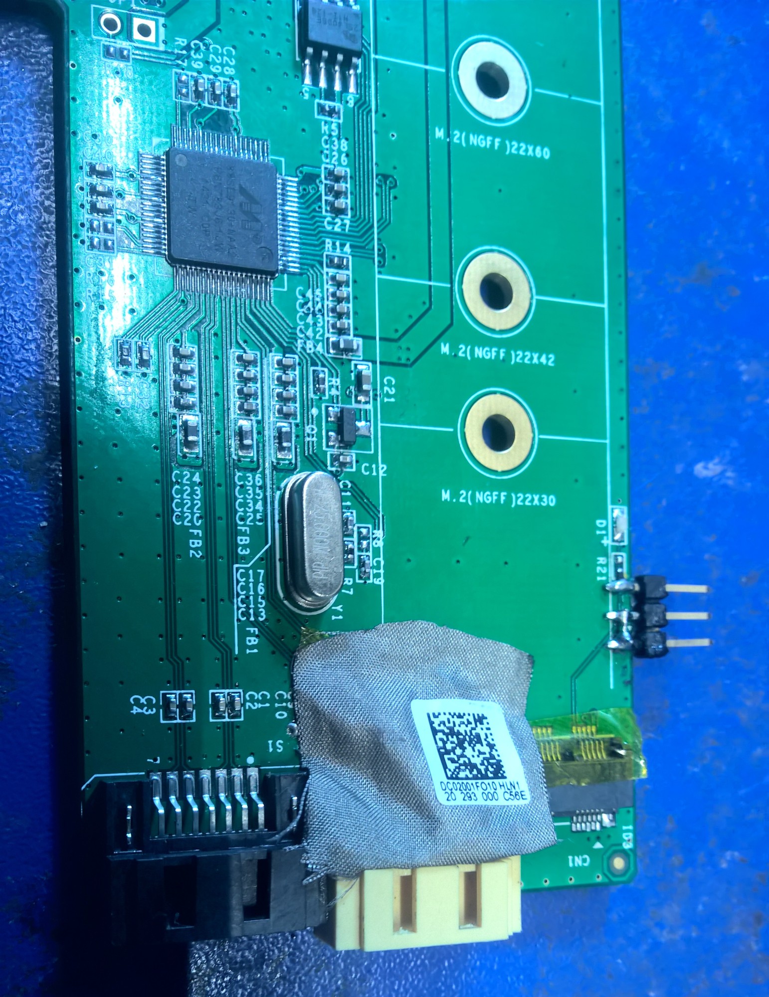

I made sure to have all signal wires the same length, insulated the signal connectons with kapton tape, then added some conductive tape on top of that (cut from a bad LVDS cable) over the whole job, touching the ground connections, to provide shielding for the high-speed signals. I added the shielding tape after i had some initial data corruption and had to delete the array and start over - it's been working fine since.

As i later found out, the activity LED was only hooked up to the M.2 slot, so the M.2 SATA drive itself would have handled that, the controller does not have any activity LED output (i've checked the datasheet). So that header you see there is useless, but i'm not going to bother taking it off now.

You should get a hot glue gun (or use it more often) - in cases like yours above where there's many loose wires soldered to a loose connector, I always apply a hefty amount of hot glue. It's almost permanent, yet still easy to remove if really needed. And keeps the wires in place in case of an "accident".
I do really dig the metal jacket/shield you put on top of those wires, though. And that QR code on it makes it looks completely legit.

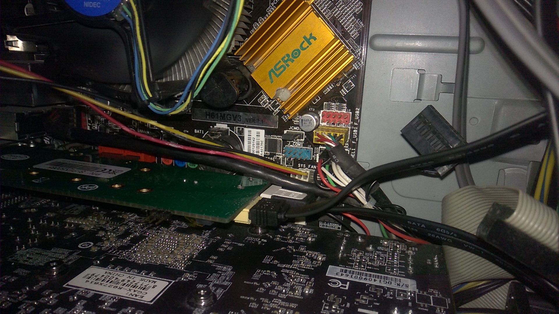

Here's a pic of how everything looks in the case. The added port looks as stock as it could be.
Ultimately the header for the LED ended up being useless - turns out it relied on the m.2 SATA SSD to provide the signaling. The controller itself does not have any provision for an activity LED - i've checked the datasheet as well. Now the only time my HDD led lights up is when the computer is performing a backup to the 2TB drive. I'm fine with that.
