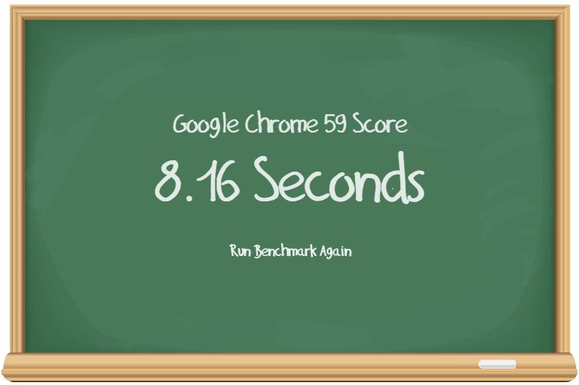

    So after proper configuration, this is the expected Haswell benchmark result:

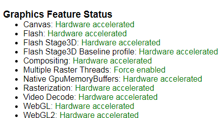

    Now you can ignore native gpu memory buffers - eventhough it has been force enabled from the command line, it doesn't work in any version of Windows. Ideally, we would want to use a minimum of Skylake so that Zero Copy could also be taken advantage of. But I did in fact find that chalkboard scored 1 second or so better with it enabled on Haswell. Also, the cost of a used Skylake laptop doesn't justify the extra expense for the small performance gain.

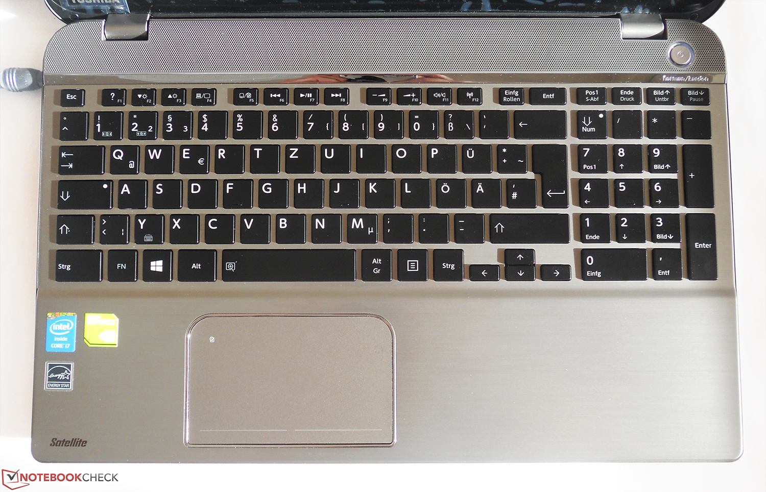

    Let's have a comparative look at the Envy 15 and the Toshiba P50:
    Is it just me, or does it look like Sager or some other company in China is just cranking out these generic Ultrabooks and then the companies are just slapping their logos on them?
    They simply won't do. And what's with HP and their nuevo garbage 4mm AC adapter plugs? Yes, because you really want to rely on an angled power connector that's only 4mm pushing 90w into your laptop.

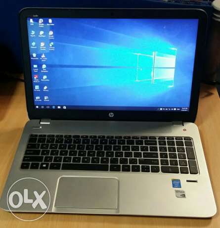

    Now one early consideration was an HP Envy 15... You have to be careful with these though. Most of them have nVidia graphics, but some don't. Get one with an nVidia chip and you'll be sitting on a paperweight that won't post in a few years because the GPU has bit the bucket. With the Haswell models, the ones that don't are also missing the M.2 socket. I thought I might just add one myself which wouldn't be too difficult, but I ultimately decided against the Envy because quite frankly, they are poorly built junk.
    Another real problem with the Haswell Envys is that they also have the dreaded 4mm DC jacks everyone complains about, and they're located to the left of the laptop, which would be a bit inconvenient.

        Where did the Graphics Feature Status list come from?

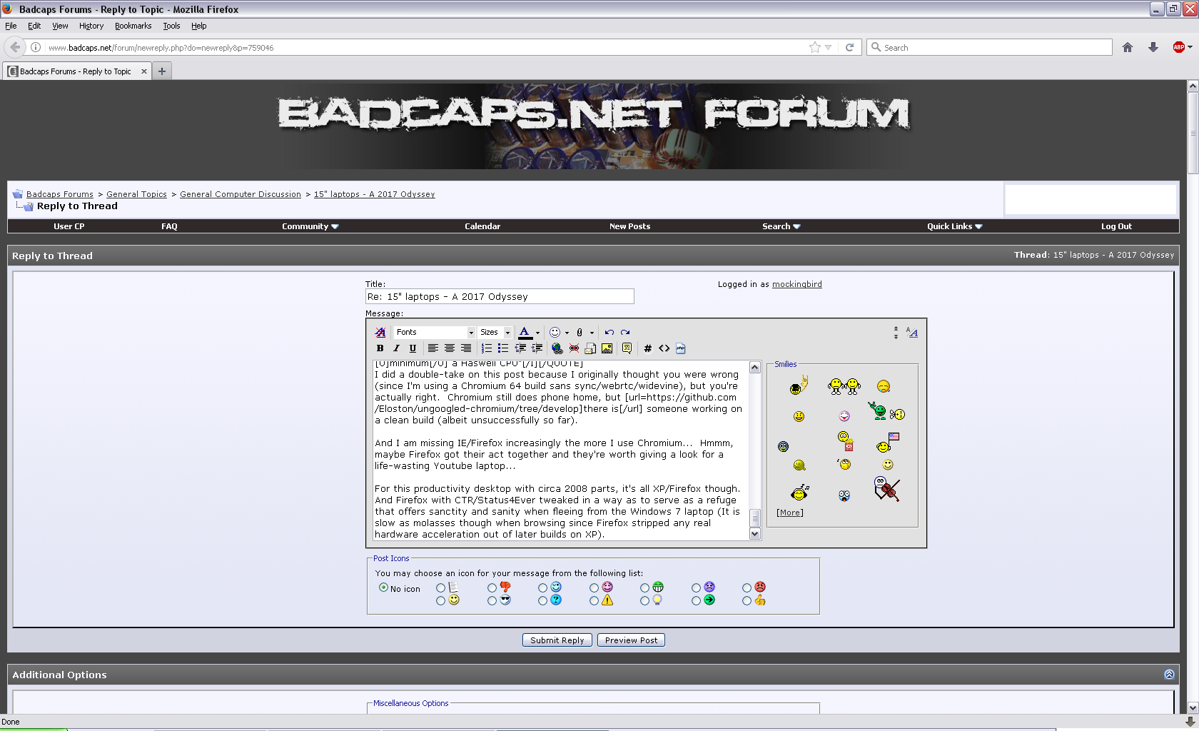

              I did a double-take on this post because I originally thought you were wrong (since I'm using a Chromium 64 build sans sync/webrtc/widevine), but you're actually right. Chromium still does phone home, but there is someone working on a clean build (albeit unsuccessfully so far).
              And I am missing IE/Firefox increasingly the more I use Chromium... Hmmm, maybe Firefox got their act together and they're worth giving a look for a life-wasting Youtube laptop...
              For this productivity desktop with circa 2008 parts, it's all XP/Firefox though. And Firefox with CTR/Status4Ever tweaked in a way as to serve as a refuge that offers sanctity and sanity when fleeing from the Windows 7 laptop (It is slow as molasses though when browsing since Firefox stripped any real hardware acceleration out of later builds on XP).

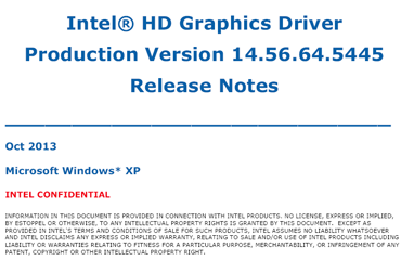

                Haswell is the last platform for which Intel provides official (= publicly released) chipset drivers, so no exclamation marks (except for the POS Intel WIfi card, that was btw recalled and I missed the deadline). That includes the iGPU drivers for those systems, Iris GT2 or Pro or whatever its called. The only catch with these "embedded beta really development testing only srsly plz dont install unless ur an Intel employee" drivers is that they support functionality level until IVY BRIDGE. What this means in English is they do not enable support for any new CPU/chipset features introduced with the 8 series platform, I guess its new pstates and such junk. It works perfectly, if you can live with some quirks with the iGPU.
                I don't have the link to the embedded driver atm (it's hidden fairly well) but if you're interested I can look 'em up and send you. It's clear you prefer NT5 as everyone who isn't insane does, so I guess it's worth giving a shot since you happen to have a Haswell system. Didn't check what iGPU you have though, is it GT2?

                        Don't have an account there but here goes:
                        Intel INF and Management engine for 8 series chipsets is uploaded to shittyshare because I could not find them on Intels site, and there's an upload size limit here...
                        intel_confidential.zip
                        Intel HD Graphics:
                        X32 - https://downloadcenter.intel.com/dow...-XP32-Embedded
                        X64 - https://downloadcenter.intel.com/dow...-XP64-Embedded
                        In addition to above I have another unreleased (well released to OEM vendors only) version of HD graphics for up to Haswell GT2 which I won't say where I found
                        (it's the intel8_xp64 folder inside intel_confidential.zip)
