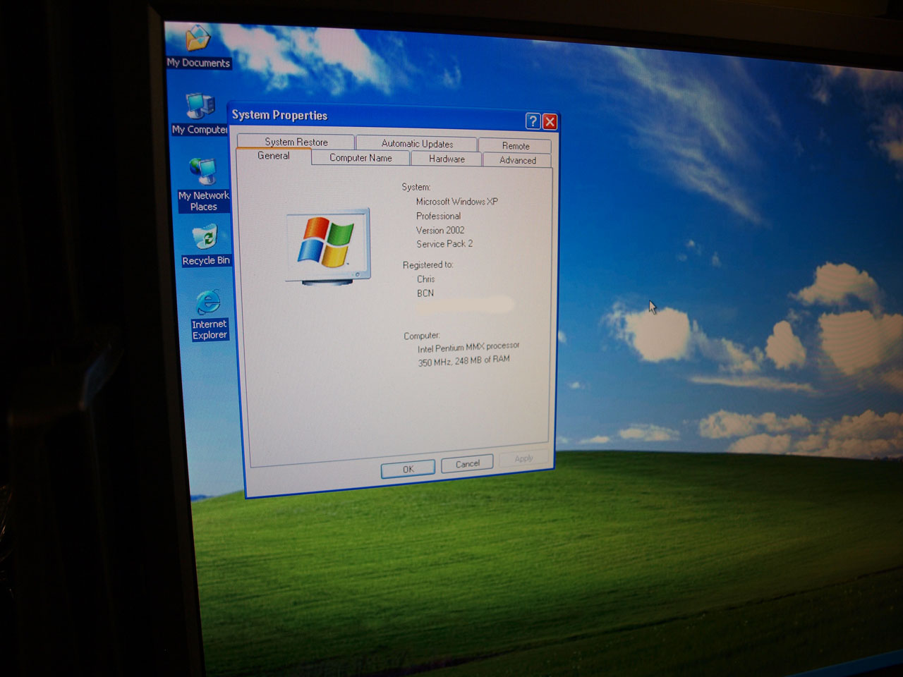

            • Per Hansson
              • Jul 2005
              • 5895
              • Sweden
              Re: Project : Tillamook
              What package and chip is it?
              300MHz Tillamook overclocked too 350?
              • Topcat
                its a 266/66 running @ 350/100, socket 7.
                  How's the OC going? Any Windows errors?
                  If you get BSOD "STOP: 0x0000000A IRQL_NOT_LESS_OR_EQUAL", increase the Vcore...
                    Its flawlessly stable @ 350/100. The goofy part is the multiplier is 4, but this board isn't recognizing it at that. Even at 66FSB, it only post's at 233, not 266. Board is a Mitac 5114VU super7... I would love to see this thing run at 400/100, and the Tillamook CPU is known to be able to do it. Super7 boards can be loads of fun....I ran a P55C 166MMX @ 250/100 with no issues at all. XP was a bit overwhelming for it, but W2K ran quite nice. The ulterior motive here is a win9x/DOS game experiment.
                      Cool! I had a K6-2 450 that would crash with only a +50 Mhz OC! 500 Mhz made it freeze. Even though it likely wasn't the best super socket 7 motherboard out there...
                      And even on a socket 462 Athlon, I could feel a difference between Windows 2000 and Windows XP... Windows 2000 benched better...
