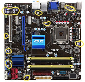

                        if you look at this p5q-vm it has fujitsu and chemicon polymers but the circled ones are taiwan polymers.
                        basically i dont see a problem with that
                        i would also be looking to buy a board late so i get a late revision
