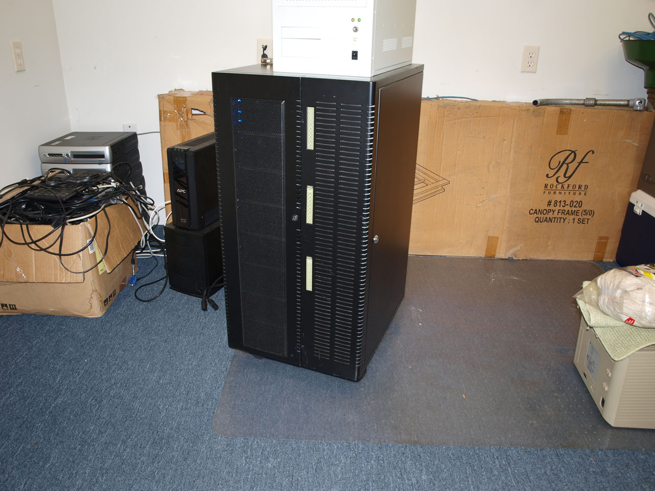

                            Anyone remember this thing?
                            It was literally buried in the corner, I couldn't even get to it....but because of a shelving project, I had to move it. First time it's been shut down since this thread...it's been rebooted a time or two for maintenance & updates, but never shut off. Good time to clean it!!
                            After the shelving.....this was only phase 1....and the systems in these pics are barely the tip of the iceberg....

                              What's sitting on top of the server case?
                                Looks like 2017 was the last time it was off... so about 3.5-4 years of 24/7, give or take. Yup, sounds about the right time to do a cleaning. I power-cycle my systems quite often (usually don't leave them On if I won't be using them for over 30-60 minutes), yet rarely go more than 2-3 years before I pull them out and de-dust. As such, I don't find much dust on them or their fans, but I don't like to anyways.
                                I see quite a few Core 2 era Optiplex 755's, 620's, and 760's - good ol' office workhorse computers.
                                I also see the beige systems get the "top shelf".
                                That said, I usually keep mine on the bottom, since they tend to be heavy. Several of them could probably crush a cheapo modern case, lol.
                                That MicronPC in the upper-left corner of this picture sure does bring back some memories from high school (that's what we used to run - Pentium II and Pentium 3 MicronPC's.) My high school was all old Dell's in the library and some of the teacher's PCs. But the computer rooms had P4 HPs and Compaq's.
                                Anyways, I really like that organization - looks really neat!
