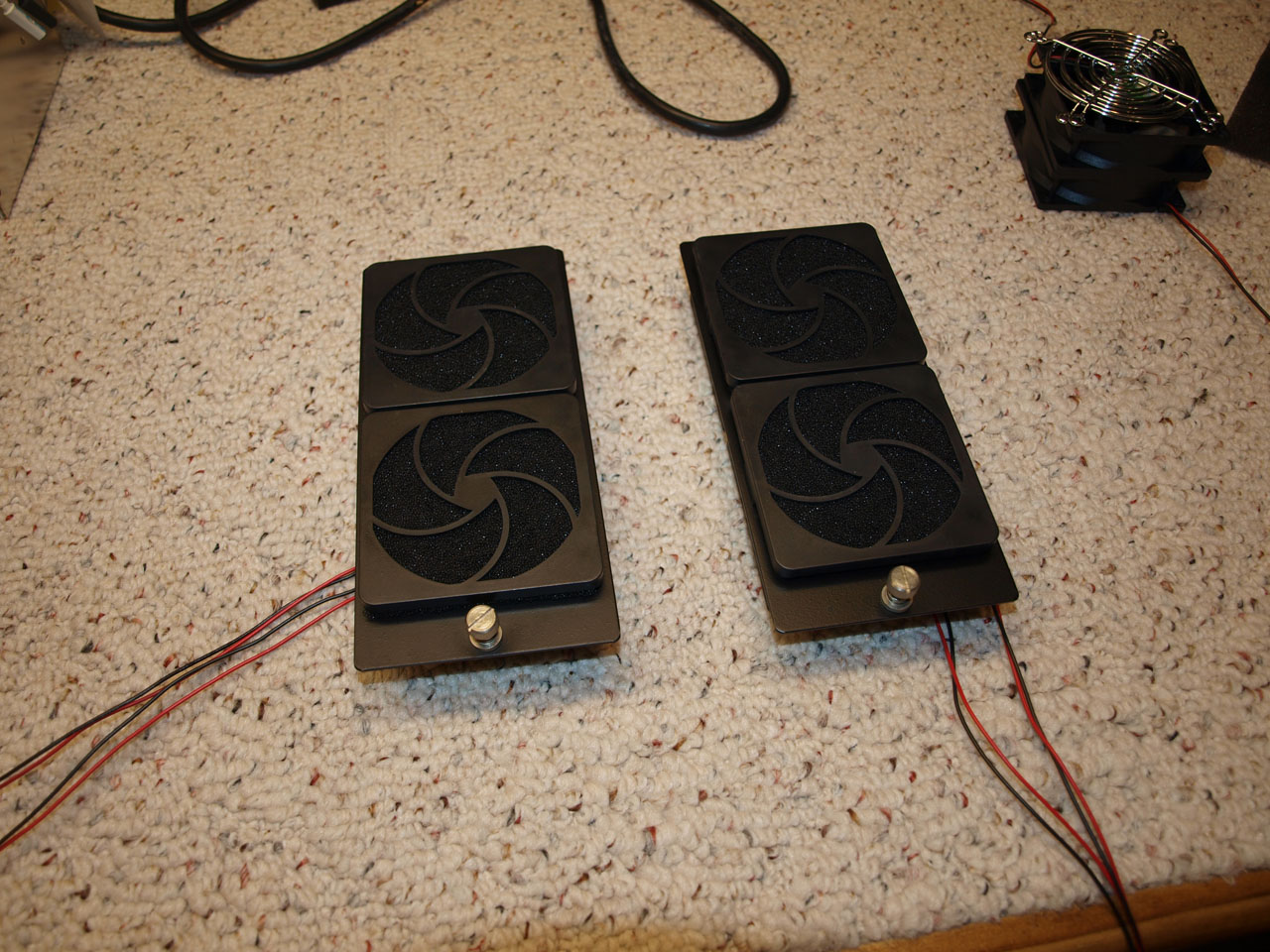

      Next I washed out all the fans and dried them with the air compressor.
      The front intake fans used to have filters on them, but when I got the server back, the filters were missing. I'm just assuming that after 14 years of use, they likely just disintegrated. I have a cure for that, I always keep this stuff around just for this reason.
      New screens.

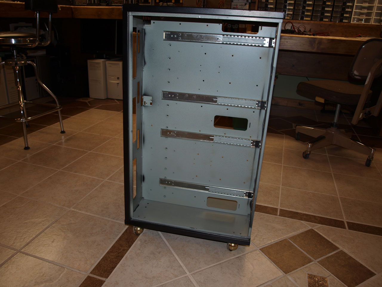

      This case is a wee bit too big to put in the sink....so I washed it outside with the garden hose.... It was gross...the company that bought it never even took an air hose to it. 9 years of dirt washed out looking like chocolate milk...
      All Clean!
      Doors too!

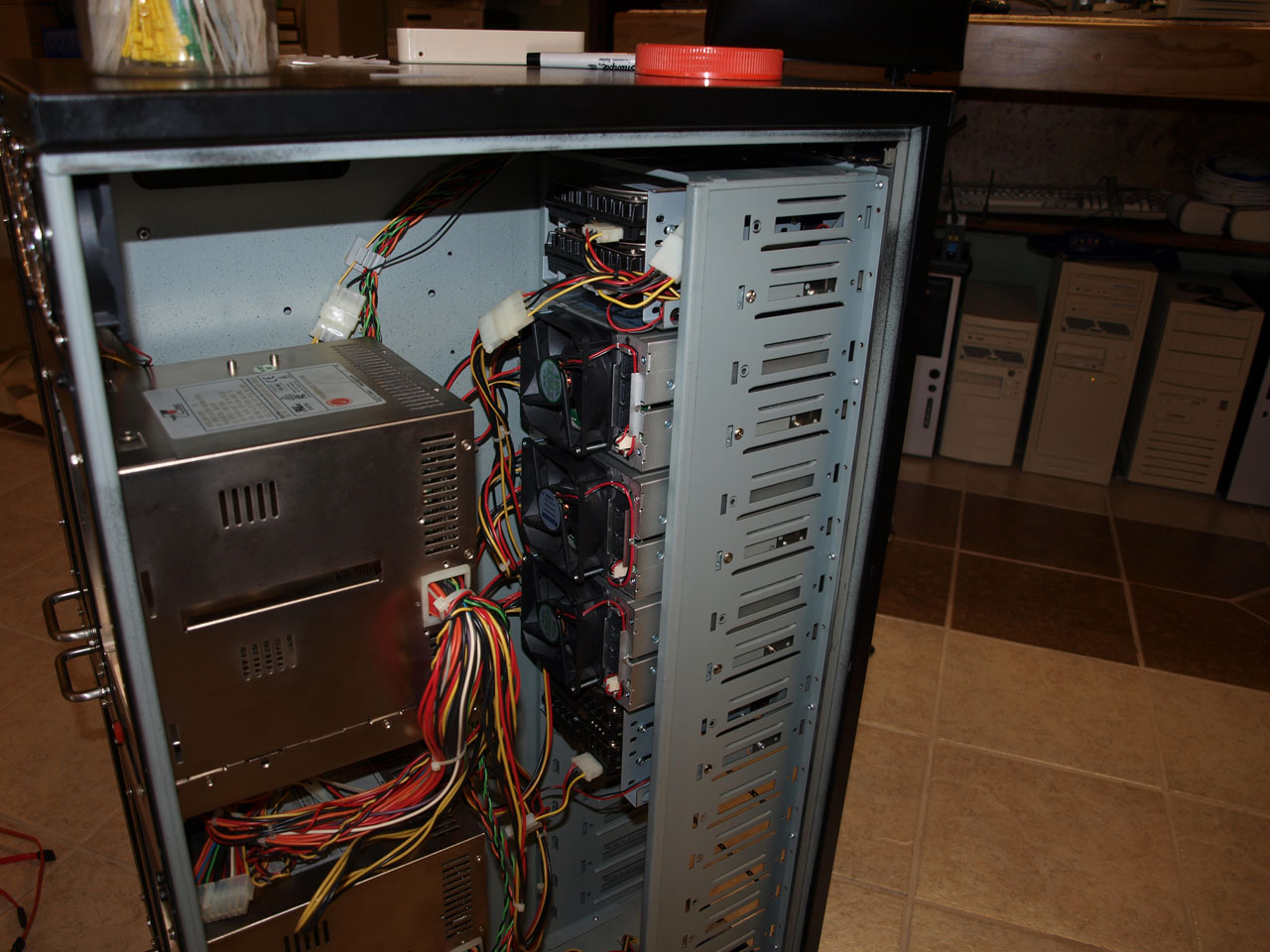

            I started reassembling it today. I replaced 2 of the front panel switches, as the pivots were broken. I also replaced the castors, as they had replaced them with some weird brass colored metal ones....I'm assuming they broke the originals.
            It comes apart easier....reassembly always seems to take longer, atleast when you do it neatly.
            Fans back in.
            Wire routing.

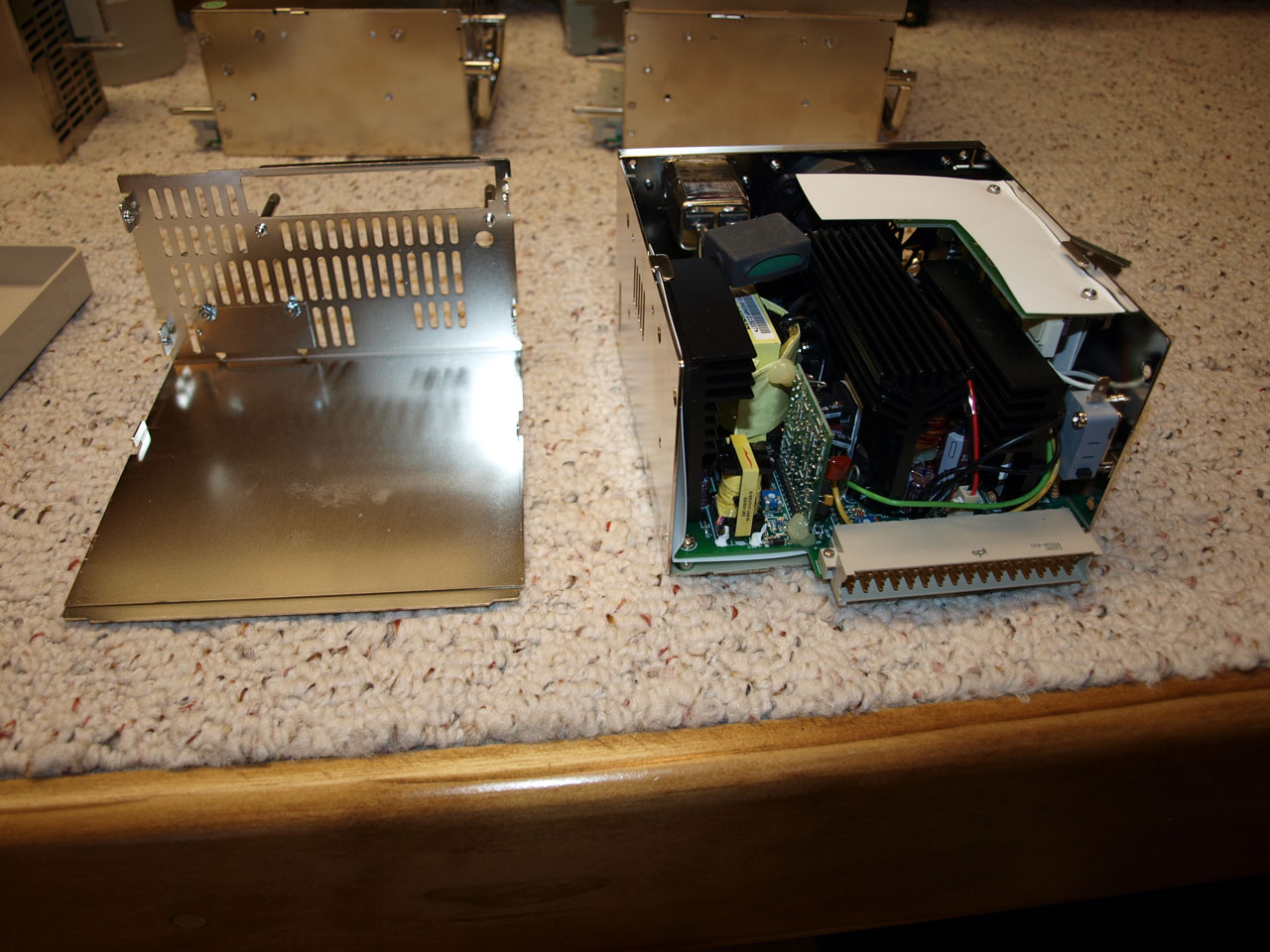

                    Caps came yesterday, I did the deed to all 5 PSU's this morning. Yes, ALL FUCKING FIVE. I only planned on doing the three...but when I checked the 2 newer ones just to be sure....well poo...found a couple crapxons. To add insult to injury, the fans are noisy too.
                    This is the replacement for the toasted one, all rubycon & UCC except for one 4700uF 10v capxon, sure enough its bad.... Replaced it of course....I'm glad I ordered plenty of extras, as they're useful for other things.
                    This is one of the older modules. All bloated, imagine that!
                    PSU & daughter board recapped.
                    Now for the BRAND NEW ONE! This one has zero hours on it, it was in its original packaging when I got it.
                    ....yes, brand new and a failed capxon....this PSU has never been powered up.
                    All 5 modules recapped. I also stripped the fans down, popped the bearings out of the sleeves (ball bearing without dust shields), and soaked them in brakleen. This removed all the dried out clumps they call 'grease'. I then repacked them with some ZEP2000 grease. All fans spin free & quiet now.
                    Pile-o-crapxons!
                    ...and its alive!
