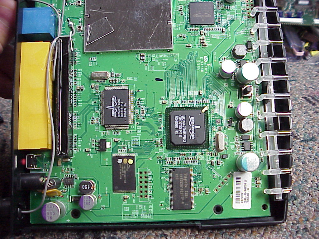

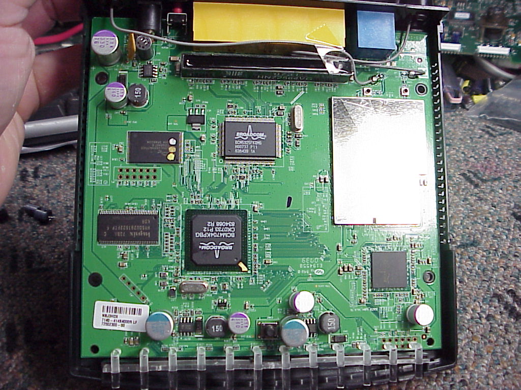

    this unit was unstable with several resets a day needed to keep it running.
    the 220@6.3 suscons sizzled when i unsoldered them.
    went all polys on this rebuild.
    next is dd-wrt.

      i got it and a brand new one secondhand at a yardsale.
      you can bet i am going to recap the new one before it gets put in service.
