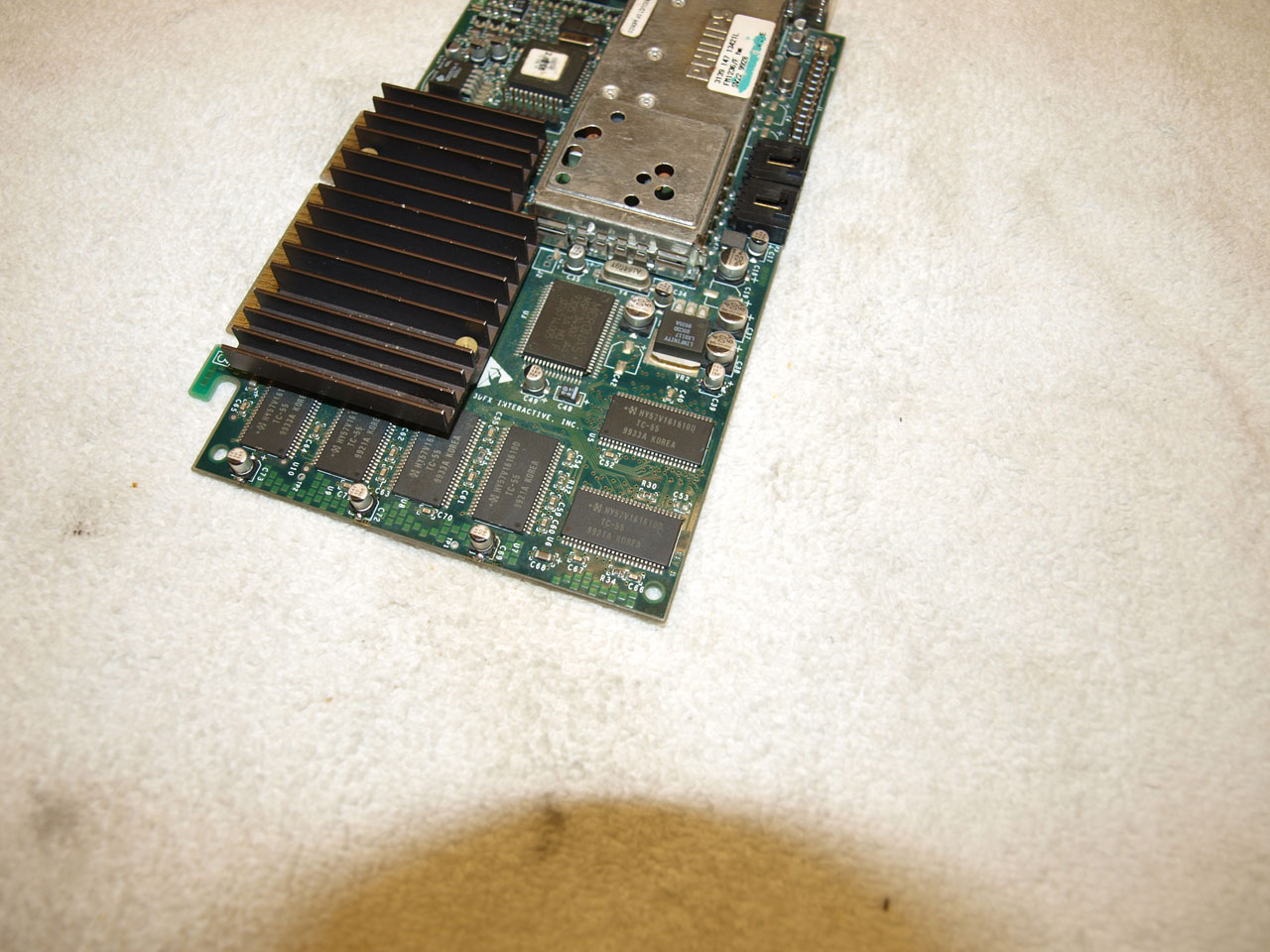

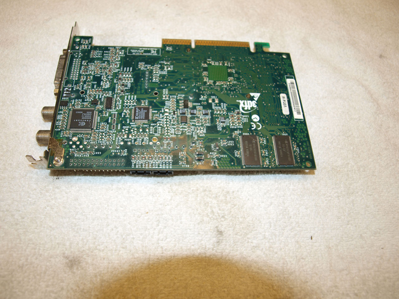

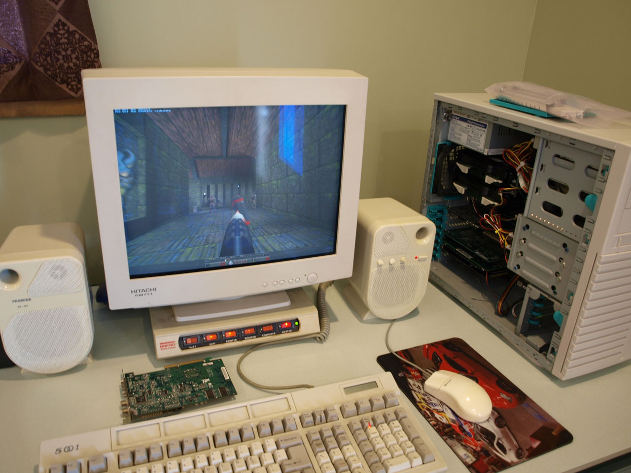

    This was a $25 ebay gamble. Seller said 'a capacitor is missing' and the card does not work.....well the card arrives, I discover 5 caps missing and 3 inductors missing. Poor handling at its finest!

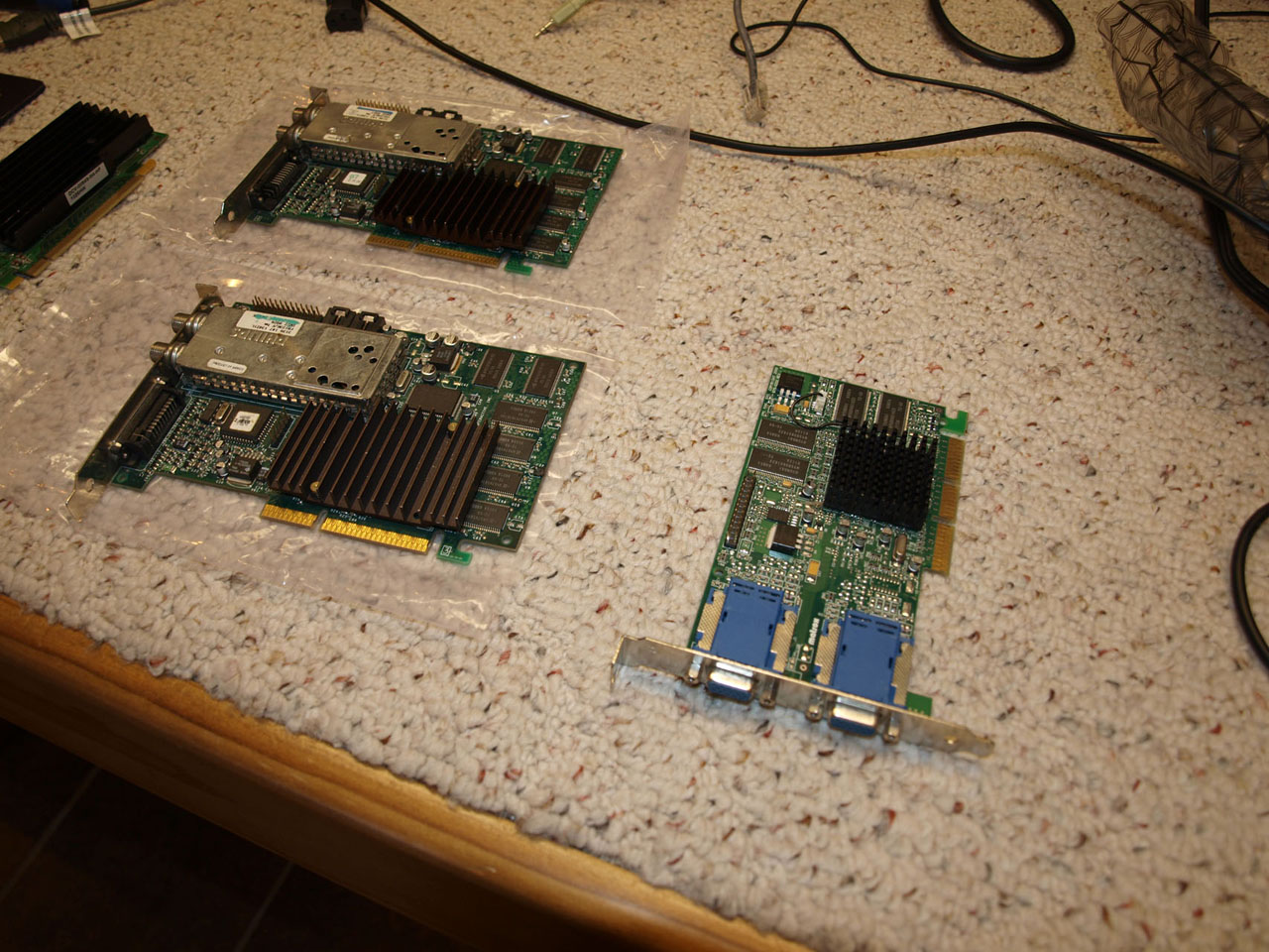

    This is a comparison to a known good identical card, the top one is the good one, the bottom one was the gamble subject:

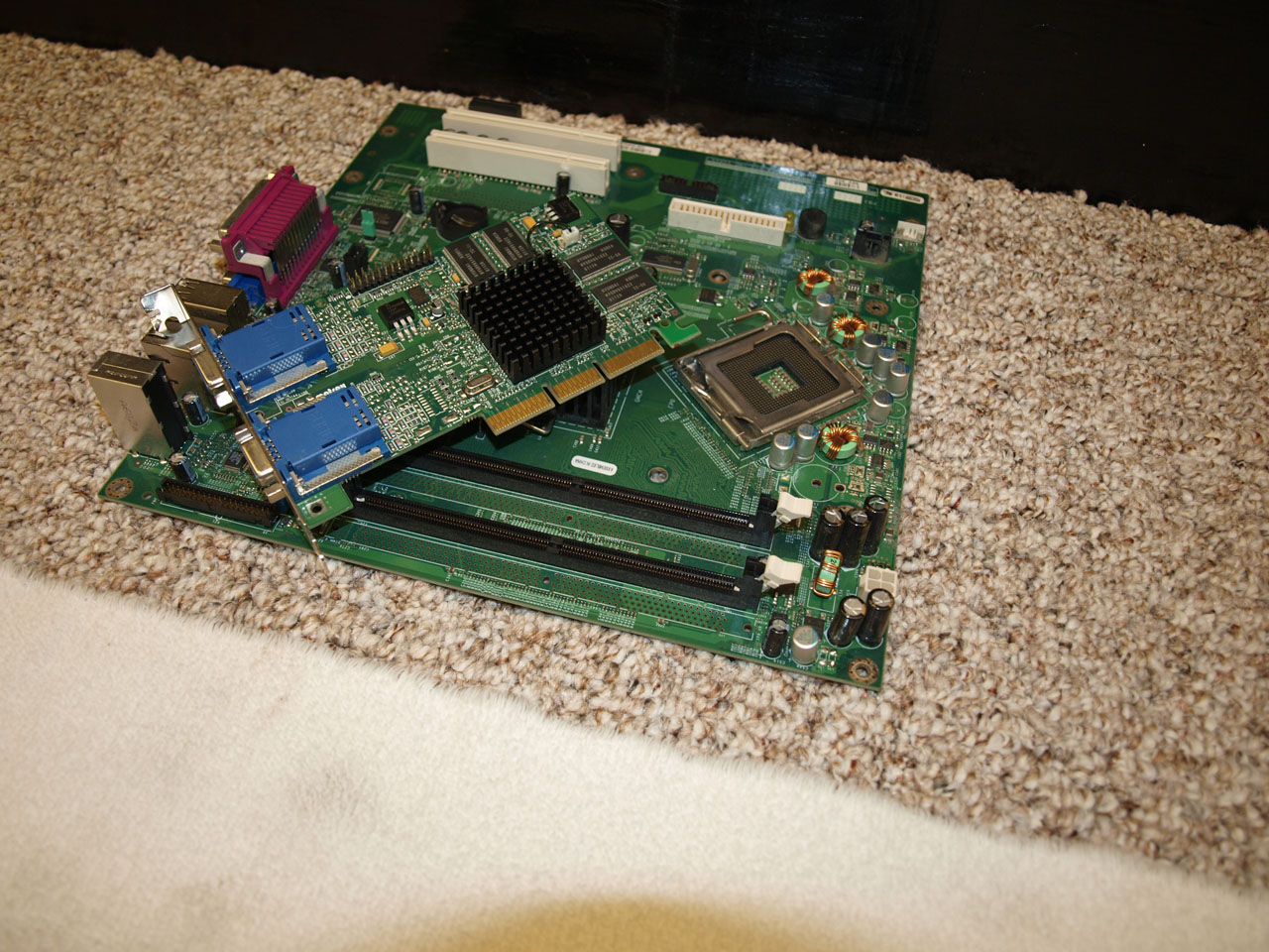

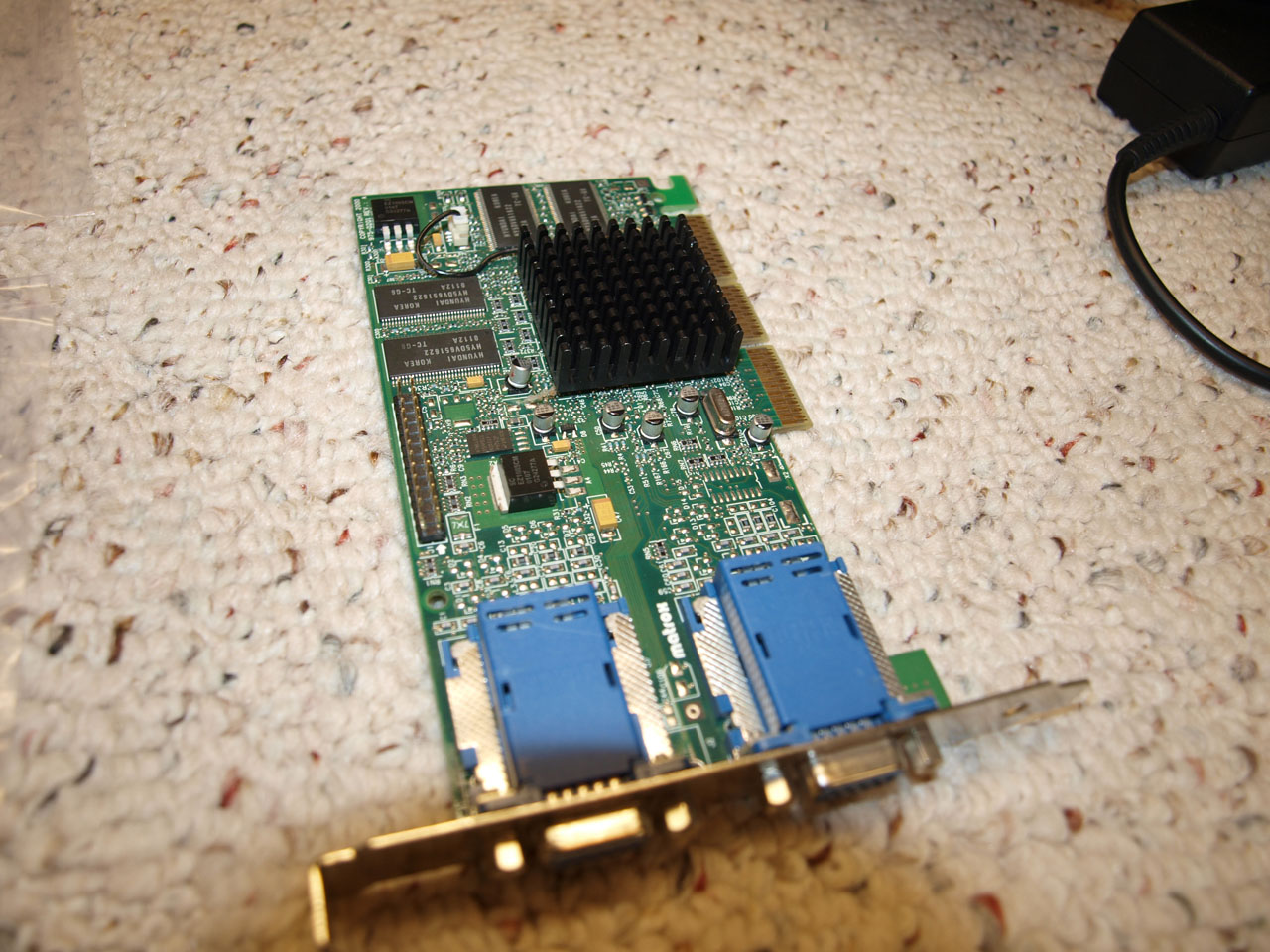

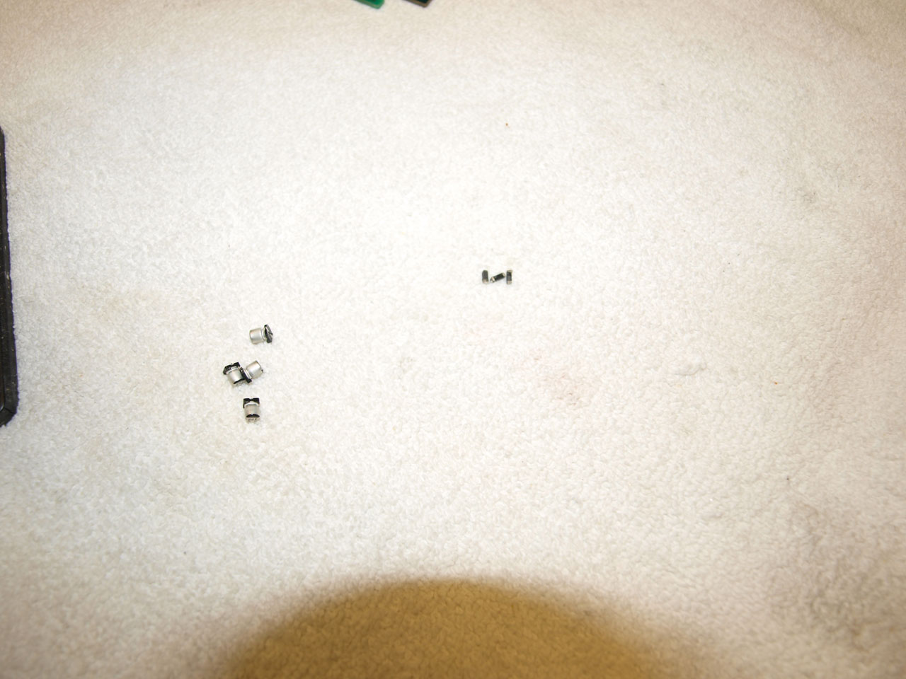

    Now to find the missing parts from junk..... The missing lytics were found in a faulty Matrox G450 card. The card had severe artifacting issues and wasn't worth messing with.....but tech haorder me just didn't trash it....it ended up in the junk bin....and lo & behold, it has the exact caps needed. Since the card didn't work, I tested the caps upon removal with my LC102, just to make sure they weren't the reason the card didn't work. The caps were spot-on.
    Now for the inductors.... I didn't have a clue what their Henry rating should be without desoldering the originals from the known good card and testing them with my inductor meter....I wasn't doing that, so I just decided to wing it and see what I could find. Well, it was a Dell GX520 motherboard that had them, right by the +12v ATV connector.
    Preparing for surgery!
    Donor parts harvested!
    Installed.

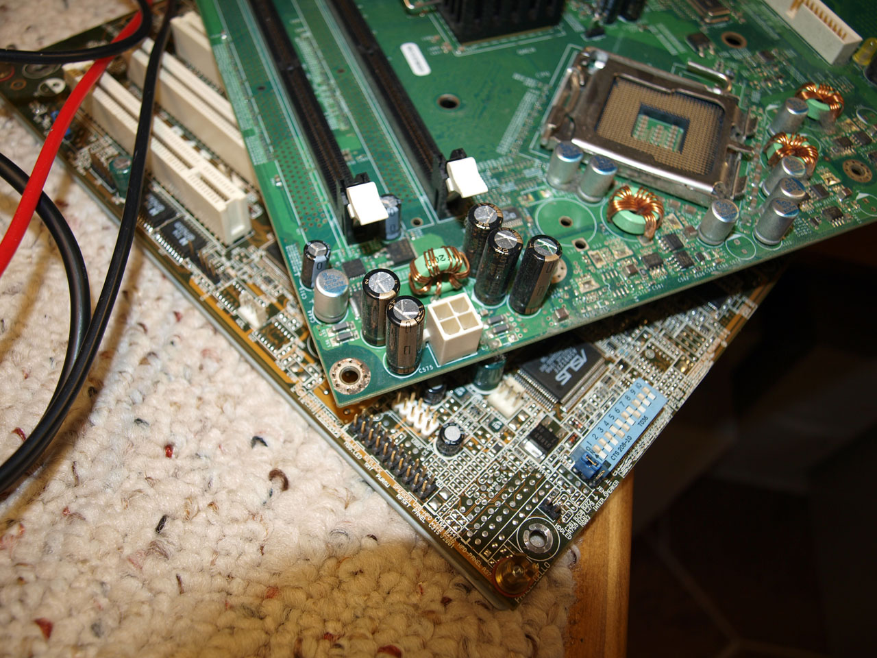

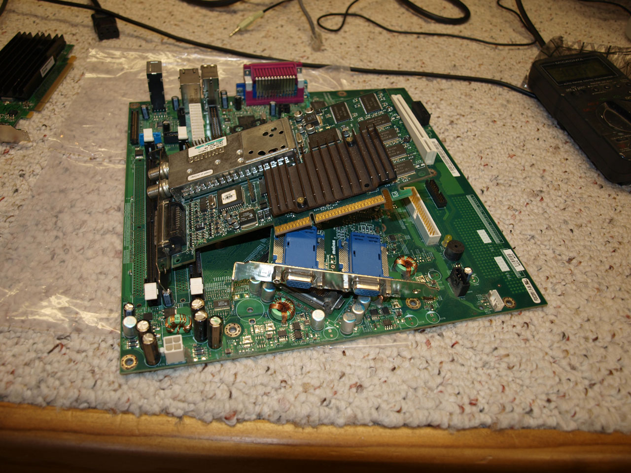

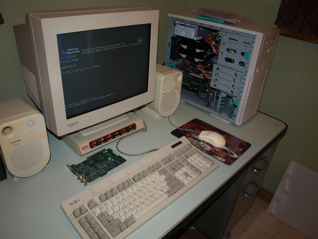

    POST tested and burn-in tested in an Abit VL6 with some Tualatin mods....I tested it in this not-very-valuable board, just incase something went *POOF*, I wasn't going to risk releasing the magic smoke from a good/valuable board.

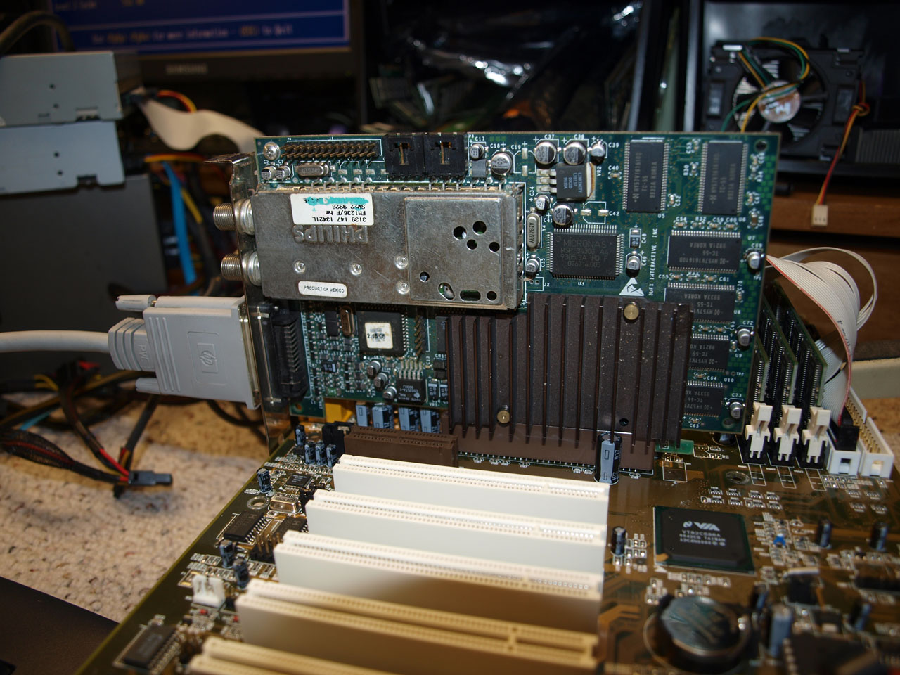

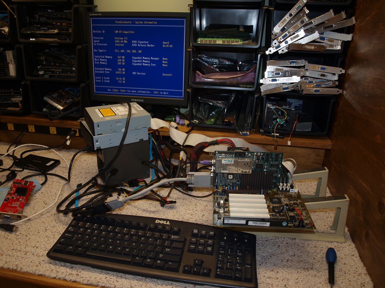

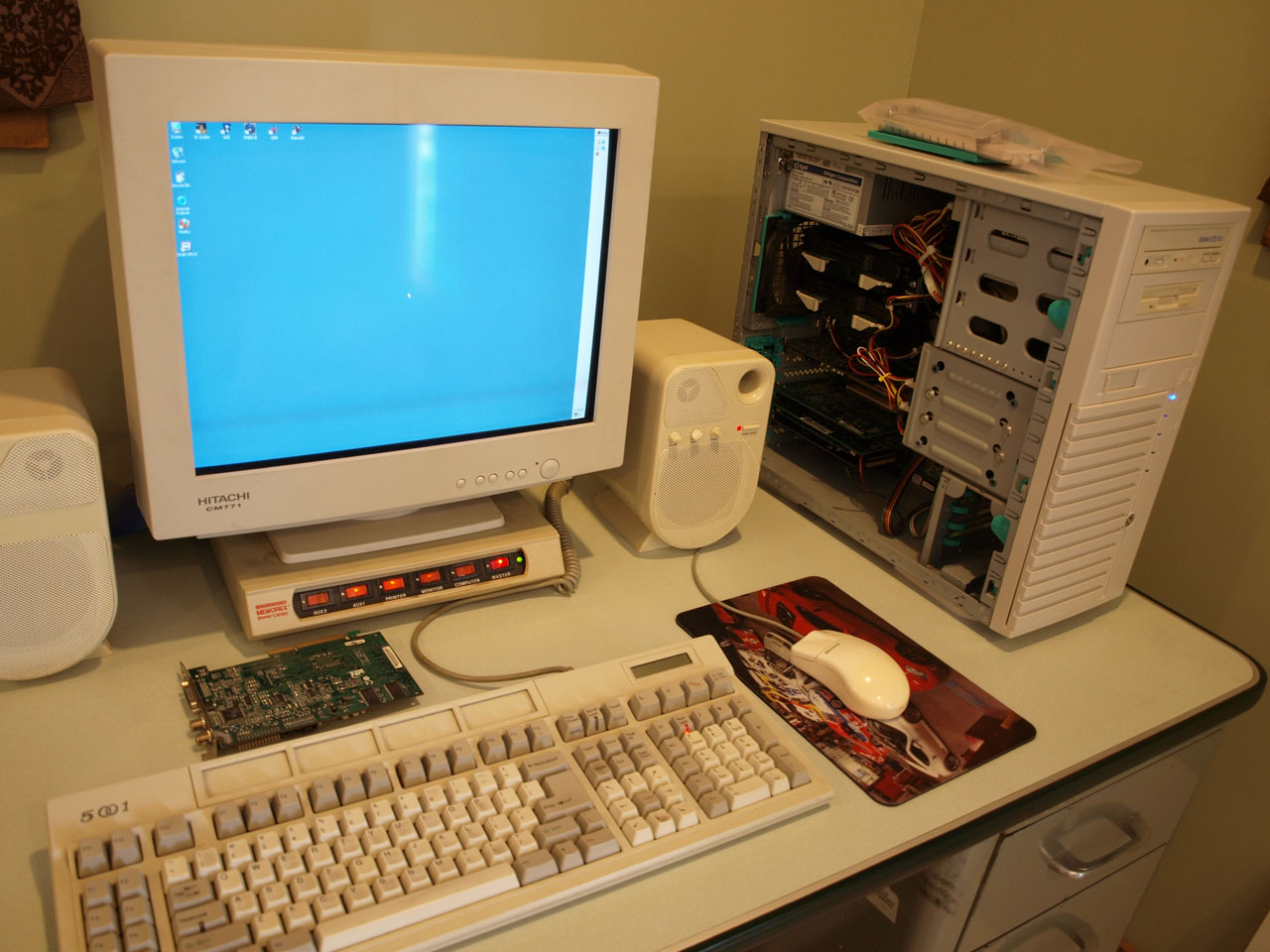

    Since nothing went poof and the card seems to be working fine, it's now time for the real test! I installed it in the system that the working card came from, the S2DGU build from THIS THREAD. Since this system is already configured for this card, it'll make testing easy....
    Booted up to the desktop, no prob.....
    ...and the final test, nothing better than a little GLQuake!!
    This gamble paid off!! I have a build in mind for this little girl!!

        Those rectangular SMD inductors are usually just ferrite "beads", so not much inductance on them. They can often be replaced with a jumper / solder bridge without any adverse effects.
        Now if this was a buck voltage regulator of some sort... yeah, you'd definitely want to get that inductance right or at least within a very reasonable ballpark. Fortunately, many old cards like this VooDoo use linear regulators for just about everything (or parts straight-connected to PSU rails.) So that makes things a lot easier to fix.
        https://www.badcaps.net/forum/attach...1&d=1582138634
        **Drools**
        This is AWESOME!
        I always wondered how the old Need For Speed series would look on these cards. I think everything up to Porsche 2000 / Porsche Unlimited still had 3DFX/glide support (and some had graphics options that supposedly weren't even available with D3D modes.)

        If anyone has/sees any old hardware with Micron Technology MT48LC1M16A1-6SE RAM chips, please PM me. I have a cracked one on my card... again, due to mishandling from whoever had it before me. So I need to replace one of those memory chips. I think they are 16 Mb chips running at 166 MHz (6 ns?)

          Just a FWIW, I stuck this card in my dual SL4KL build, as rare as those CPU's are it seemed a worthy candidate. Very period-specific as well.
