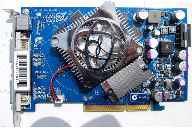

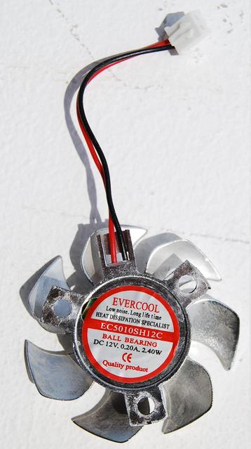

          I feel your pain! I am now working on my nVidia 6600GT. I already oiled the fan once, so now I am thinking about a replacement. I already replaced the fan on my Radeon 9700 Pro. The aftermarket fan is so big that it takes up the PCI slot next to it. I don't want that for the 6600GT.

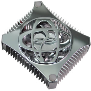

          I found the original, made by Evercool.
          http://www.evercool.com.tw/products/oemodm_pn21.htm

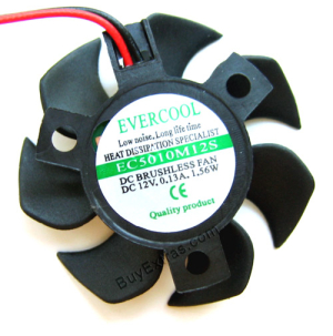

          Here's some replacement fans by Evercool
          http://www.buyextras.com/dc12vvgahef...FSK1IgodBB25Bw
          Here's mine
          And here's the replacement
          I see that NewEgg.com also has them, so I'd rather get it from someone I have dealt with before.
          I ended up getting $300 worth of stuff at NewEgg!

            i bet that original "ball bearing" fan has a standard oilite sleeve bushing in it and only thing retaining the oil is the sticker!

                  I oiled it and put it back together already. Otherwise I would snap another picture.
                  You're correct about the fact the sticker is the only thing holding the oil in. It also looked to be a bronze bushing, not a ball bearing. Although I didn't take it apart that far to really get a good look.
                  I was worried that the replacement fan was of a lesser quality than the original (ball vs sleeve). But now I am not too worried.
