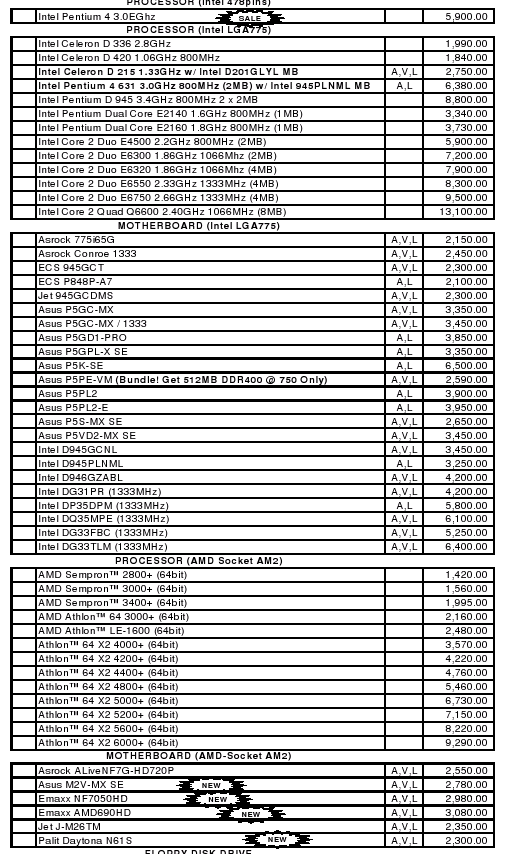

                  OK. disregard the previous store's pricelist.
                  This is the pricelist of the store I want to buy from:
                  Note: Its in Philippine Pesos. Currently $1=P42.
                  SO any suggestions for a Processor-Mobo Combo capped at P7000? :-)

                    #69
                    Re: AMD or Intel??....
                    Originally posted by grss1982
                    Any suggestions for a Processor-Mobo Combo capped at P7000? :-)
                    I suppose you are looking for a board with integrated video, so I choose 4 combos:
                    a) Athlon X2 4000+ (3170 P) + Asus M2A-VM (3740 P) = 6910 P
                    b) Athlon X2 4200+ (3800 P) + Asrock ALiveNF7G-HD720p (2650 P) = 6450 P
                    c) Intel E2140 (3220 P) + Msi G31M-F (3640 P) = 6860 P
                    d) Intel E2180 (3950 P) + AsRock Conroe1333-D667 (2290 P) = 6240 P
                    At stock speed the 4000+ is slightly faster than the E2140 and the 4200+ slower than the E2180, but Intels can overclock better if board and memory can stand with it.
                    I think you're stick with Intel G31 and 945GC chipset for Intel processors: the boards with Intel G33 are out of budget and I fear most Via and nVidia powered ones are not so good. Sis' ones are a lottery: some good, some bad - I tend to avoid them.
                    The Msi has a 3 phases vrm with polimer caps, the AsRock a 4 phases with standard electrolytitcs ones - so check their brand before buying.
                    For AMDs the chipsets are AMD 690g and v or nForce 405/430 and 630a: Via products are quite outdated and both nForce 500 SLI and 560 SLI are the old nForce 4 SLI renamed (it still has a lot of trouble with PCI timings, so I don't like it). nForce 520 is acceptable too, but lacks the integrate graphics and force you buying a graphic card.
                    Both Asus and AsRock feature a vrm with electrolytic caps, so same suggestion here (check their brand).

                          #72
                          Zandrax
                          Thanks Zandrax.
                          Looks like I can narrow down my choices to:
                          The Intel setup is actually the perfect choice for me since I don't want to overclock. Well maybe later when prices of the p35 mobos go down

                          • grss1982
                            • Mar 2007
                            • 225
                            • Philippines
                            #73
                            CRAP!!!!
                            @Zandrax:
                            The Mobo on option b has TK and OST caps!!!! ugh......
                            Same on Option D too. :-(
